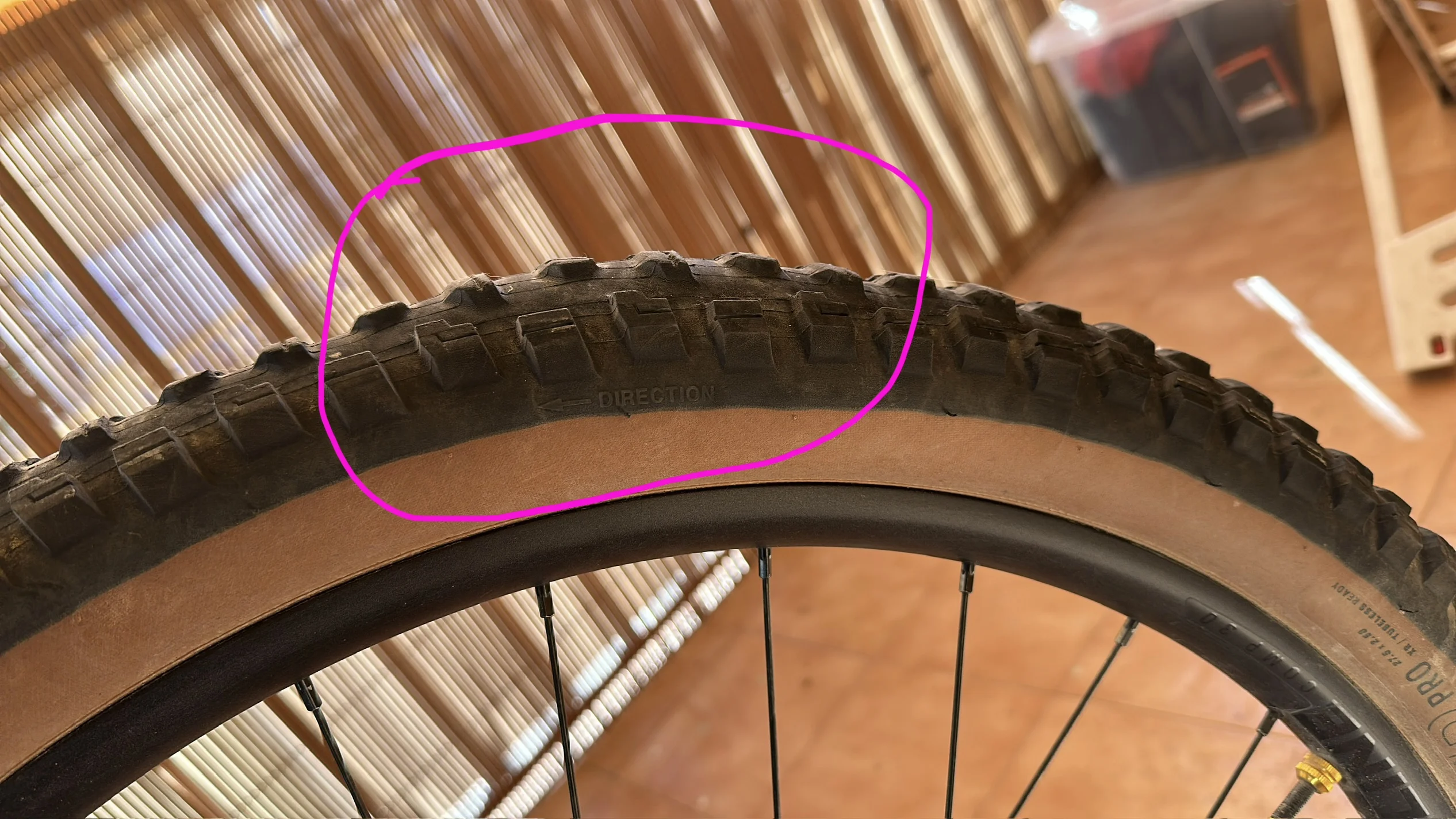

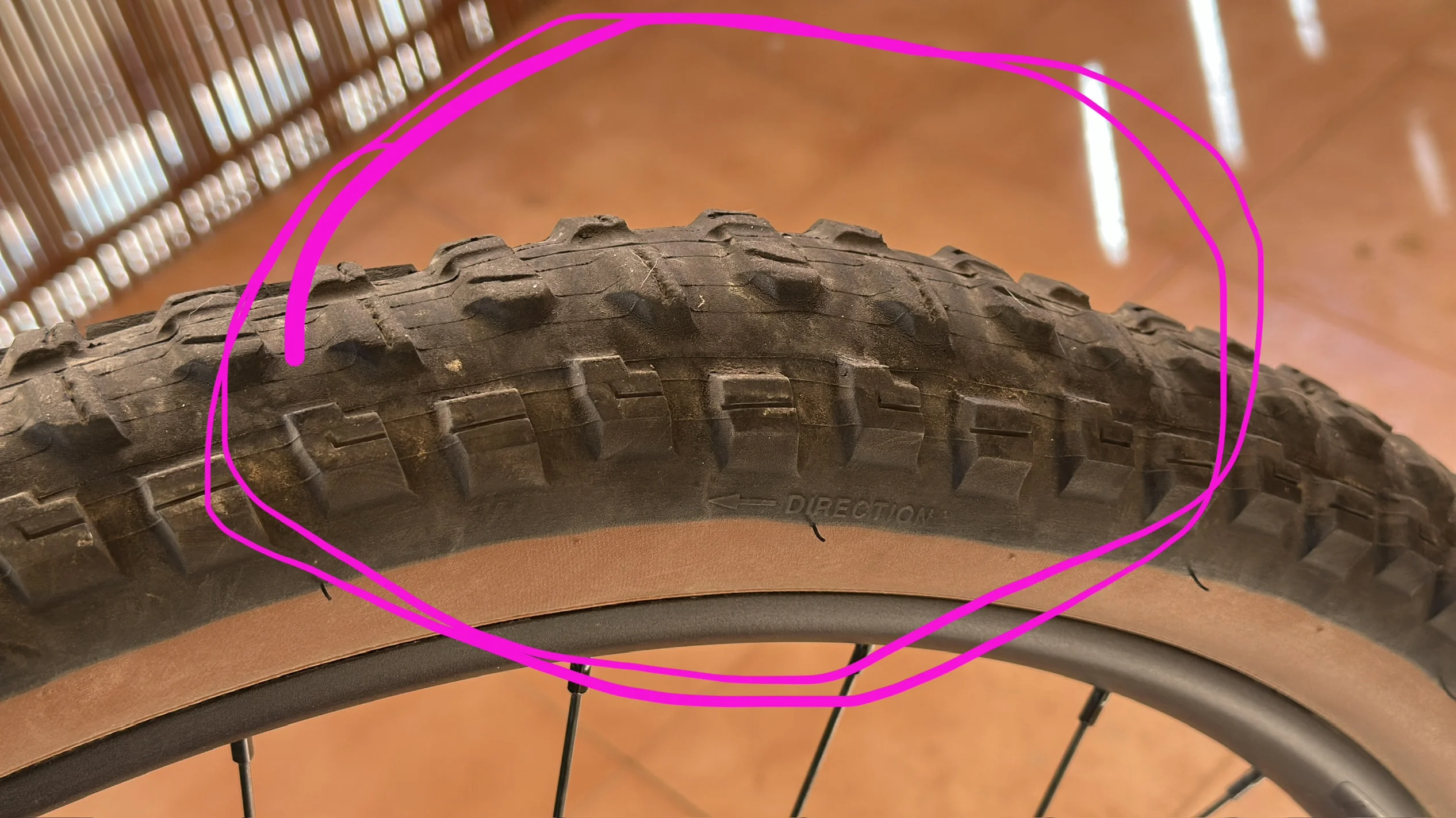

Hi everyone. This is the first problem I've had with my Rail+ 8 gen5 since I bought it in March, apart from the seatpost remote, which was quite awkward and I replaced.
On Saturday afternoon I went for a ride and after 3 km I had to turn back 😟😟.

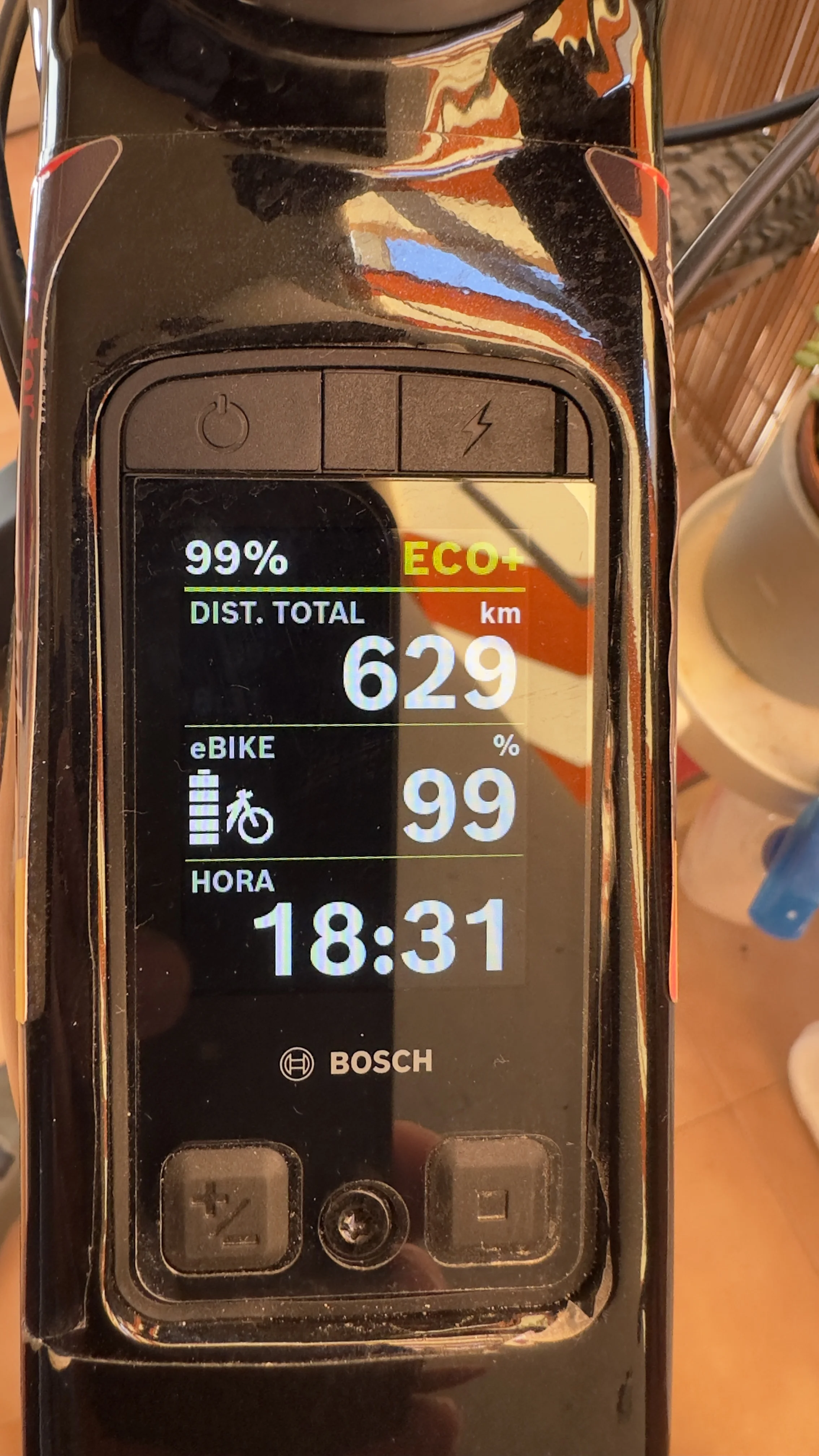

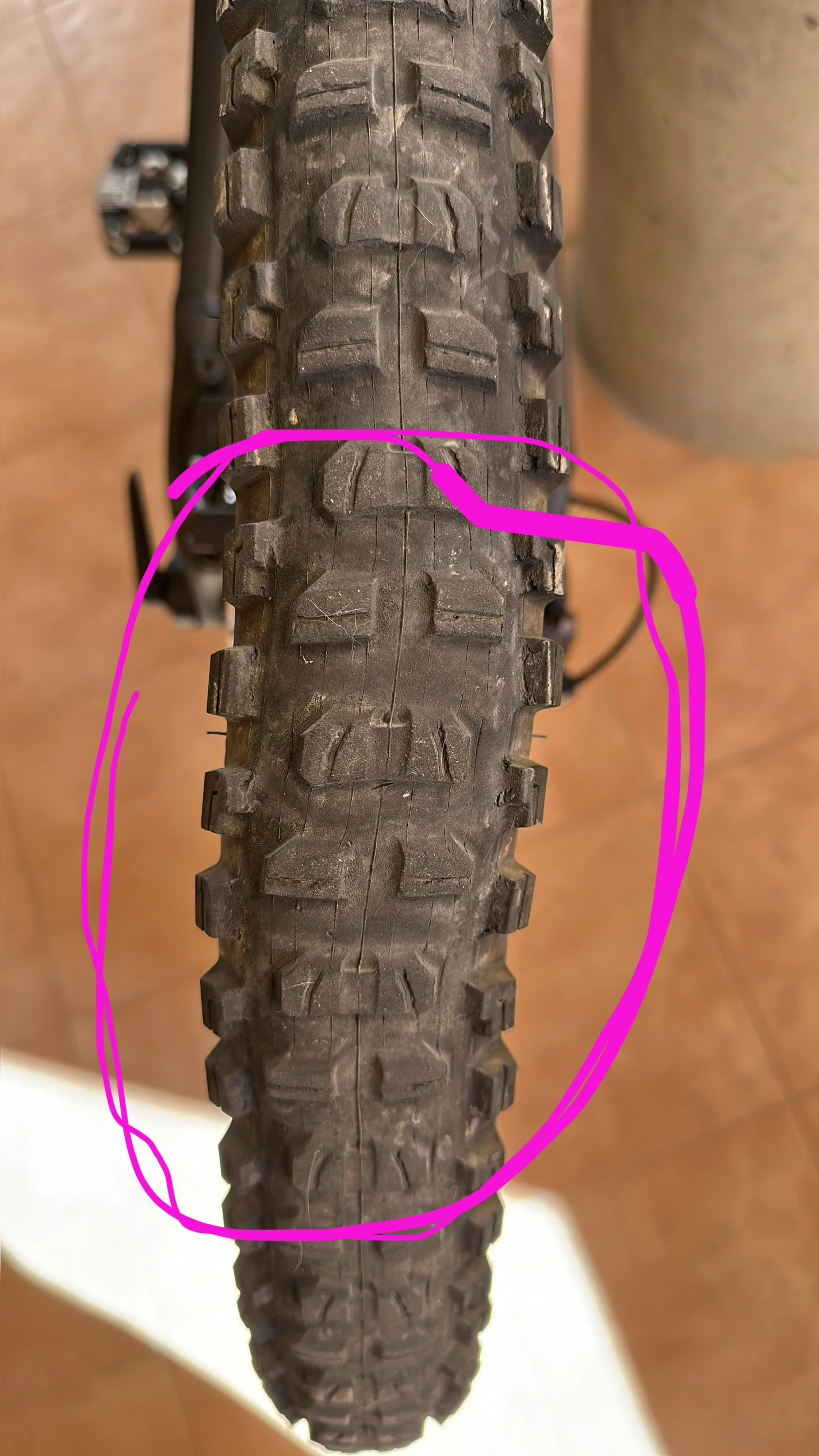

Last week, my riding partner mentioned that the rear wheel didn't seem to be properly positioned. We stopped and checked it, but the deformation wasn't noticeable at the time. I started riding on a dirt road and the instability wasn't obvious, but when I turned onto the bike path to connect with another trail, the bike was swaying from side to side. I stopped and the deformation, which you can see in the photos, was now visible. The bike has 620 km on it and there's no damage to the rim or any impacts.
Has this ever happened to any of you?
I'm going to post it in the Trek store's WhatsApp group to see what they say, although I have a feeling they're going to reply.
are you running tubes? only thing I can think of is a twisted inner tube.
if not, and the rim is straight, it's time to choose a new tyre
We have been experiencing this crap for 15yrs, commonly known as MaxiWobble or ContiWobble, Conti have made good lately, Maxxis, not so good.
I have successively warranted 1 tyre with Continental but I have had wobble issues with about 10 tyres, 9 of them Maxxis, 1 Conti. 3 riders in our house.
Maxxis dont give a sheet.
Just replace them. They’re undesirable tires. I’m not a fan of any Bontrager rubber. You got good life at 629k. Might as well upgrade them.
