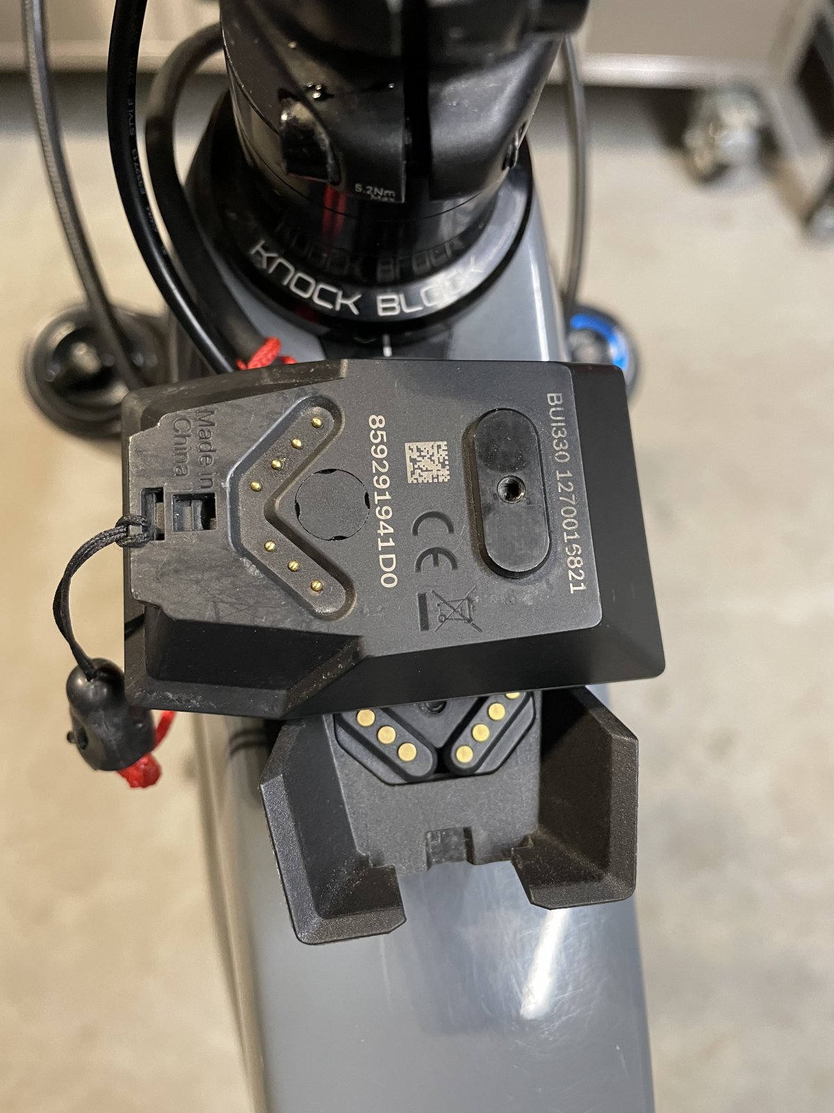

The issue that @yorkshire89 mentioned sounds most likely. With the Kiox removed from its holder it should also power on.
There’s several contact points between the Kiox and the holder. Some of these contacts supply power when the Kiox is in holder-position. If the alignment or position of the Kiox is not just right it could cause a number of issues. For example; yesterday I installed a new Kiox controller. Once I completed the install (included removal and disassembly of Kiox holder) I placed the Kiox in the holder and pressed the ON button. The screen lite-up but I noticed that the battery % was blank. I could change the modes but the walk button never worked. It was a simple fix though. R&R the Kiox. But.
During rides I sometimes lose power assist when the bike is ridden over rough gravel. The Kiox screen stays on but I need to power through this for 5-10 seconds. The likely cause for this may be the electrical contact in the battery compartment due to vibration. It got me thinking 🤔. Could the contacts between the Kiox and the controller be affected from this vibration also?
There are 7 contact points between the Kiox and the holder. Any debris, dirt or a misaligned Kiox could cause a number of issues. I don’t know the wiring configuration for this area but it seems that could cause certain issues at times. There’s also a small battery in the Kiox.
