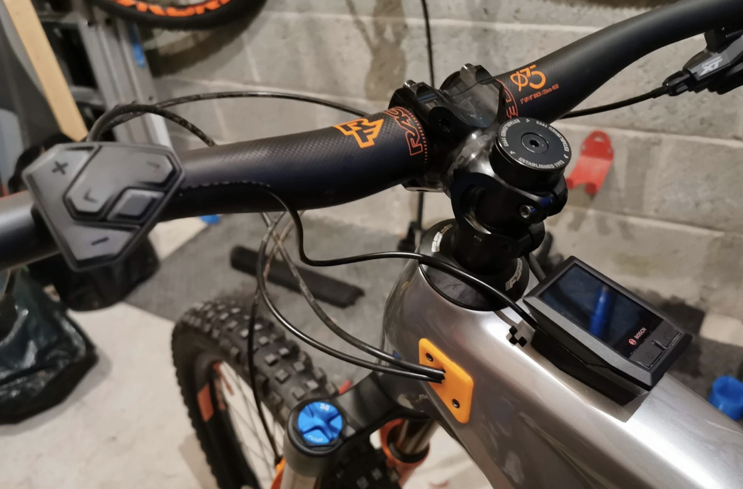

I use a mount from www.ebikeprints.com it sticks to frame it’s 3D printed originally made for cube but works on my Whyte E180s and it’s only £15 works great so I can keep my garmin on the stem
Huh! I came to this subforum just to ask about this very kind of thing and here's a relevant post. I've been struggling with this whole Kiox holder business. Unfortunately, ebikeprints doesn't ship to the US. :confused: Two days before that a very old backorder for a Cube Acid Kiox holder was canceled by Bike24, so there's two strikes so far. :cautious: There is another vendor on eBay with a more or less similar design to the ebikeprints design and not charging crazy shipping or refusing to ship to the US so maybe there's hope yet.
I have a couple of questions about this:
1. Have you had any quirks or issues with this style of mount?
2. How tall does the top of the Kiox sit above the frame?

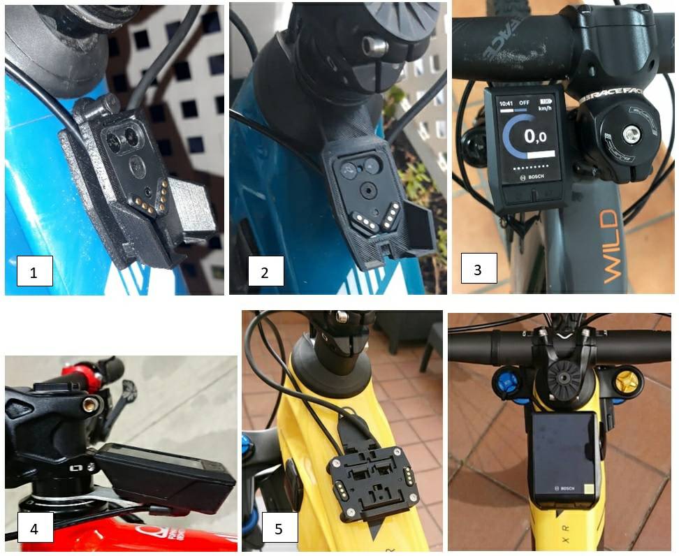

These are the brackets for Bosch kiox and Nyon!

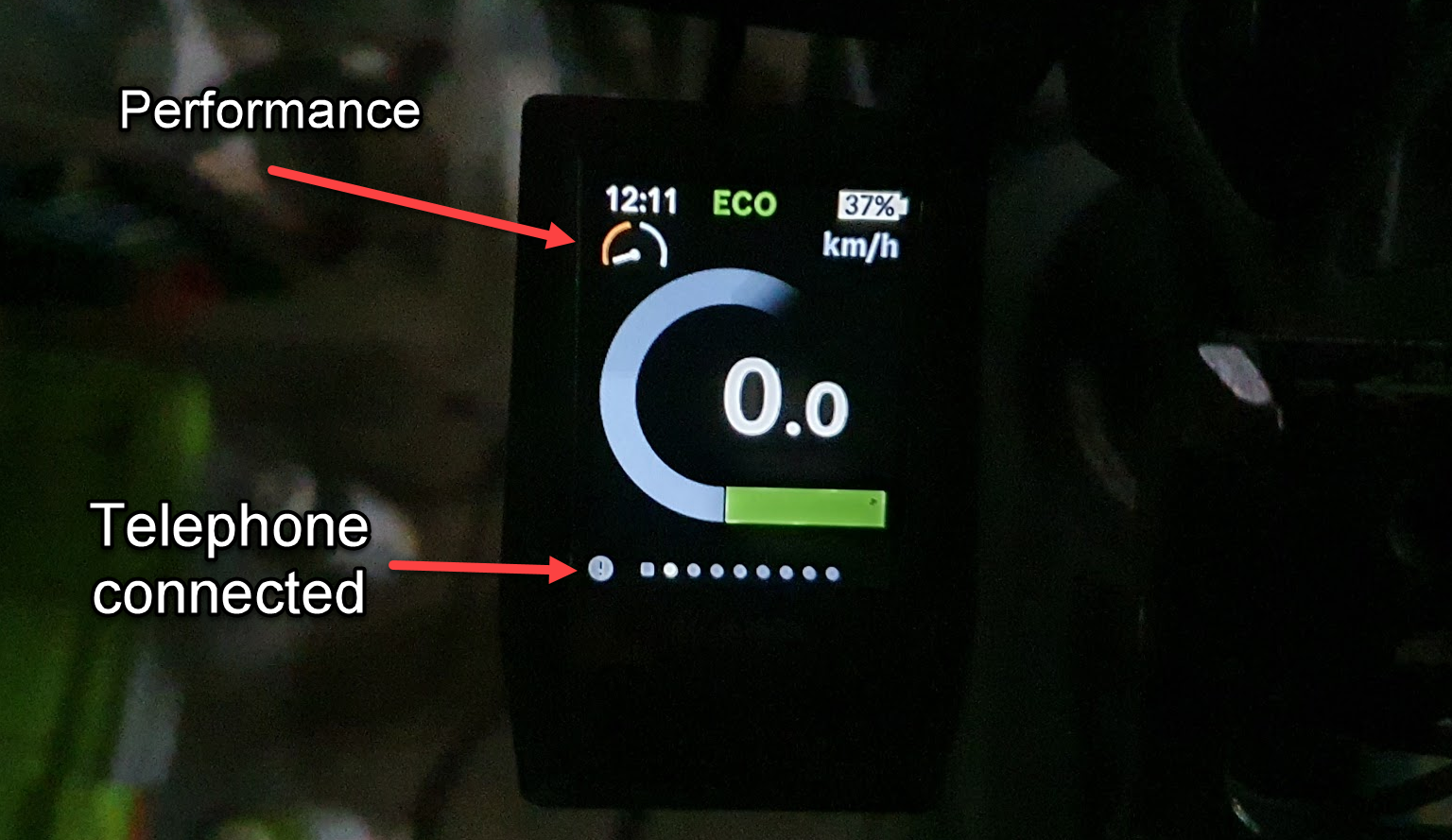

I just got my bike updated to the latest firmware 1.1.5.0. I guess the Kiox and battery were also updated.
I definitely notice an improvement in the Kiox telephone connection.
Also the Ascent and Descent values are now displayed in the statistics in the Bosch App. on your phone.
Lastly the Kiox display has changed a bit.
Performance is if you are currently above or below your average speed.
