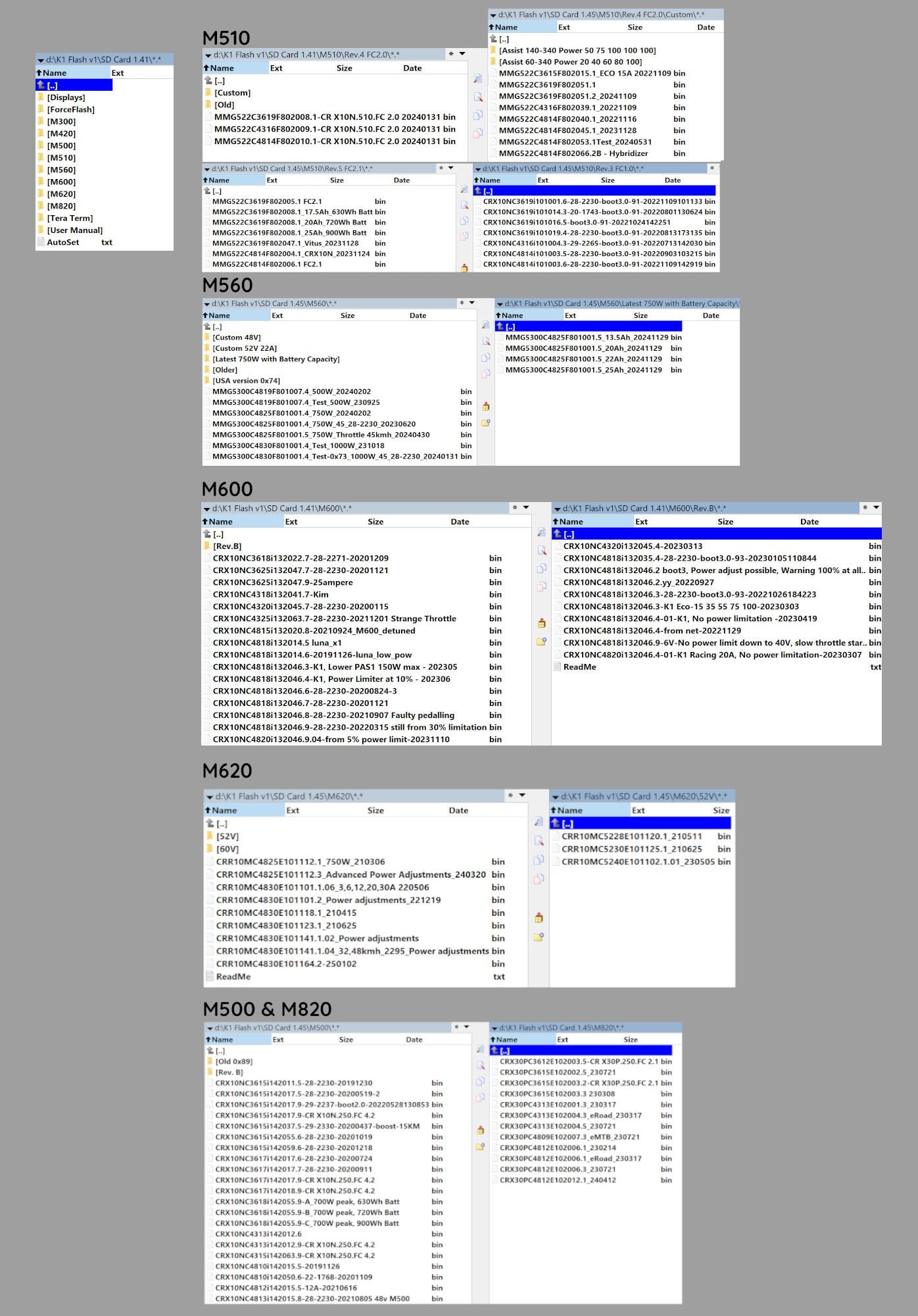

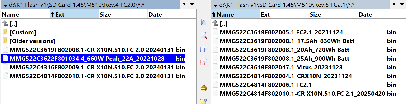

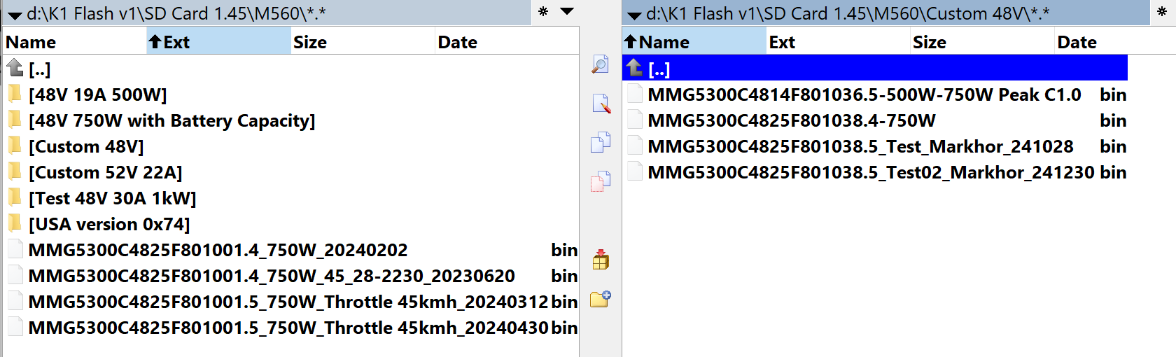

Few new firmwares available.
M500 - latest and I guess also last 36V 18A firmwares v55.9, with different battery capacity: 630Wh, 720Wh, 900Wh - good for DYI batteries to get better range estimation. Also for Rev.B motors. Peak 710W.
M510 - new FC2.0 firmwares v8.1 , compiled for different battery sizes: 630Wh, 720Wh, 900Wh
Custom firmwares (Vitus, Hybridizer, ECO firmware 36V 15A max), Latest firmwares with different factory settings - for longer range.
M560 - new firmwares v1.5 750W compiled for battery capacity: 13.5Ah, 20Ah, 22Ah, 25Ah
Some lates custom "Test" firmware v38.5

Theres some older 22A M510 firmware. Be careful about long hills on full power.

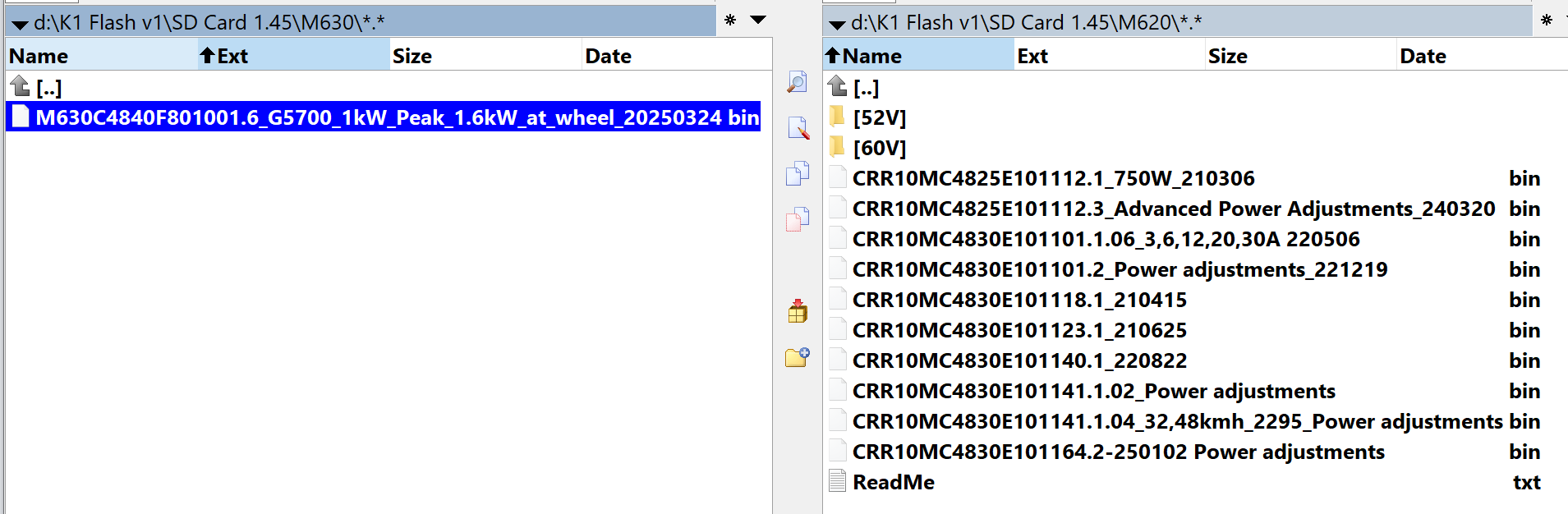

Some M630 firmware came randomly under my hands.
I did flash this firmware to M560 and motor started, also took all the settings. 48V 40A, that will be a chain breaker. ;)) Thats cca 1.6kW peak on a wheel.

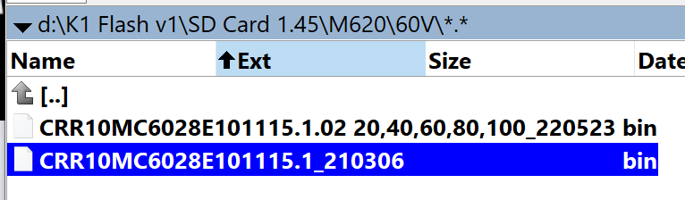

Will this work on the Frey Beast with the 60V Bafang M620 setup?
Have just 2 firmwares for 60V. :( Thats rare combination.
Basic settings would work (Speed limit, Wheel size, Circumference)
72 klm/hr reliably?
Can we also set to 25 klm/hr if needed?
Over 72 new controllers usually refusing to set.

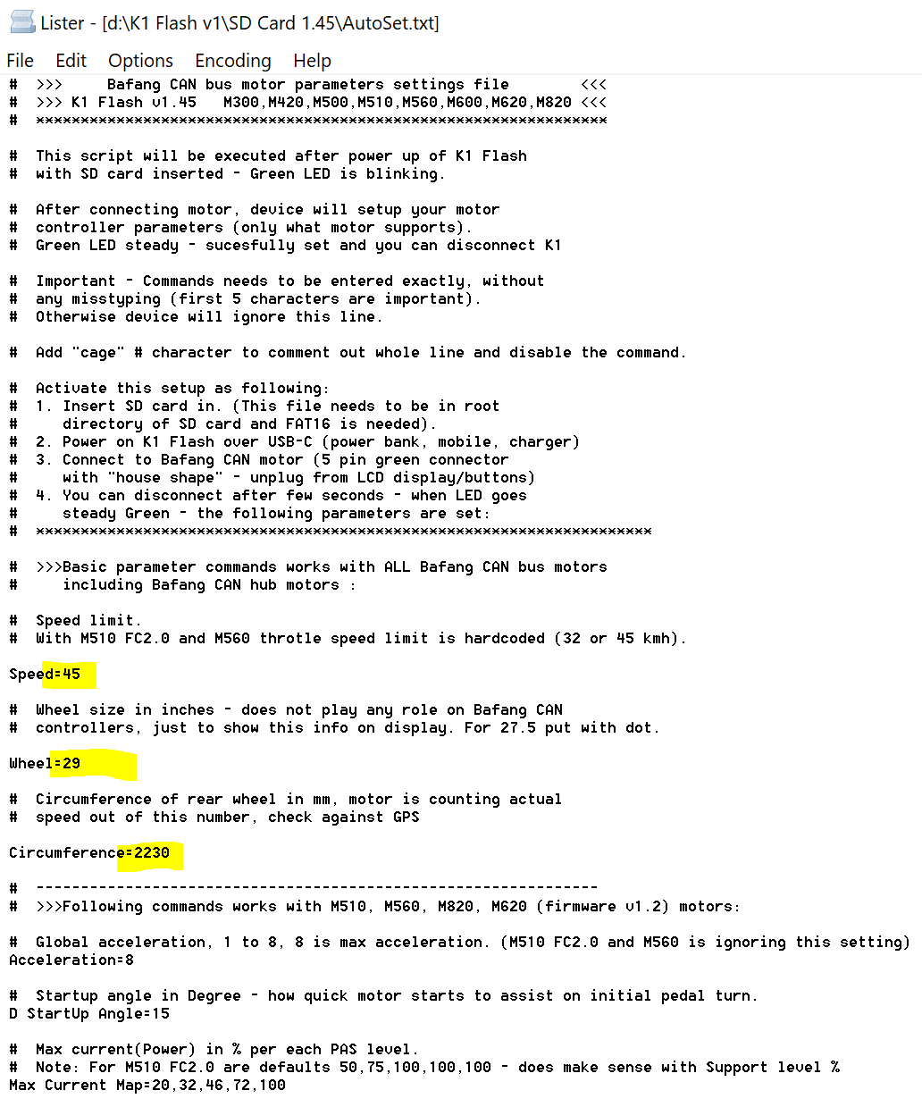

Of course you can set any speed limit, just by editing AutoSet.txt file on SD card:

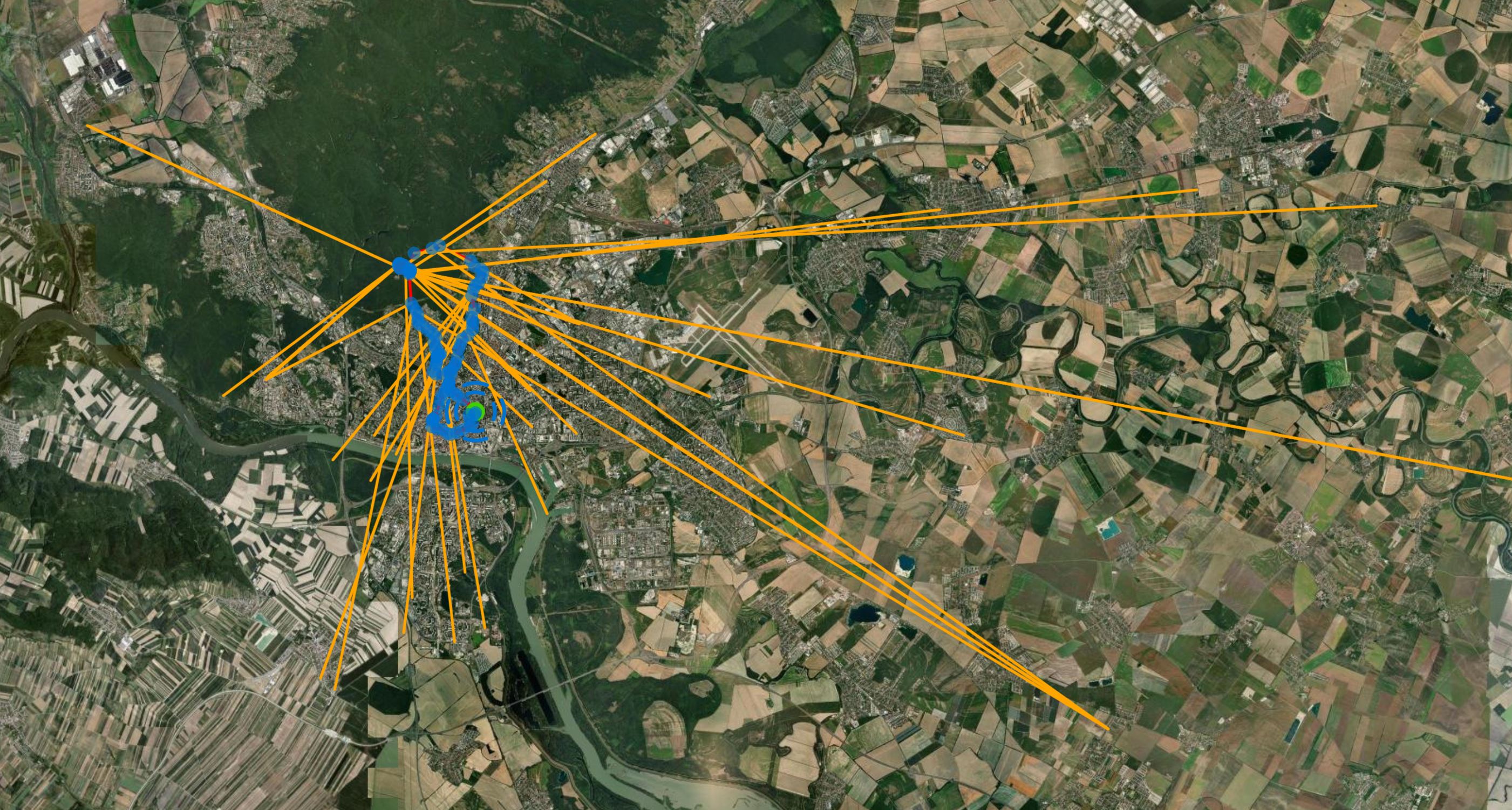

Working on a GPS Tracker over IOT Helium network - K1 Chirp Tracker
No need to pay SIM cards. (But Helium and servers also cost something)

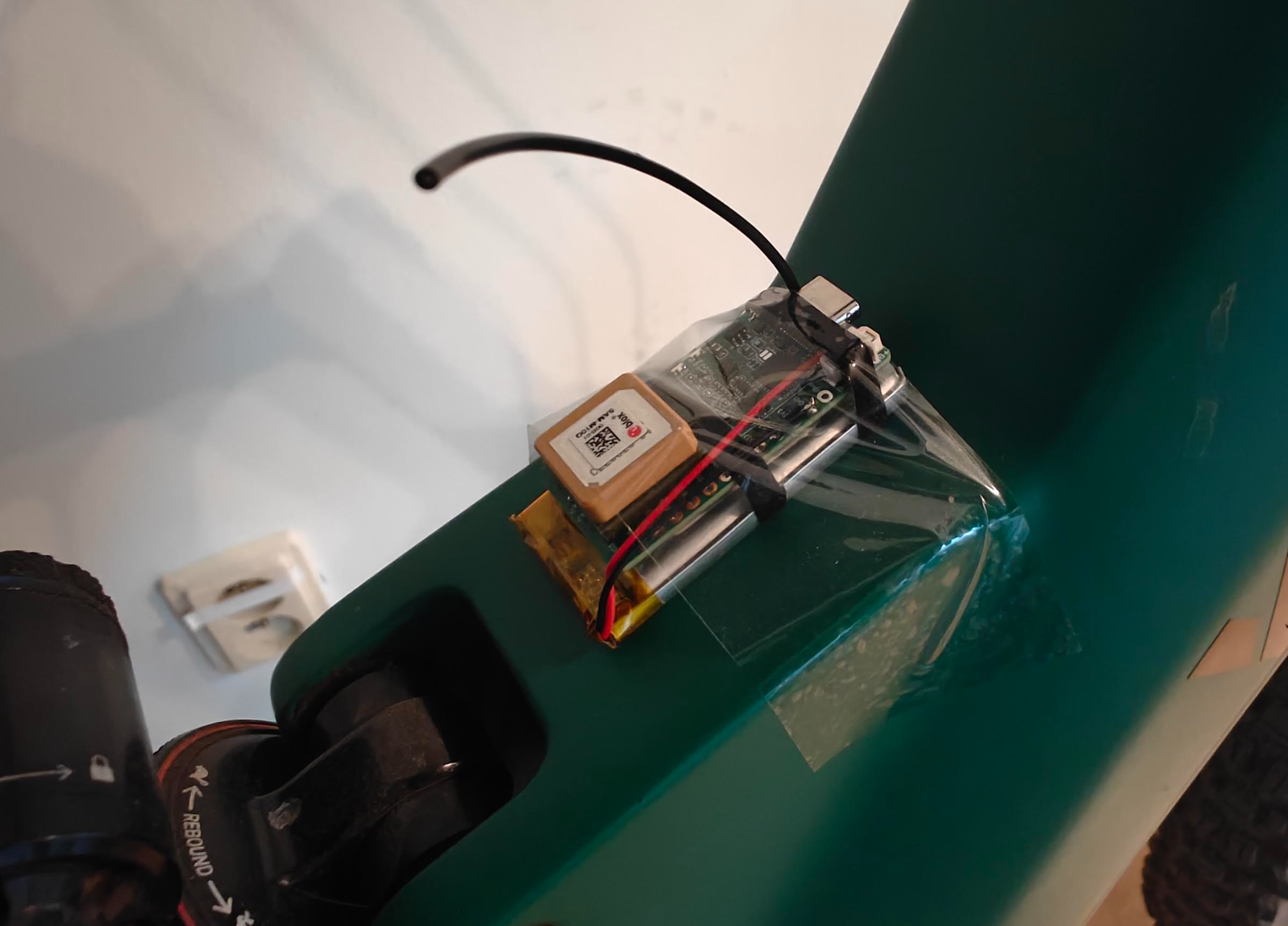

4th prototype works as a charm. Note that professional holder. ;)

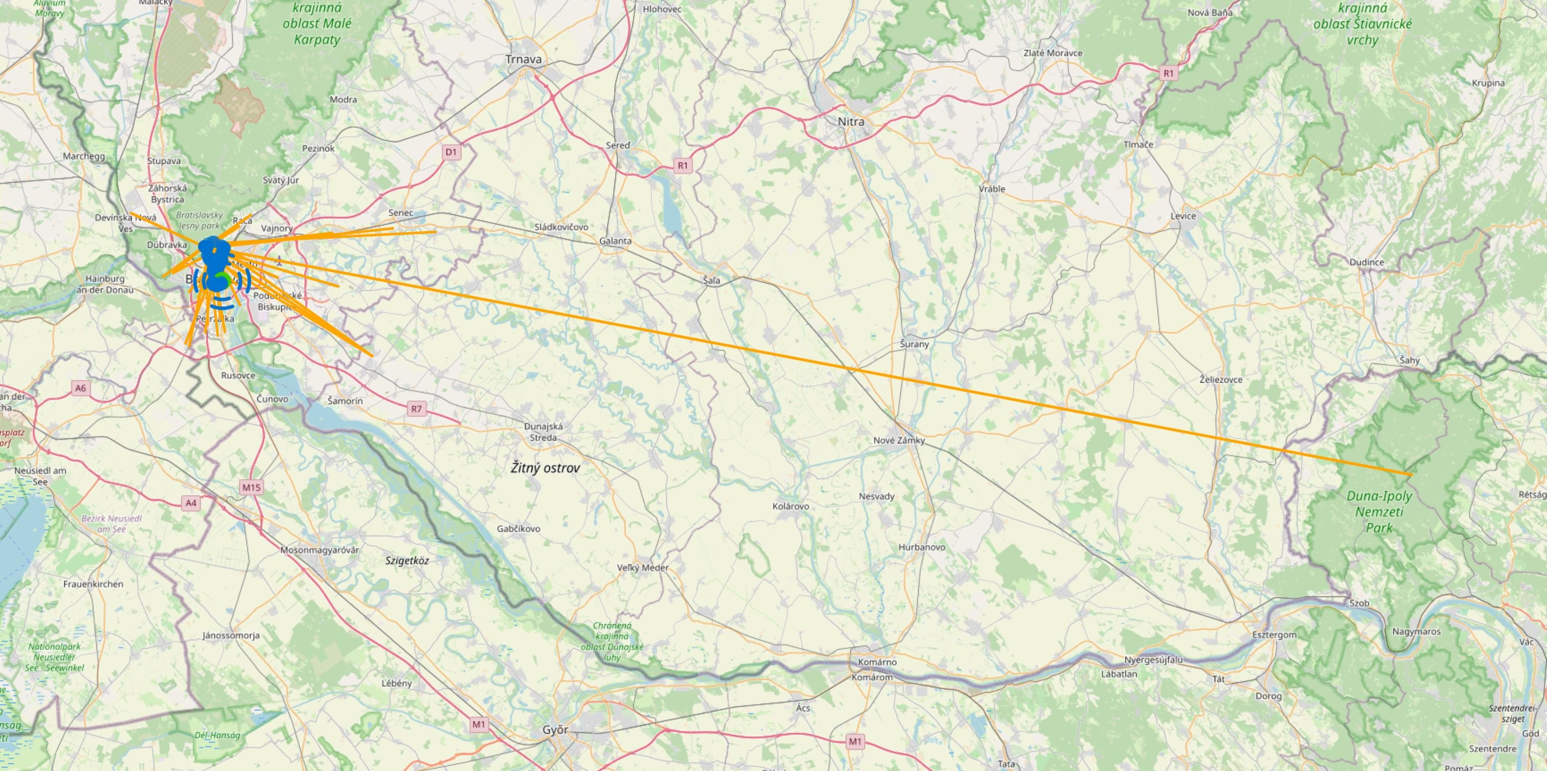

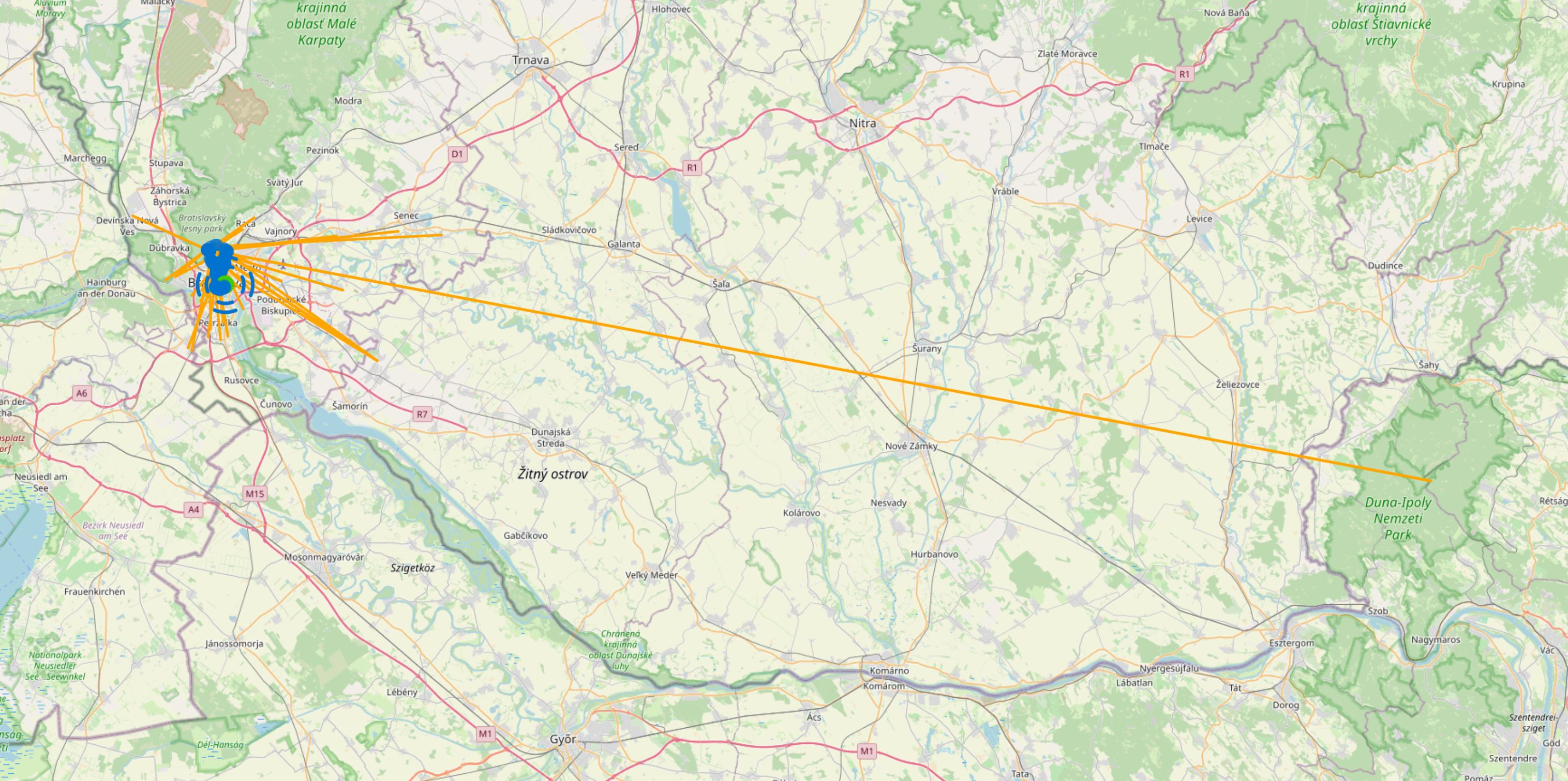

I am even surprised to reach 140km over LoRa (long orange line in a map). Over a piece of cable you see in a picture.
I am calling this spider web - where is Helium Access Point which is catching you.

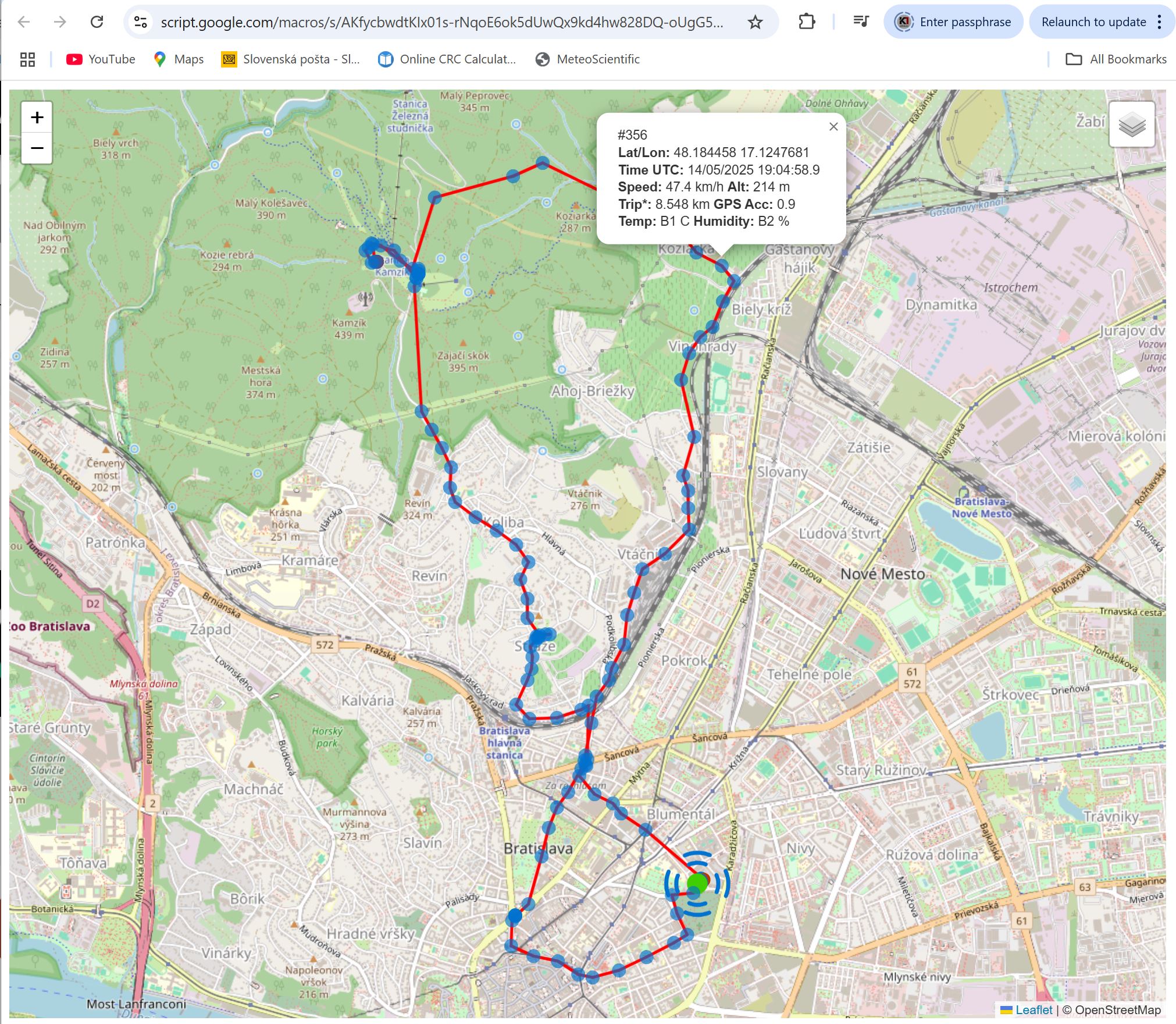

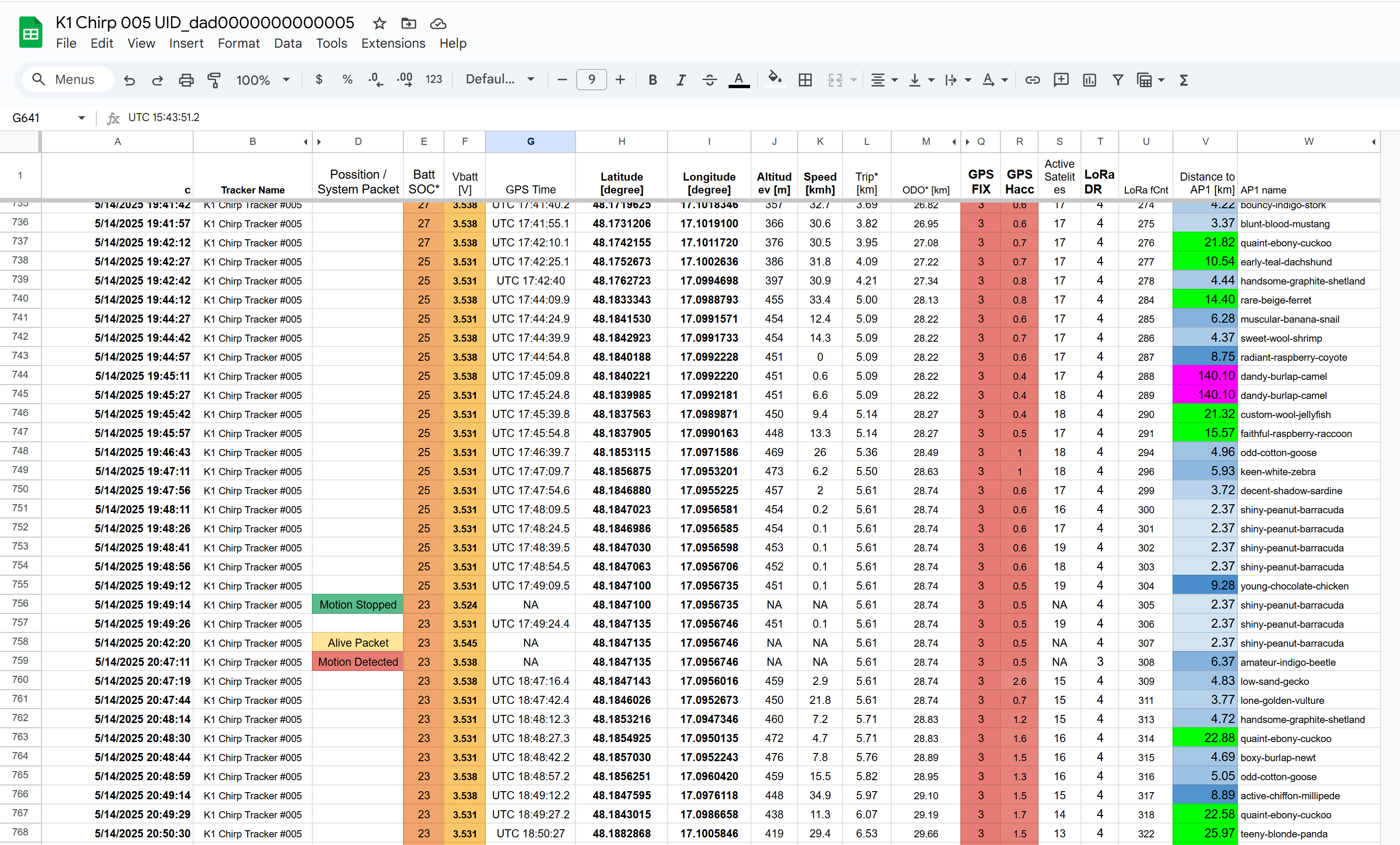

Real time data in a shared excel, so you can read data from here. Or I can do html PUSH for further data gathering and processing.

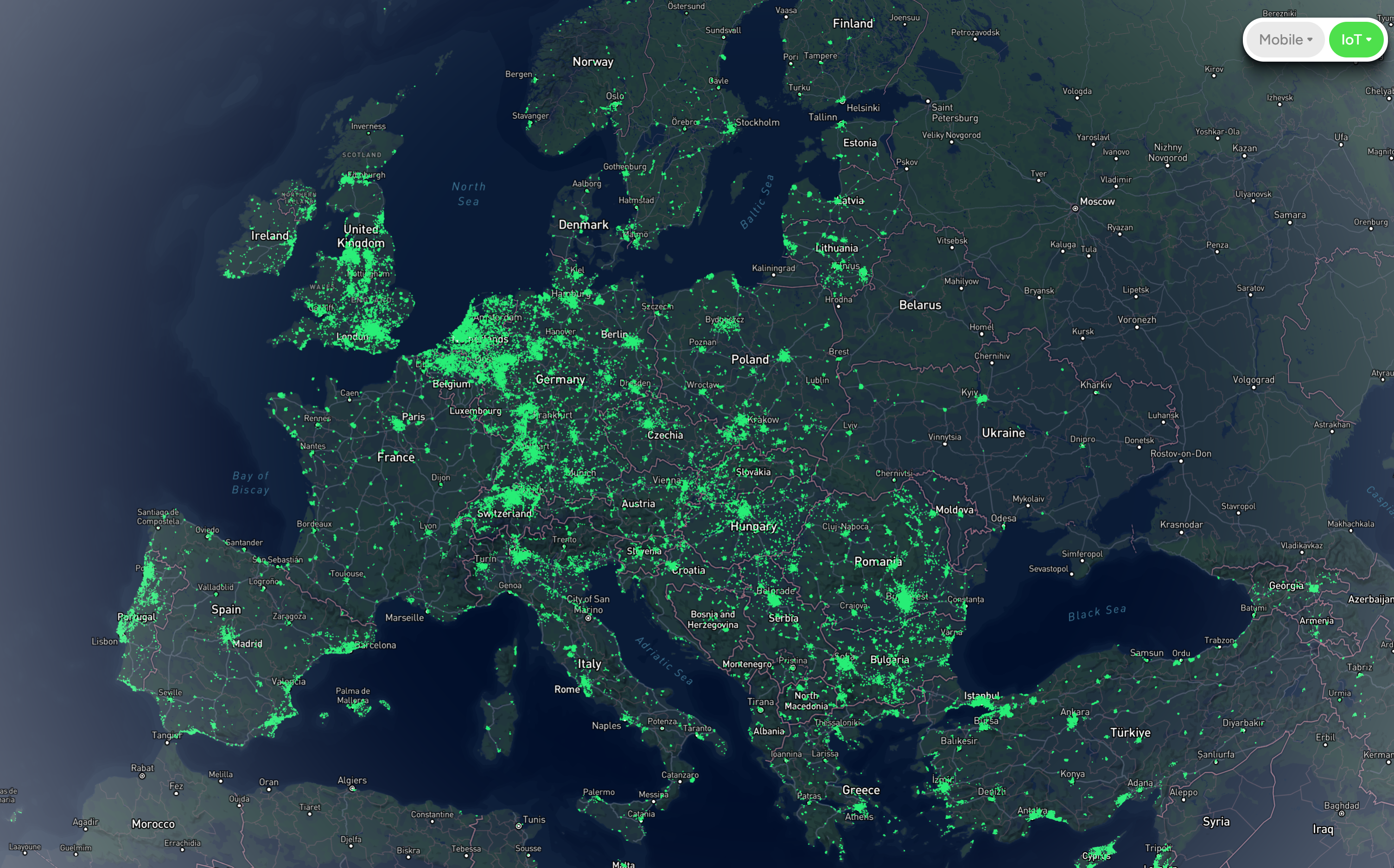

Of course, when I hide antenna inside a case, close to electronics and battery, there will be lot of loss. In populated areas we should be fine and should get the reception. Check Helium IOT map: Helium World
Let me know if somebody would be interested. It is not easy to go into such a project.
For my personal use it is ok even in this beta state (I started with this long time ago, just as I was curious about Helium network).
I have lot of ideas for further improvements and wanna come up to a bike rear flash light with Chirp tracker. (yes, will be expensive rear flash light ;) ) There could be lot of use cases. Will add also external Temperature and Humidity sensor.
Also can offer as a modul for DYI guys. (ESP32 S3, Lora, GPS ublox M10Q , g-Meter, Charging, CP2102 USB driver, simple battery V-meter - so wont be cheap unfortunately)
Ich habe zufällig eine M630-Firmware erhalten. Ich kann sie nicht testen, da ich keinen M630-Motor habe.
Wenn jemand K1 Flash mit M630 testen möchte, bieten wir 30 % Rabatt auf K1 Flash.
Ich habe diese Firmware auf M560 geflasht und der Motor gestartet, außerdem habe ich alle Einstellungen vorgenommen. 48 V, 40 A, das wird ein Kettentrenner. ;)) Das sind ca. 1,6 kW Spitzenleistung an einem Rad.
Wtf how long does an m560 controller with 40 amps last... M560 can also do 60 volts peak.
It is not working in M560 motor, I guess different MOSFET driver. But motor boots up. In M630 is same microcontroller chip, but different HW around.
