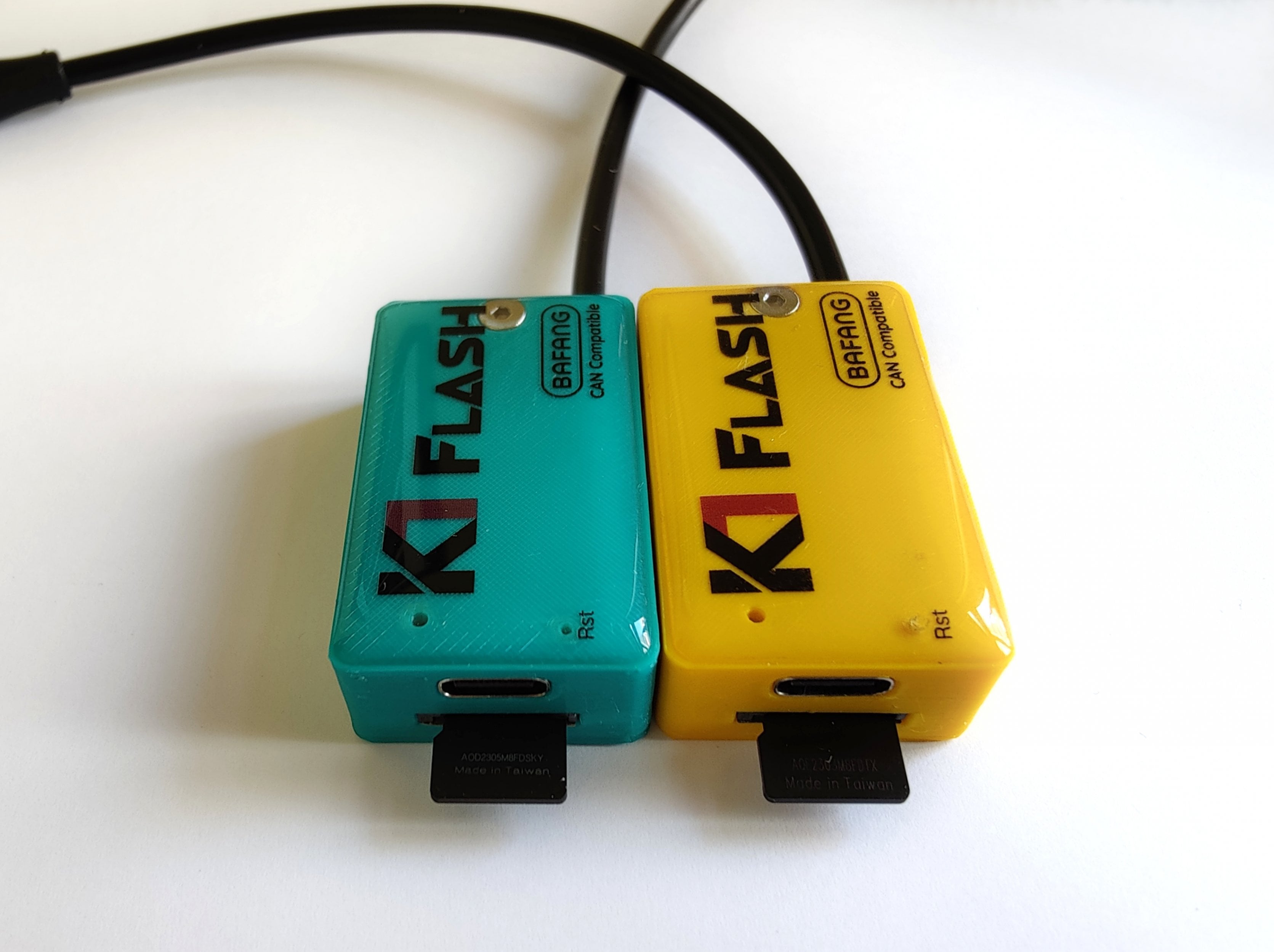

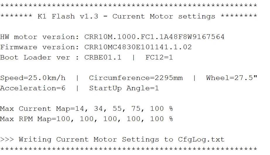

Dear Bafang ebikers

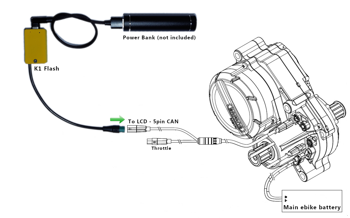

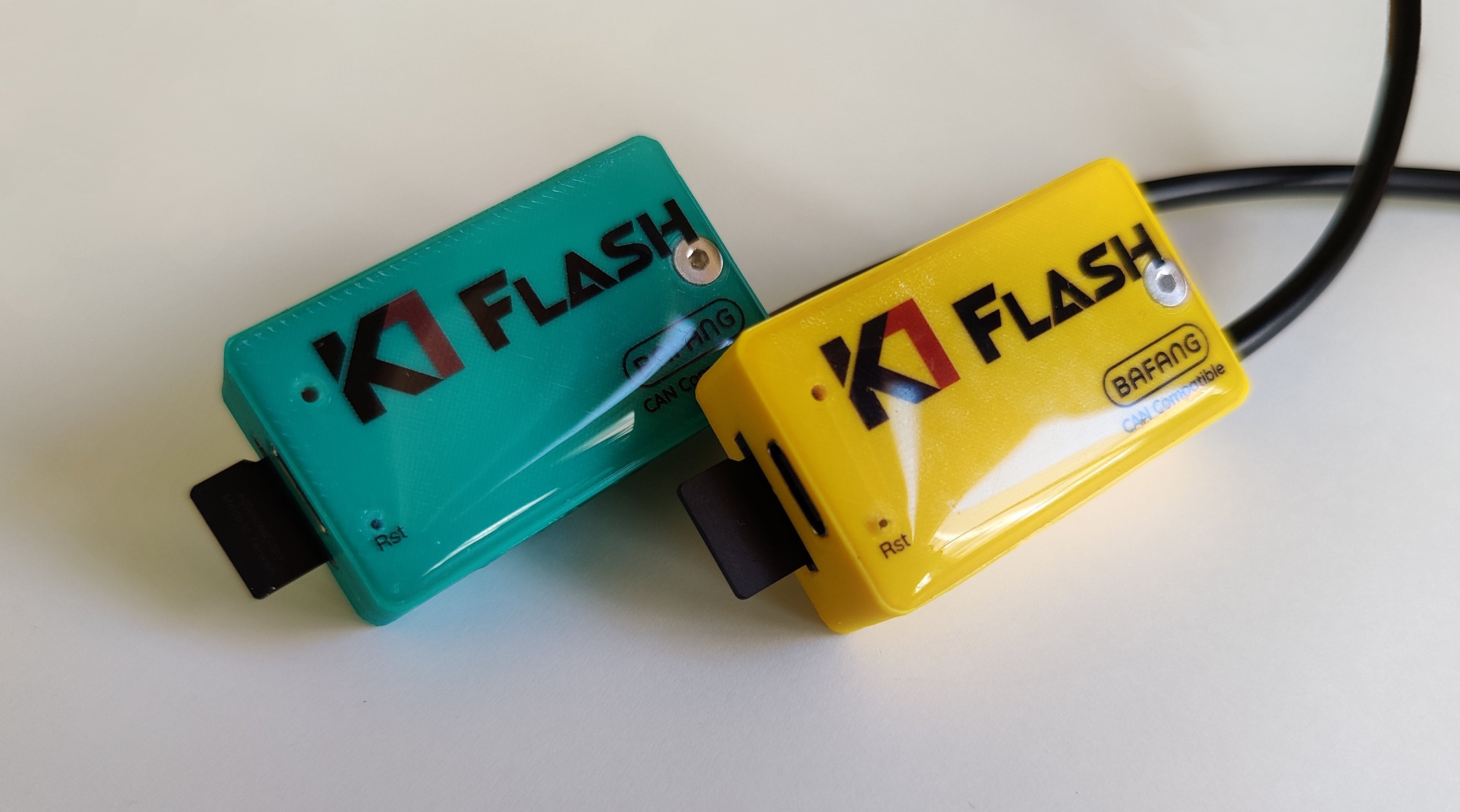

Would you like to set or tune motor controller parameters? K1 Flash is compatible with all Bafang CAN bus motors (5 pin "house " shape connector to LCD).
Also can update motor firmware for M500, M510, M560, M600, M620, M820 motors and run rotor Calibration.
Simple as 1, 2 ,3 ...
1.
Insert included SD card (with set of firmwares - cca 50 firmwares)
2. Power up K1 Flash (over USB-C cable from your mobile, power bank, charger ...)
3. Connect to your CAN motor - steady green LED light means all set and you can unplug device
In a minute your motor is flashed and parameters set according setup text file on SD card.
More info, pictures, videos and ordering info at: www.k1ebikes.com/k1flash
Tested on M500, M600 rev.A and B, M510 FC1.0 and FC2.x, M560, M620, M820, M400, M420, M300
Speed unlock, Circumference and Wheel size supported by all Bafang CAN motors, including CAN hub motors.
Ebikes brands: CTM, Kellys, Dema, Crussis, Leader Fox, Pells, MTF, Dengfu, Hybridizer, Vitus.
K1 Flash Lite starting from 110 Eur including shipping in EU.

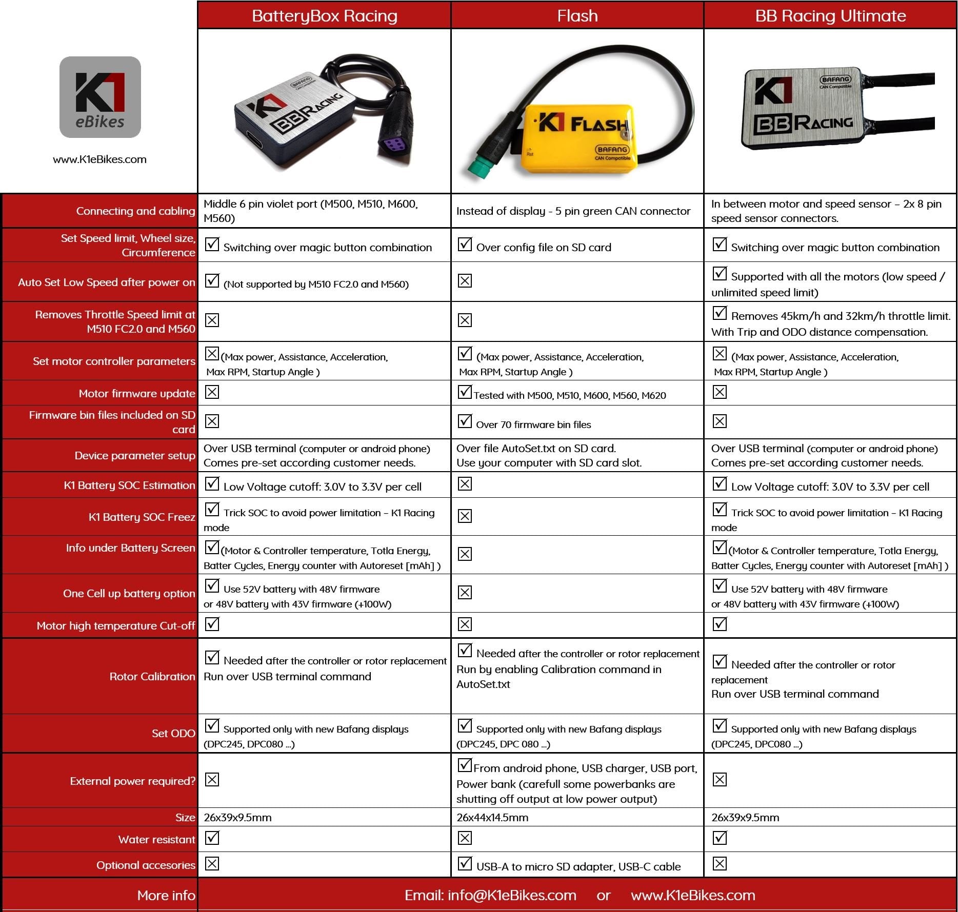

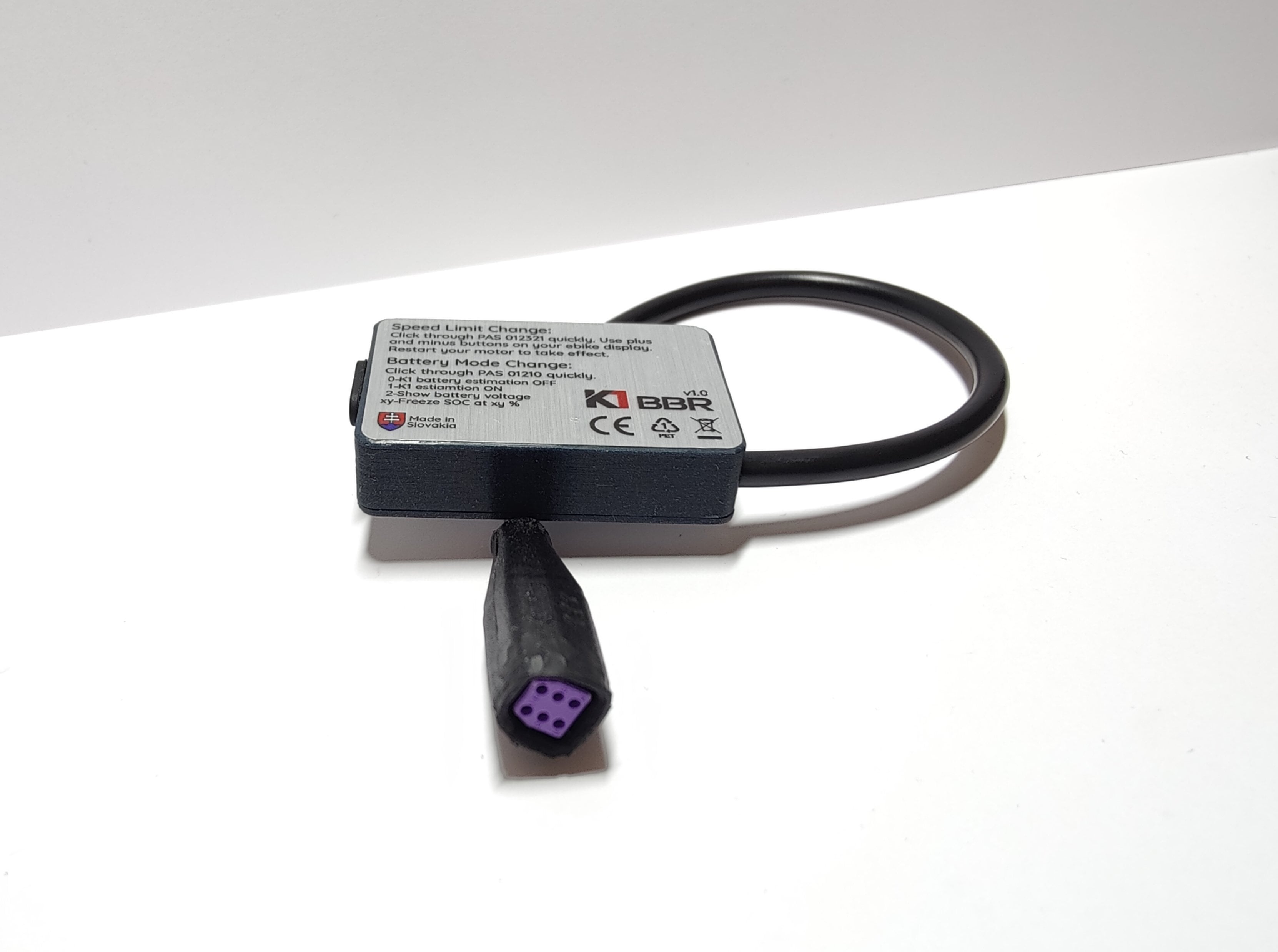

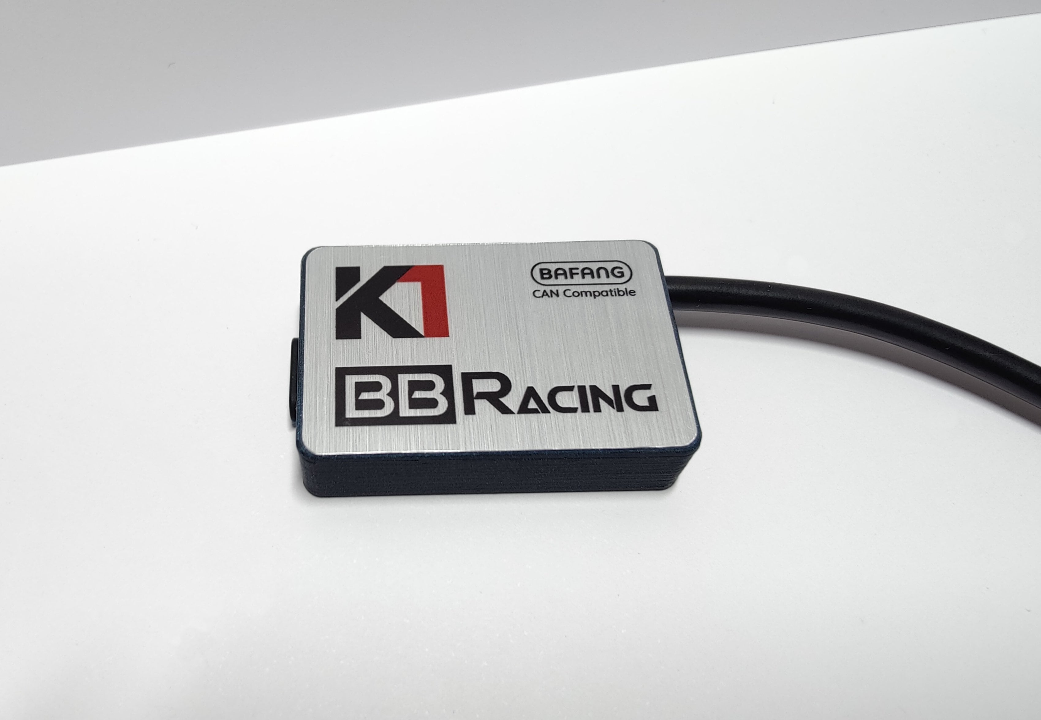

Are you not confident with power limitation at low battery SOC%?
Would you like to set lower discharge cut off voltage to get more range from your battery?
Would you like to remove throttle speed limitation?

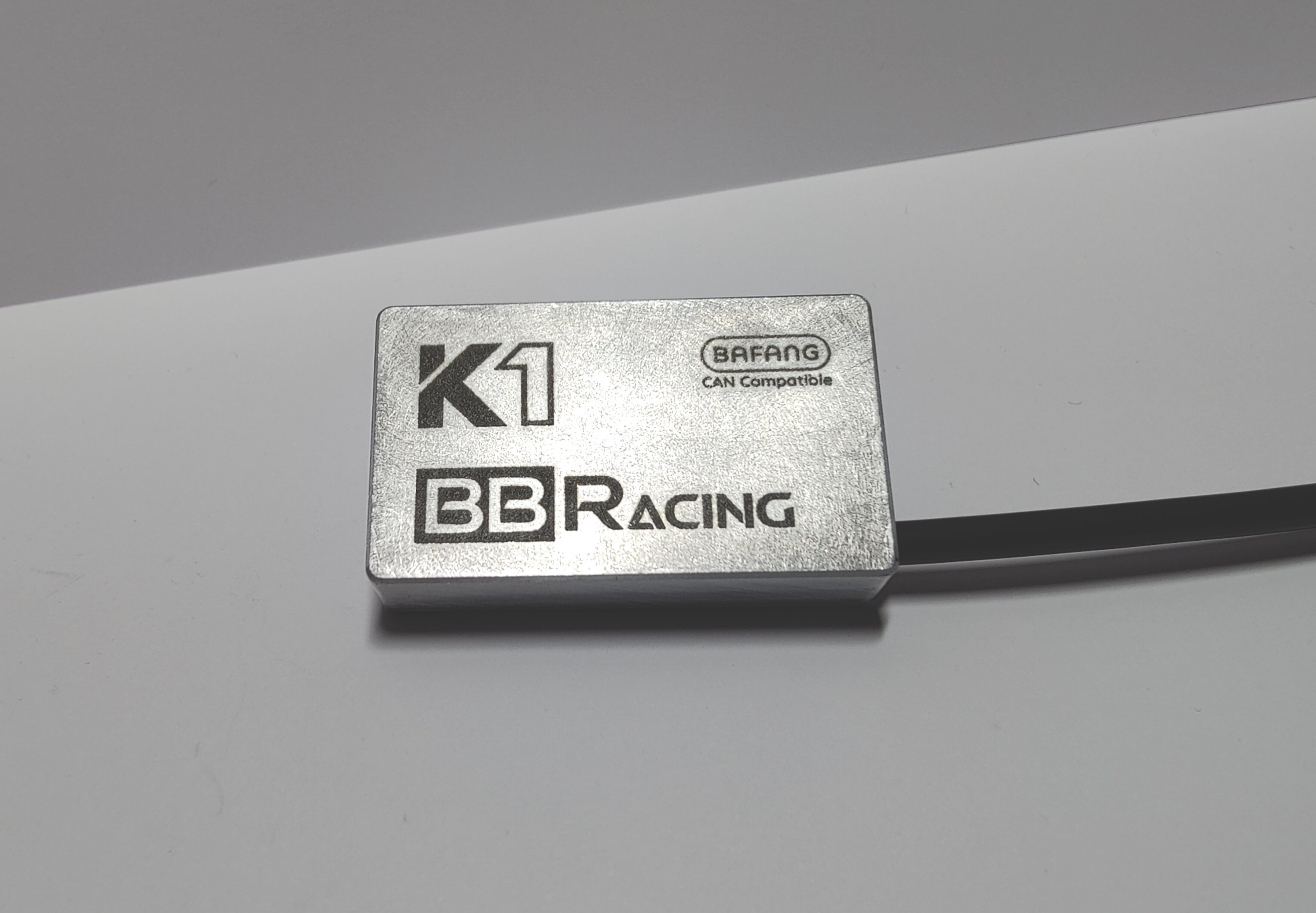

Theres a new device BB Racing, whit many new functions. You can set Low Voltage cut-off to 3.0V per cell or even lower. You can use 52V battery with 48V firmware and have accurate SOC % reading.

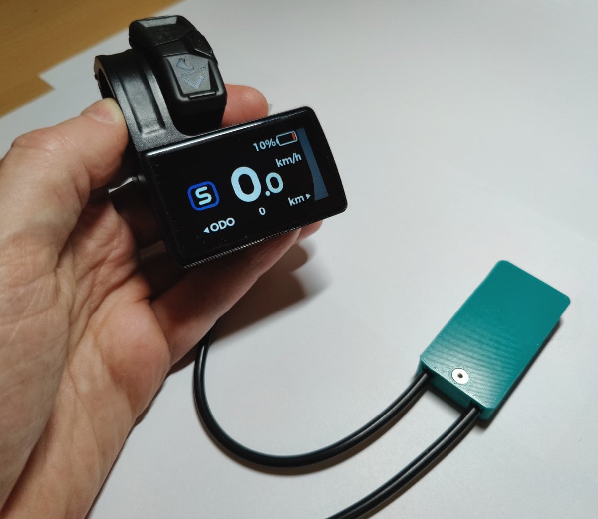

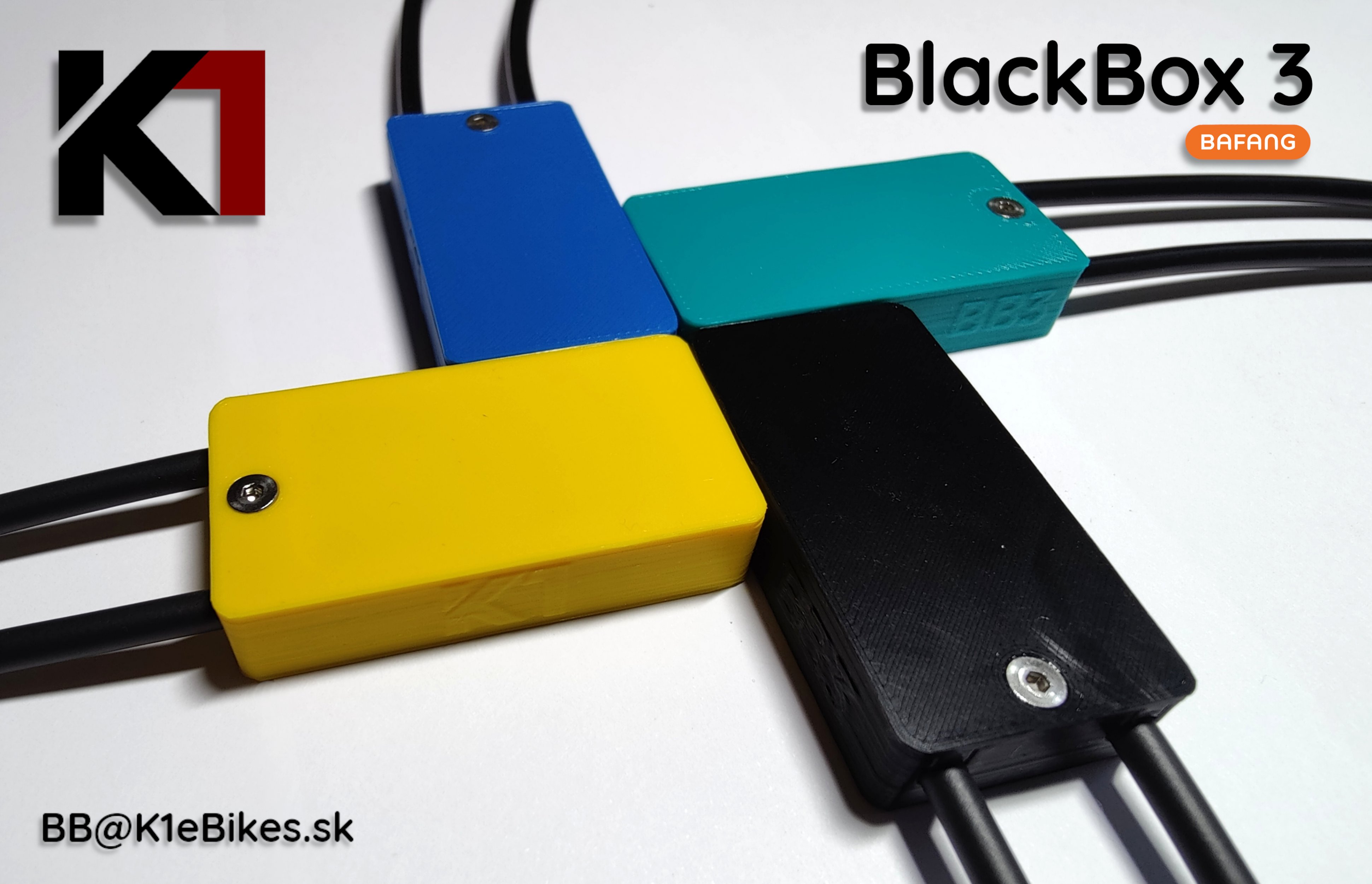

K1 BlackBox 3
We are sorry, this product is sold out.

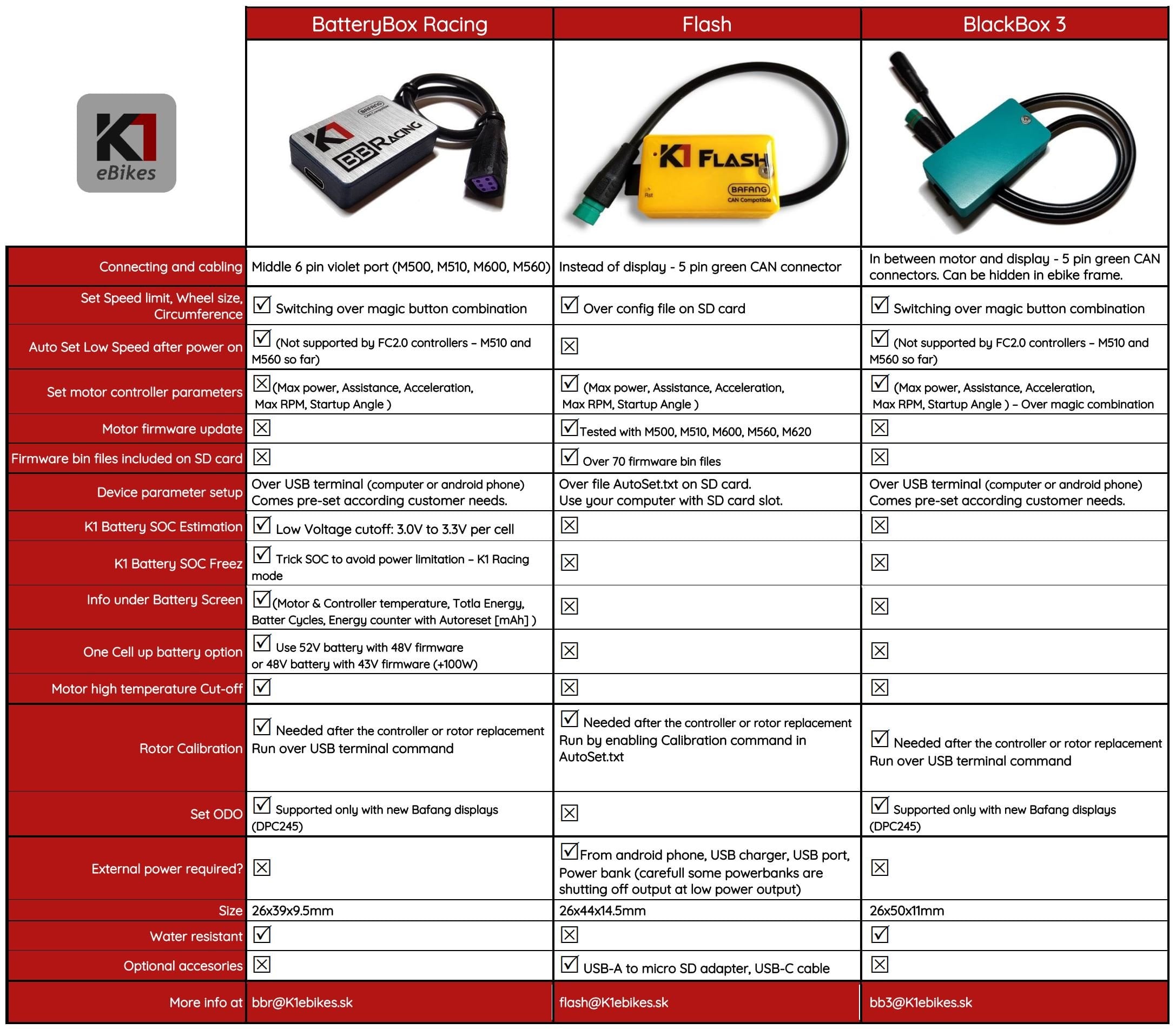

What is the difference to K1 Flash
  • BB3 is connected between motor and display. Can be plugged permanently on your ebike, or you can just set parameters and then unplug.
  • Switch speed limits and configuration parameters by holding a Plus button on your Bafang buttons
  • Is waterproof
  • Power is taken from your motor
  • No firmware flash support.
  • ASLS function

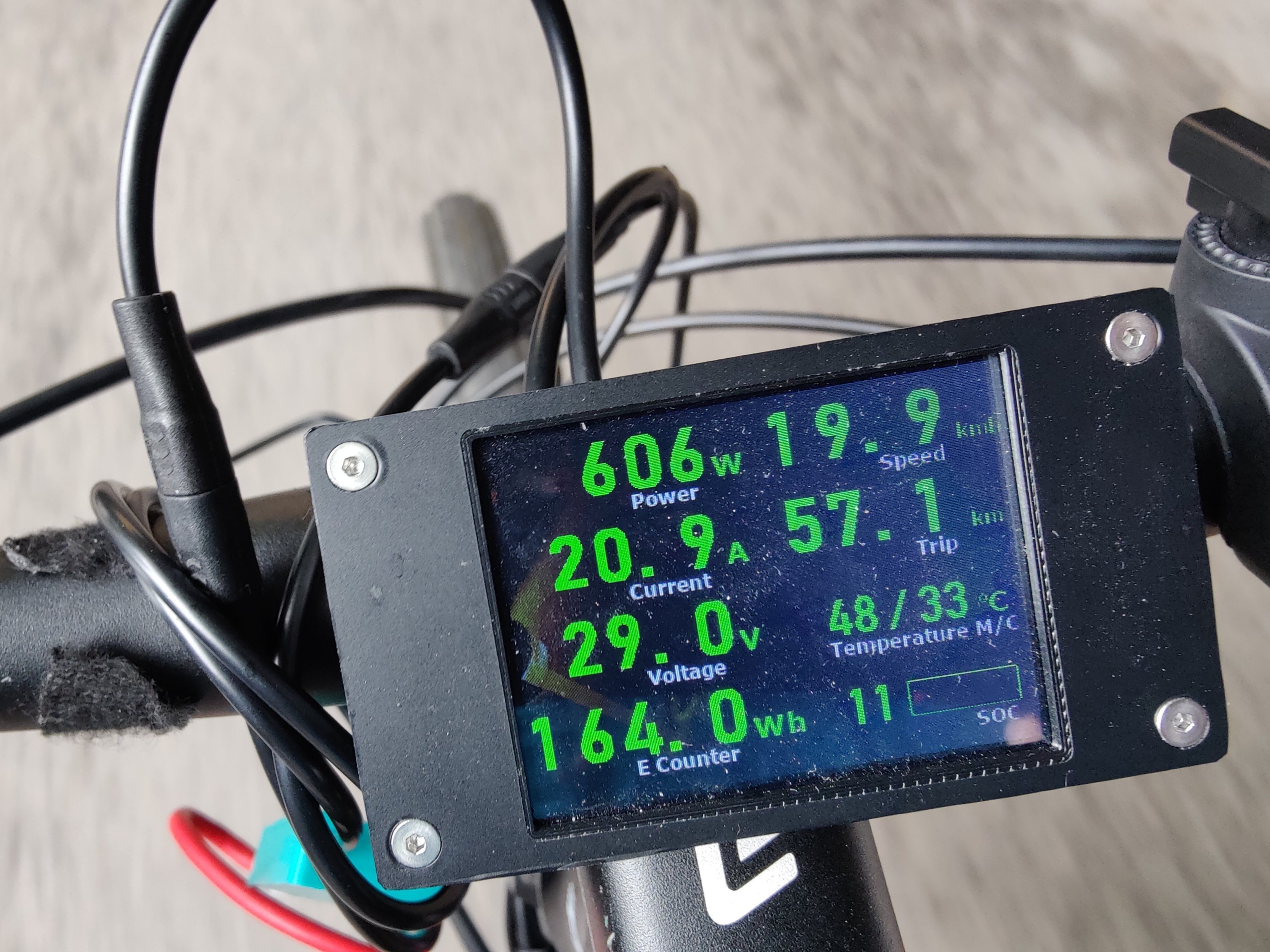

Sucking 20A at 29V ;)

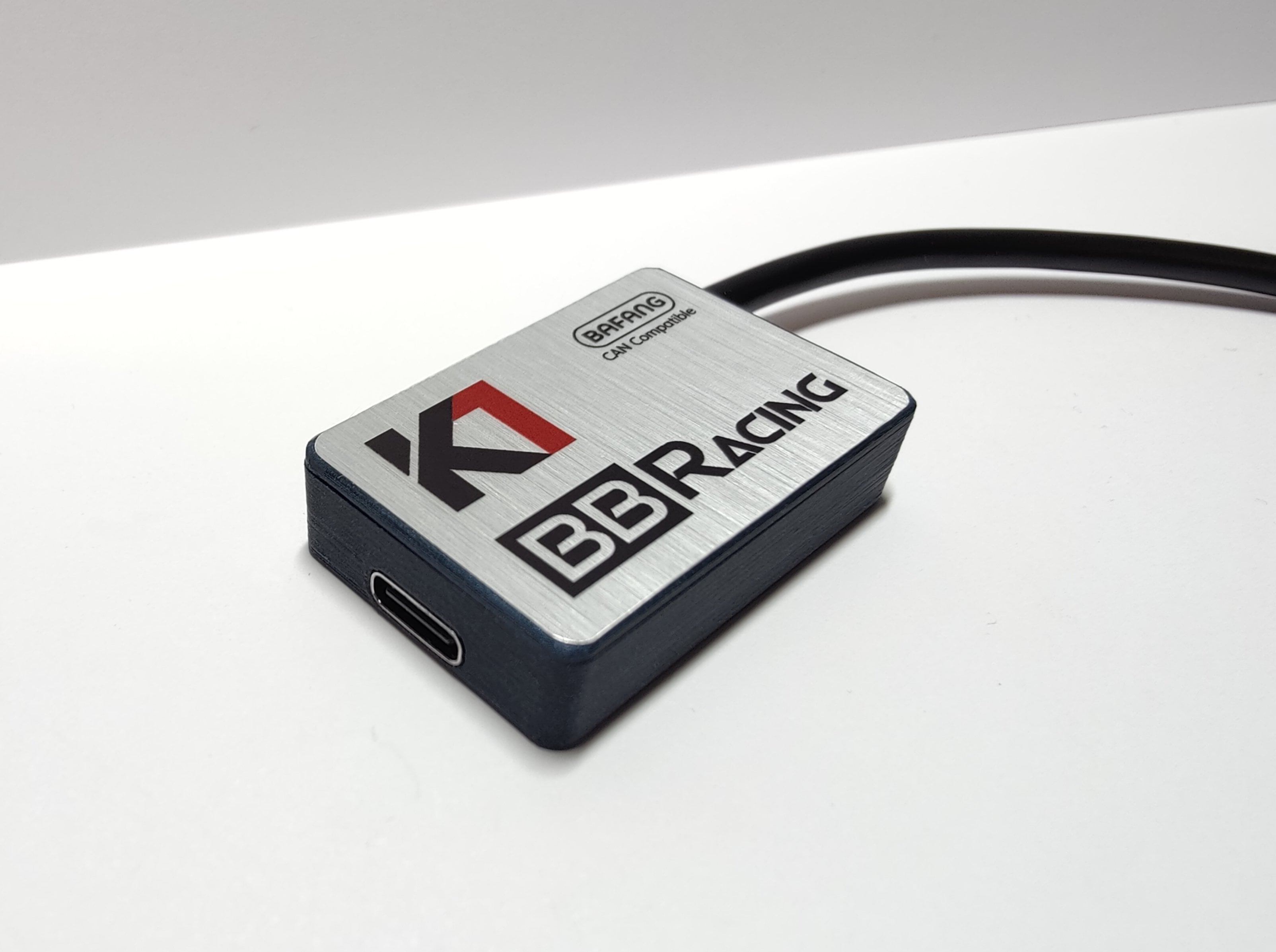

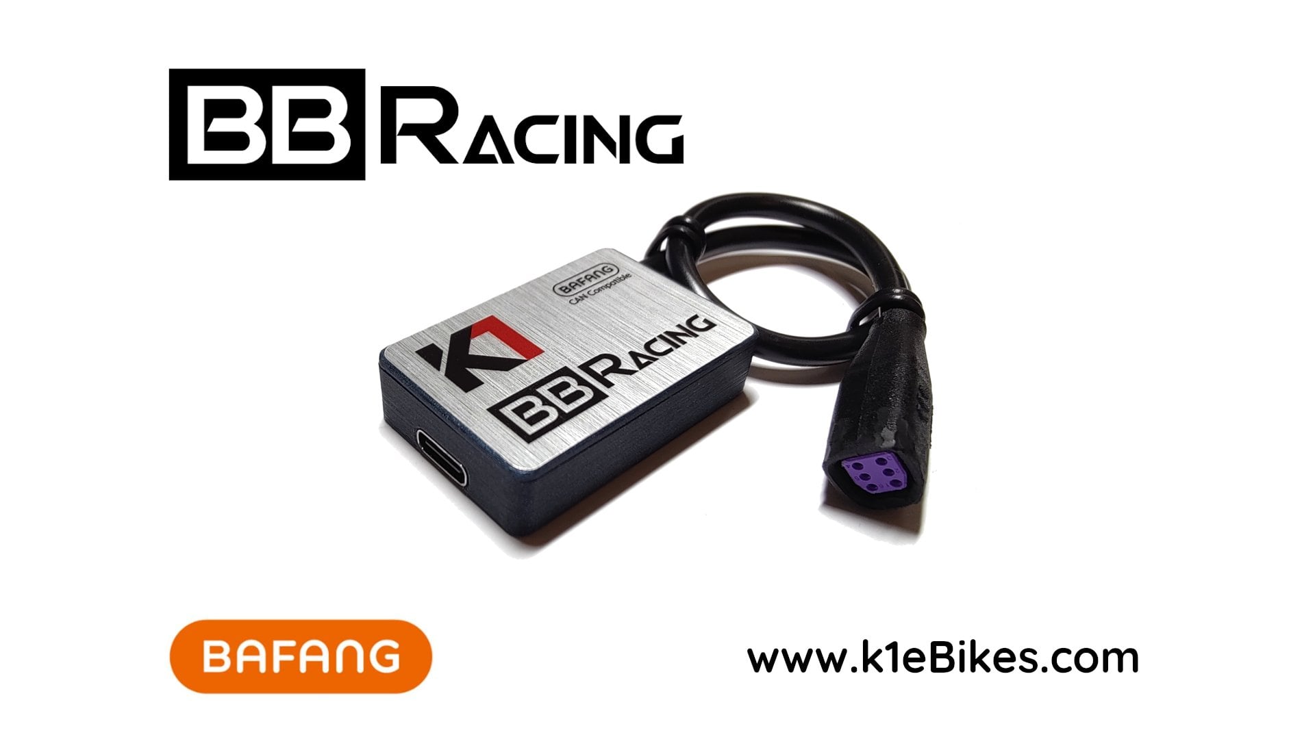

Since I swapped to CAN Bafang motors, I was concerned about power limitation (too soon - M600 from 30%, M510 FC2.0 from 25%) and about depth of discharge.

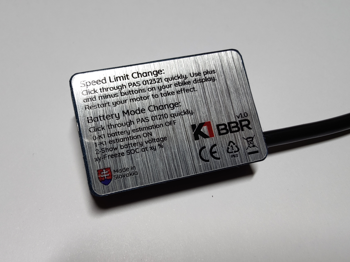

I did some tests of brand new K1 BlackBox Racing device and works as a charm. ;)
Possible to set Low Voltage Cutoff and you can discharge your battery down to 3.0 V per cell even without power limitation.
It is done with tricking the controller, not by a change of firmware, so device needs to be connected permanently to motor (over middle connector at the motor and hide next to motor).
Also you can use 52V battery with 48V firmware and you would get correct SOC percentage. (K1 SOC estimation algorithm will be upgraded if needed - not simple task to estimate correctly just from battery voltage. In cold it is very hard, when no battery temperature compensation).
Or you can use your 48V battery and flash to motor 43V firmware and you get cca 100W more.
Can show also battery Voltage at main screen (without decimals).
Device can also swap between 4 basic speed limit and circumference. (New motors - M510 FC2 and M560 - needs restart to take effect)
A video here - 43V firmware in M600 and 48V battery.
Some fake parameters: Current is motor temperature -640 means 64 degree C
MNT - total energy consumption in Ah
LNT - Energy counter in mAh, is resetting automatically after full battery charge.
Cell - Battery in use (10 - 36V, 12 - 43V, 13 - 48V, 14- 52V)
Hi Dano
I have 3 motors M500, M510 & M820, will K1 Flash work on all 3 motors and what advantages will I have over the Beest tool.
Do you offer a after Sales help?
I‘m pretty savvy with the mechanical and electrical stuff but clueless on the programming.
Thanks
Hello Goff.
Yes, will work with all 3 motors. M500 does not support much to set - only speed limit, wheel size and circumference though. But you can flash 17A firmware (if you dont have already) and you will feel significant more power.
K1 Flash is simple and user friendly, just connect to motor and wait few seconds for green steady light. No need passwords (which are expiring in Besst), no speed limit restriction (with current Besst you can set only 25kmh in EU or you need to hassle with python workarounds). And comes with set of firmwares (over 60 firmwares). Can run also rotor calibration.
Can not set old UART motors (but here it is cheap solution for 5 Eur with usb to uart convertor). And can not flash firmware to displays - but this is not much important, did not experience any issues with CAN displays.
Yes, you will get also after sale profesional support. Have 10y experience with Bafangs and did lot of troubleshooting with customers. Will provide you explanations, how bafang motors works, what is possible and what is not. :) I am fair and replaying in 24h usually. I am racing in marathon open category and tunning motors for higher power. Riding now 2kW Bafang Innotrance ebike, also 3.5kW LMX and looking forward for new M560 - what continous power it can stand. :)
Now working on "faking" battery device K1 BBR, which will allow deeper discharge and also remove power limitation - which was big drawback with non original CAN bus batteries. Also will be able to swap between 4 speed limits (25, 32, 45, 65kmh), calibration. Should be out soon. Later maybe also BT support for parameter settings of BBR.
Check the product link for thanks email. :)

BB Racing is A MUST HAVE for any M500/M600 owner. I am so happy of it. The speed limit adjustment is only one thing, but the best part is about the battery.
Now i can use my favorite super strong 46.7 M600 firmware and i can override stupid 30% power limit on battery.
BB Racing can override this and can get you extra kilometers that you may safely use from the battery.
If you guys are thinking about what you can get for your Bafang engines - then do not think much - get the BB Racing from @Dado (y)
