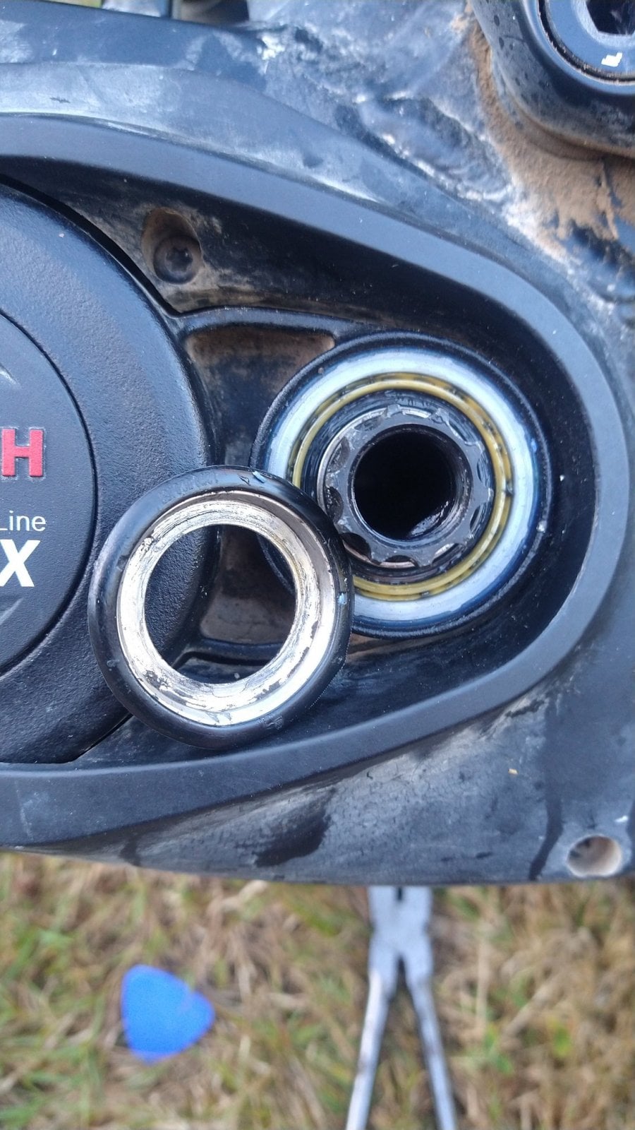

Thing I've learned about Bosch motors & water. The case is well sealed, you can forget about water ingress through the case or the connections, those things are very well engineered indeed. Your biggest risk is via the cranks. Last week I changed the bearing cover seals on my motor, doing this comes strongly recommended from @Bearing Man to prolong the life of your motor.
Having done so, it's obvious to me how this benefits the motor. The cover seals are tight fitting with (if you do it right) a protective layer of thick grease behind them, adding a further layer of protection against water. If you were sufficiently motivated, you would remove the cranks & find some kind of cap that fits over the crankshaft & wash away to your hearts content. I doubt hardly anyone would go to these lengths but after seeing the design up close, I'm happy that with regular grease top ups & cover seal renewal, there is no reason not to clean a Bosch ebike although I'd still avoid a jet wash at all costs & keep water round the motor to an absolute minimum.
