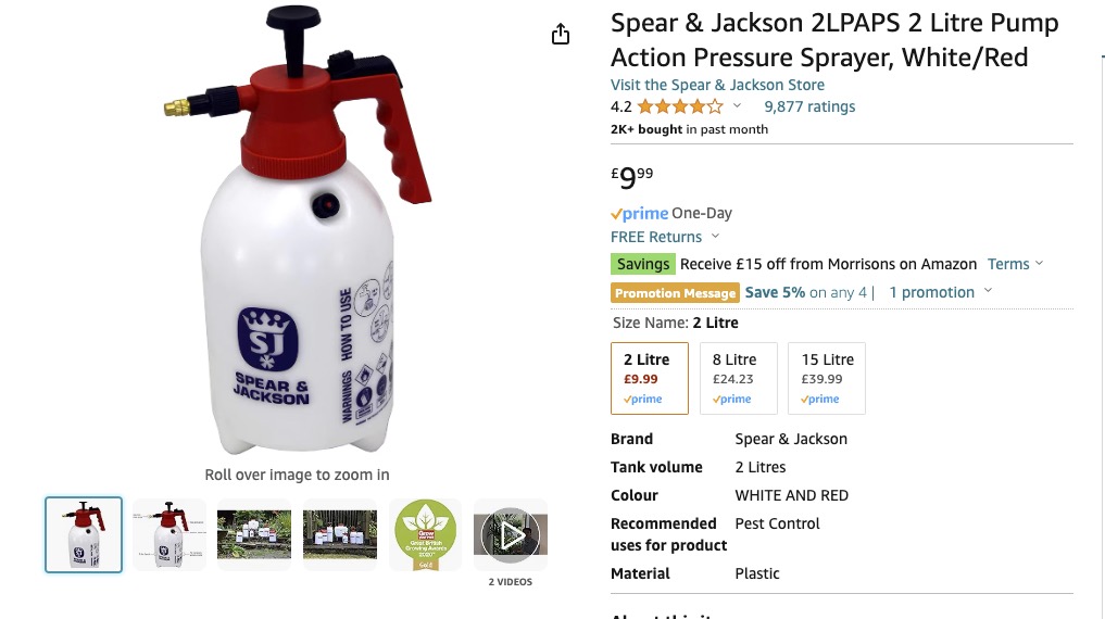

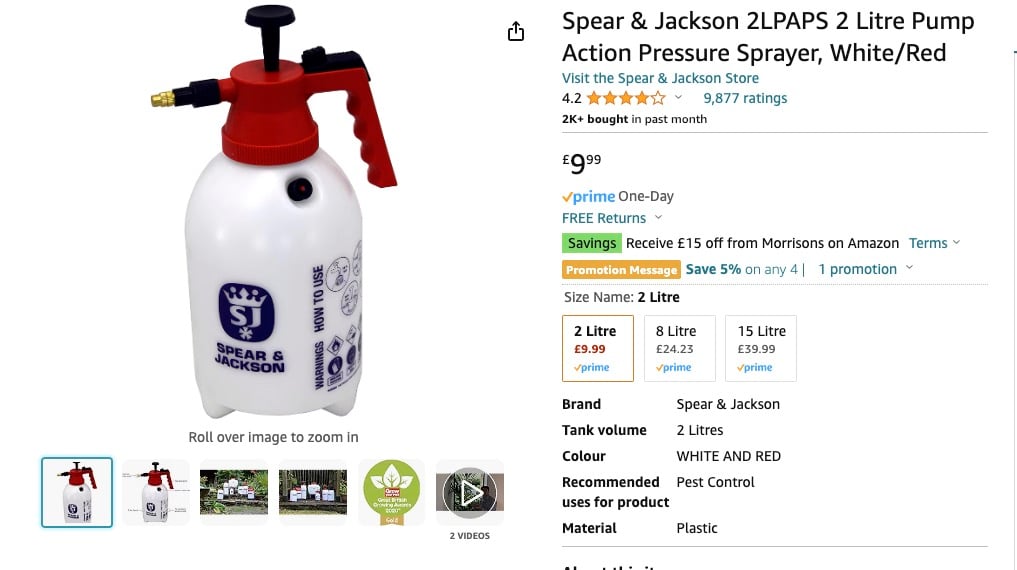

Might have to give some of this a try and see how it compares with MucOff. I'm probably about £5 per litre of MucOff.
I was tempted to put the MucOff into one of those pump and spray bottles as it'd be easier / quicker to apply than the current trigger spray bottle it's in!
I did that with the stuff I clean my car wheels with - and then thought, why didn't I think of this sooner!!

Is this a foaming sprayer or a regular one? It looks like a regular sprayer. I've found some videos of people hacking these into foaming sprayers, which makes them more effective.
