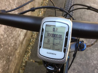

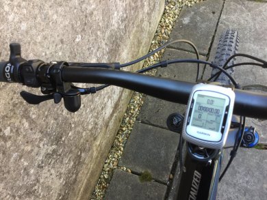

Hi I use my Garmin 500, works well. The speed is just GPS, cadence comes from the Levo and the power although not showing at the moment is via the fake channel on the Mission control app along with the 2018 remote I never have to look down at the meter on the side. Don’t really need anything more.
