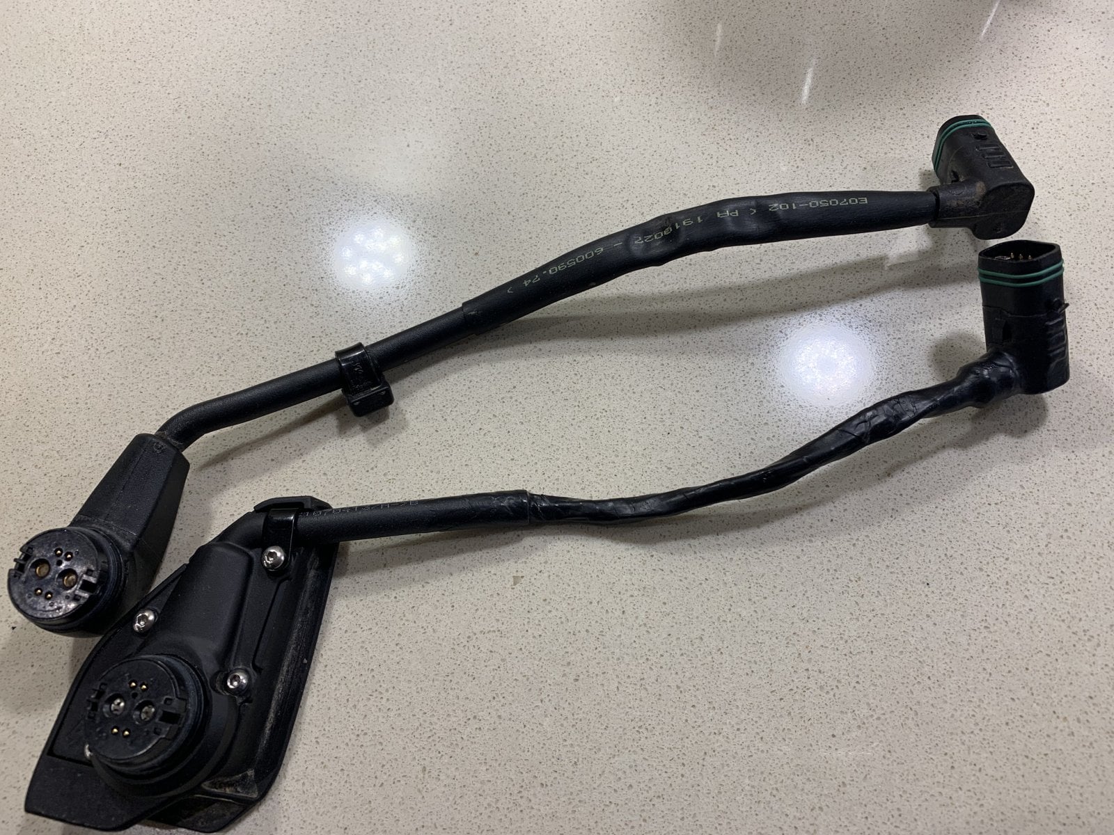

Internal Power Cable Failure, Levo 2019
Seems to be an issue only with the newer 90° connectors. Does beg the question, why the change to the new and then unproven, now proven dubious connector in the first place?
Looks like a version 3 is needed, with a more durable 90 degree connector shroud, and better sealing from water ingress. Fingers crossed something will come soon :unsure:

Weirdly enough, it's never the magnetic end of the lead that fails, in my experience it's always the the motor end of the lead.
If Specialized are suggesting otherwise they still are not getting it.

I had the motor cover off yesterday and just before putting it back on i noticed the dreaded exposed wiring peaking through on the motor side plug. I was tempted to put a dab of liquid electrical tape on it. It does look like there is stress placed on the plug from too tight a turn of the cable
How old is your bike, take any pics?
The pos and neg wires are pretty heavy duty. I wonder if the cable becomes even stiffer with colder temperatures. I would definitely seal that split with a suitable tape and get a new cable fitted as soon as possible. If you get any water ingress inside the motor cover through riding in wet conditions or washing you are likely to get a fault otherwise.
mine is a 2019 with about a year of use ,2k miles. I didn't snap a pic but the tear in the sheathing is just beginning, hopefully when it fails it will be intermittent so i don't have to walk a 50 lbs anchor home. Yes i might just bite the bullet and buy a spare
Use your warranty to get a replacement.
