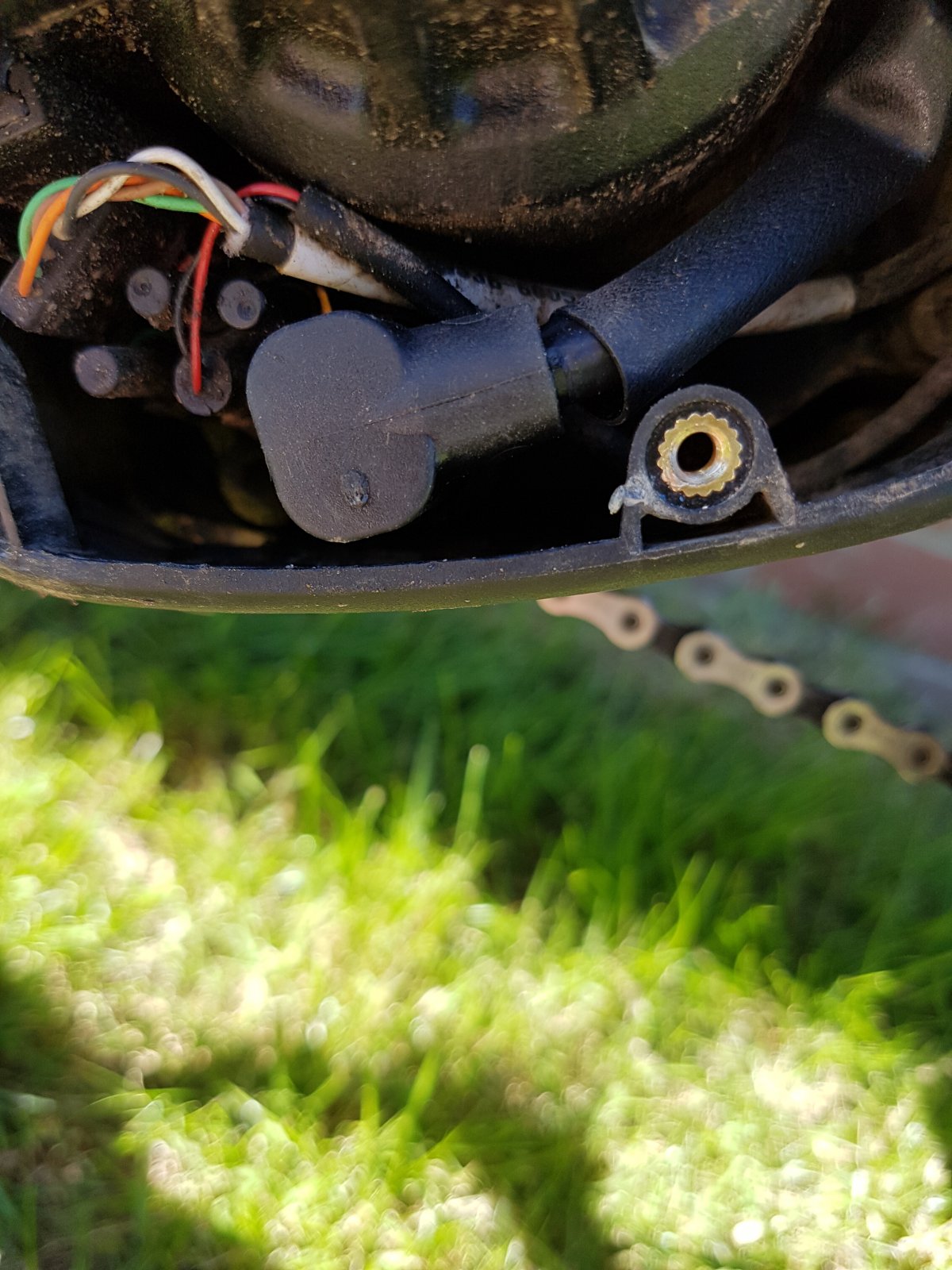

Looks like Specialized have been listening, this is the new cable fitted to my bike and it is now completely sealed ?
Maastricht
Oct 3, 2018
646
655
M
Looks like Specialized have been listening, this is the new cable fitted to my bike and it is now completely sealed ? View attachment 13764
I think this is the current design compare the design for example too an earlier post:
Internal Power Cable Failure, Levo 2019 - EMTB Forums
If yuo look closely to the picture of the link above you will see the connector is cracked. This is exactly the same issue which I had. I didn't have issues due to the crack but the cable was replaced as a precaution. Specialized is still searching for another (more reliable) redesign as I have understood.

The way those various spindly little wires are routed and unshrouded really is a shame. There are so many better connectors and ways of doing this that Specz R+D should have looked at. All the junctions should be double sealed at least but inline connectors would be so much easier to fully weather/grot proof too.
jerry
Dec 22, 2018
257
165
Belgium
The way those various spindly little wires are routed and unshrouded really is a shame. There are so many better connectors and ways of doing this that Specz R+D should have looked at..
Guess it's a learning process for them as well... marrying electronics with technical stuff. I think you actually see the same in other converged manufacturing.... Tesla, for instance, is getting all electronics +/- right (power management, software, batteries, etc); but they struggle with mechanical issues that traditional car manufacturers have nailed for ages - water seals, trim alignment, for example. And the traditional manufacturers - they struggle with software, motors, etc...
