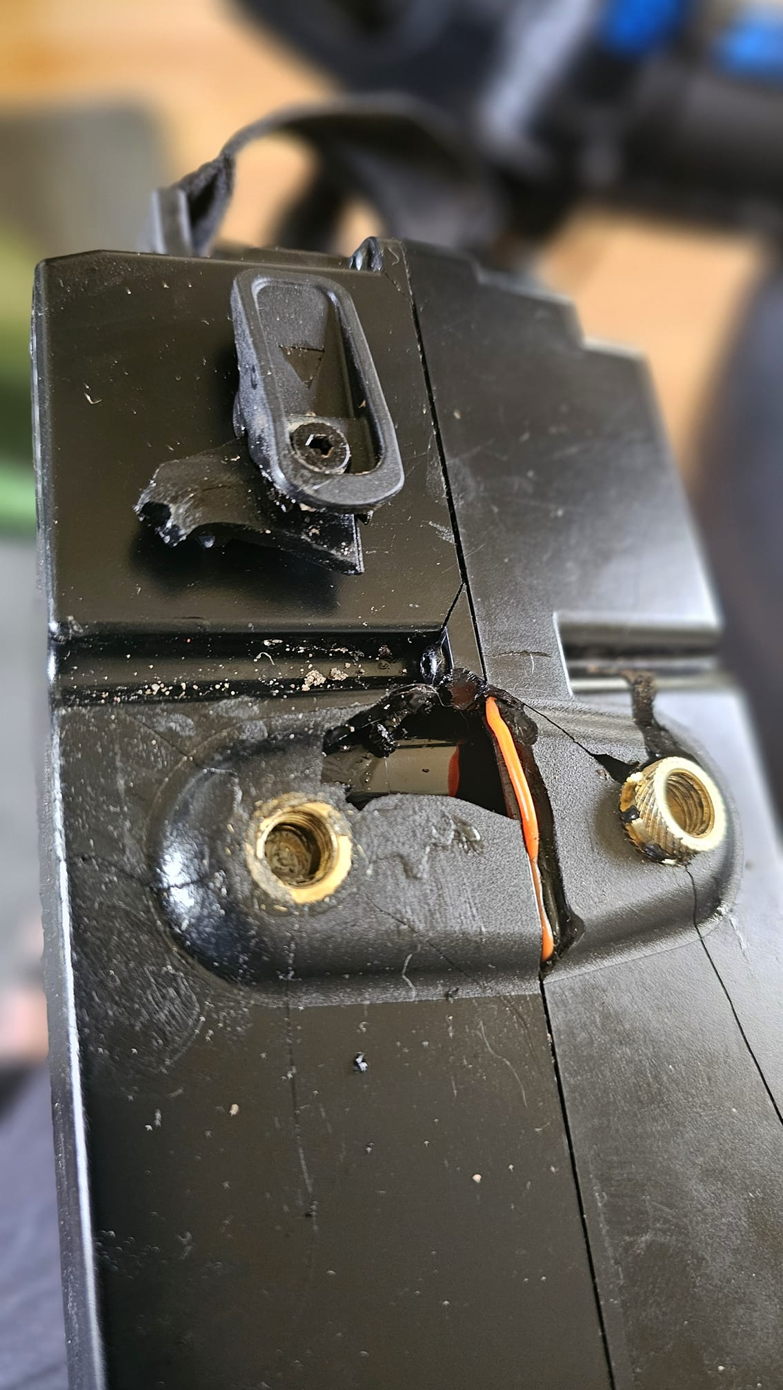

Full notice - Mandatory battery check and safety notice
Extract:
„Understanding the issue
The batteries used for our E-bikes are sourced from reputable companies and tested to meet or exceed industry standards. We have been notified that a small number of batteries may be liable to damage the housing appearing as small cracks, gaps or similar.
In rare circumstances, this could allow moisture inside the battery, potentially triggering a short-circuit that bypasses the fail-safe protection mechanisms. Whilst extremely unlikely, we cannot rule out that a damaged battery might catch on fire, resulting in a risk of personal injury or damage to property.
We must instruct you to please stop using any of the affected batteries in your bike and to not charge them.

The guy who owns this battery has tried epoxy resin fixes with temporary success :

What im leaning towards is that these bikes do not like water. I kept my bike and drivetrain spotless because they go through cassettes and chains and brake pads and rotors so quickly. They replaced my motor and wring harness, and now they want to do the second harness, and im waiting for that to arrive but its on back order. Now the batter recall. So here are the details. Bike shut off 2 to 8 times every ride, and that is 30 miles of riding and 4000' of climbing every ride almost daily. After wiring harness I got 2 weeks and no shut offs, before it started acting up again. Then motor swap, last 2 rides. So then I quit washing the bike, for 2 weeks and no shut offs, then for 2 days it shut off bad, maybe 10 times. A thermal shut off took place meaning it took 10 minutes to cool down before it would power on. This TSD has only happened 9 times in 6 months. Now last 2 weeks I have no shut offs. So while Im not 100% on this, the lack of water has given me more trouble free riding, [4 weeks total.] than anything else. Side notes, both motor and battery have thermal protection. and I do not know which one gets activated. The only thing not getting replaced is the battery so far. So if the bike makes it another few weeks without shutting down, washing it, was the problem. If someone lives in a wet environment, id pass on this bike. Pressure wash? NEVER. I have been riding this close to a professional level, 3000 + miles since May and 300,000' of climbing. been through 3 cassettes and 4 chains, one rear rotors, 4 sets of brake pads.
