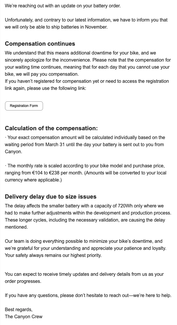

Surely it's better for them just to ship 900wh batteries to everyone rather than make the 720wh customers wait until November?

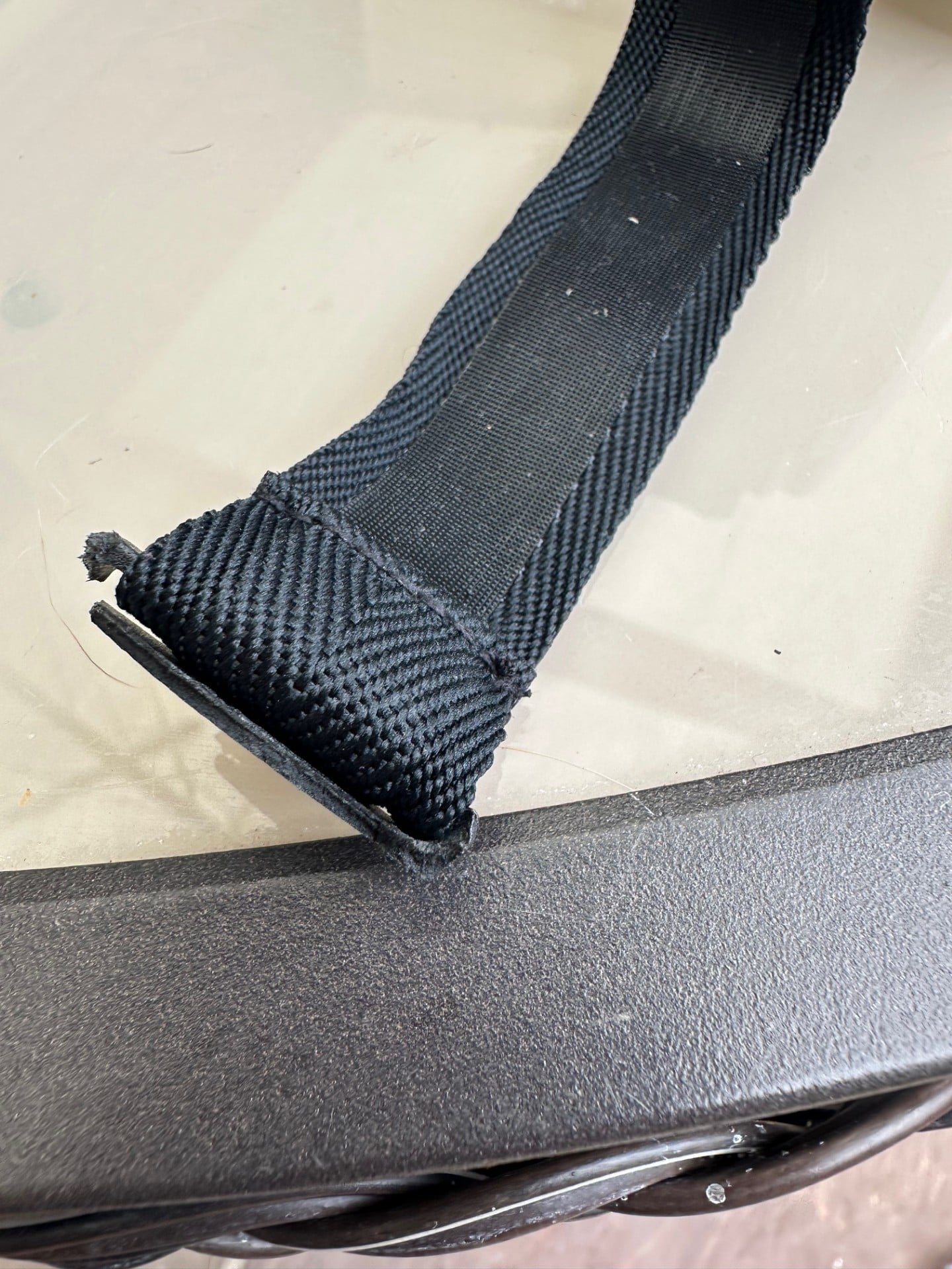

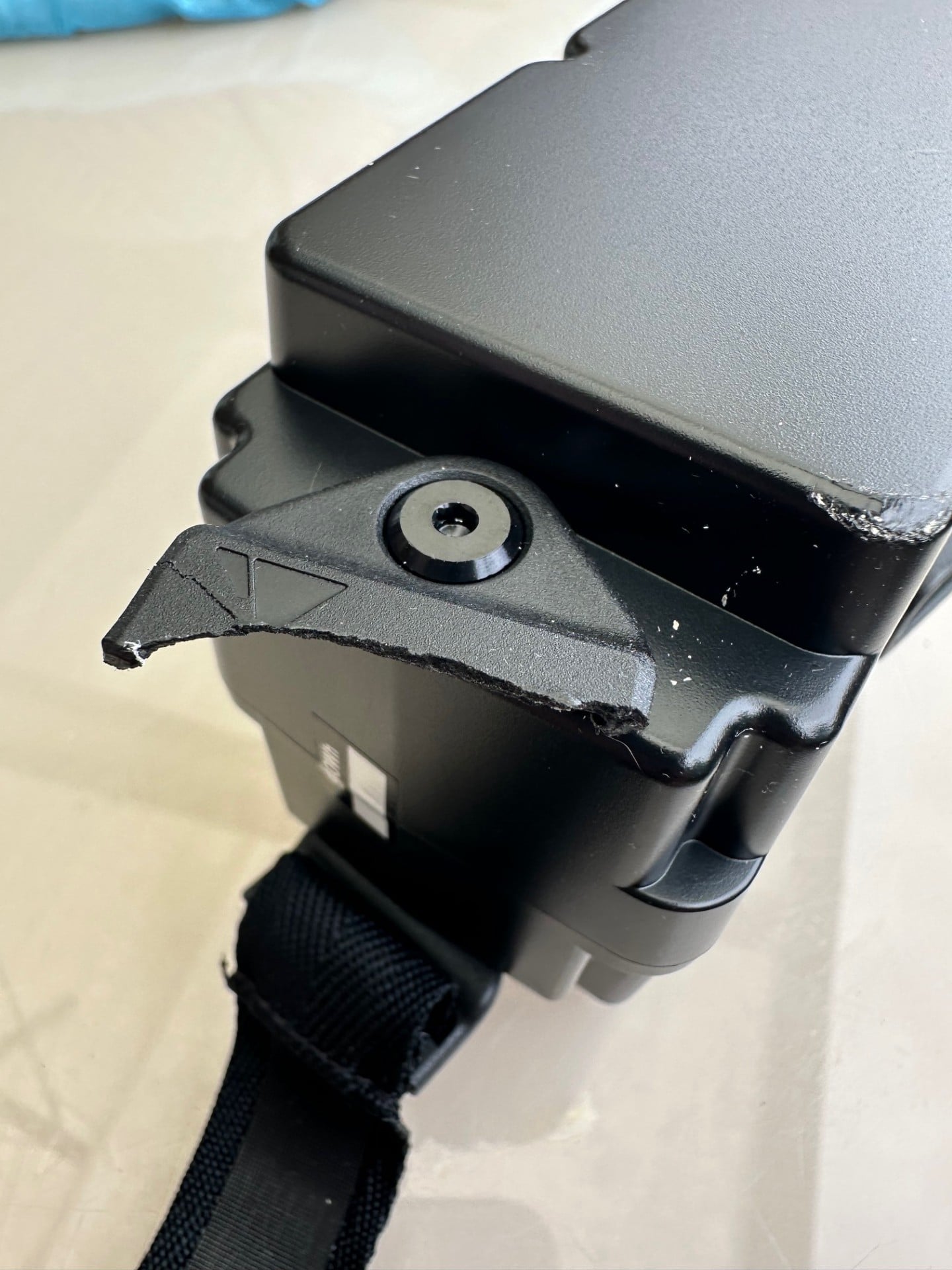

FYI all don't try and carry your new battery with the carry handle... All I did was walk from the box to the garden but before I got to the door the handle broke and the battery was bouncing on the floor. Luckily the battery survived and I didn't scrap the old one so I could swap the handles. The new handle brackets are super thin compared to the old one. I cannot wait to sell this bike
View attachment 164641 View attachment 164642
That's mental.........
