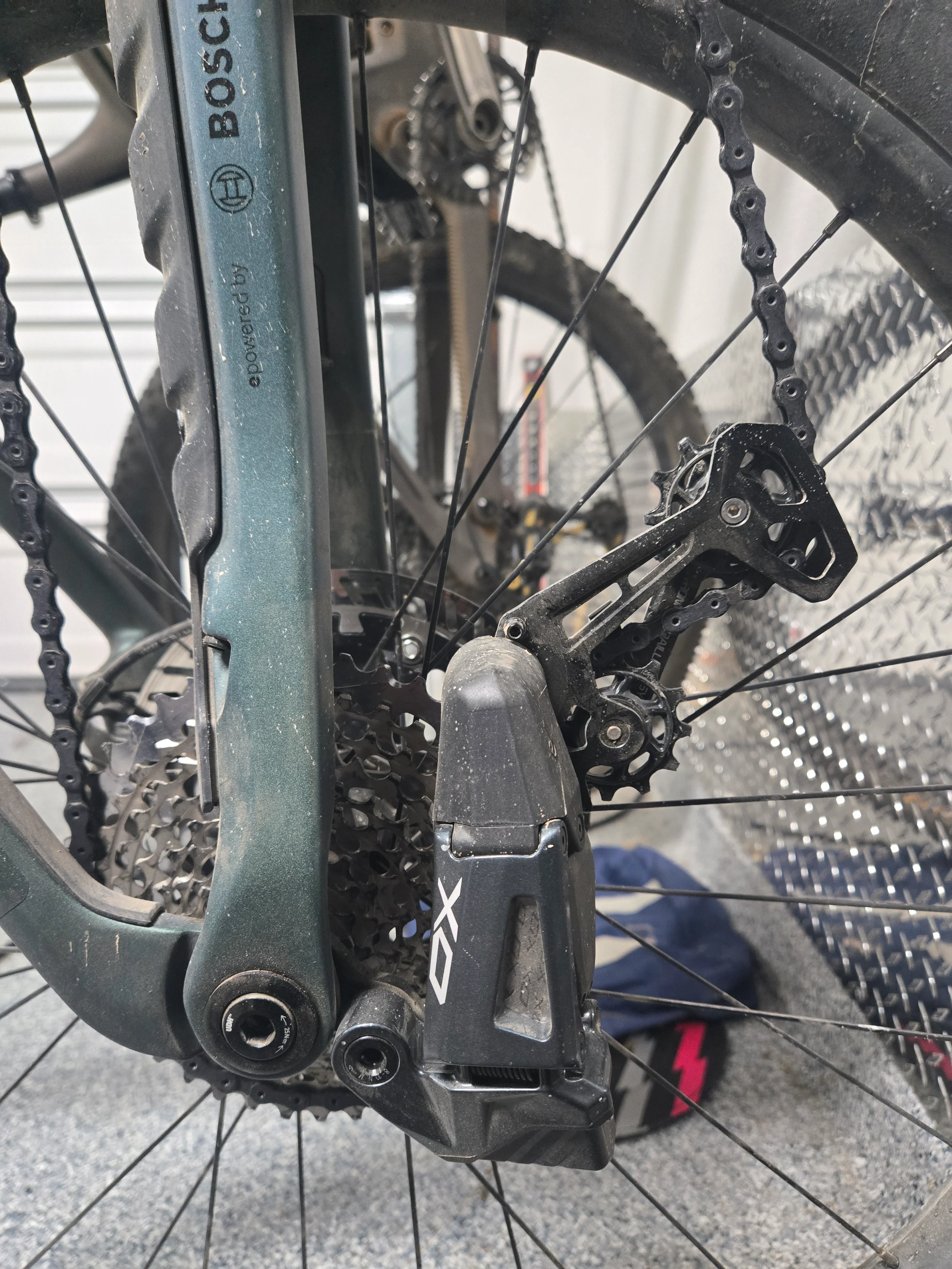

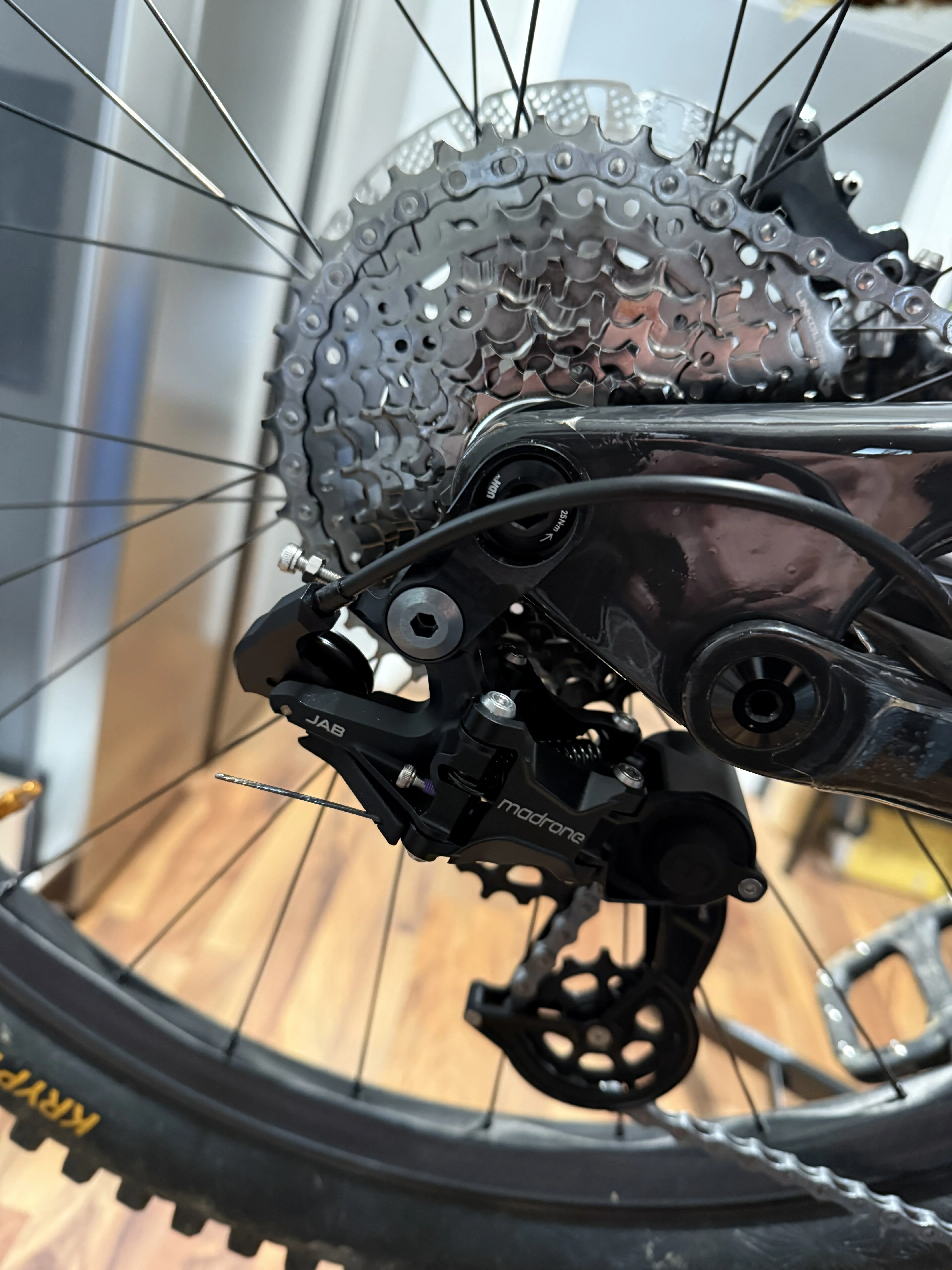

I have a Druid CorE, and after about 400mi my GX t-type chain is already worn. I can't be bothered to use wax over normal chain lube like Muckoff C3 and I clean the chain pretty regularly. I'm not too interested in adding to my maintenance routine, or two chain rotation, etc. I'm also not very interested in replacing chains often. So I decided to do some research here and other threads on better options than Transmission (which I've been using for last few years on my Analog bikes also). I just want a drivetrain that can take the abuse of an Avinox M1 and in soil that has a lot of sand in it.
I decided to go with a 10sp linkglide 11-39T Steel cassette (which actually weighs the same as my 10-52T XS-1270 its replacing), and a Madrone Jab with a linkglide cam and a short cage. Going to try different chains, for now I have a KMC E10. The Madrone Jab is about 150g lighter than the X0 AXS derailleur, but the shifter and cable is about 150g heaver than the AXS Pod, so they ended up at the same weight in the end (literally they are a few grams difference), but I'm saving 150g of unsprung weight in the rear and a lot more ground clearance, how much do those matter? not sure but every bit helps.
I went with 10sp LG b/c everyone talks about how durable it is and nice it shifts under load, also I read that Shimano made 10sp LG compatible with other 10sp shifters and derailleurs (HG, Microshift - maybe Saint/Zee?) so I figured if I didn't like the deore 10sp shifter I had other options to try. I chose 11-39T because I found that I never even shifted lower than 4th gear even starting on steeps, and even then usually 5th gear. 11T isn't ideal. I would love to see a 9T option, I might try 36T CR instead, since I rarely use the 39T either.
Also went with the Jab b/c it seemed like it was a tank (and a work of art), and I read someone else doing this with a 10sp LG. I also really like MadroneCycles values as far as being home mechanic friendly, and I like the strong, but also adjustable clutch. The chain is nice and quiet.
I only have about 80mi on it so far, but pretty happy. It shifts like a dream compared to my outgoing transmission and I forgot how much I liked Shimano's finger shifting. It's also not complained one bit when I need to change gears quickly out of 10th gear, even the transmission would sometimes start skipping if I wasn't careful enough and then the bikes overrun won't let it grab until I stop pedaling completely and I'm forced off the bike to get it in a better gear.
The only thing I really miss is the coast shifting, but not enough to care much. I thought I'd miss the pod shifter, but the crisp shifting of the Jab and the finger shift feature really make for a good experience. Also the Avinox gear display doesn't work well anymore, it thinks I have 2-11 gears instead of 1-10 gears, not sure if I could calibrate that, also the settings doesn't have an option for a 36T CR even though Forbidden manual says the bike supports up to 36T CR, not really sure how that value affects the ride experience.
