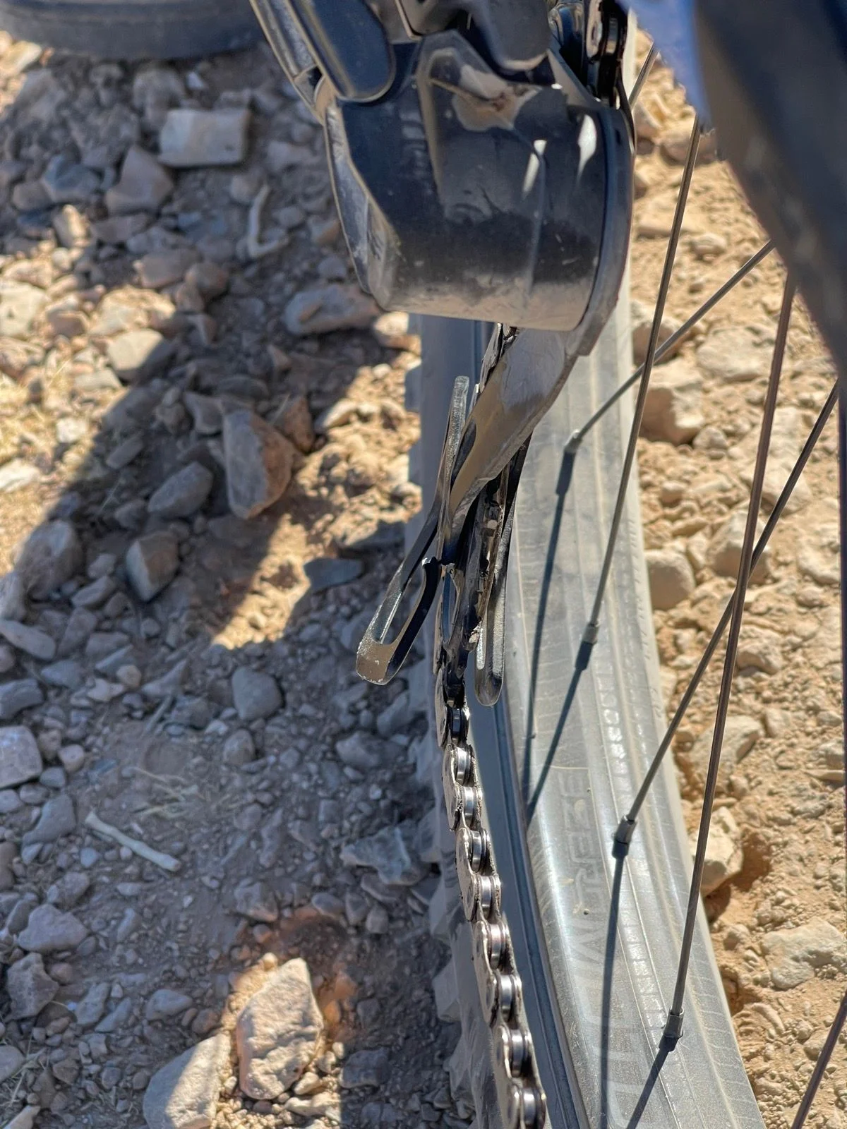

SRAM Eagler AXS, hard hit on a rock drop, Brohemian Rhapsody Trail, Las Vegas Nevada.
Being new to eMTB at the time, I found that on power moves such as a punchy climb, I was snapping chains frequently. I often thought about how much thicker chains chains used to be on the older 9 speed drivetrain setups. I also questioned why the need for 12 speeds on an eBike? I get 12 speeds on a traditional bike, but why an eBike? After all, I was receiving plenty of power from the bike, why not a more robust eight or nine speed system?

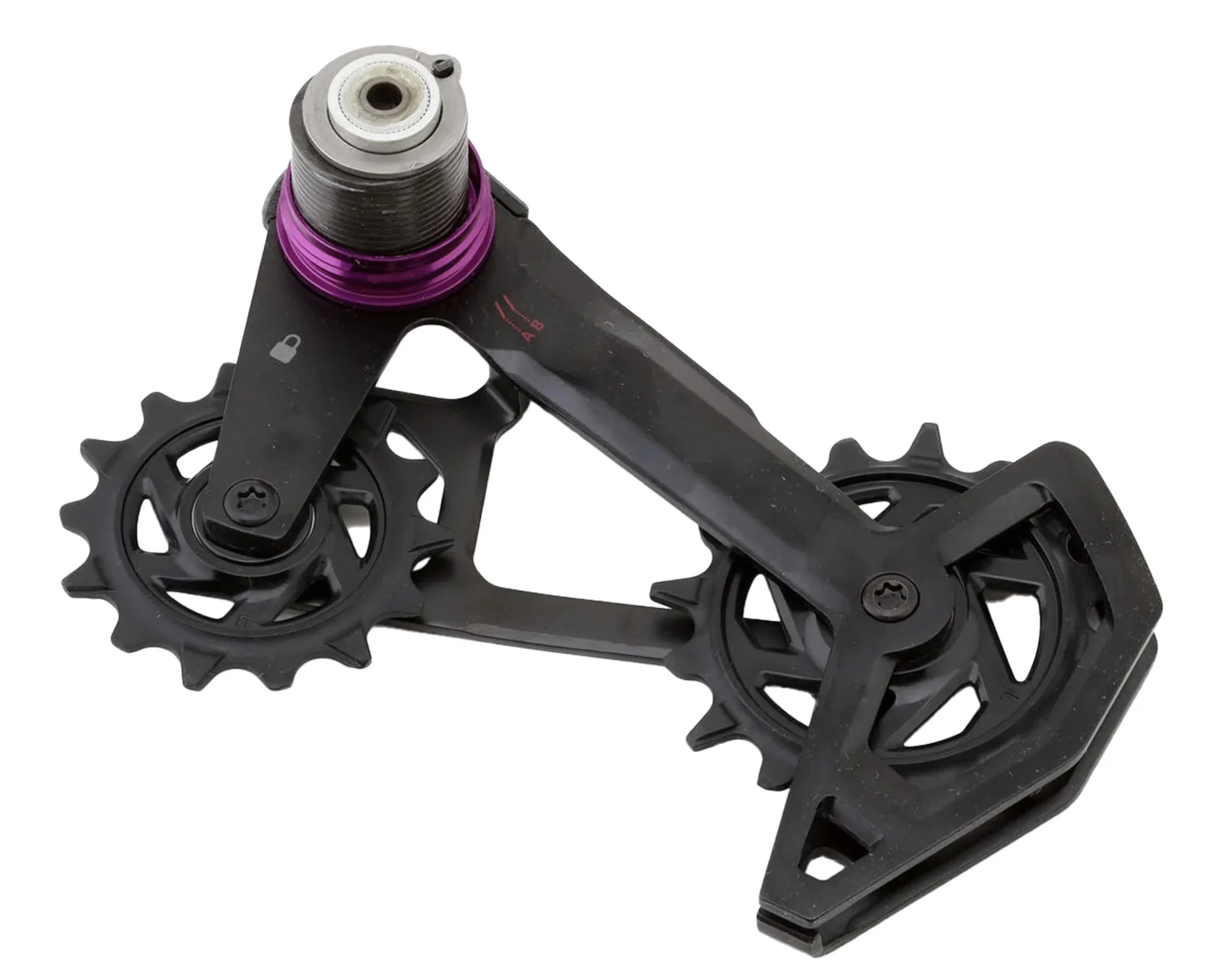

I currently use the SRAM 'T-Type' AXS drivetrain, coupled with a Bosch Race motor. It's a great system and I have felt no need to change. Occasionlly, I will have to replace the derailleur arm. It's one of those costs of doing business things. Swapping out a T-Type derailleur arm is a quick and easy process that does not require breaking the chain and takes only about few minutes to do.
T-Type replacement derailleur arm

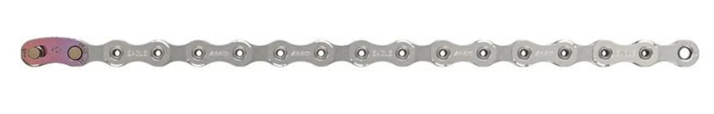

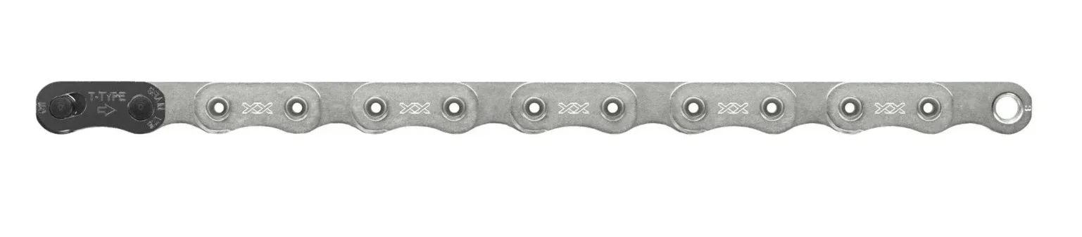

New style SRAM Type T chain (Note the thicker chain plate)
Older style SRAM Eagle chain

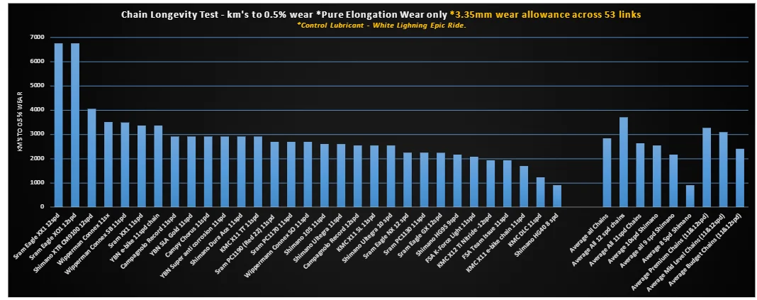

These tests were done pre-Transmission, but they conclusively show that Sram Eagle chains wore better than all other previous chains, including those old 8-9 speeds. The wear of chains isn't from the side plates, it comes from the rollers wearing out.
The most economical chain to purchase is the X01 12 speed chain, Eagle or Transmission.
If you wax your drivetrains, at least in my case, I approximately doubled my chain life and my cassettes last thousands of miles. All that greasy chain lube just grinds in all the dirt into your drivetrain.

The XO Eagle Transmission chains are £80, the Eagle 70 Transmission chains are £25. That graph doesn't suggest the XO chain lasts longer than 3+ Eagle 70 ones?
Are you accounting for perhaps less wear on the rest of the drive chain?
The GX Eagle chain was stretched at 2200 kms whereas the X01 eagle was stretched at 6800 kms. So the GX would need to cost less than 32% of the total cost of the X01 to be more economical.
Where I shop GX chains run about 60% of the cost of the X01. And yes, one should also consider the other drivetrain components that get worn down when the chain is worn.
Thanks for that, was hard to make out the numbers on the graph. Looks like the Eagle 70 chains are available for just under 32% of the price here, so I can certainly see why you get the XO Eagle ones where you are. Given me food for thought.

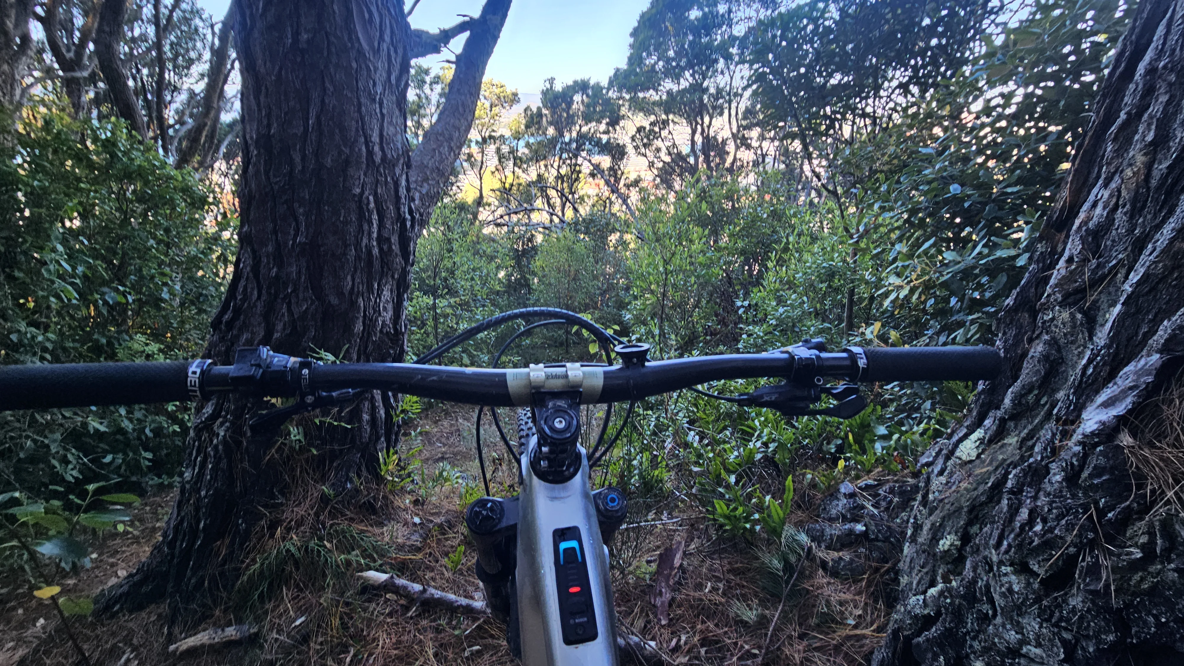

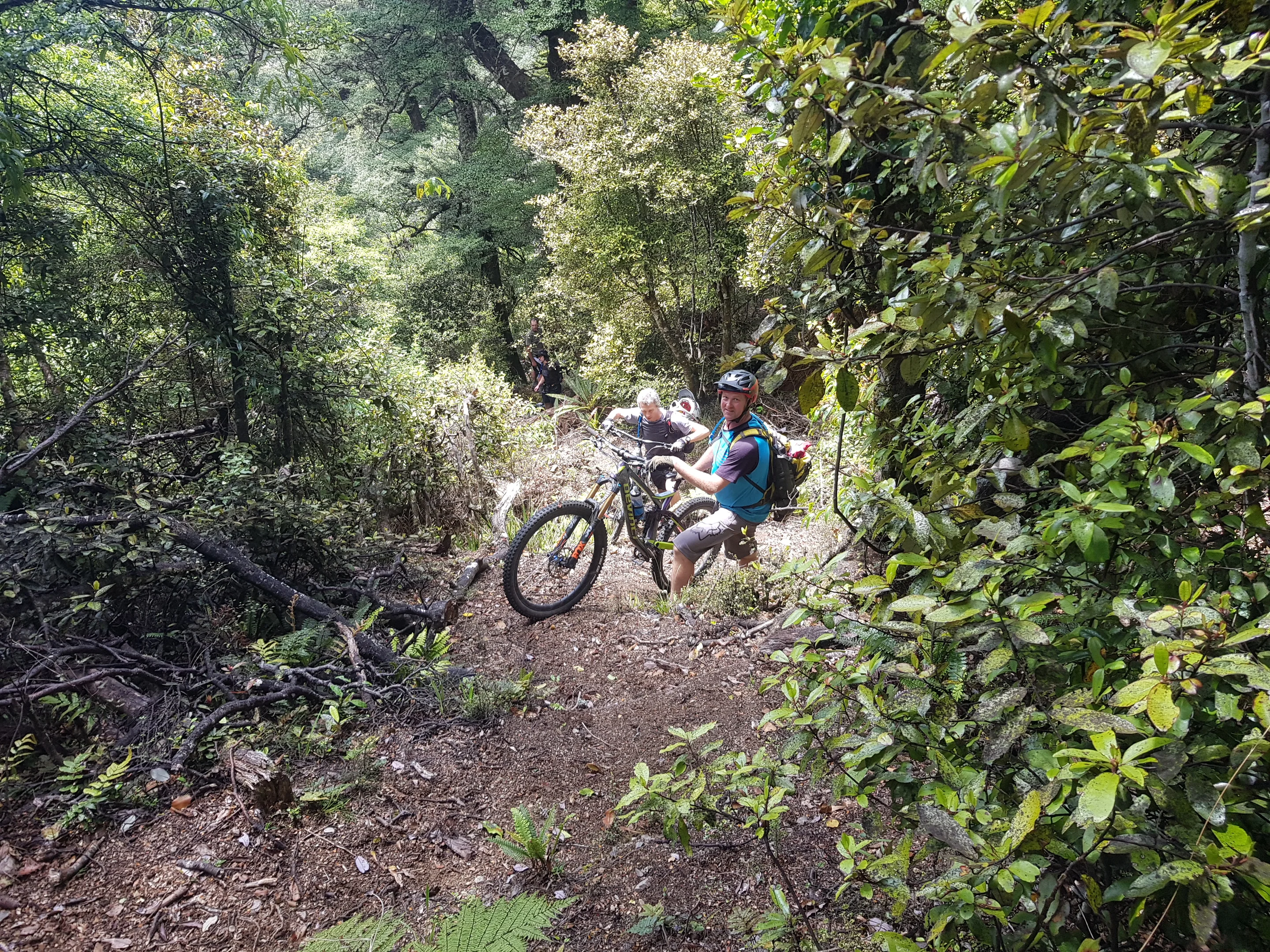

You are making the assumption and the track is open and obstacles are visible and that slowing and going around obstacles is an option. I dont ever damage derailleurs on standard bike park trail.

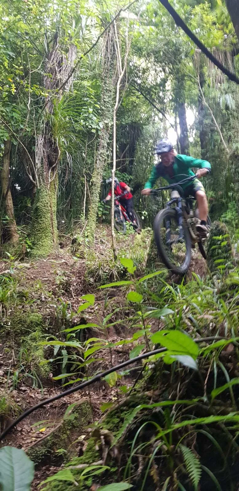

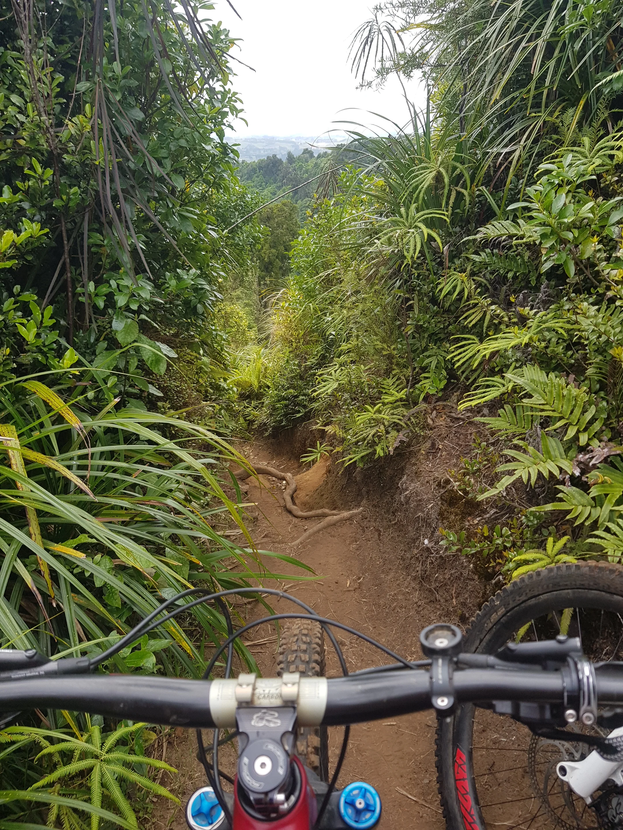

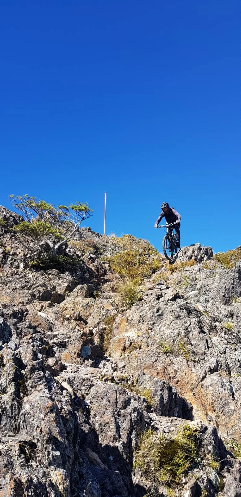

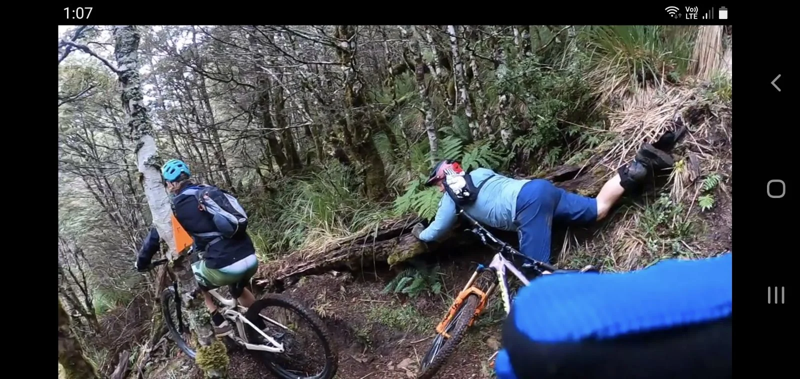

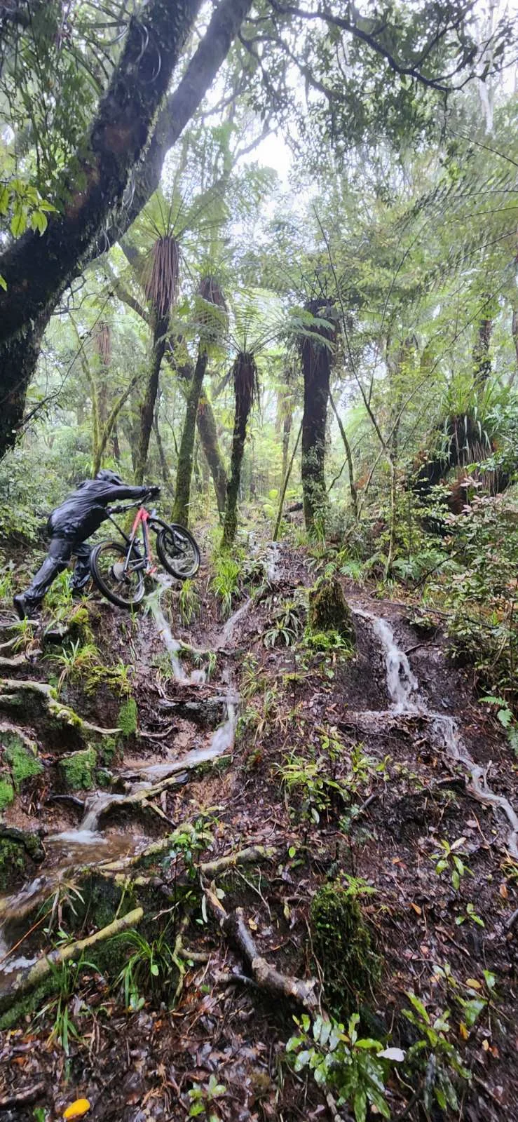

In my instance chase a lot of obscure steep hike a bike track which is often over grown and also parts of the track are so steep that once you roll into that section you are committed until the track flattens out. Often times the derailleur damaging thing is hidden in grasses and ferns im riding through and other times i get slightly offline on a super steep section and just have to ride that section out until i can get back online, if i hit anything along the way so be it....
The last derailleur I tore in half was on a steep committed section and I went maybe 100mm offline and the the thing that tore the deraelleur in half was hidden in some grasses. I heard it go, but couldnt stop for another 20 odd meters of vert....
Its just an occupational hazard of chasing that type of trail.
Here's some picks that dont really do it justice, but give you an idea.
Fair enough. But I would run a dedicated bike for that terrain. Destroying your nice $16K Crestline in that terrain would not bring me joy.

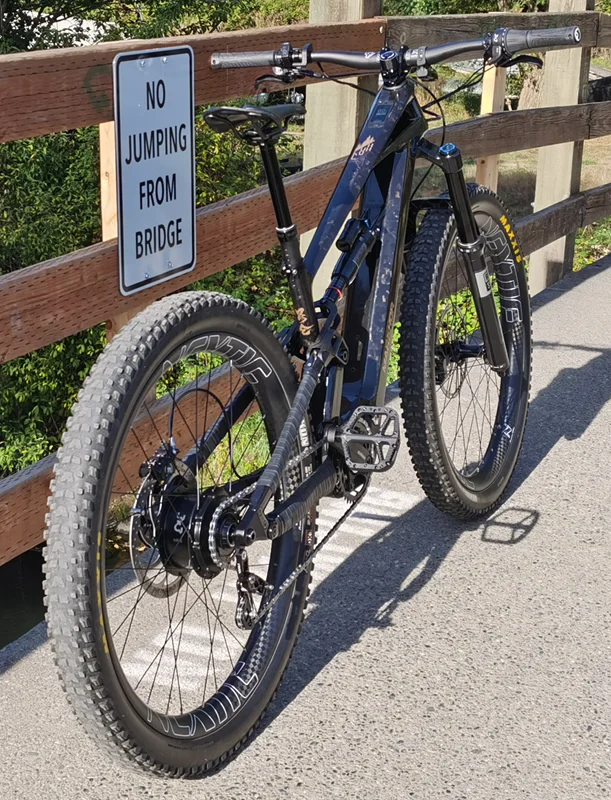

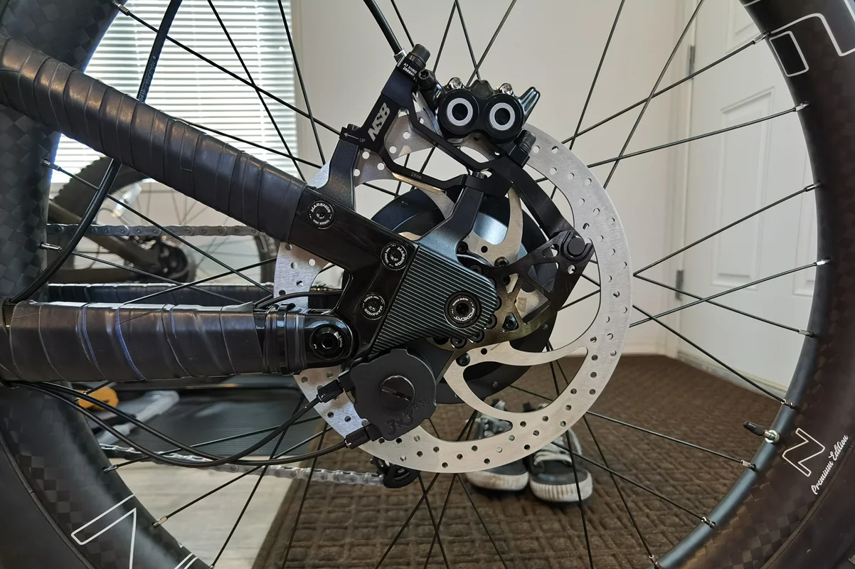

3X3 nine hub with single speed heavy duty chain with steel chainring is ideal EMTB drivetrain. I used a bunch if different derailleurs drivetrains, used Kindernay XIV gearhub drivertain, used Kindernay VII gearhub drivetrain and finally use 3X3 nine hub drivetrain now.
Intrigued but wondering about unsprung weight.
Also, what wheels are those??

it's ~160g heavier than a GX T-type cassette, but it is made of Steel. So incredibly more durable for an ebike use case.
