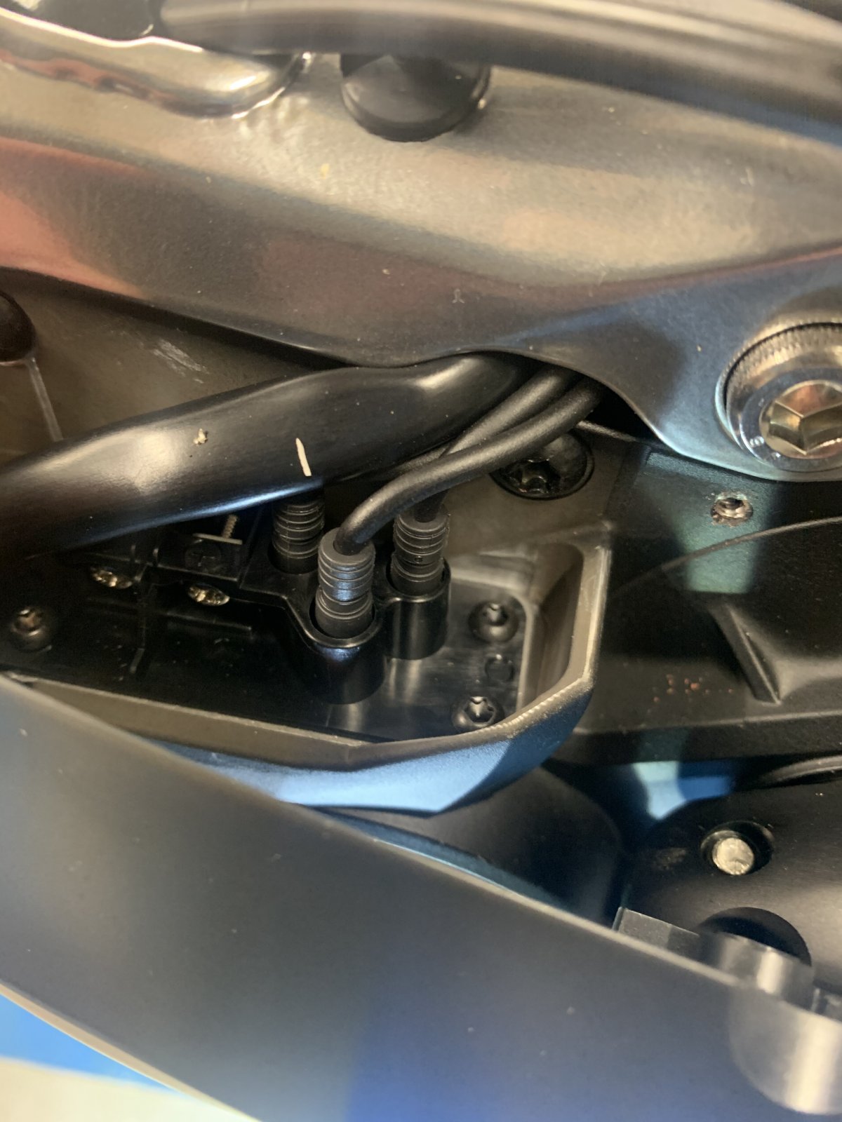

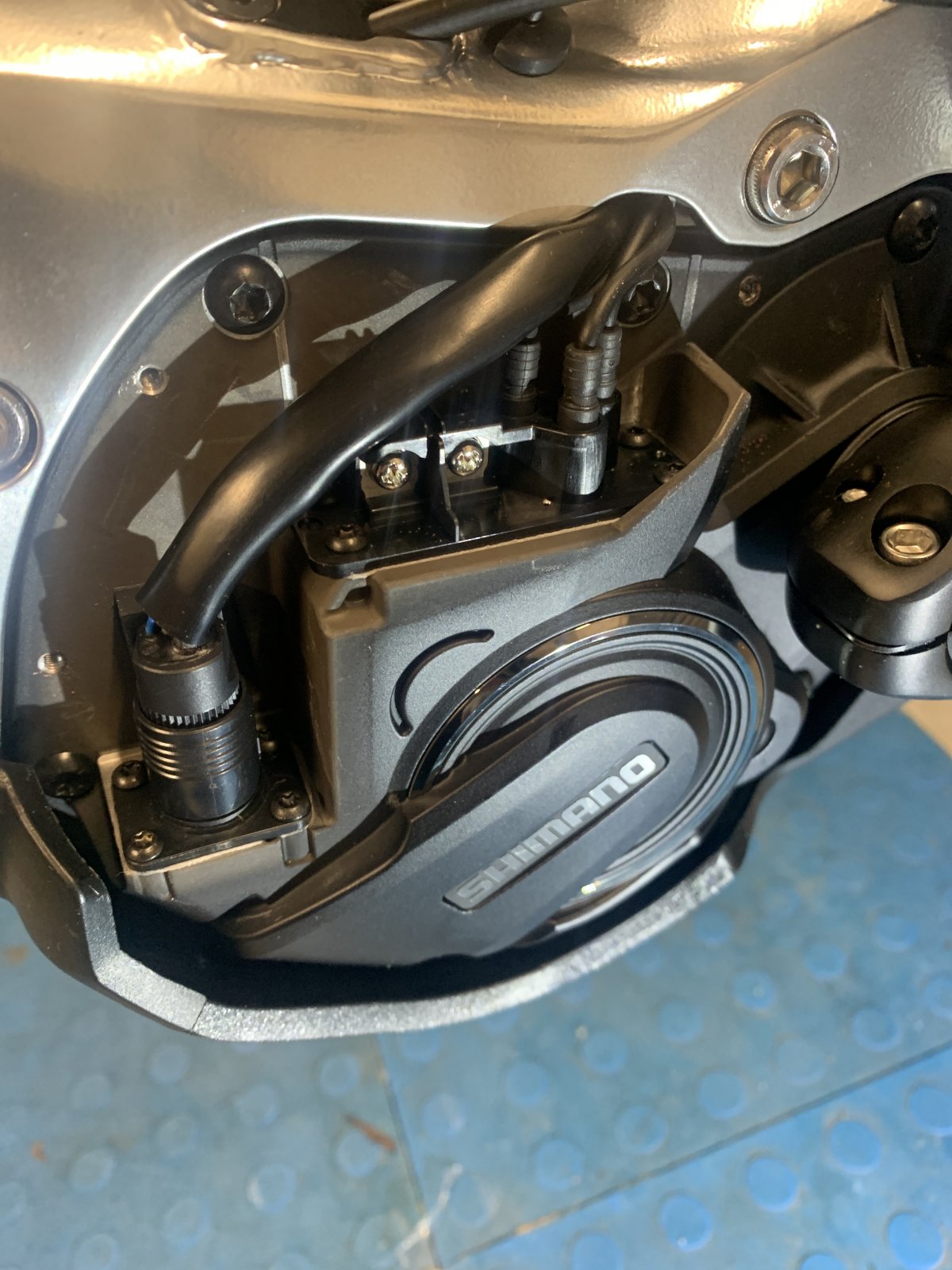

Hmmm, I may have mislead you. Try the drive-side cover. There is a big ole two-wire connector under one of them. I may have remembered which side it is in a wrongly way.
Agree?I take it the big fat one is the motor to battery connector and the other three are speed sensor display and the dreaded power button ?
Actually, check under the cover on the other side. Mine came with one of the covers off, and there was a big two-wire connector that was unplugged, I guess for shipping.
It wasn't like the one in your picture there.

I think they're sadly crappy Phillips screws aren't they ? Maybe they've seen the light and upgraded to torx.
Yes, small Phillips screws, my cover was off and multi plug to motor disconnected. Charge it up first and I hope it all work ?

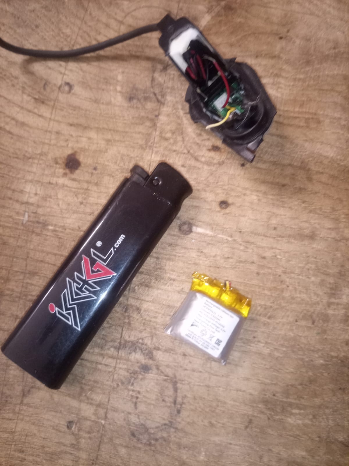

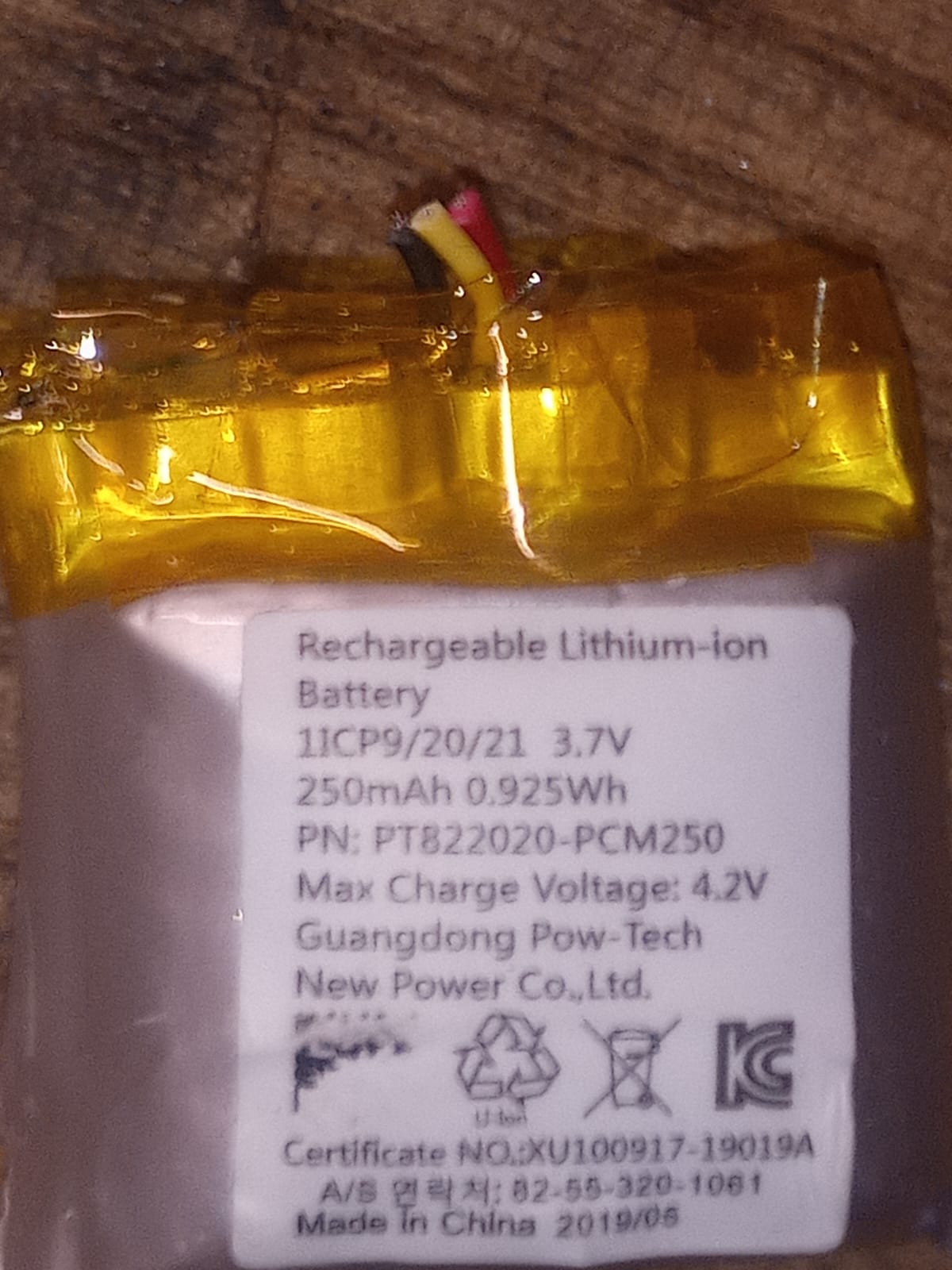

EW-SW-100 torn apart. i replaced the battery with another similar one from an RC-car...
battery voltage 3.7v
charging voltage 4.2v
no need to buy this peace of scrap for 80 bucks. just cut it open and put a 5 buck rc-battery.
have fun!

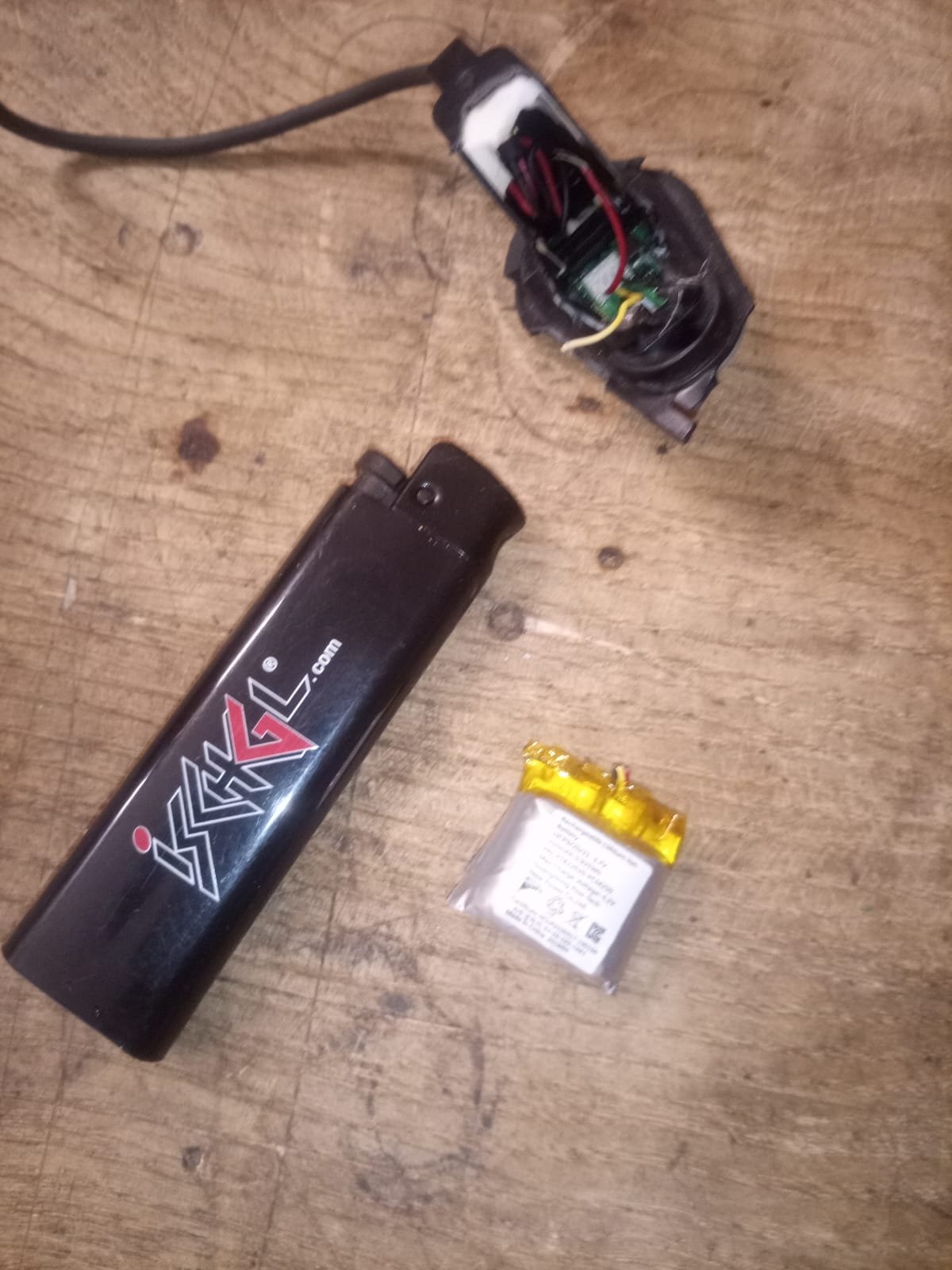

have fun!
Can you describe colors / pairing of polarity? Possibly I will make the same thing. I hate to beg for Shimano box before each long holiday for emergenecy.
We had a long weekend in TR last week. I had prepared all bike stuff, loaded the emtb into the car and hit the road to Istanbul, I was dreaming 4 days of riding in Istanbul forests. But shit happened again; not possible to switch the bike on :(
I went to electronics shop and bought a simple cell holder for 18650 battery and a battery cell. I cut the switch to half and removed the shitty micro LiPo battery inside. I have soldered 18650 battery holders with correct polarity and made a custom sealed switch body. I glued the cell holder under the switch then insert into the bike.
If 250mAh LiPo battery finishes in 3 weeks at home, let's see how long 2800mAh cell will stand...
I want to find this genius engineer that put a battery into that switch...
