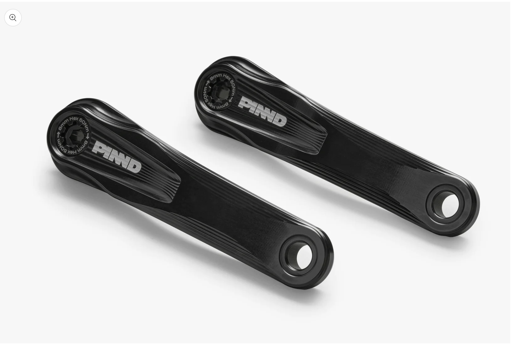

The Hope cranks are great and really easy to install and come with everything. They are spendy compared to some brands but are still very nice. You want them in the "standard offset". The ones made for the specialized bikes will not work.
I like this idea of 155 cranks. What type would I be looking for to outfit my Reign?
I bought the cheapo Miranda 155 cranks to try to see if I liked them with the intention of upgrading to Hopes if I did. I'm totally sold on shorter cranks but I'm still riding the Mirandas and haven't felt the need to upgrade to Hopes yet (although it is still my plan to do it at some point). The Mirandas are absolutely fine though, just not very blingy.
I rode Miranda's on my Commencal for 2 years and eventually bent them (side hit to a rock at high speed). Still bought a pair for my Giant, even if I need to replace them every couple of years, I just don't see the point in fitting anything more expensive.
Any ISIS compatible cranks for an ebike.
Examples:
FSA CK-220 ISIS E-Bike Crankset
145mm cranks.
