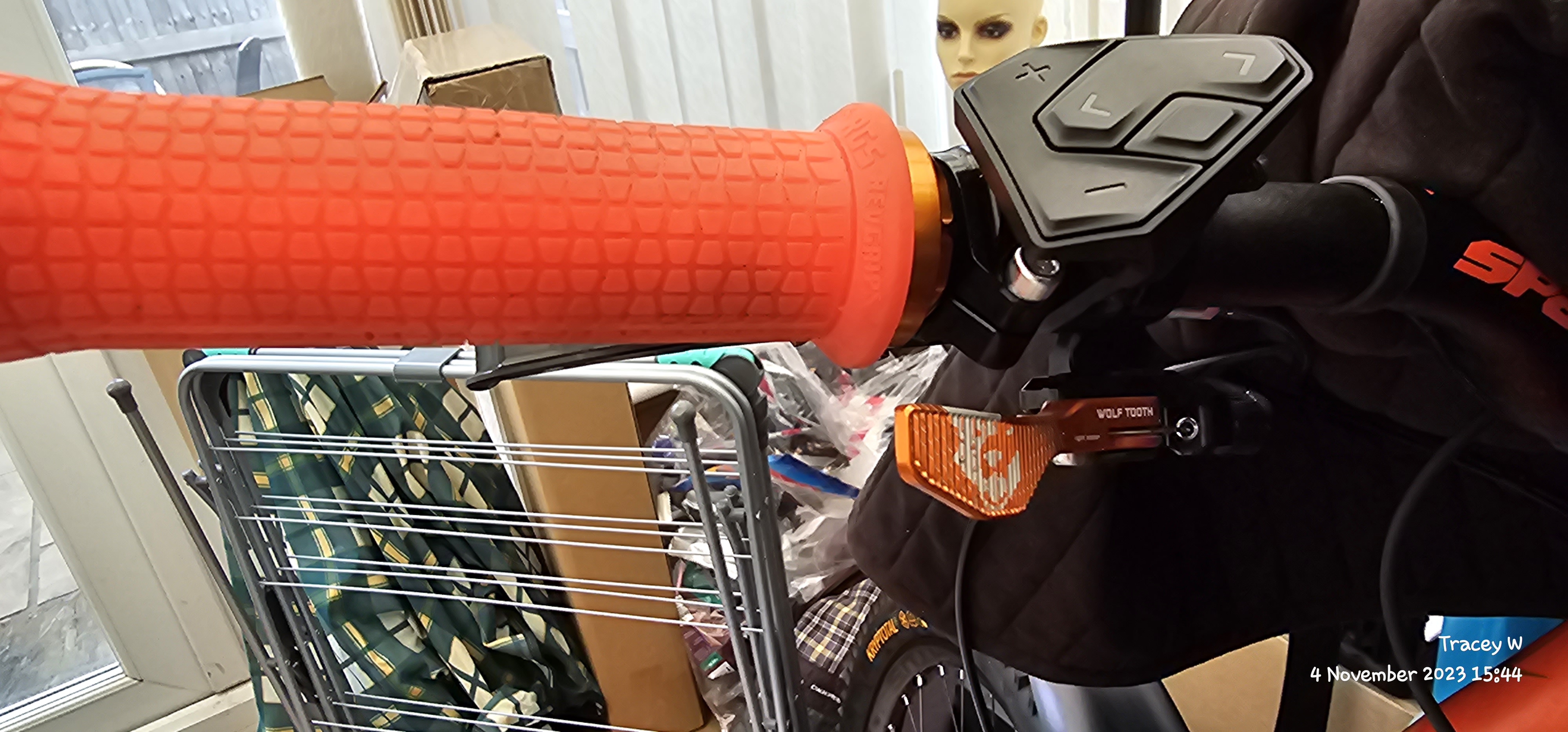

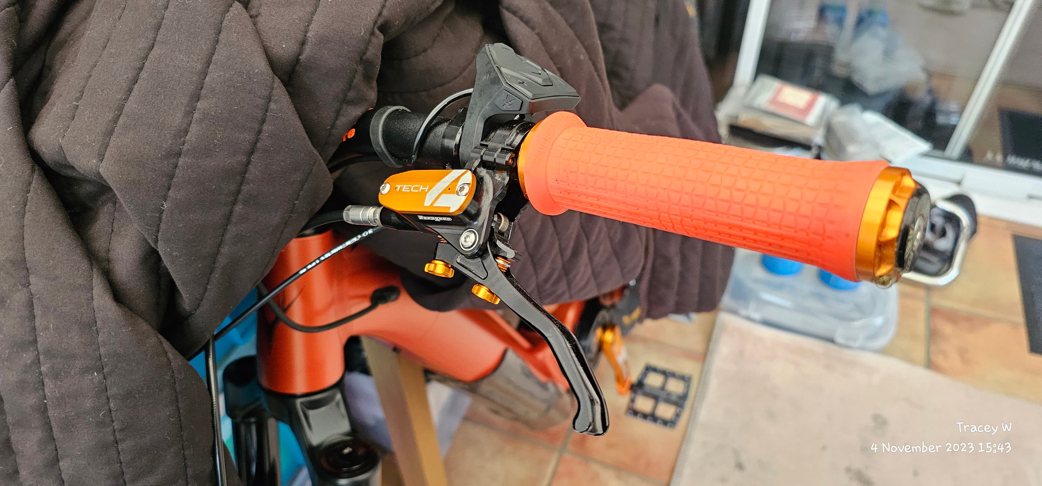

I've got RevGrip Pro's and Hope V4s and don't have any issues. I've changed my dropper lever to a Wolftooth light action but left it on it's own mount rather than the Hope adapter as it would have been too far into the grips. See photo. 16991126042823165622598709556716.jpg 16991126526623705192280462311814.jpg

I should add that the rear caliper can have issues clearing the magnet but I didn't - you do need to put a washer under the magnet mount though as the floating rotors have a dip in them.

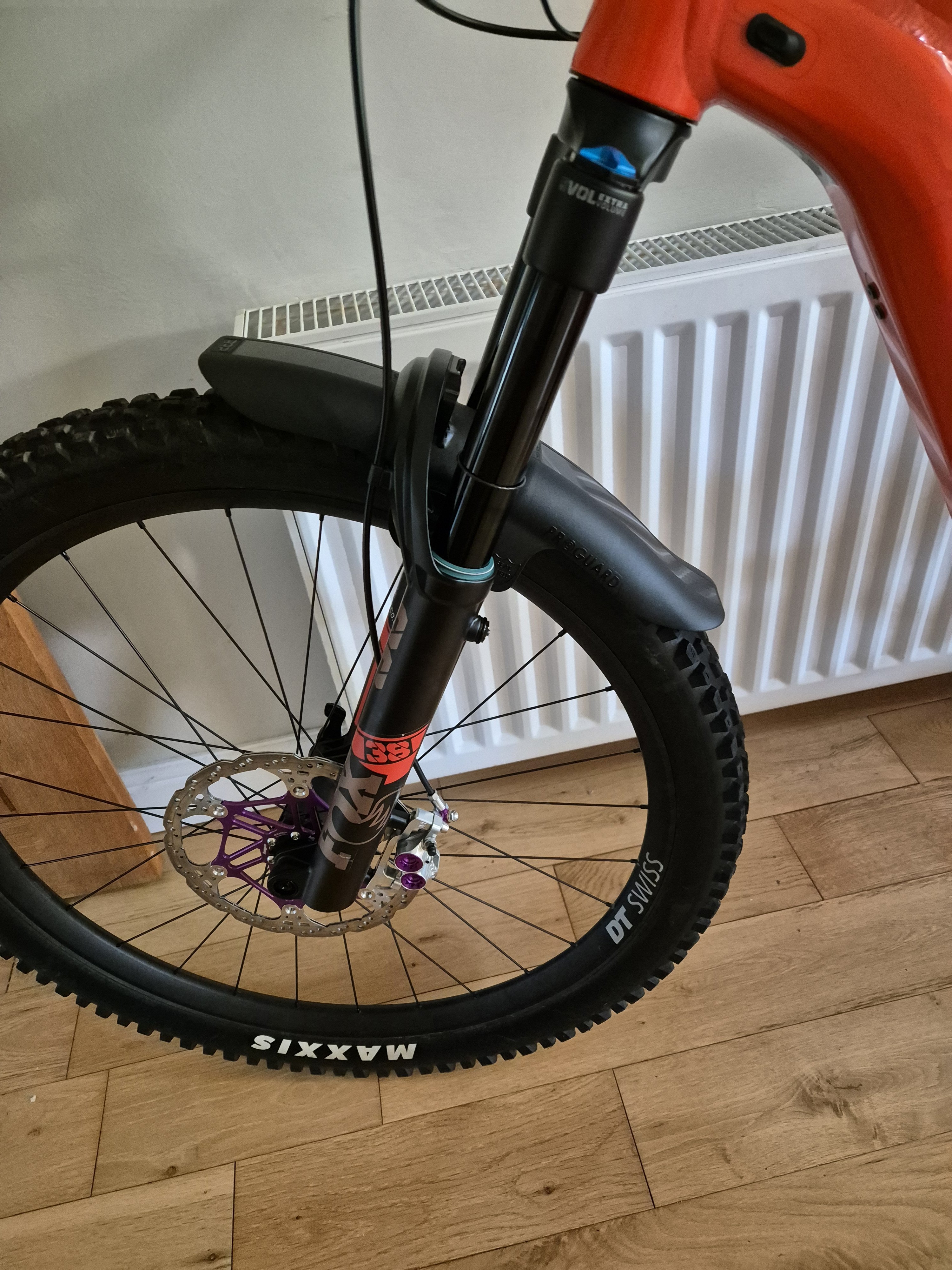

Fantastic responses to my question, I have just ordered my brakes off the back of reading these replies, I have the fatter Revgrips but they’re not much fatter, I also have the same Kiox controller too, a picture paints a thousand words 👍 I have to order the barbed routing tool and the rotors and a bleed kit, all in good time, I may have to ask more questions about this but I’m really grateful for all the help you guys have given me so far 🙏

Following on from these replies I have bought myself a Hope easy bleed kit but the Reverb stealth barb gizmo is another story altogether, I found one on eBay but it’s over £15 with postage, some greedy little wannabe entrepreneur 😡 I might not even need it as I have some movement on my brake hose, I bought a Park Tool copycat cable routing kit for my old shifter setup, I’ll try that first before buying the barb gizmo, I’m not a tight ass, it’s the principle of the thing 😡

Not yet, I’m waiting for my rotors to arrive but even if they arrive this week I’m doing a plumbing job this weekend 🤞 I get that done in time to do my brakes plus I need to source the correct sensor magnet
