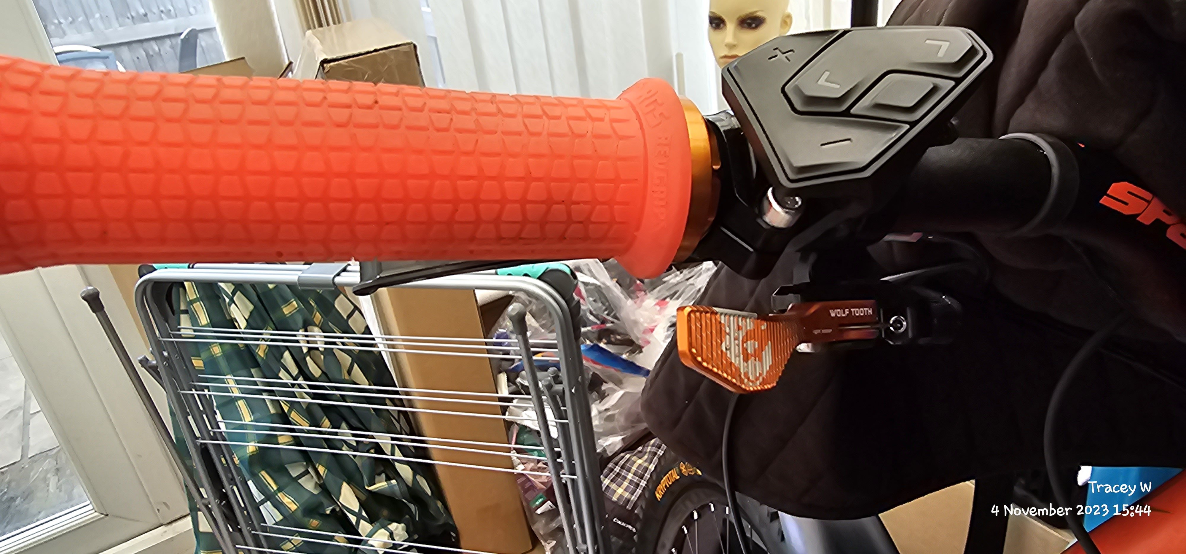

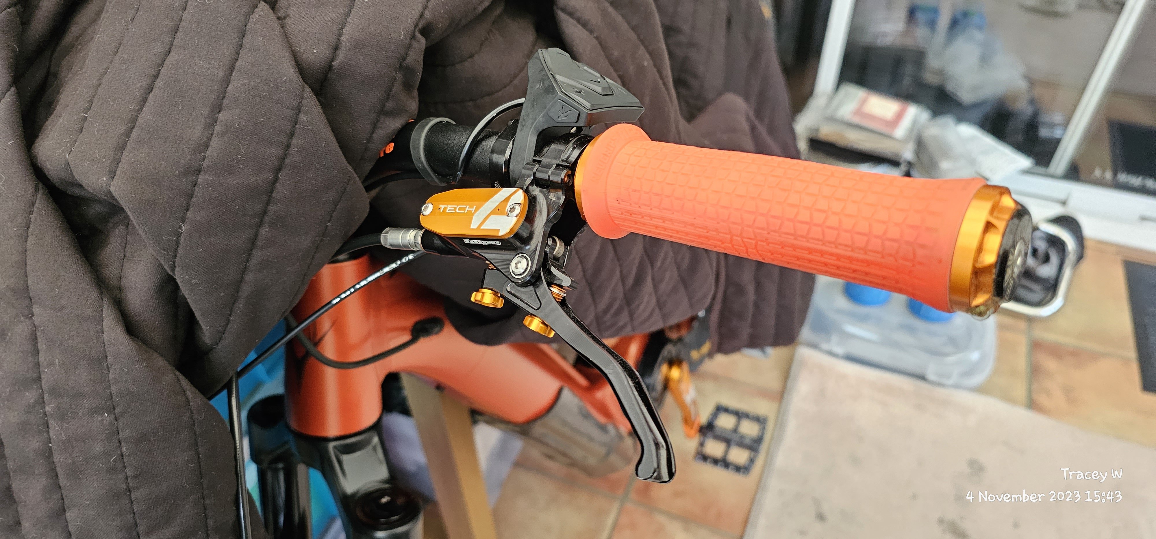

I've got RevGrip Pro's and Hope V4s and don't have any issues. I've changed my dropper lever to a Wolftooth light action but left it on it's own mount rather than the Hope adapter as it would have been too far into the grips. See photo. 16991126042823165622598709556716.jpg 16991126526623705192280462311814.jpg

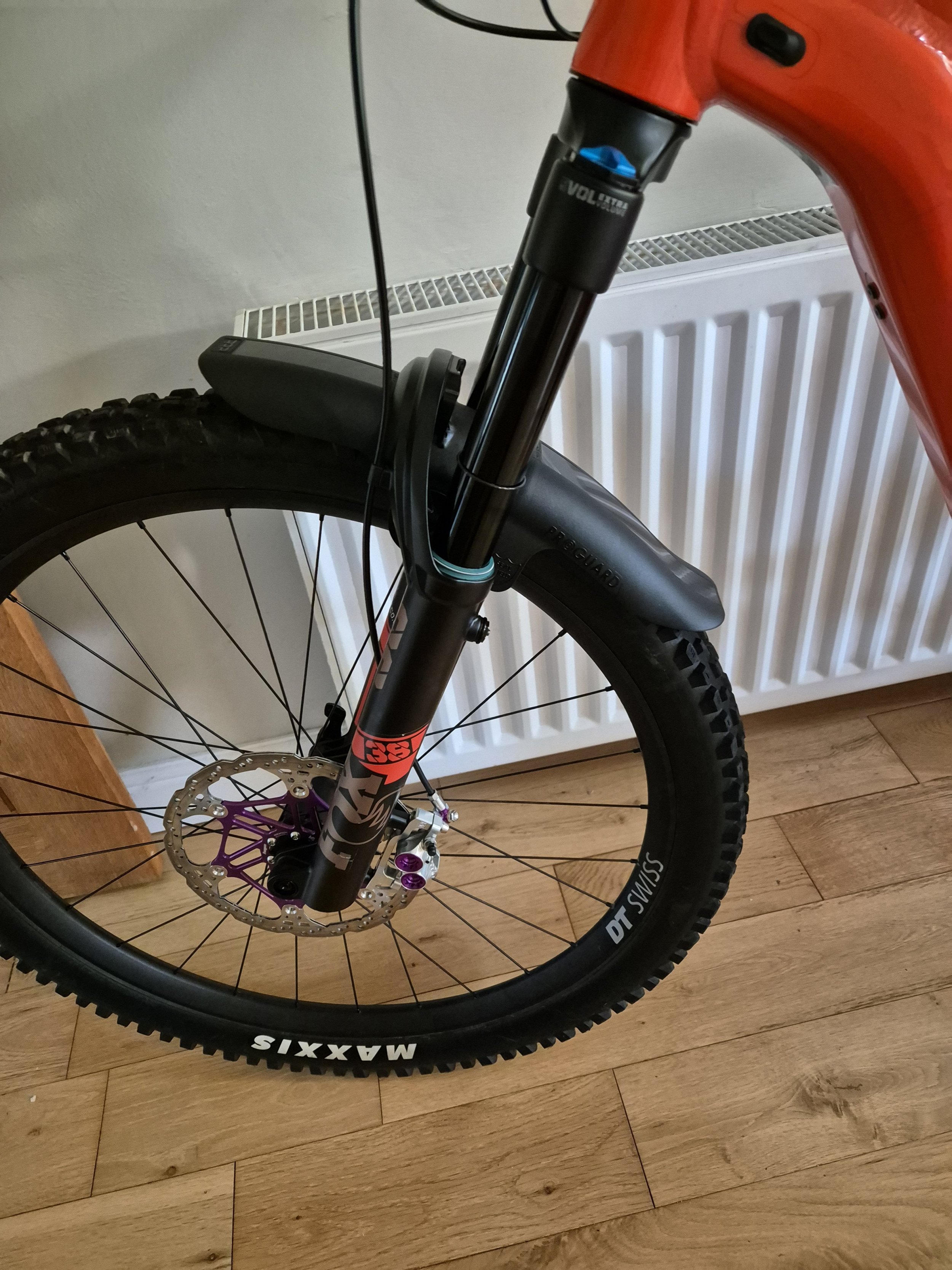

I fitted T4 V4 to front a month ago. Went vented and looks ace. Fitting the rear this weekend but going with none vented normal floating rotor. Not looking forward to job and just hoping I don't need to drop the motor as I don't have a Bosch Gen 4 lock ring removal tool. Hoping I can do it with standard routing tools and the none drive side motor cover removed. Annoyingly I can't get a raw aluminium flat mount to post mount adapter either. It's going to ruin my silver and purple Hope look.
Which mount did you use on the front?
