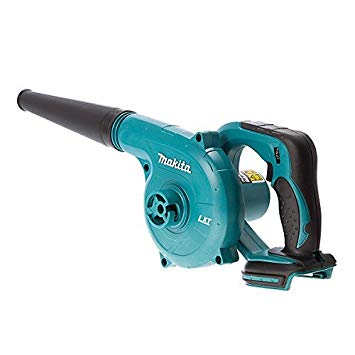

+1 on the leaf blower ..

Interesting video.
a compressor seems a bit overkill for a little air blasting. Concerned about the noise one would make too, in summer I am likely to be washing at 9-10pm maybe
How about this for cost effectiveness :)
I've been googling compressors, then leaf blowers, then car dryers, and now pet dryers!
