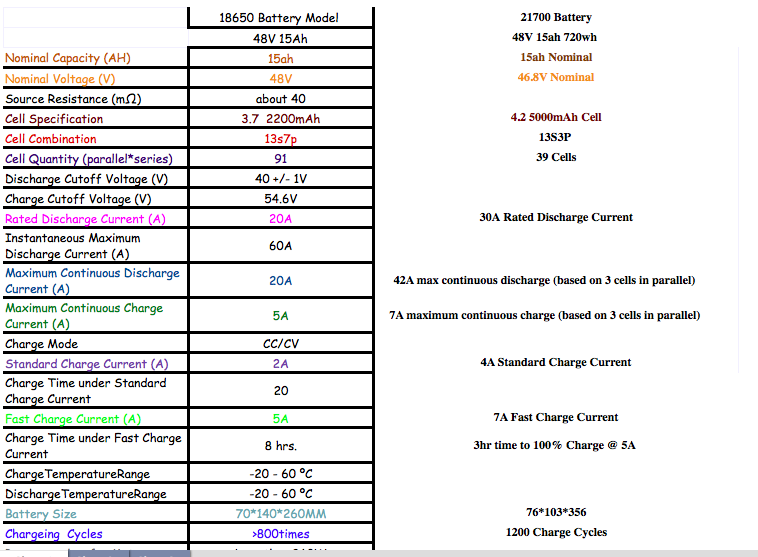

Being US based my primary interest is in the 48-52v battery. Not that they don't apply elsewhere they are more popular here due to our more generous watt allowance of 750w. I made this up earlier this summer while starting research into a 2170 battery design that would retrofit to the largest amount of bikes on the ground here in the US using 48v systems, think RAD and Sondors, as their original batteries are about the spec as the model used here but in 13s4p configs. The 2170 battery is the LG 5A version licensed by BMZ.

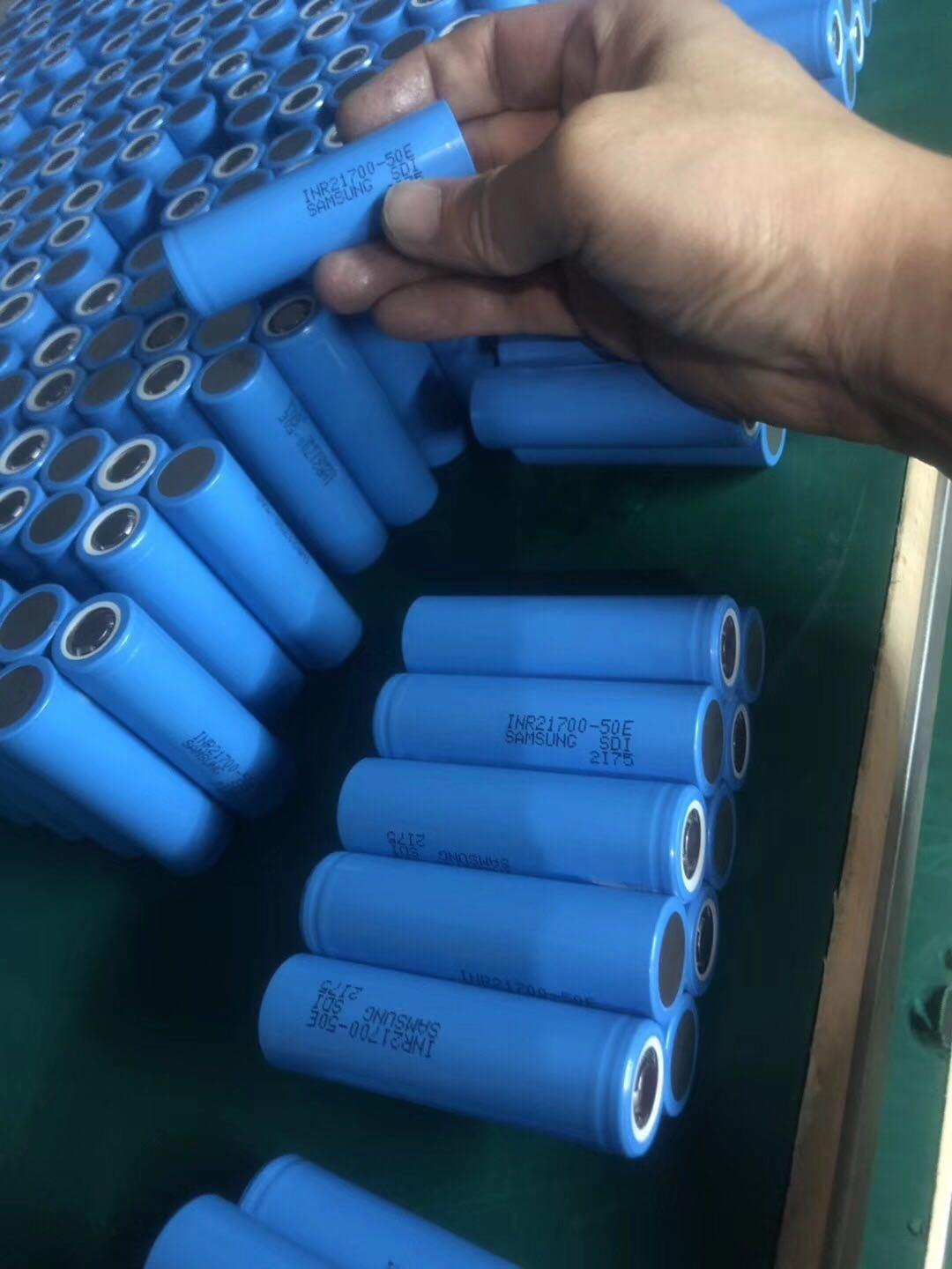

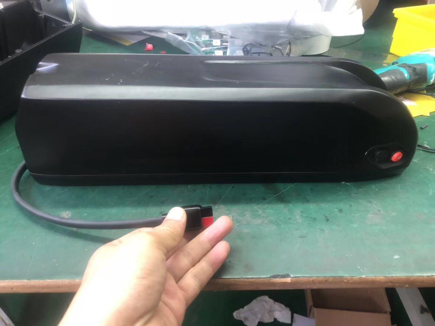

To that end I have a battery on the way that is 14s4p, or 52v/15ah/780wh on paper for trials here. It is made of Samsung 50E cells and the case is a new version of the popular HL type battery in use world wide. I prefer a 52v battery but all findings should extrapolate to 36 and 48v systems.
fb3c600d-2025-45d5-99b6-bdb79fa6fe1c-original.jpeg /
I will be able to use this battery on my eMTB as well as my eRoad bikes in terrain and conditions familiar to me and see how it performs which to me is going to be the test period and the best part, riding. Also have access to a full battery testing facility that it will visit to be able to chart it's performance. So between the two it should show if there is anything to gain going forward with the 2170 format.
View attachment 7222 /
I'm not too into the progress and development of cells, so every time I wonder what the future holds, I can't find any insightful answer :) I've been hoping to see larger 18650 8A+ cells, but it seems to have stopped with 3500mAh. E-bike batteries with those cells have been around for some 2 years now!? Focus is running 10s3p batteries with 3500mAh cells (378Wh). I'm guessing they use 8A cells. The discharge current of 24A seems to be good enough for a 250W nominal motor. There has been some rumors of 3900mAh 18650 cells. In 10s3p that would result in a battery of about 2kg and 421Wh. I believe that will do for my riding, and I'll take that 500gr of weight reduction. Have you heard anything about what's next for the 18650 cell? From a weight saving point of view I'm not too excited about the current 21700 cells. To get a proper lightweight battery from the 21700 cells one would have to go 10s2p, with 10A cells that's a 20A battery, and I think that won't cut it.
It seems you have very different requirements for a battery compared to me. Building that battery from 91 cells sounds like quite a job. With that cell count, going to 21700 will save a whole lot of soldering. Those 2200mAh cells does have a pretty awful energy density though. An 18650 Samsung 35E 8A cell does have about the same energy density as the 21700 Samsung 48G 10A cell. But if we get 21700 6500mAh 13A cells in a year or two, then I'm ready to embrace it and get my 10s2p 470Wh battery :) Not getting my hopes up though, as the same chemistry can be used in both cells!?!

14x4 is 56 cells for the 52v/15ah/780 watt battery, not sure where the 91 cell you mention is arrived at?
I think as time goes on you will find that there are going to be quite a few people figuring out just what wh battery works best for their needs. I have been using 520wh 52v batteries for awhile but if I just want to charge to 85% for extending battery life then going to the larger wh battery makes sense as I will gain over 30% more wh's which at that point I think I will be in my zone based on my experiences to date.
Time will tell.
The chart on the left in your post #126 mentions 91 cell count
