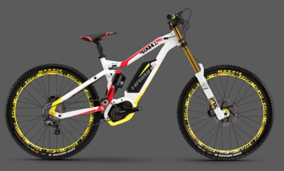

I think that bike looks hideous, over engineered and heavy looking. Hate the front and tail lights. I love motos, two KTMs in the garage but that bike is trying too hard to look like a Moto. It’s a MTB.
The eZesty on the other hand looks sweet,
Light and agile and gets my vote, will be interesting to see how it performs next year.
Looks a lot less like a moto than most downhill bikes, non?
I have had loads of off roaders, from Huskys to Hondas and i still don't think e-mtbs are remotely similar, either in looks or what they do. DH bikes are the closet thing to a MC visually and in terms of thing you do on them that crossover to motor (whips etc), and of those the Brooklyn Machine works, and HondaDH bike are probably the closest to a moto we have come.
Haibikes generally are not my cup of tea, mainly because i always think they look like a dogs dinner of parts shoved on a frame with a bad paint job, but there are a lot of features on this that i think are good, if you look at the videos of it its very well integrated and sleeker than it appears in the pics, especially when the optional headlight removed, and the lights appeal as most of my riding from October till April is done at night, and one of the great things about ebikes is the ability to power lights off the battery.
Like you the la pierre appeals more, but will really be interested in the first reviews of the Flyon
Haibikes existing EMTB Downhill bike is a lot more moto like!
