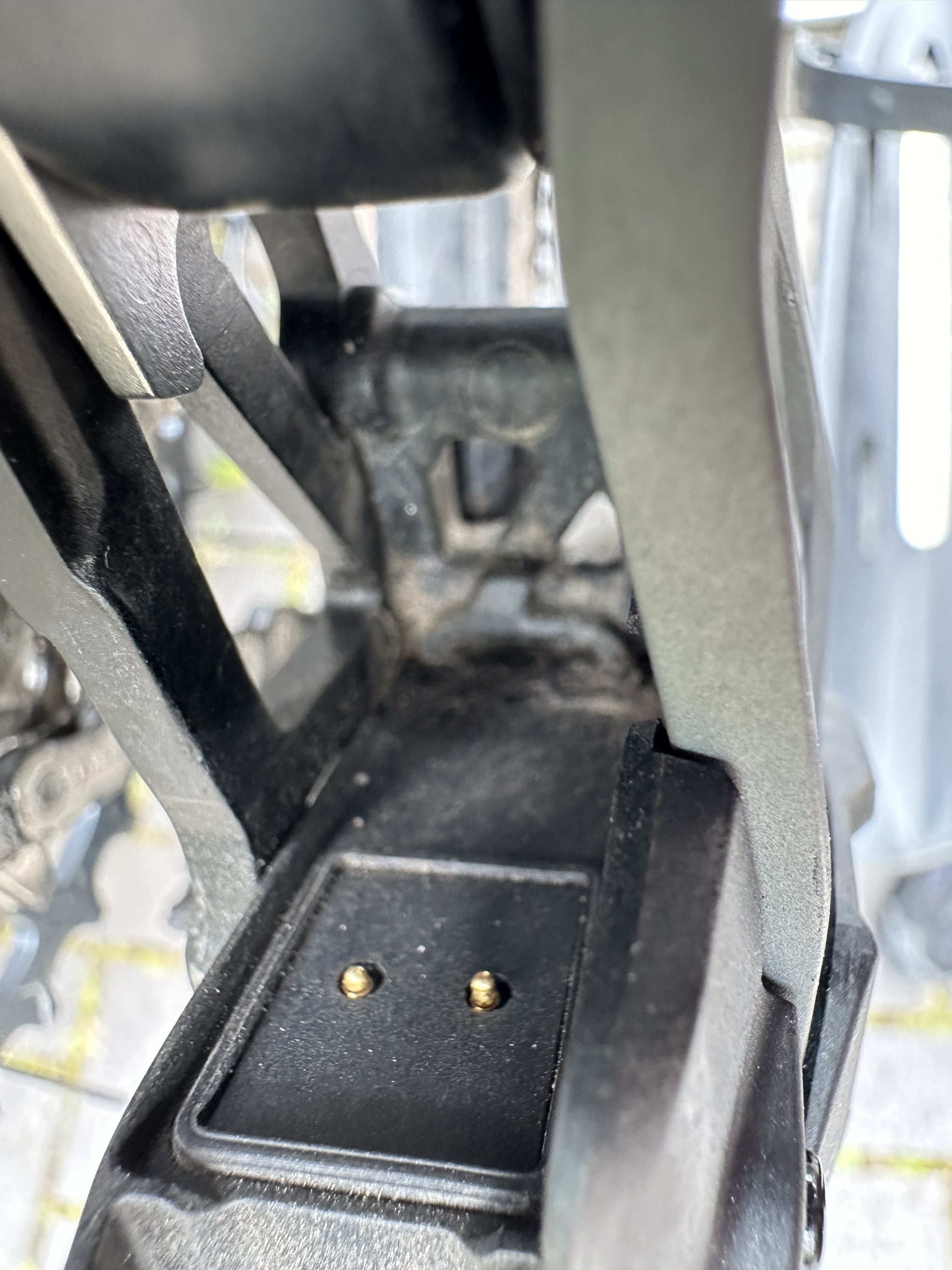

10 months later.
My GX AXS T type has failed with the same problem. One of the two brass pins is slightly recessed
and looses it's springiness which is necessary to make contact.
The problem arises without warning and it just stops shifting mid-ride. A change of battery and no result,
then on close inspection you can see the problem.
Either I am very unlucky or this is a serious design fault.
It is being warrantied and my LBS have been really helpful sorting it but SRAM must be aware
and maybe need to do an upgrade / recall ?
