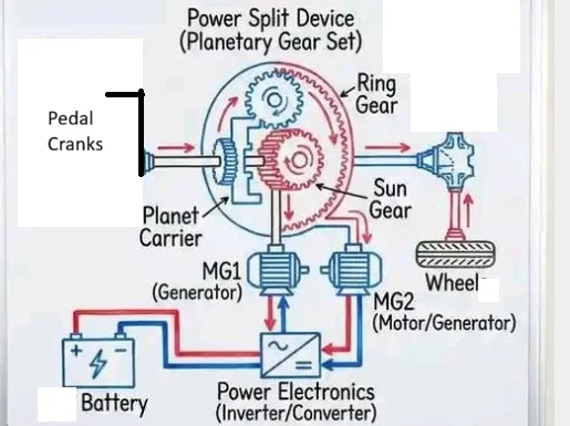

Thanks Gobao - I think the ECVT concept (used in hybrid cars like the Prius) is a great idea to eliminate derailleurs. Use muscle power to spin pedals and electric power to assist etc etc etc.

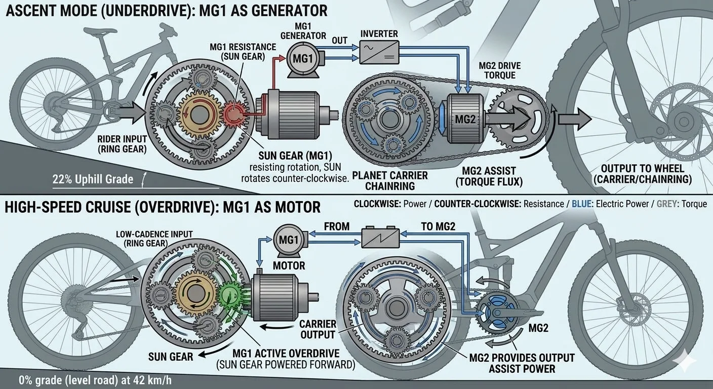

And lastly. The ECVT works as a fixed speed gearbox, if you turn all the electrics off. Your legs drive the planetary carrier. The planetary gears drive the ring gear. The ring gear drives the chainring. The chainring drives the chain. Then the chain drives your rear wheel. There is no virtual pedalling. You are directly driving the wheels, through gears, from your legs.
When the electrics are working. The electric motors act to add pedal assistance, by adding assistance to the ring gear, and rotate the sun gear, to vary gear ratio. That's it. It's still a mechanical gearbox. The fact you don't understand how it works. Doesn't suddenly make it a motorbike.
