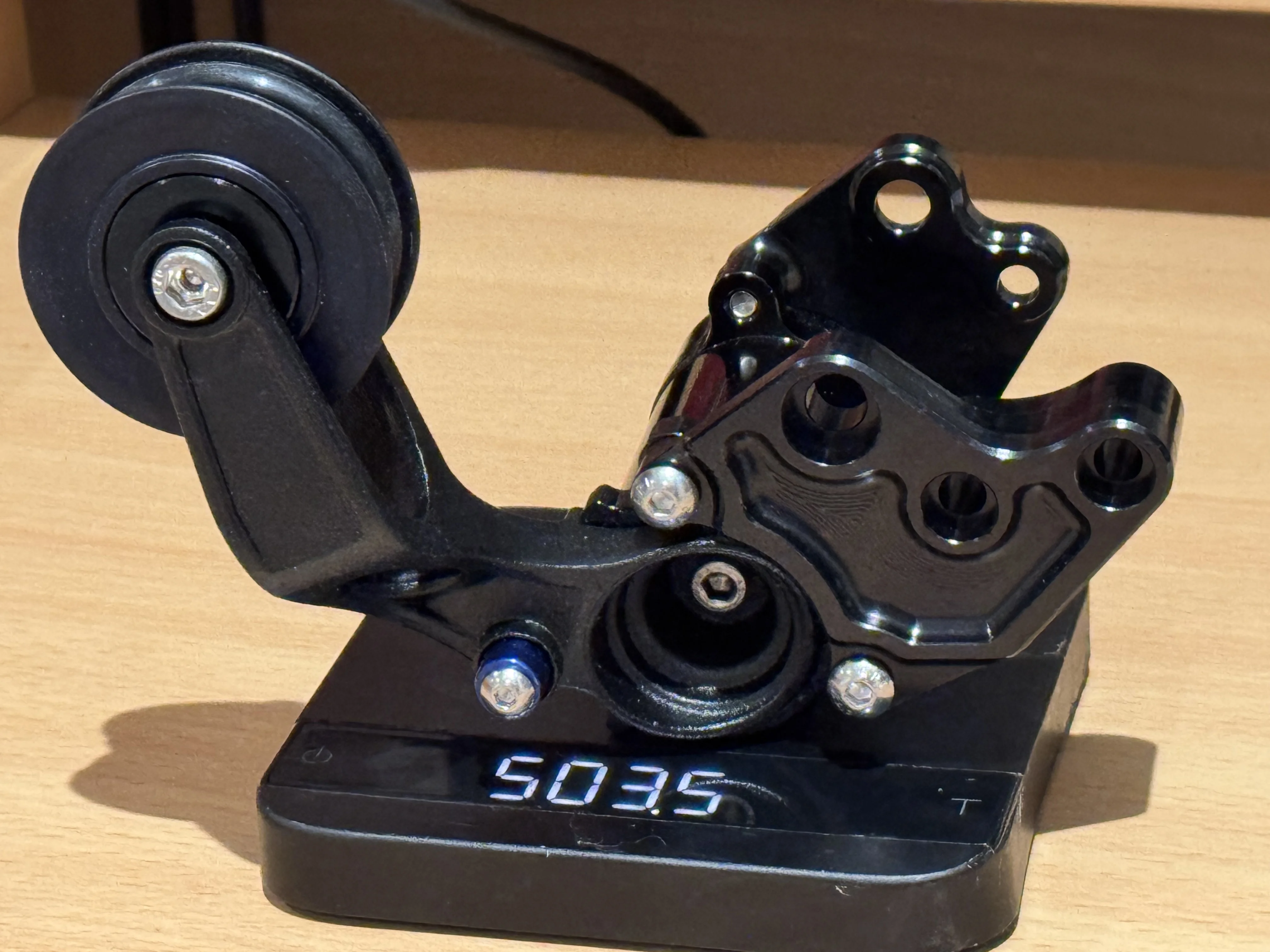

2. A fast spinning chain that now has tension on the underside not on the top as usually. That would mean slop on the top adding a serious possibility of chain derailment.
I think the only possible way of regen in an parallel ecvt mtb drive(what the versions of Gobao an Avinox due to the shape design most probably are) is only possible with active pedaling. The regen capability being different according to the riding situation.
Someone was suggesting a concentric pivot to alleviate suspension issues. Gets rid of the need for a tensioner, as there is no chain or belt growth and obviously, no derailleur. So the chainstay attaches around the output shaft\chainring, on the MGU.
