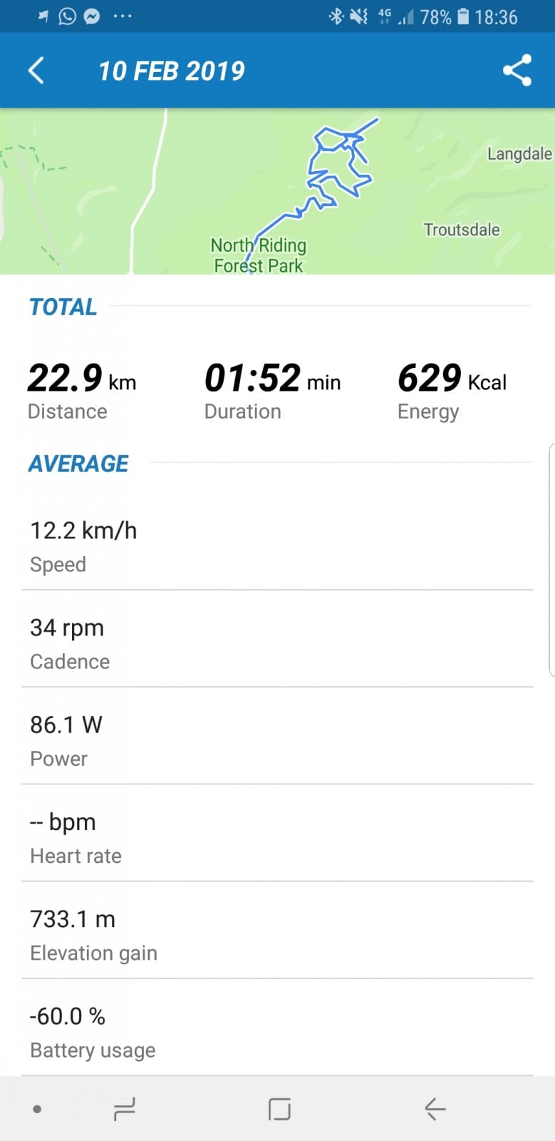

Have tried 4 different i phones as soon as the app opens it shuts straight back down again
I stopped the giant app early to check battery %
Simple observation...cadence!!! You need to be aiming for 80’s or more...your grinding which uses battery
Totally agree. @Mikey1984, try the same ride again, but spin in the 80-90 range and see what you get. If your range is still below 30 miles then I would say you need to take it back to the shop for an investigation of the battery and powertrain.
Totally agree. Try the same ride again, but spin in the 80-90 range and see what you get. If your range is still below 30 miles then I would say you need to take it back to the shop for an investigation of the battery and powertrain.

Had my first full ride out today a lot of climbing into the wind but only used the 3rd light for 10minutes the rest was using lights 1& 2 got 28 miles before the battery was dead.what do you reckon ? i am only a novice rider and about 13 stone spinning as much as possible
Im 13.4 stone...today we did an hard ride jacobs ladder in the peaks 22 miles over 3000ft of climbing all in eco &eco+...i had 33% battery left at the end
