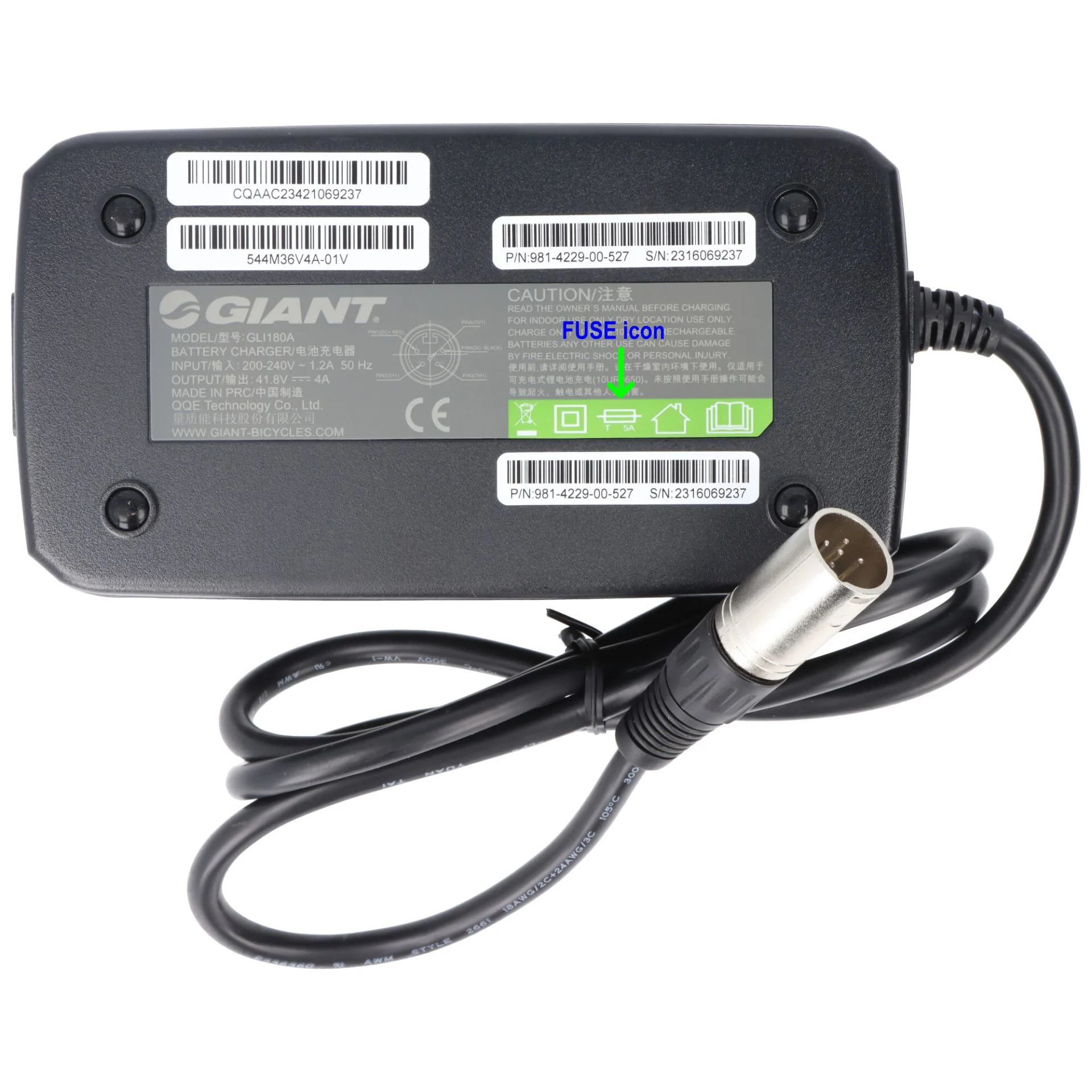

I have an older Giant Aspiro e-bike with a Giant EnergyPak 36V 10Ah (360Wh) rear rack battery.

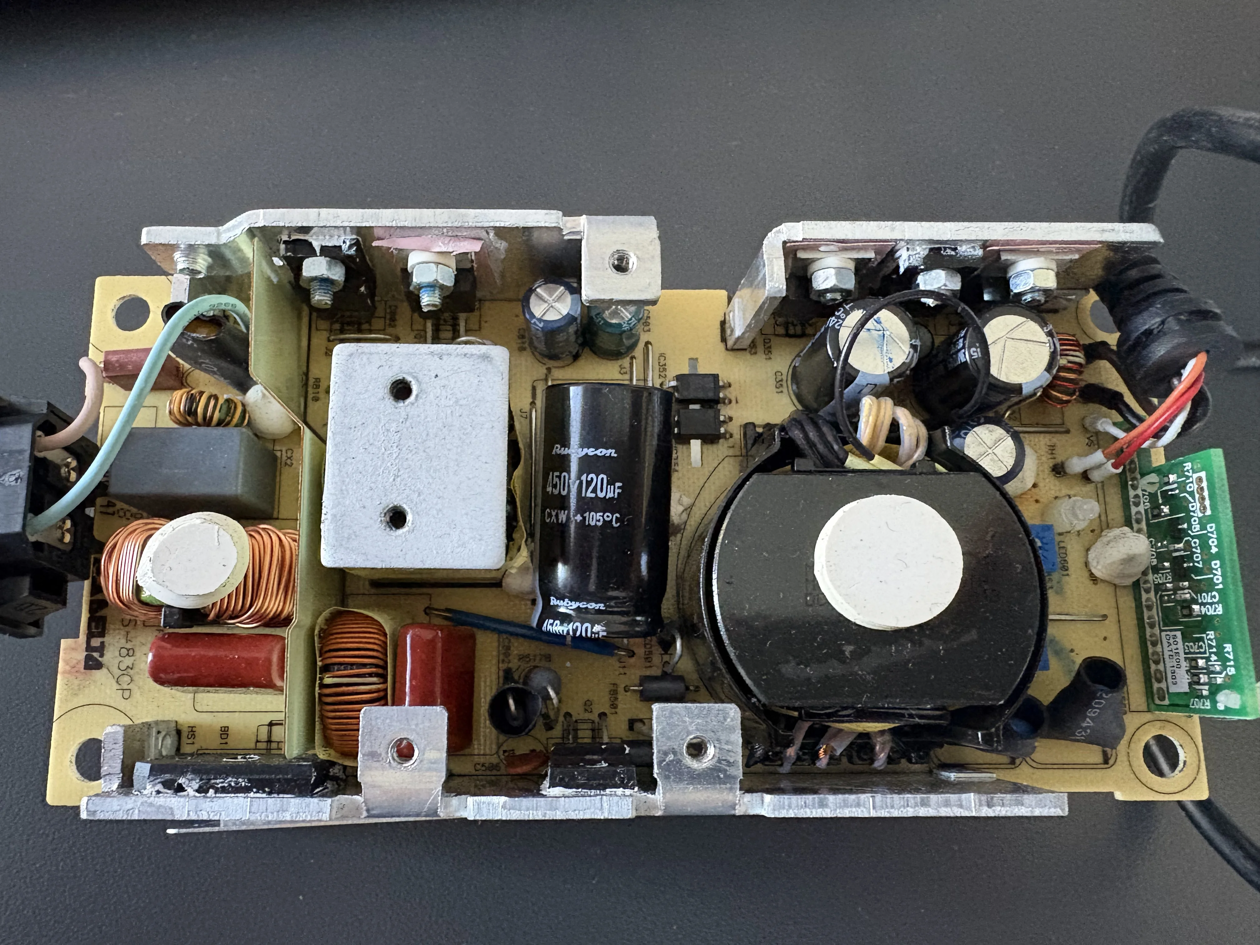

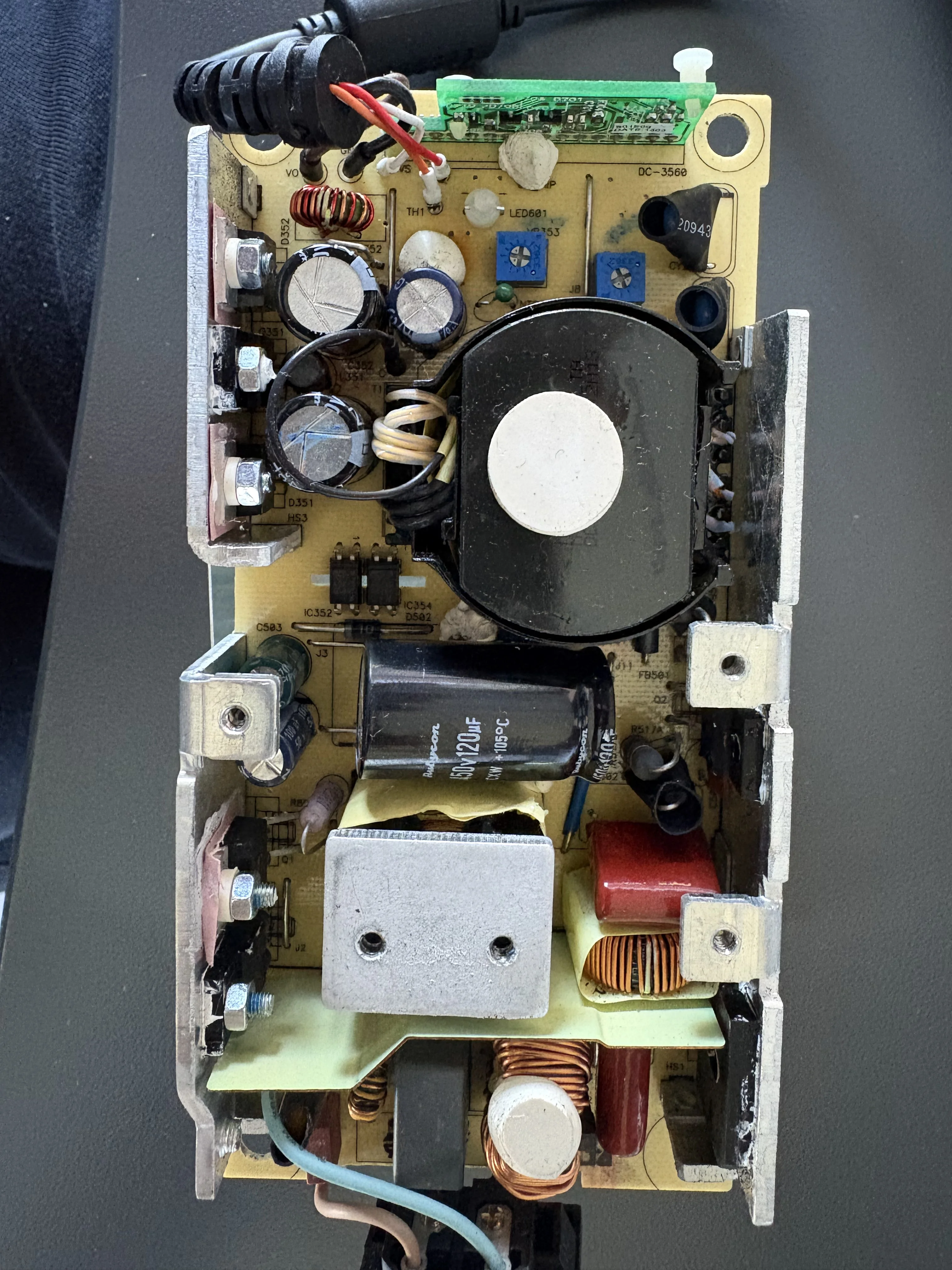

The original Giant charger (DPS-83CB A, 41.5V 2A) failed, so I replaced it with a generic 42V 2A Li-ion charger and reused the original 5-pin Giant charging cable, using only the VO + and VO -

Seems like the original Giant charger will signal to the battery that when fully charged it will show 100% in the display, and this function is lost with an aftermarket charger, using only VO+ and VO-?
Any workaround?

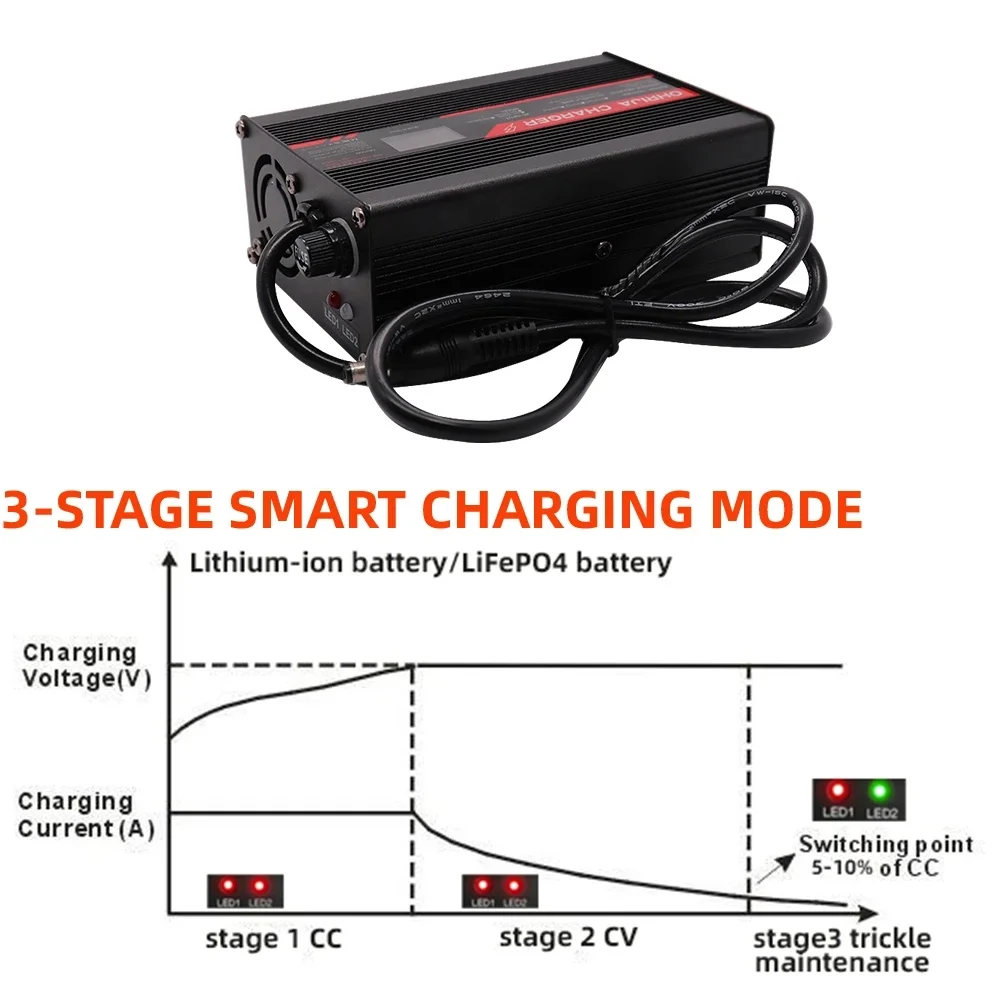

Try leaving the charger on longer and see if the stage 3 trickle charge tops the battery further. Heading back to old charger, did it always reach and report 100% previously ? Charging with an inline ammeter / watt meter can provide good feedback. Handy diagnostic tool.
I slept on this. Your 42V generic charger may not be calibrated correctly and is falling short in the stage 1 constant current or stage 2 constant voltage phases and the BMS is reacting strangely and turning off the tap when it thinks it's full.
You could test this roughly by depleting the battery and timing the recharge. 10.4A battery / 2A charger = 5 hours or so. 75% fill is around 4 hours ?

I borrowed an original Giant charger from a friend and then the battery status was updated after charging.
