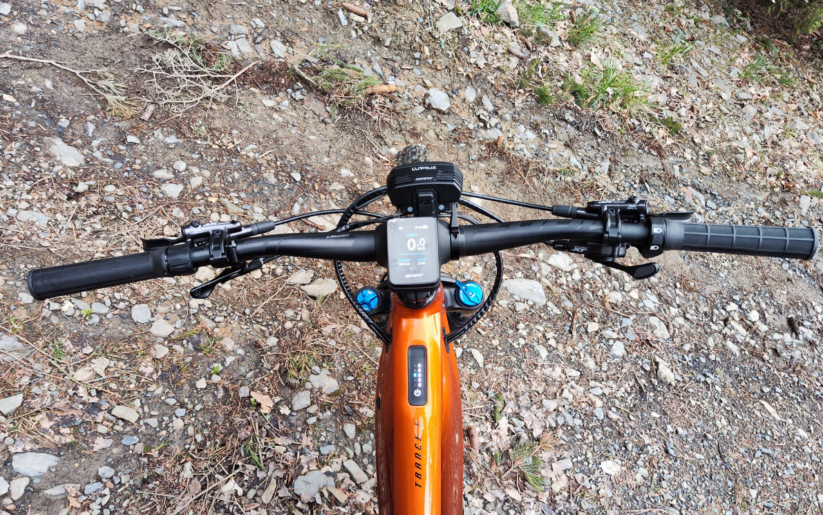

I tried installing the RideDash EVO but so far have not got it to work (I have the same bike as you). I have seen it working on the exact same bike but on a Facebook thread. So I assume it must be possible but maybe a dealer thing to get it working.
Ridedash EVO on a 2022 Giant Trance/Reign E+? - EMTB Forums
(not my bike)
View attachment 89295 (not my bike)
Strange, on our 2021 Fathom, it was a simple job of unplugging the controller cable from the joint in the top of downtube and plugging in the display, then reconnectiing the controller to the other lead coming off the display. Just had to be careful stuffing the cable back into the frame.
Yeah, that's exactly what I did. But no joy. Could be a faulty RideDash EVO but I doubt it.
