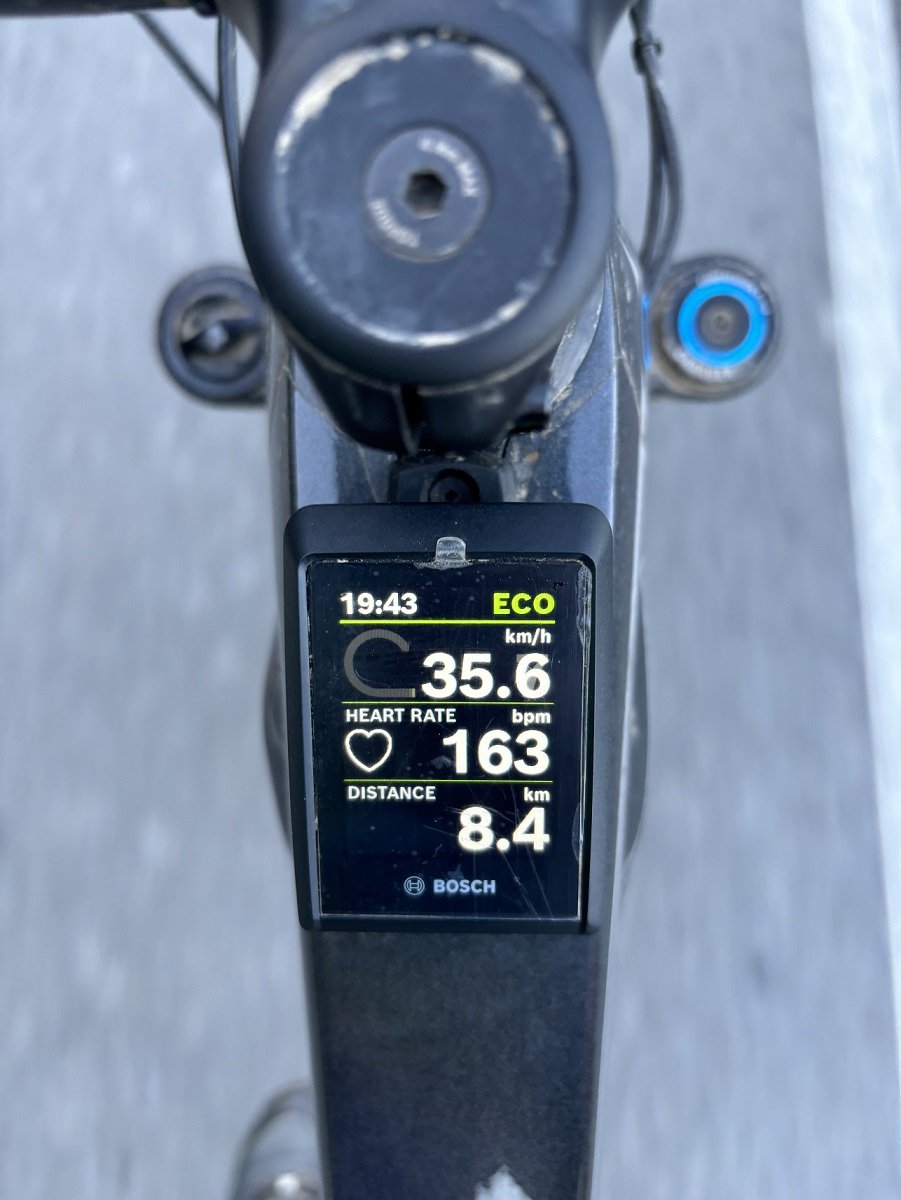

2) load into the data that gets stored on Garmin Connect activity.
If you only want to load data from your rides to Garmin Connect, then that is possible. I do that with all of my rides on a regular basis.
You will need to track your activity with the Bosch Flow app on your smartphone. Once configured correctly tracking will start automatically as soon as you start riding.
After the ride you will have to export the data from the Flow app as .fit file.
In the next step above file can be imported into Garmin Connect.
Once in Connect you will see the track, elevation, speed, cadence, rider power, calories and a few summaries. Unfortunately heart rate is a challenge. Just recently Bosch added the capability to include heart rate from an Apple watch. To date there are no Garmin devices or heart rate straps supported.

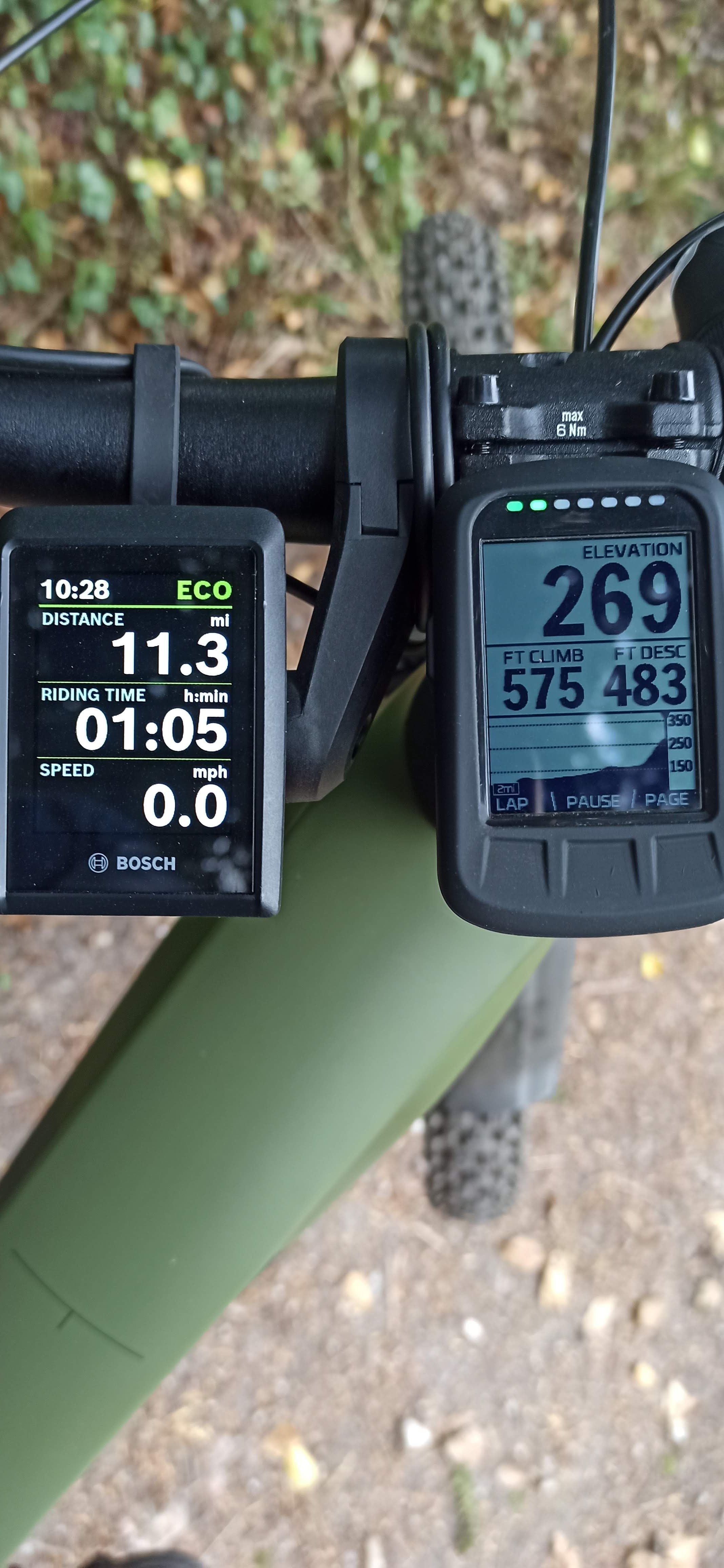

N.R.G.
Nov 17, 2022
31
25
Hampshire
Garmin watch with Wahoo and stock Bosch screen , all the info you need

Or I would be content on using the Kiox display IF i could get gps tracking, heart rate and be able to upload it to Garmin Connect or Strava.
For the time being you need an Apple watch to provide the heart rate. The complete recording can be automatically synched to Strava after each ride, but needs manual export/import to Garmin Connect.
