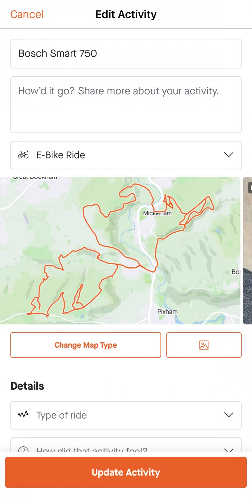

Only if you remember to log onto Strava to tell it manually that it was an ebike ride. If you forget to log on and change it it’ll still record it as an regular bike ride.
now it should automatically upload it as an ebike ride and no need to do anything on the Strava side.
Sorry, that is not correct. After syncronising to Strava, you are automatically prompted with a notification: "this looks to be an ebike ride...; do you wish to change?".
Rob Rides EMTB
Administrator
Staff member
Jan 14, 2018
6,164
13,305
Surrey, UK
Yes, but you actually need to open up Strava and click ‘yes’ to that prompt. If you don’t, the ride will still not be changed.
So you still have to remember to log onto Strava and manually correct it. If you don’t, your ebike ride will be recorded as a regular MTB ride.
Often I won’t open up Strava for a day or so after the ride, and it’s still marked as a MTB ride. So yes, there’s still a manual step involved as far as I can see 😊
With the new emtb mode it should remove that process. I’ll check today. 👍

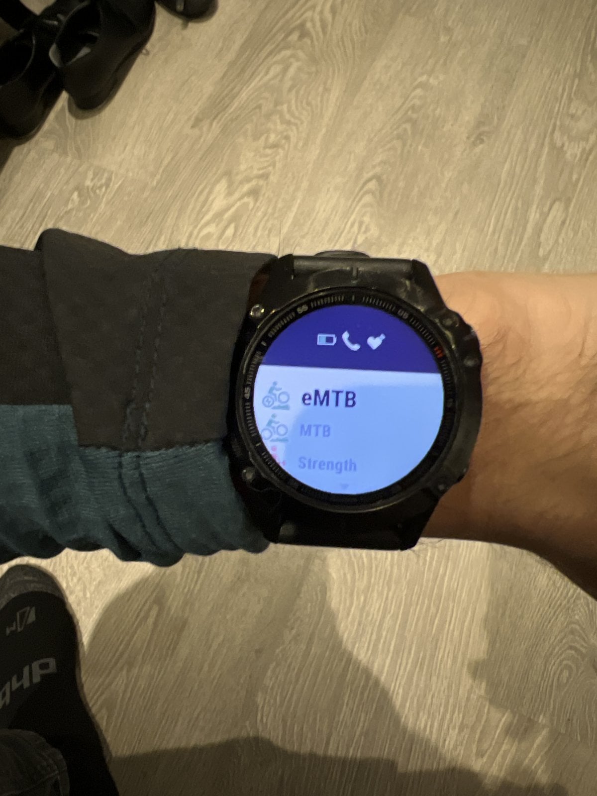

New Garmin eMTB screen

I have just bought my 1st Garmin watch, a Fenix 6s Pro, I would be very grateful if someone could point me towards a beginners how to for setting up the emtb features.
MrSimmo
Apr 24, 2020
1,054
987
The Trail.
I had a look for you but couldn’t find a guide on emtb for the Fenix.
But for me on my Levo, I turned on the bike, searched for sensors on my watch which found 3 bike sensors. I connected all of them with the exception of bike speed (as i have a garmin speed sensor) and then the ebike metrics (power etc) appear as a data field you can add to activity screens.
I think it works the same for Shimano powered bikes.
I also use the ebike-field data field set from Jan on this forum (its on the connectiq store) which gives some extra fields such as motor power mode.
Sorry its not a proper guide but hopefully helpful.
