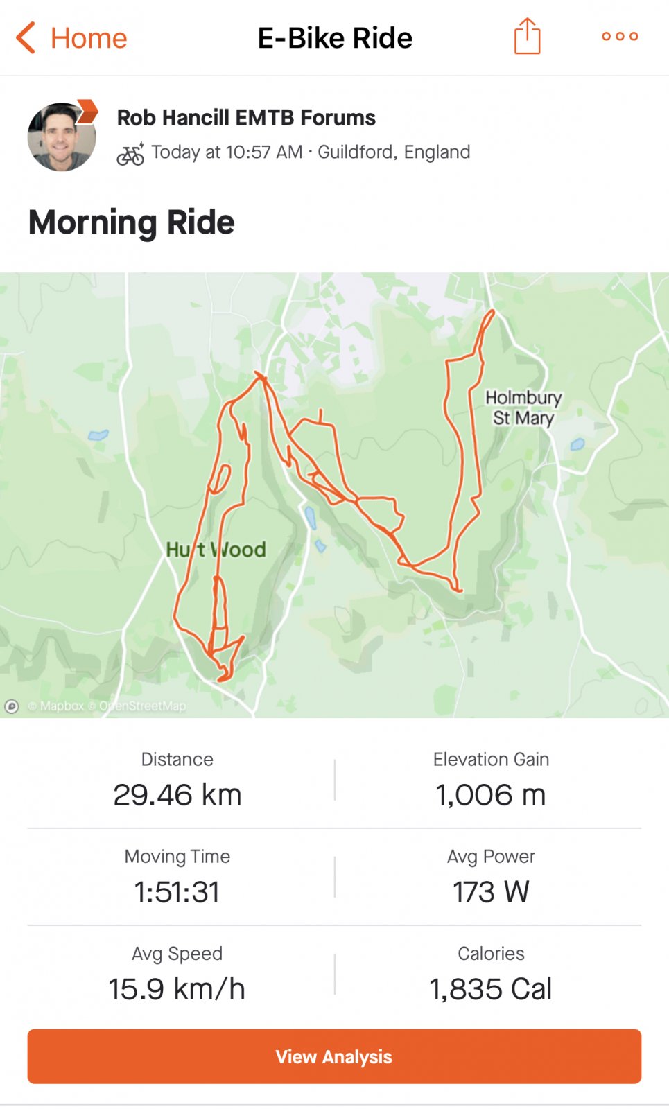

Only if you remember to log onto Strava to tell it manually that it was an ebike ride. If you forget to log on and change it it’ll still record it as an regular bike ride.
now it should automatically upload it as an ebike ride and no need to do anything on the Strava side.
Sorry, that is not correct. After syncronising to Strava, you are automatically prompted with a notification: "this looks to be an ebike ride...; do you wish to change?".
Yes, but you actually need to open up Strava and click ‘yes’ to that prompt. If you don’t, the ride will still not be changed.
So you still have to remember to log onto Strava and manually correct it. If you don’t, your ebike ride will be recorded as a regular MTB ride.
Often I won’t open up Strava for a day or so after the ride, and it’s still marked as a MTB ride. So yes, there’s still a manual step involved as far as I can see 😊
With the new emtb mode it should remove that process. I’ll check today. 👍

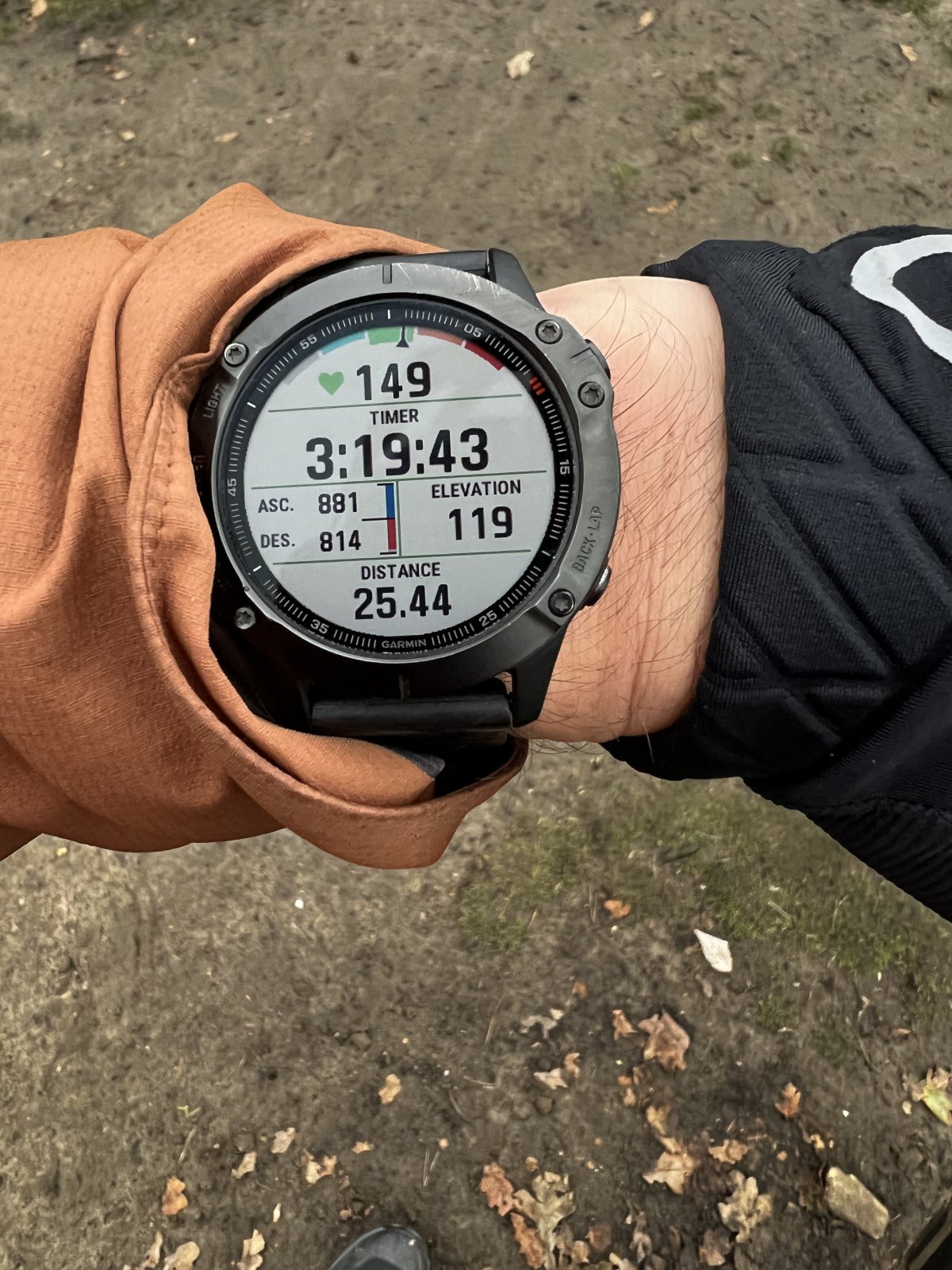

New Garmin eMTB screen
I have just bought my 1st Garmin watch, a Fenix 6s Pro, I would be very grateful if someone could point me towards a beginners how to for setting up the emtb features.

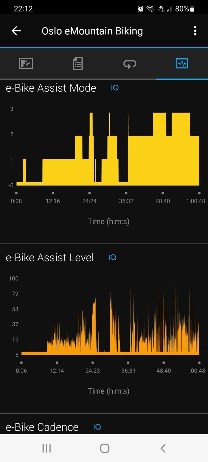

Riding a Rise with the Garmin Epix 2 watch (Orbea RS Toolbox app installed), I was surprised to find that assist mode, assist level etc was logged during the eMTB activity. Does the watch know what these fields are?
