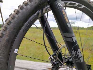

Got one on my Kenevo. 180mm and lovin’ it!!!
that looks awesome!

Ebike specific only comes up to 160mm. Kenevo needs 180. Supposedly the Lyrik that came with it wasn’t ebike specific so can’t say I notice a stiffness difference either way. Love having the tun-ability and it feels less harsh than the 2018 Lyrik. Newer Lyriks may be even smoother according to the reviews but still lack the tuning range. They look the bomb in orange as well!!! ?
