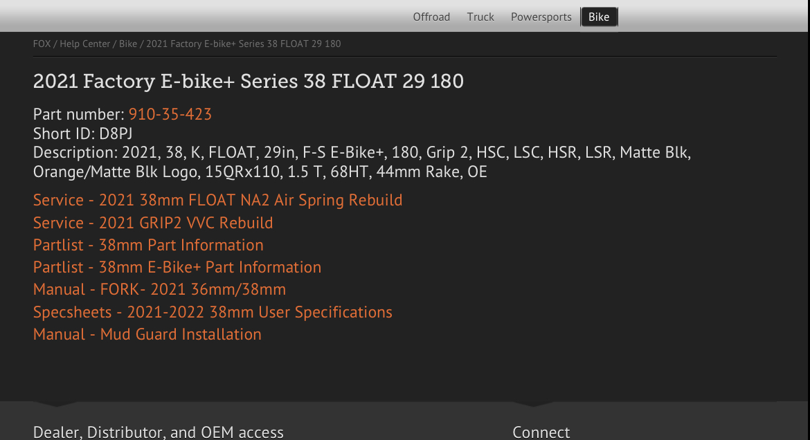

Here’s an example of the e-tuned from Fox ID:
I wonder if it's a DIY alteration of the shim stack or a replacement damper. Plus possibly a different air shaft. A quick Google has shown nothing.
The first fork is an OEM only fork.............presumably tuned according to the brands requirements rather than the standard Fox 38 E tune
