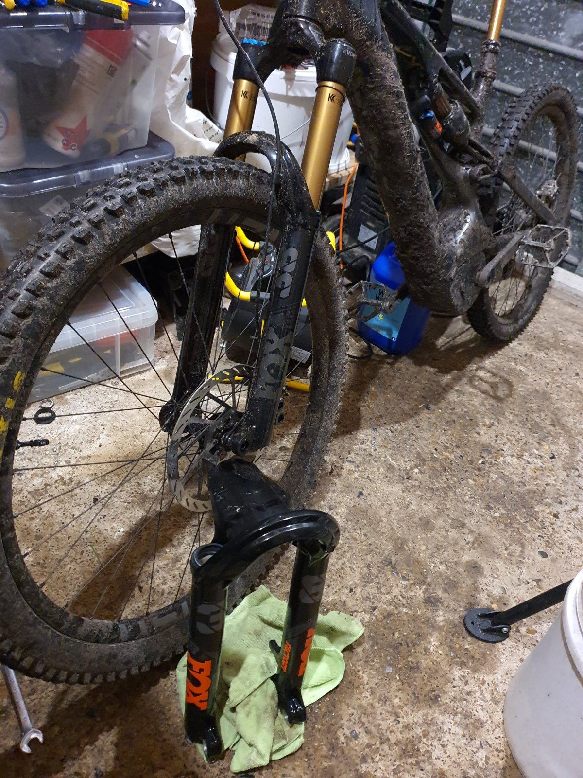

Have you already checked this?
- If the fork sucked down after you lowered your air pressure, cycle the fork several times to equalize positive and negative pressure
How to do this?
- Take the wheel off. Put the axle back on. Put the end of fork on something soft. Stick your foot on the axle. Pull up on the handlebars until you are fully extended and hit the stop. Push the fork down. Cycle the fork this way several times.
Thanks for your reply and advise. I cycled my fork as described with setting up my Shockwiz (with the wheel attached, but I extended it completely), it didn't change anything. Maybe the fork is too soft in the beginning and i should add some air, as it responds just to the weight of the bike (est. 22 kg)?! I'm going to measure the remaining travel, I wonder if its around 150 or 160 mm......

Seems I'm not the only one with 38 issues
I had mine apart today and there is obvious wear on one of the pad things (what are they called please? Sit below inside the lowers below the wipers and the foam rings)
Like the fork is out of alignment or something. Would explain the stiction

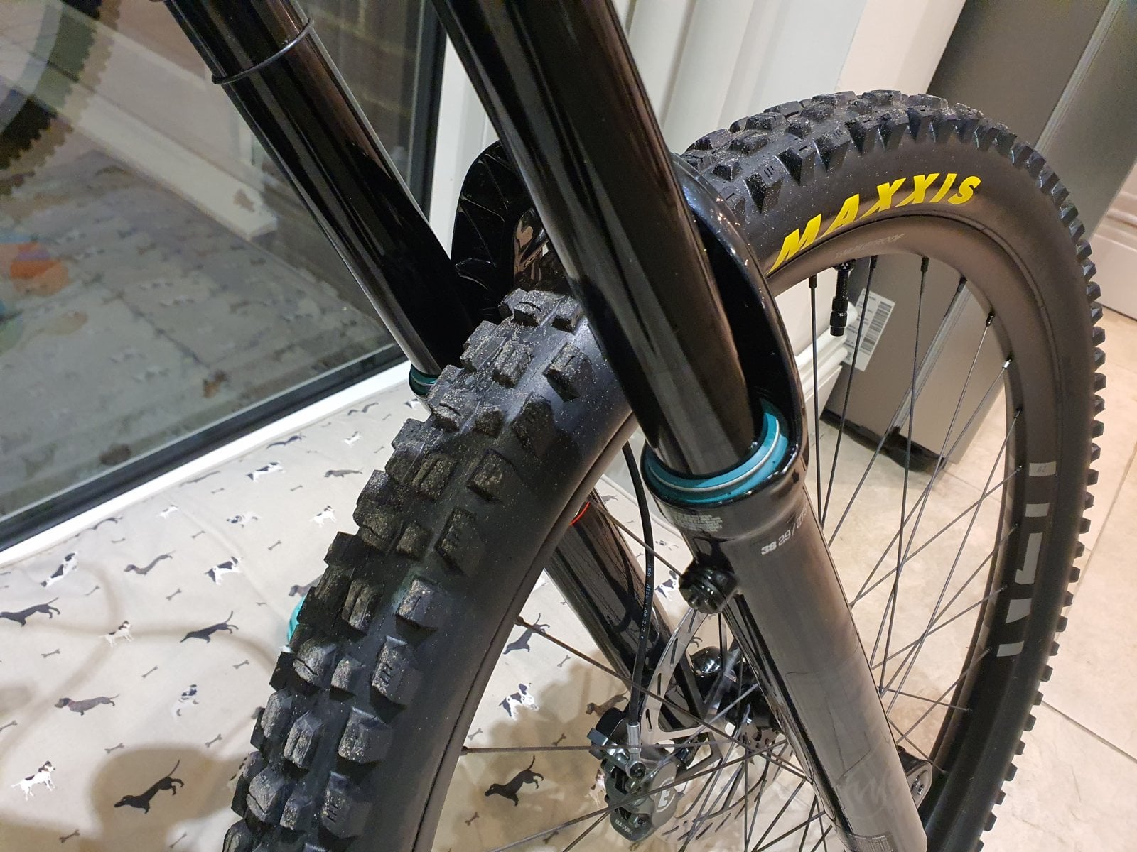

Once you have replaced the oil try running a mudguard for a bit of dust seal protection. There isn't much oil in them anyway so water and dirt being dragged in is going to do nothing positive for that nice first touch you are after.

a properly designed front mudguard...even a small one like the Enduro guard.........helps to keep mud water and grit away from the seals on the fork.
