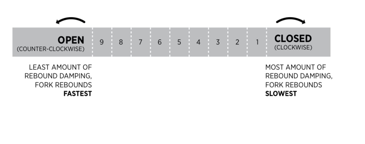

"even with the rebound fully open. Open doesnt mean no rebound in this case" as fully open means there is very little to no oil going thru the rebound circuit which in my mind would make your fork very lively even with low tire pressure! Which Fox 38 are you using? Grip 2 damper? In the video below, I am cruising down a trail that has 4-6 foot table top jumps (medium size) and what I see is a fork that pops up a small amount when I land. I would think if I set the rebound any faster, I would be landing on my back tire and coming down a lot harder on my front tire. I am running around 18 PSI front and back with Cushcore on a Kenevo SL. Spring Rate: 92 PSI with 3 volume spacers, HSR:3, LSR:2, HSC:6, LSC:14, I weigh 88 Kg with my gear. The video is pretty boring but it does show how the fork behaves on small jumps starting around the 4:30 minute mark.

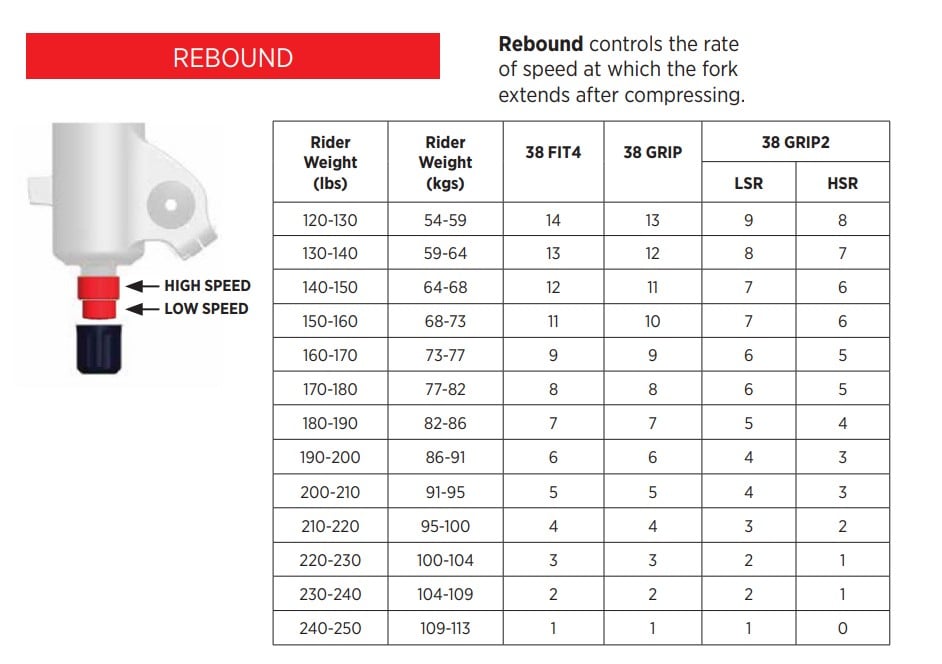

With fully open I mean 9 clicks from closed, as described in the fox tuning guide. Propably this isn’t fully open.

Your low Speed rebound is definately waaay too slow with just 2 clicks.

Thanks for finding the article. It still makes no sense to me how a rider can run a fork without very little rebound unless they are weighing in at under 60 kg but with rebound being directly related to spring rate (air pressure), when you mentioned you were up in the 90 PSI range, it had me scratching my head. Then again, I seem to be under the recommended spring rate at 92 PSI for my weight (97 PSI) and am probably only getting around 10-12% SAG. As I dive deeper into all of this, I am starting to see a lot of personal preference and riding style creeping in! As long as we are enjoying how are bikes are feeling, vive la différence!

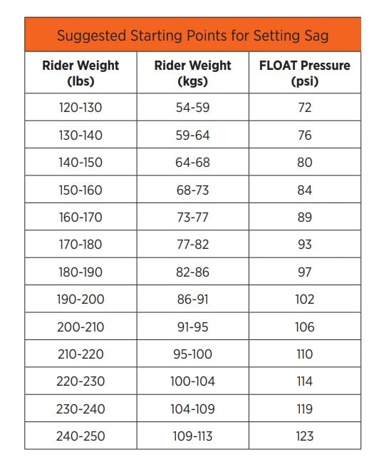

The fox recommendations for pressure etc don‘t account the bike weight o r riding style. I suggest you to set sag properly to 20%, so your fork gets softer on small bumps, and to set your rebound faster, that it recovery fast enough for the next hit.

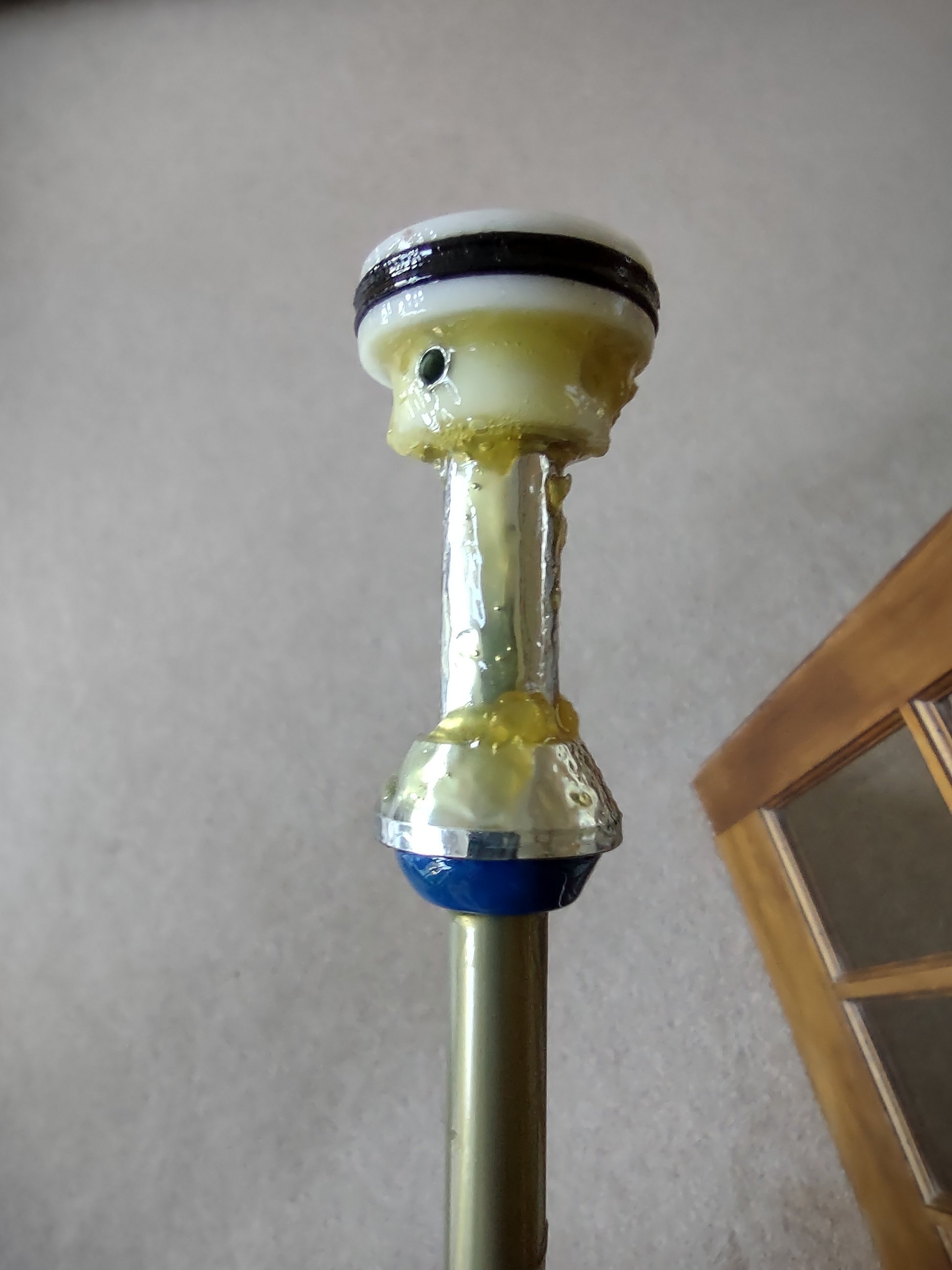

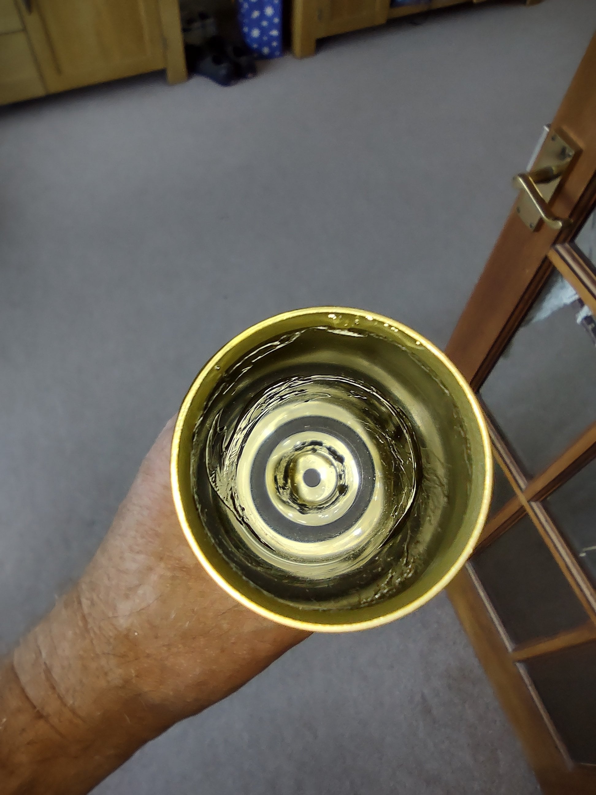

Edit: Finally got around to taking apart the 38 that was giving me grief. Bushings were okay (not loose, not tight), grease in the air spring wasn't too bad. The problem seemed to be that it came with so many tokens that allowing the sag to sit low was a recipe for ramp-up disaster. I took out 2/4 tokens, regreased lightly with Slickoleum, added the Supergliss 68k/100k mix, and set sag around 15-20%. Working worlds better now on small and medium hits. I might add one token back trying to find the right balance of progression and linearity for me.
Wow. Stripped the air spring on my fairly new 38s tonight and removed all the excess grease. Took my KSL for a spin over a dh rough field locally near my house. Night and day. Worth doing this is you haven't (Shame it needs to be done on a new bike)
