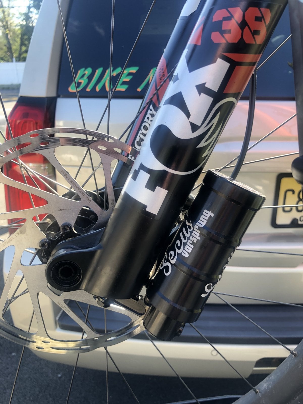

Two rides in on Vorsprung Secus and it has transformed this fork. Super plush as I had hoped. I would have gone straight to coil, but those were backordered longer. No need now.
Nice. Are you running any tokens?
As an aside, if you notice the fork losing pressure, one of the bolts at the footstud assembly of the Secus sometimes isn't torqued right from the factory, resulting in a very slow leak. Spraying some soapy water around it will help spot any issue.

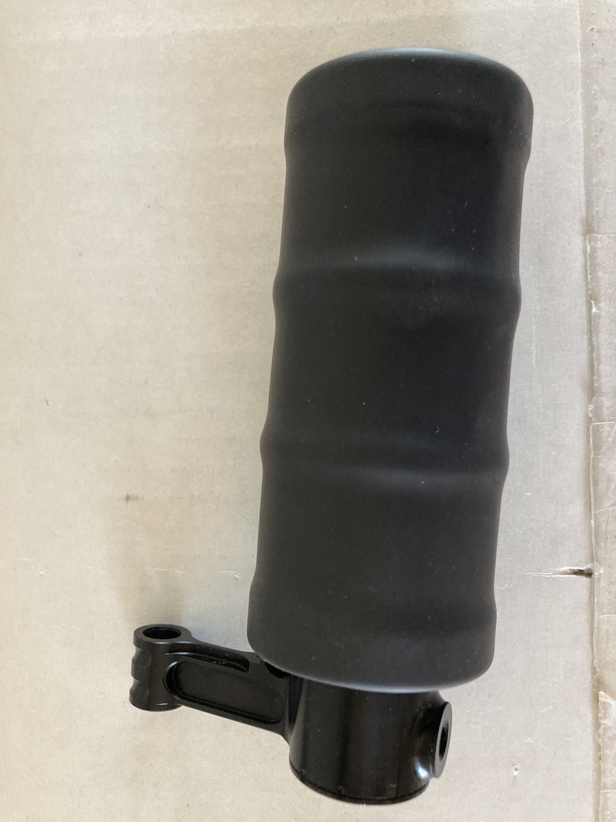

This is why I added the Secus to my 38. I don't think it's possible to get a stock 38 to feel like you want no matter how you set it up. I'm sure some revalving would work, but slapping on the Secus is a simple quick fix.
Here's a Secus with some XHF 50mm heat shrink tubing to protect the barrel. It's reasonably thick and tough for what it is.

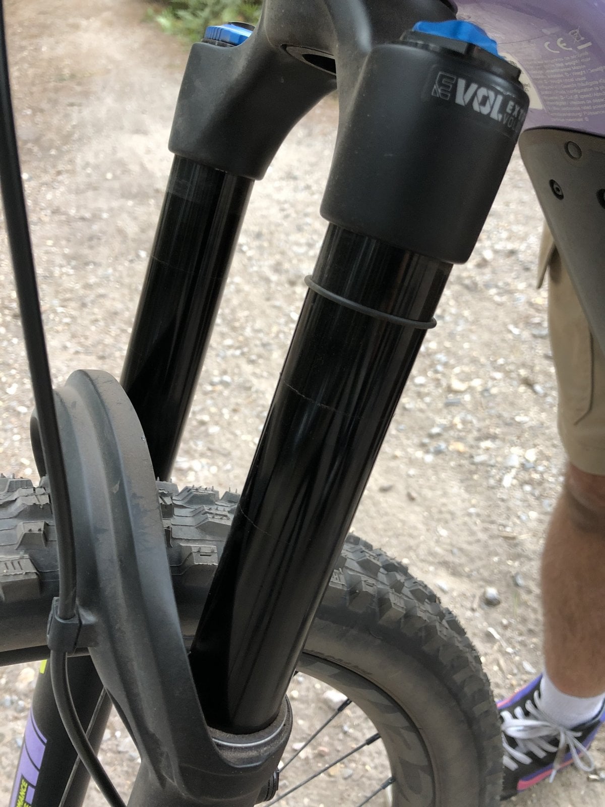

Big thanks to @MBag85 for all the help and advice set up on my 38’s ? zero tokens - 20% sag with just over 100psi after a good few cycles every 20psi when inflating and there now like butter ??
Well done. I believe the problem for most is the harder tune the brands tend to specify for the forks whereas the standard factory tune is medium. That stiffer tune coupled with one or two tokens means the recommended air pressure for anyone other than a heavyweight or a pro downhiller is much too high. My Fox 38s on my Whyte E180 are medium tune throughout but even so my air pressure is below the Fox recommendation and I go for c 27% SAG and very little HSC............unless I am expecting bigger drops in which case I dial up HSC a couple of clicks and match that with more rebound. In both setting the fork is super plush but with good ramp and no bottom out.
