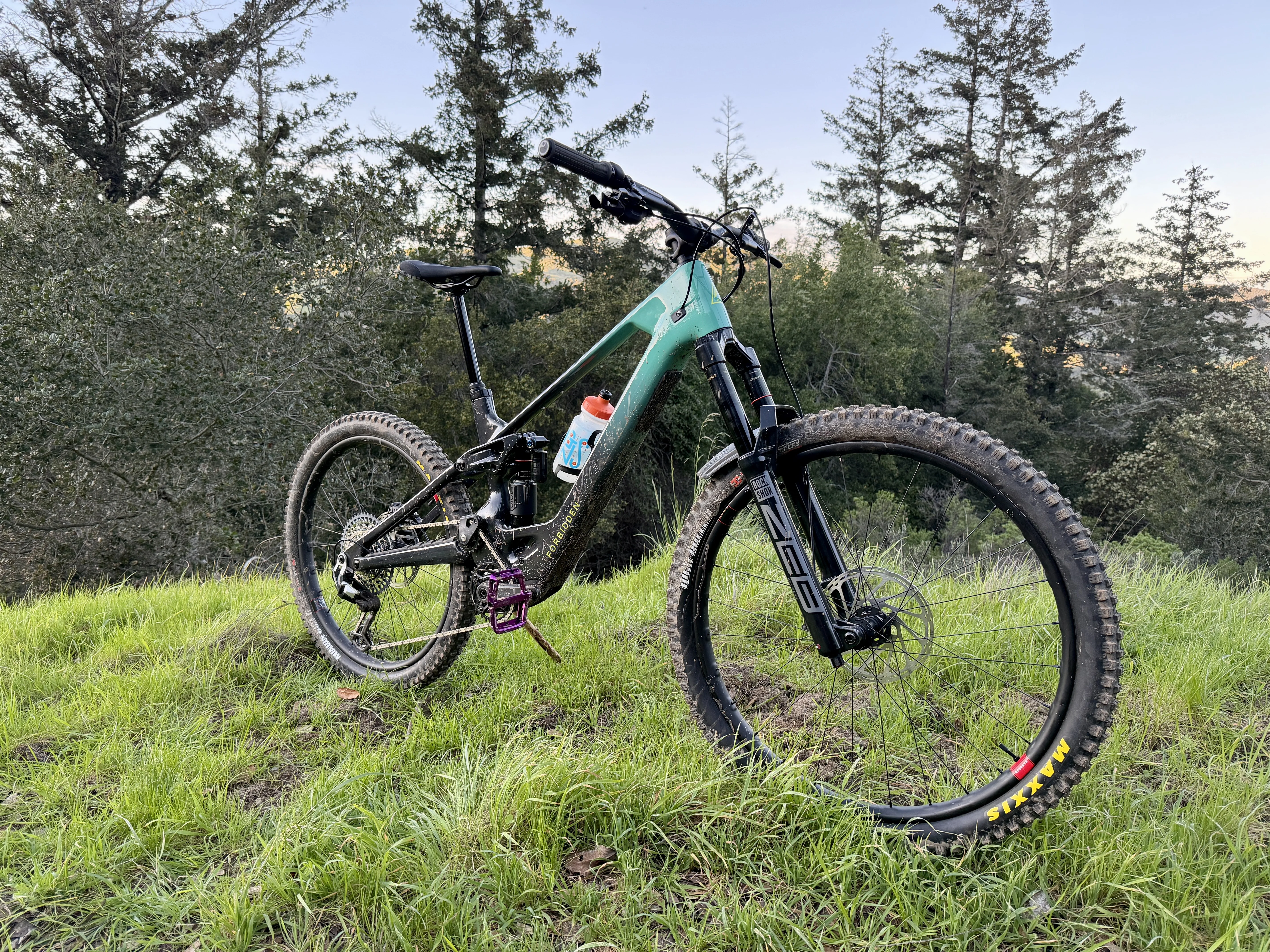

Took mine out for first ride yesterday. Even coming from a normal druid the front end feels very high, its also surprising how long the bike feels even in large. I own the druid v2 in s3 and they say sizes match but the core feels longer and taller. Motor noise is alot more than the amflow, i noticed this on my friends lite too. Bike fully rips downhill and the avinox system is still so better than the levo4 i had previously. Think the front ends going to take some getting use too! bike looks gorgeous.

It’s definitely longer feeling than a v2 Druid meat bike. Felt like an oil tanker trying to go up and around some switchbacks.
I love the eDruid stack. For me, the v2 Druid was way too low.

i got same wheels! yeah took bit getting use to, i love my druid v2 but this feels alot more bike than it. looking forward to getting out again tomorrow on it.

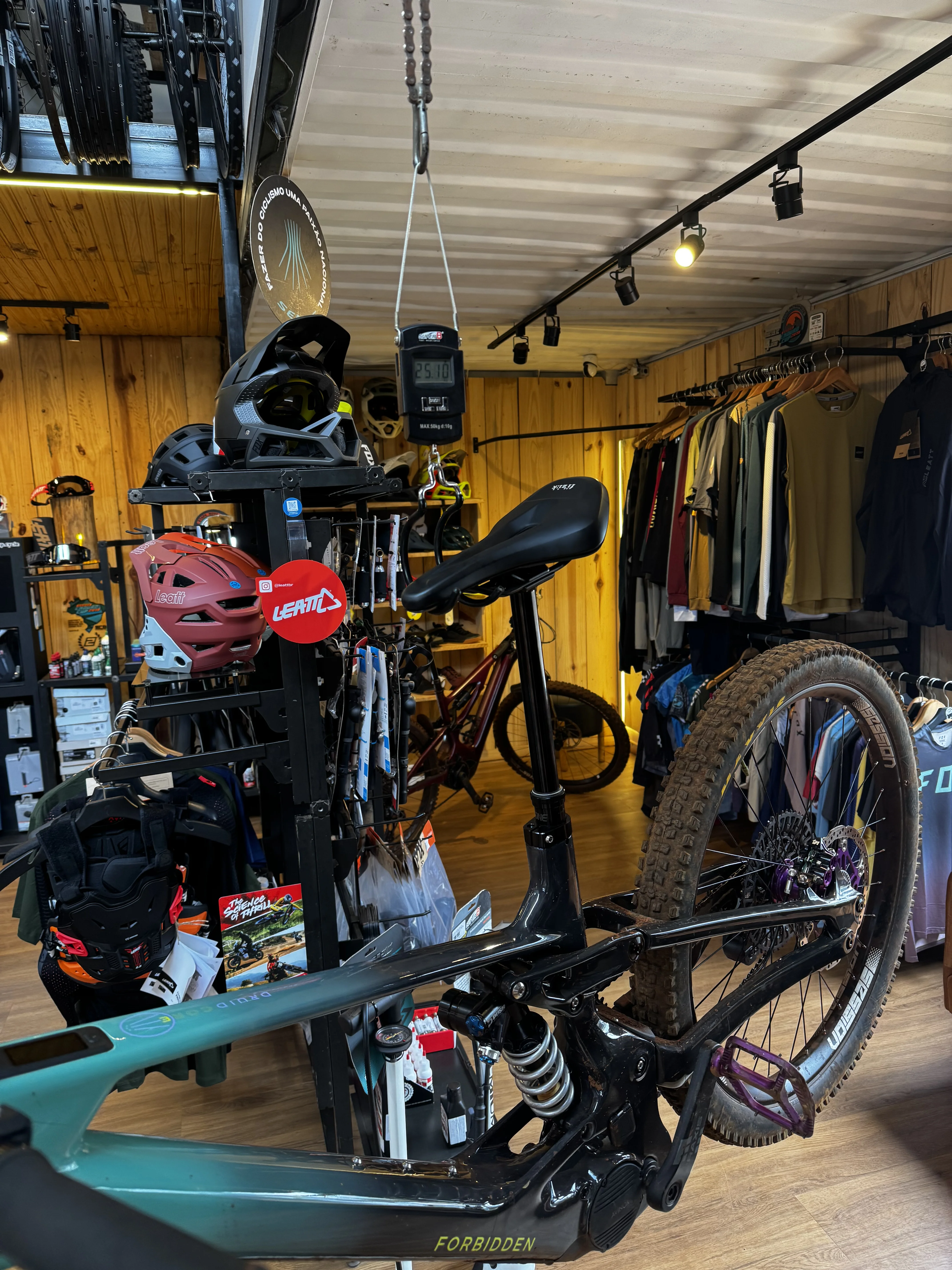

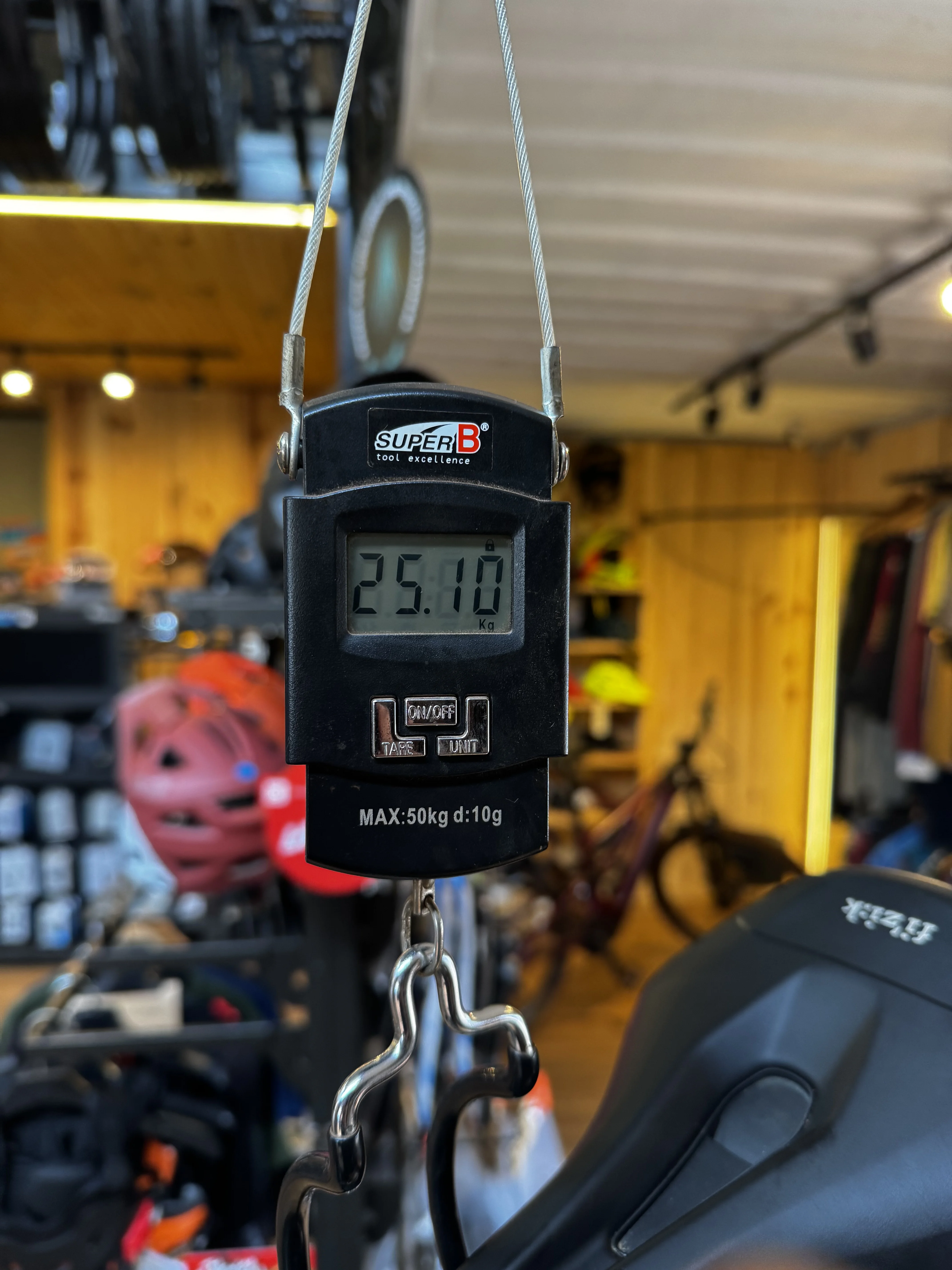

My Core 3/Size 3 is 22.62 kg/49.87 freedumbs before pedals with carbon wheels & bar.
