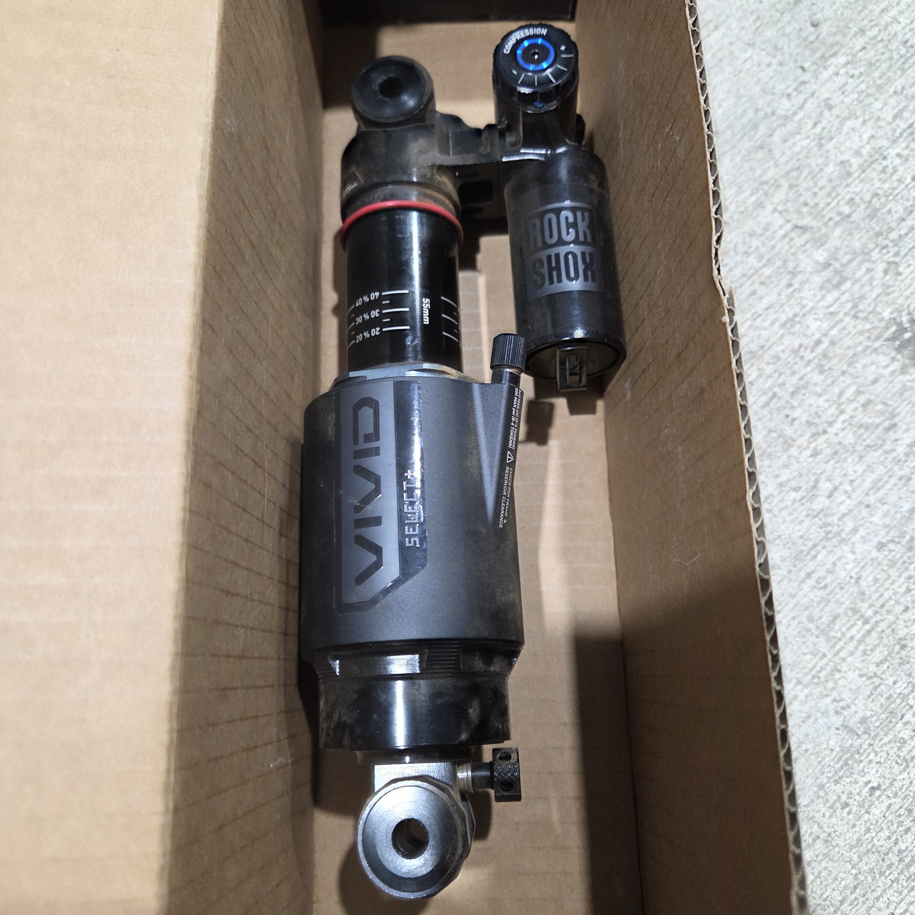

Anyway enough weight weenie talk. I'm selling my vivid if anybody is interested DM me but must be in the usa.

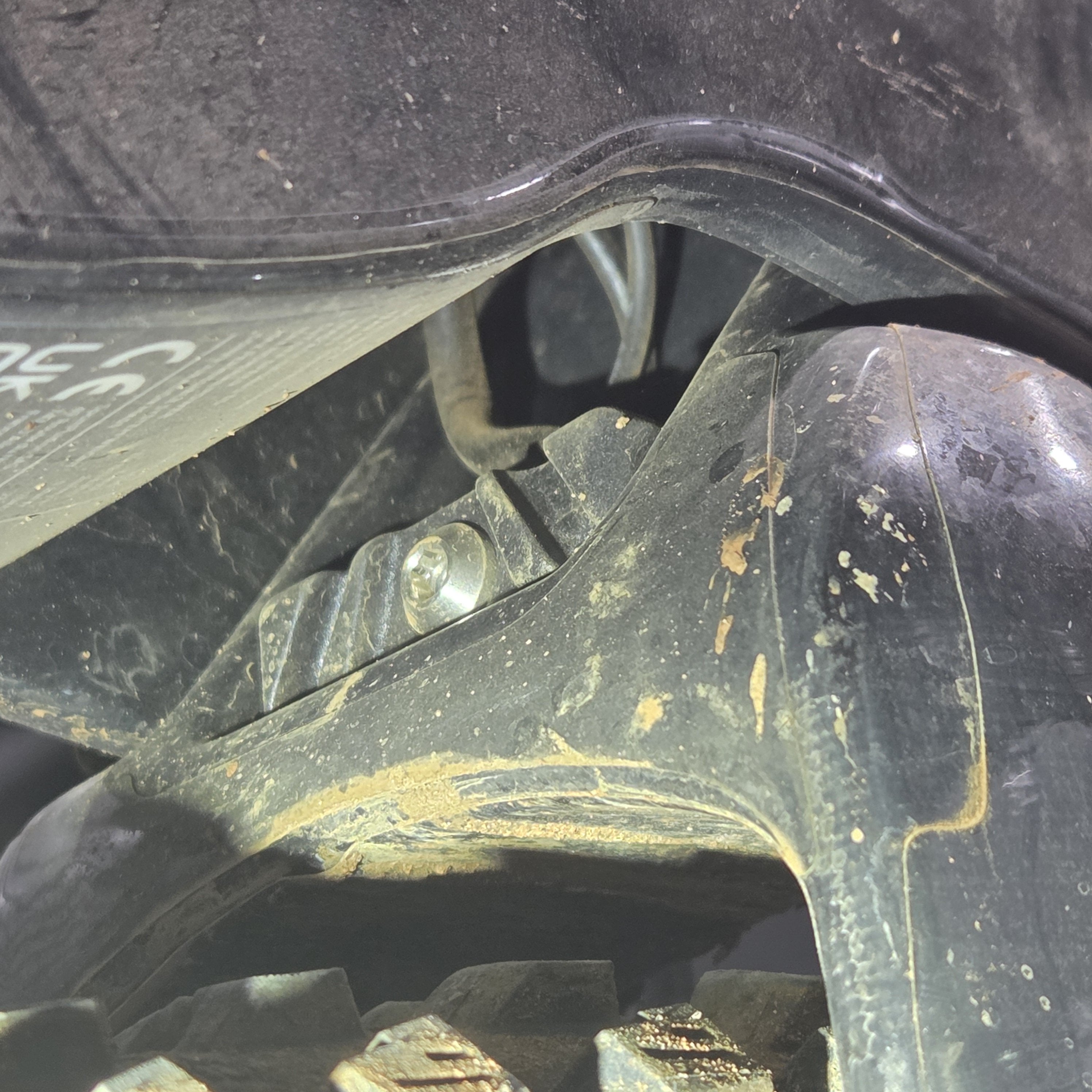

Hey yall. Picked up my teal S2 Druid Core build 2 last weekend and love the bike so far. Hate the Mavens though, wandering bite point worse than Shimano and way too heavy lever pull.
I had some TRP Evo Pros on the way that arrived on Friday, so I started the install. Forgot I'd have to drop the motor, but it was only two bolts and some cables.
Anyways, I got everything installed using the instructions here and pretty quickly noticed when cycling the suspension from fully compressed to full extension the hose is kinking. I've tried with TWO TRP hoses and it's looking like I might need a third now.
Has anyone else installed or had a shop install TRP brakes on their Druid without issues?

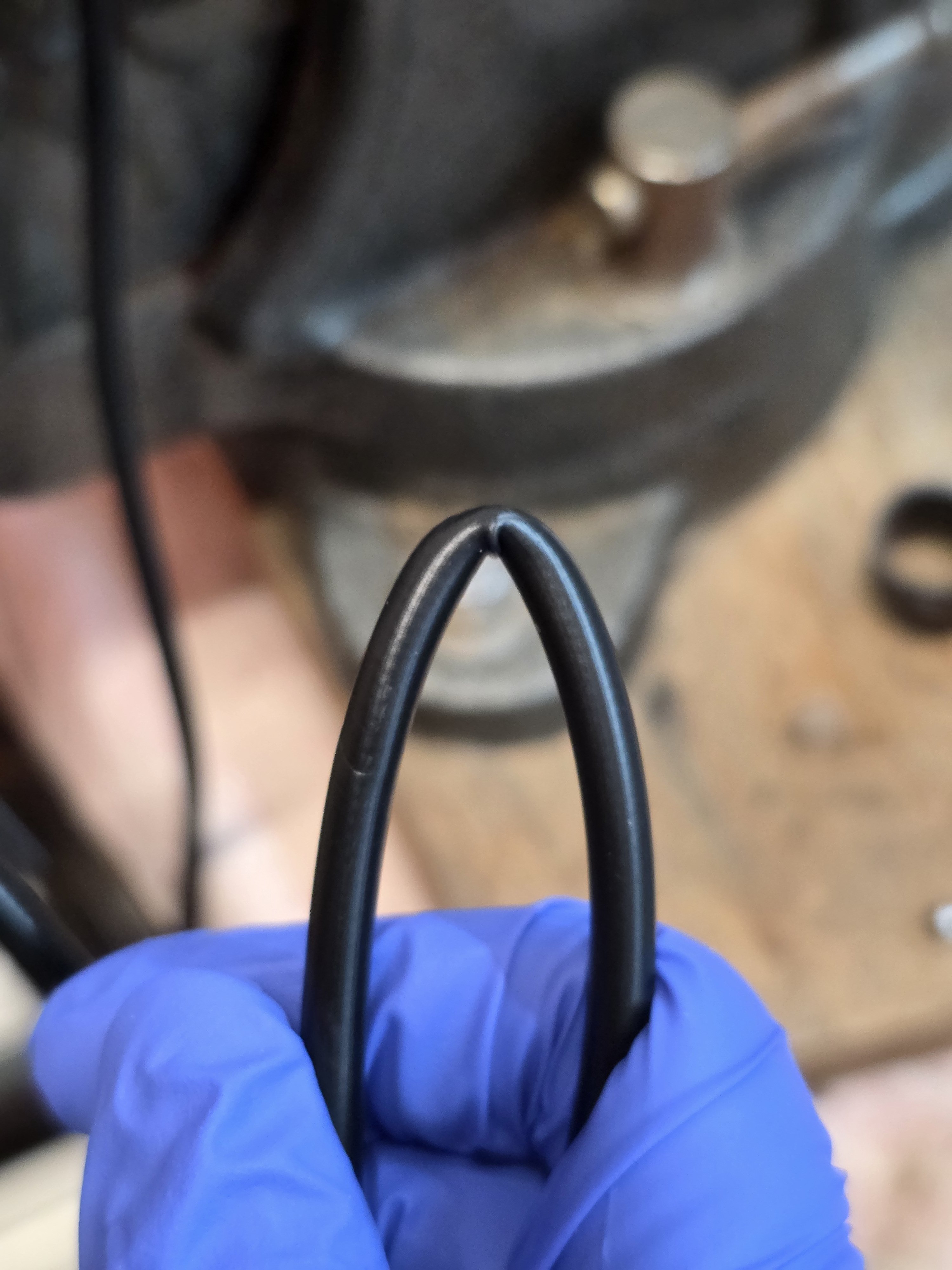

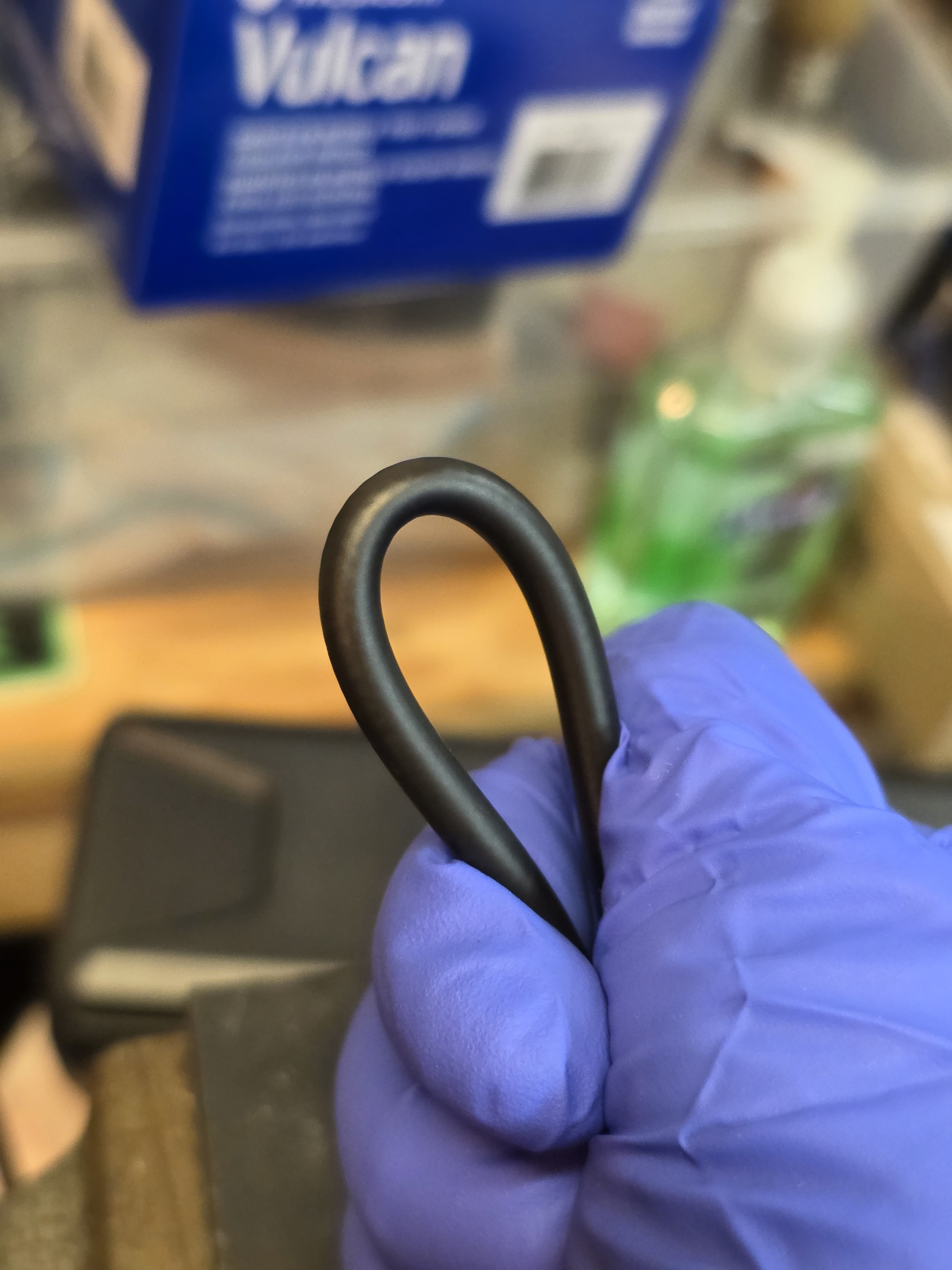

Update on this.
Here's a Sram Maven hose at a tight bend radius:
And here's a TRP hose:
I think the TRP hoses are just not going to be compatible with the cable routing design on these bikes. I've got an email conversation going with one of the Forbidden support guys so I'll update again if I get any tips from him.
Some good news, however, is that the TRP banjo fitting is nearly identical to the Sram Maven hose banjo fitting. They're both 6.5mm wide with a 6.0mm inner diameter. The O-ring counterbore size is slightly different, but I don't see any issue with using a TRP banjo bolt (it's longer but the same diameter with a slightly larger head) with the Sram banjo fitting and Sram O-rings. I think that's what I will try next.

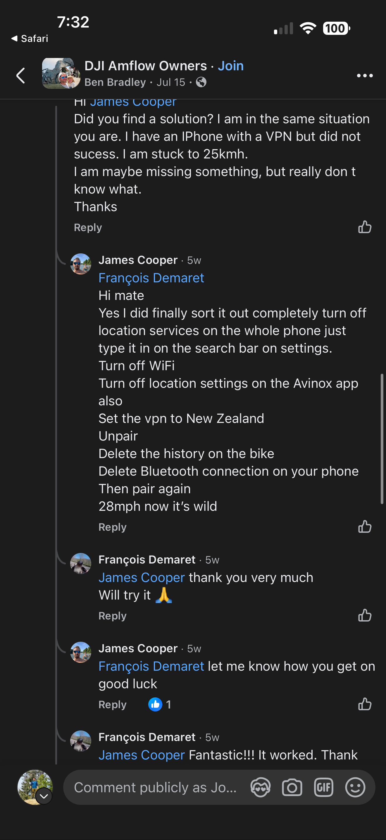

Is anyone else having trouble changing the region with “the VPN trick”? Worked fine for my Amflow, not for my new Druid Core.
Worked fine on mine first attempt
Mine is set to the US, you don't get the Class 3 or whatever it's called option though but that's fine, 32kph is more than enough really and I rarely hit it anyway

I'm thinking about either using the Sram hose like I mentioned or picking up some Jagwire aftermarket hose at the suggestion of a friend, just in case the Sram hose changes the feel of the TRP brakes too much.

Just heard back from Forbidden, one of the guys runs Shimano BH-90 hose with his TRP DHR brakes on his Druid CorE. He suggested trying the Sram hose if it works because that's the one they did all of their testing with.
