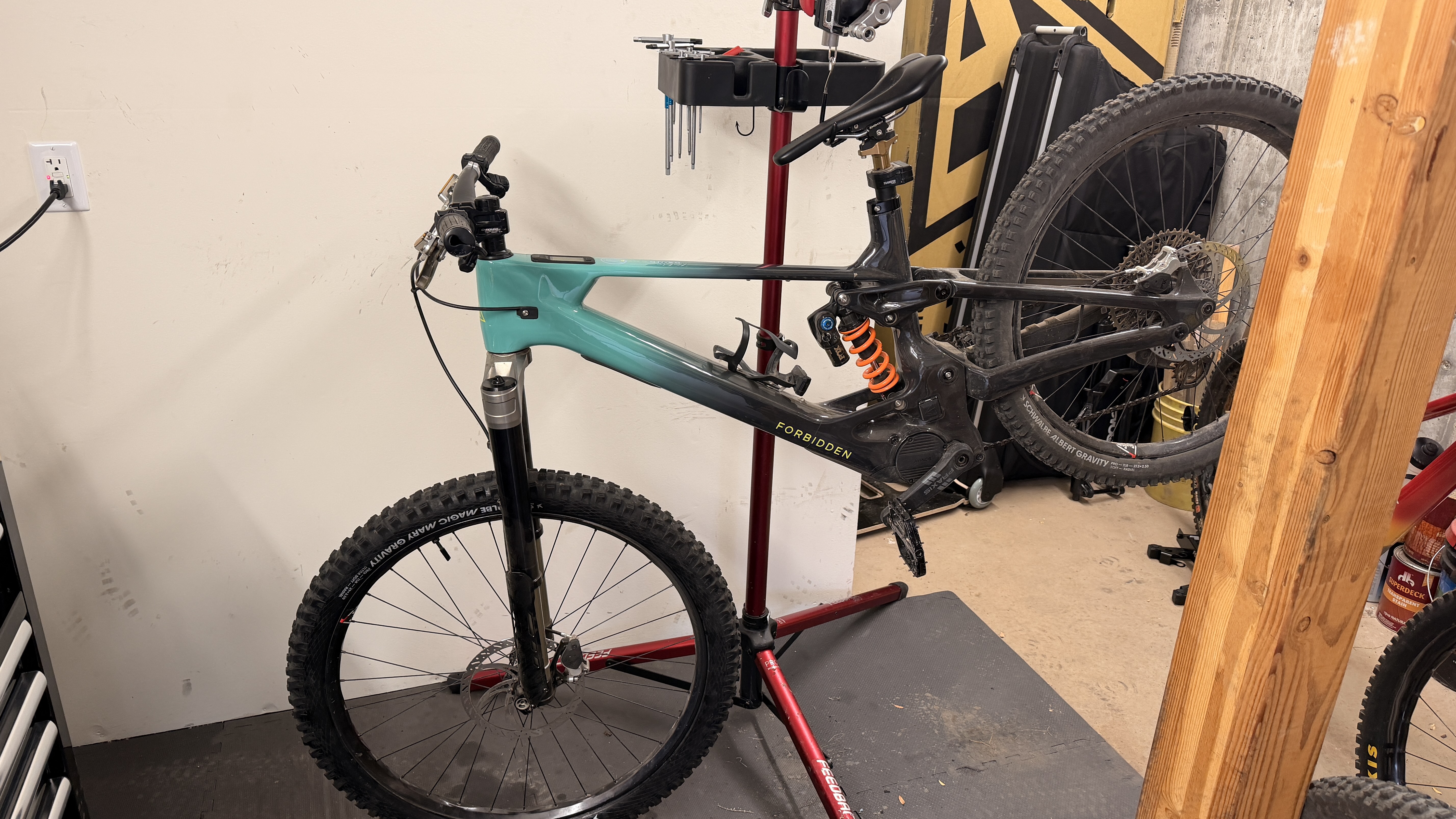

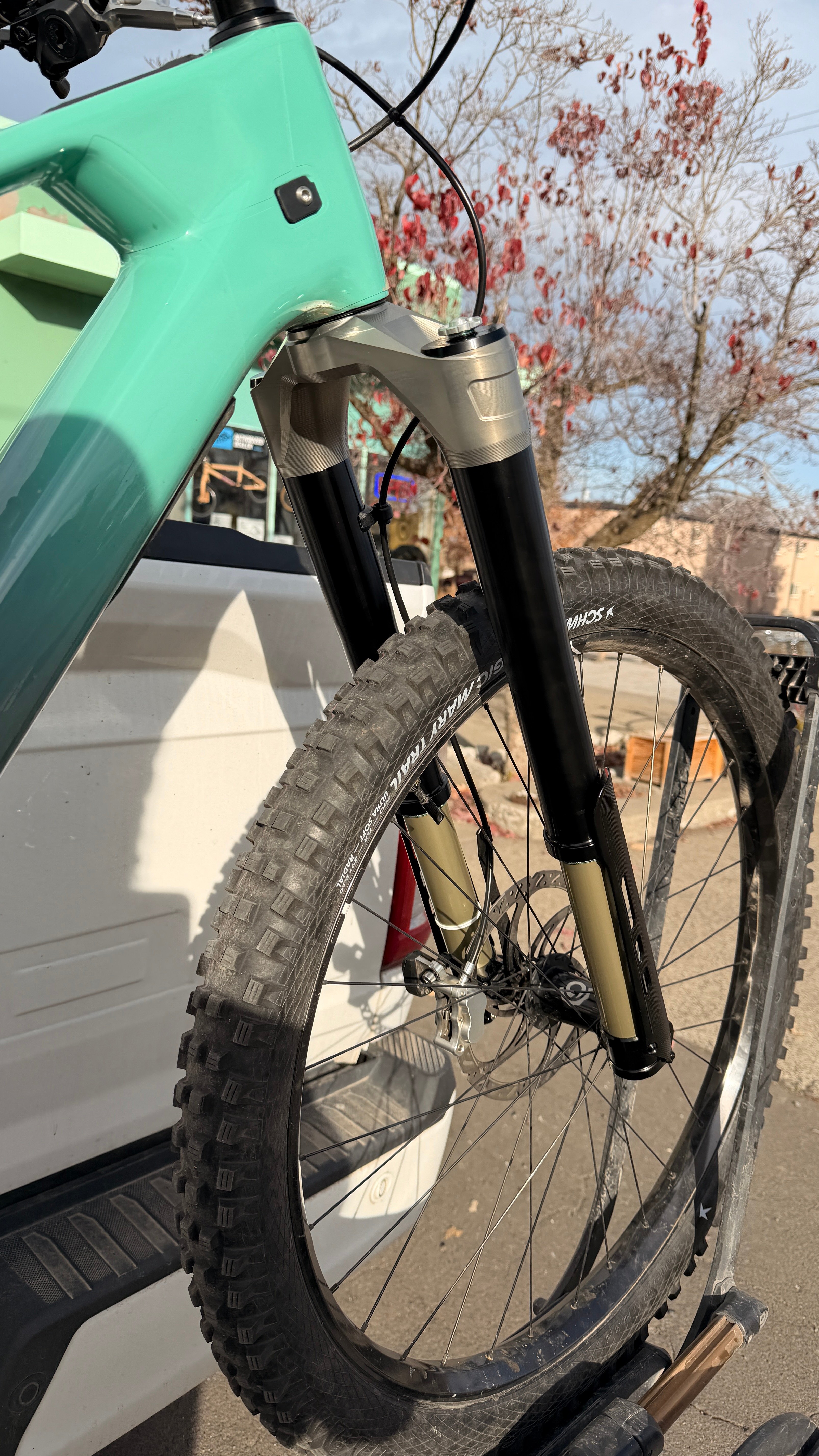

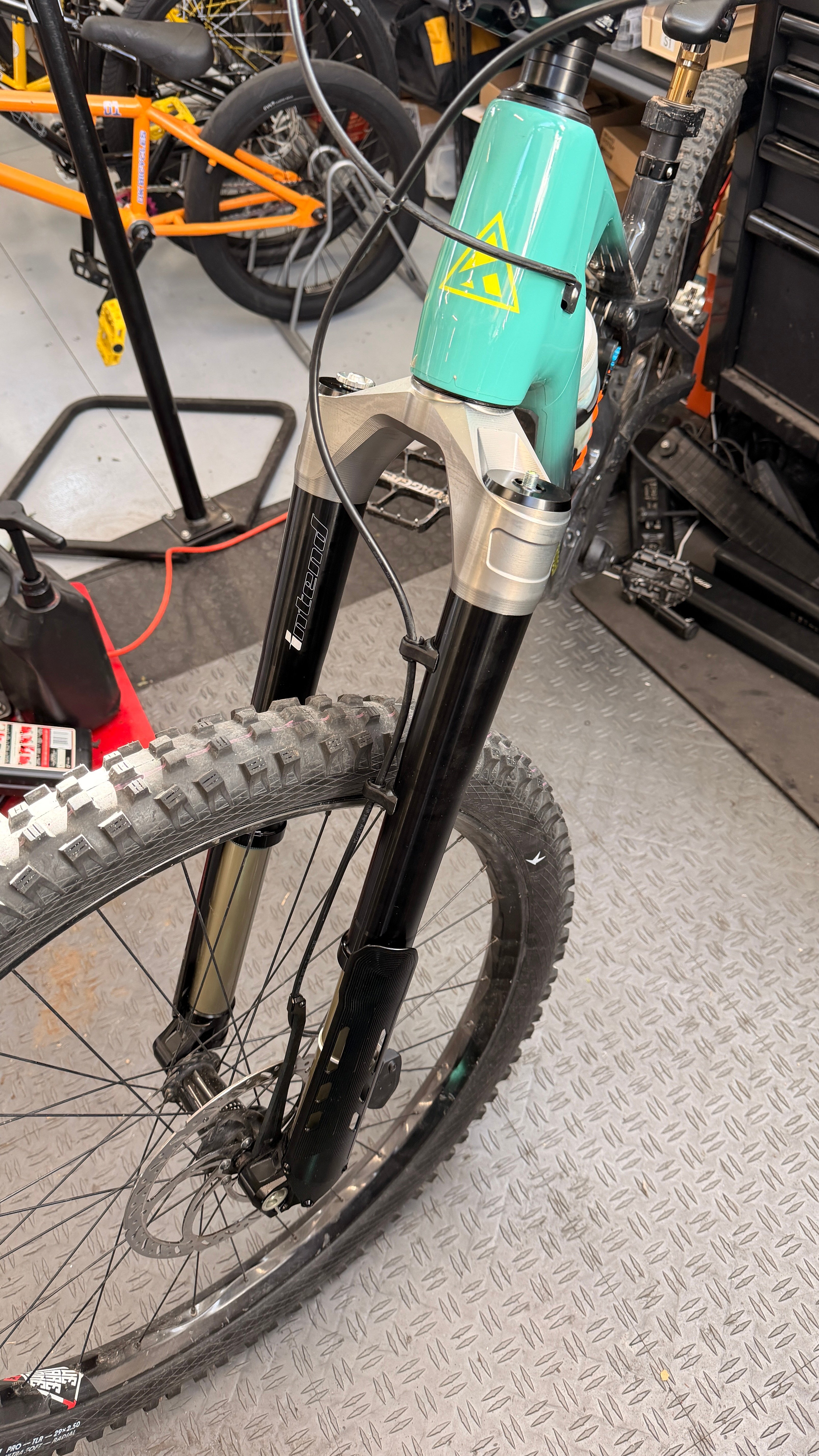

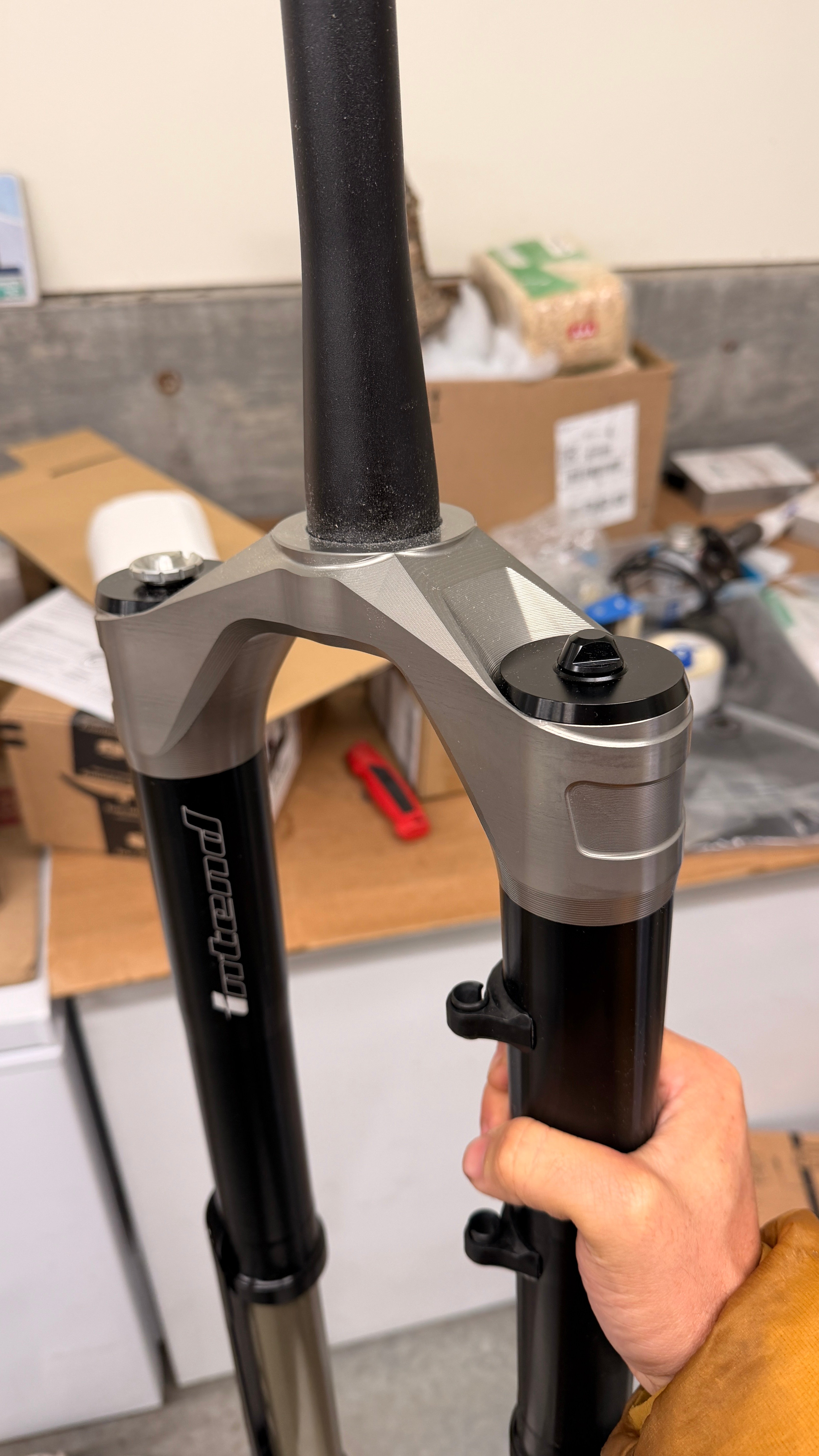

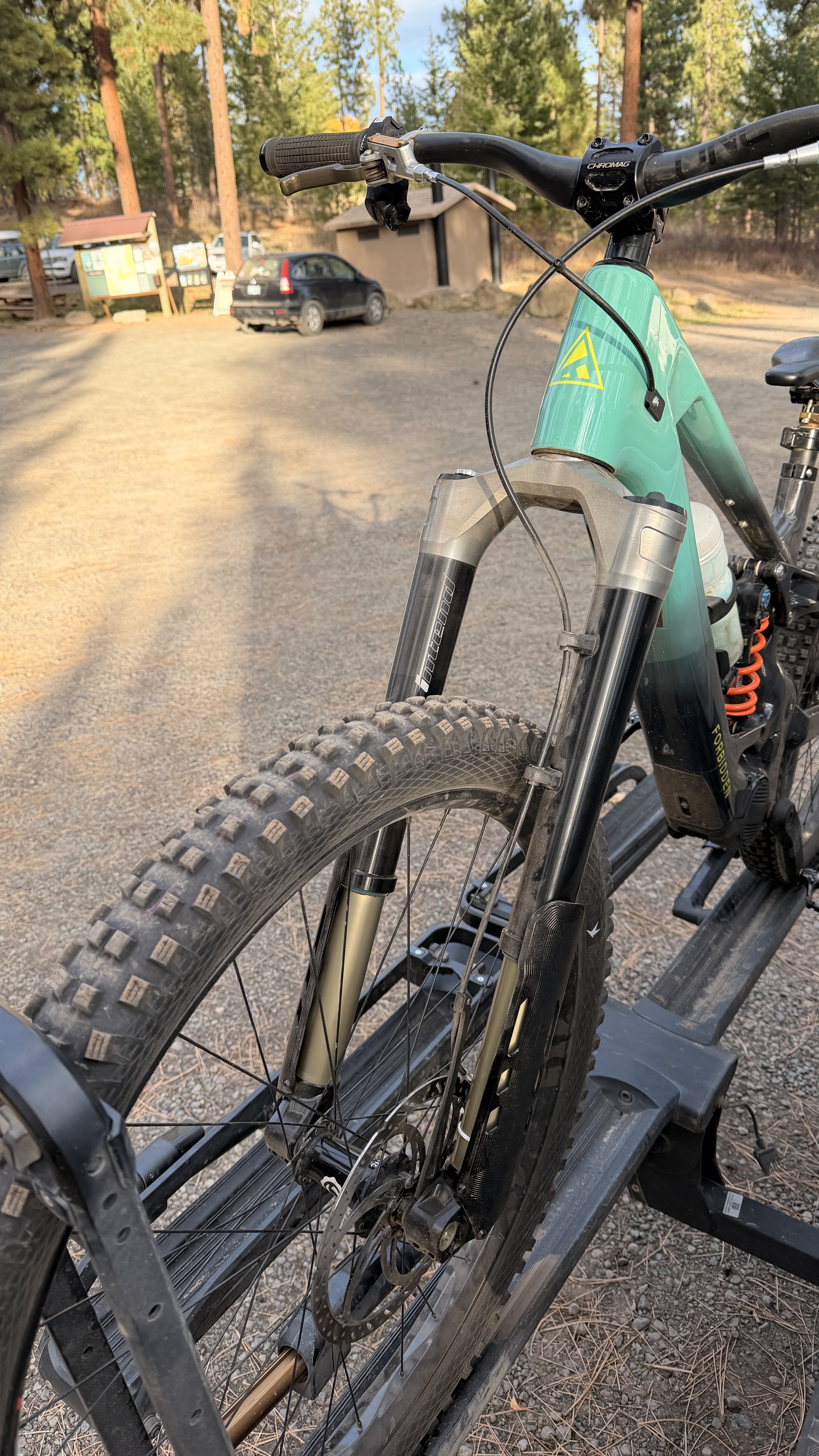

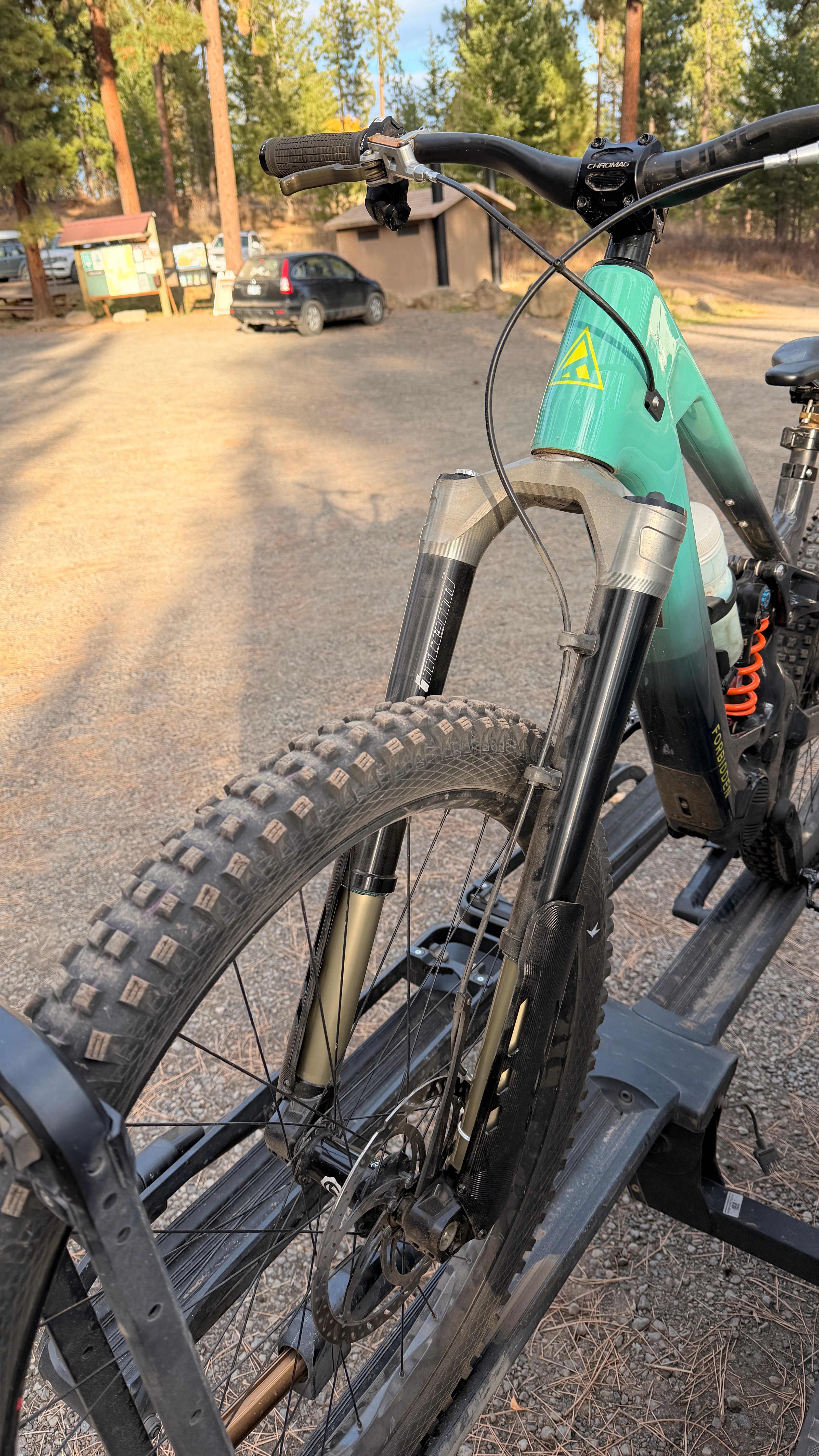

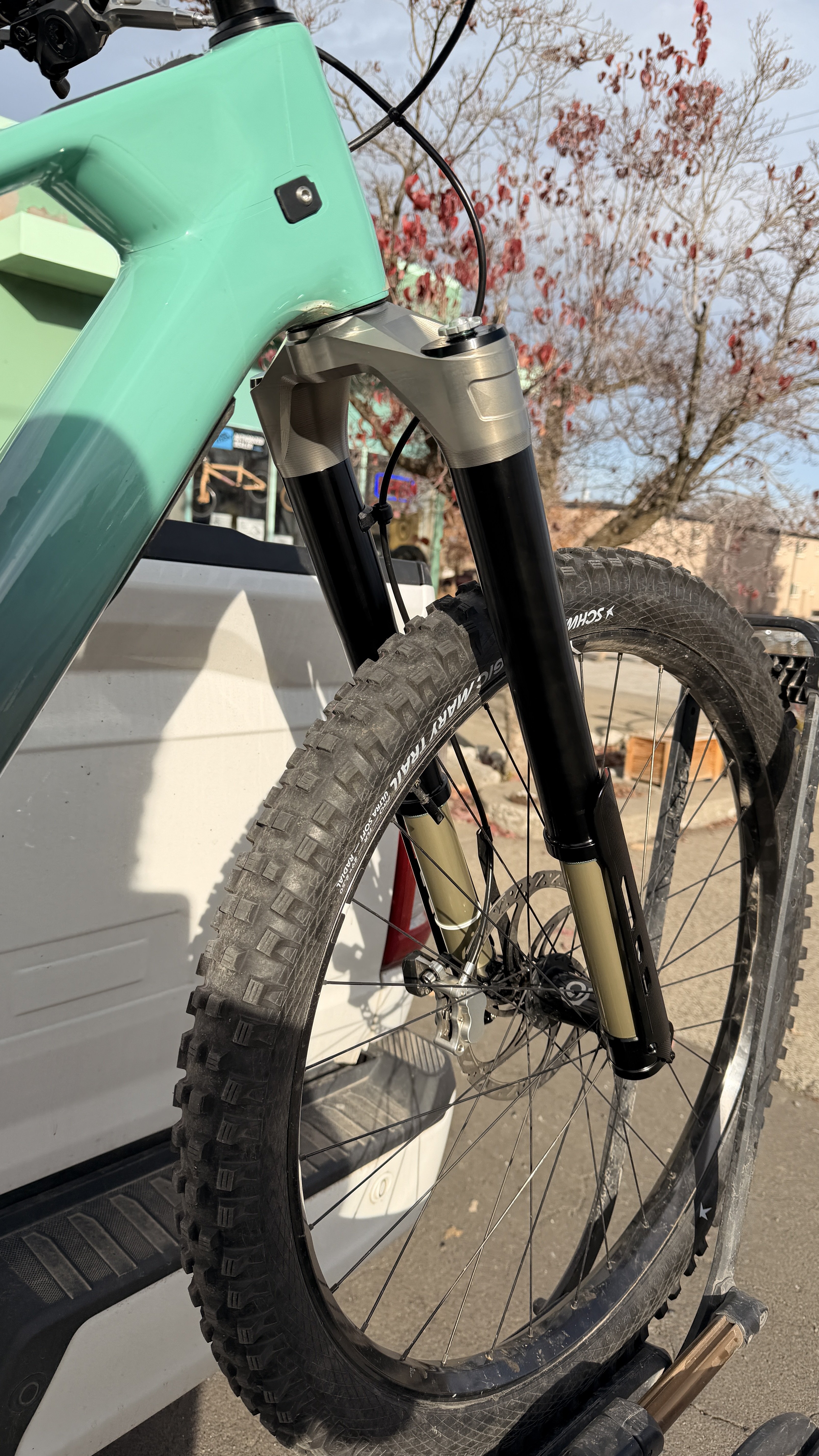

Got the new flash 38 in the mail today and did a short ride with it. What an amazing fork. Was on a fox podium briefly before it started to leak and needed warranty, but this fork right away feels noticeably better all around

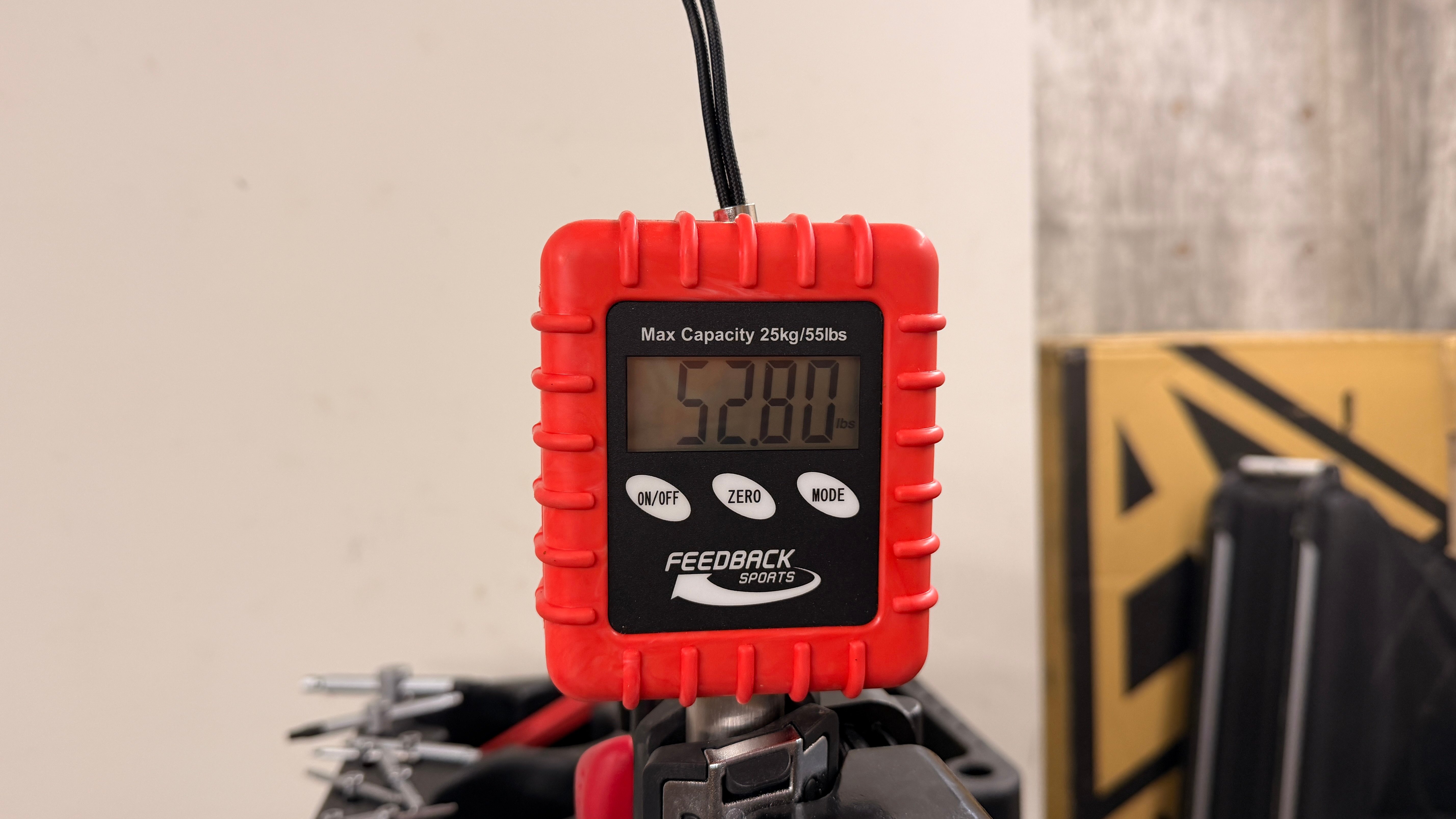

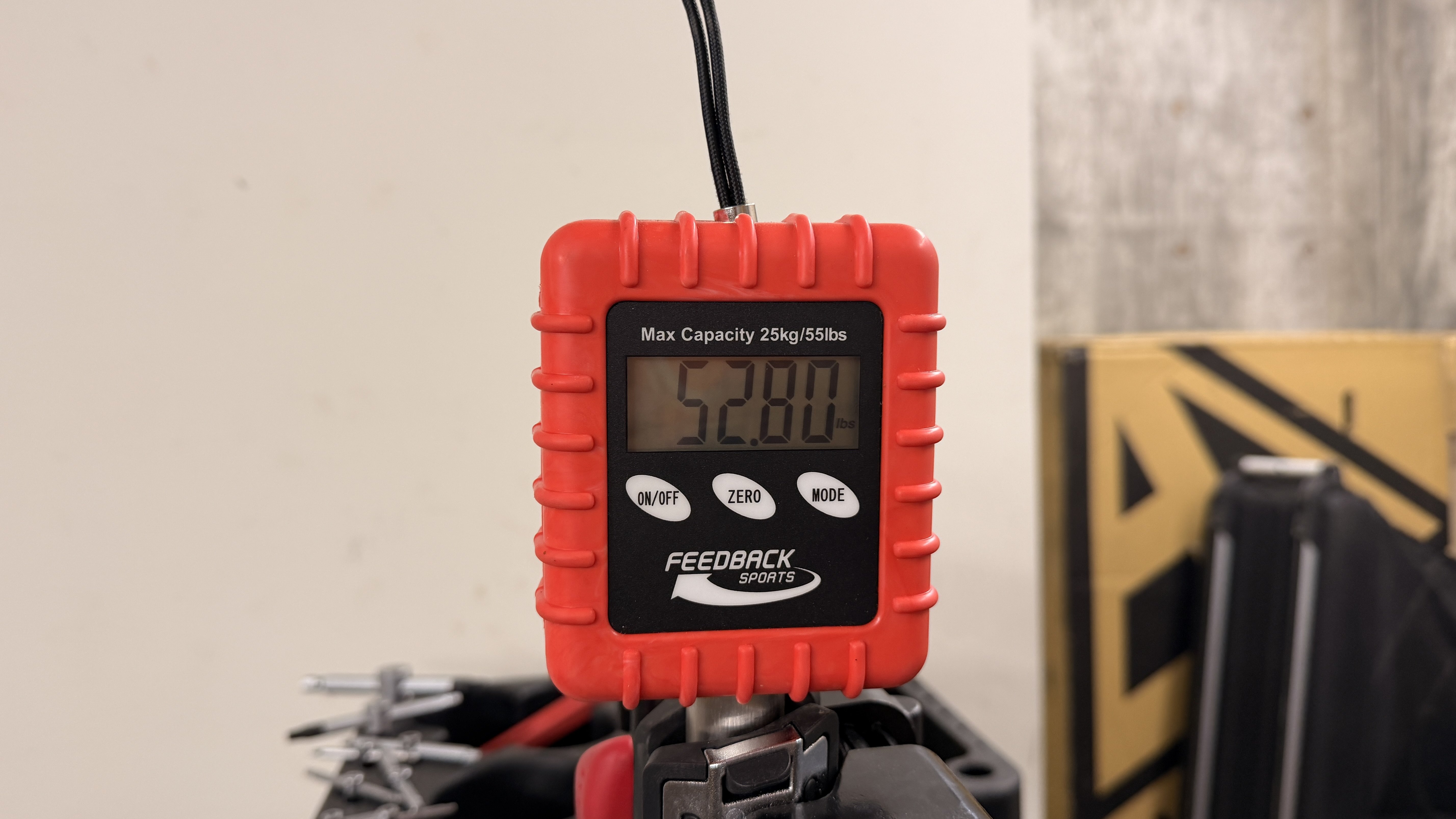

Amazing! Have you happened to weigh it now with your setup?
Yes, weighed it after the install, took off the water bottle but have the swat tool waterbottle cage. It's basically 53lb even. A little on the heavier side but its got a motor so not a big deal to me. Could probably save a bit of weight with a different rear shock, but it rides really well. Front end is incredibly planted now.
Need to play with the stack more, lowered it by 5mm after test riding it yesterday. Love the higher front end but it sits noticeably taller up front on trail because there is so much more midstroke support compared to the stock zeb Select+

I was on the podium prior to this. It was an awesome fork however the seals starting pissing oil after a week of riding on it. I impulse bought the flash 38 while I was waiting to get the podium back from warranty. Apparently it was just a first batch issue and it has been solved with new seals. Just going to sell the fork though as I have the intend now. I got the intend with a 20mm axle since I already converted my hydra front hub to 20mm to run the podium so may as well just keep the bigger axle and maybe a touch more stiffness rather than going back to 15mm.
The intend just turns it up a notch compared to the podium. No bushing bind whatsoever, super supple off the top, and a lot of midstroke support and bottom out/huck to flats like in the video have felt really smooth and composed. I need to spend more time in rougher sections of trail to see how composed it remains while charging through tech. It feels a bit more planted and solid than the podium, but I will need to ride some more tech to actually confirm that. It also weighs about 100g less than the podium. The front wheel feels a bit glued to the ground right now, but should be able to easily make it more lively by opening up compression and rebound a little bit. I'm closer on the damped side right now and it feels great. I'm glad I got a deal on the podium because at retail price, I just don't think it makes sense to get the podium over something like the intend for a few hundred more dollars.
