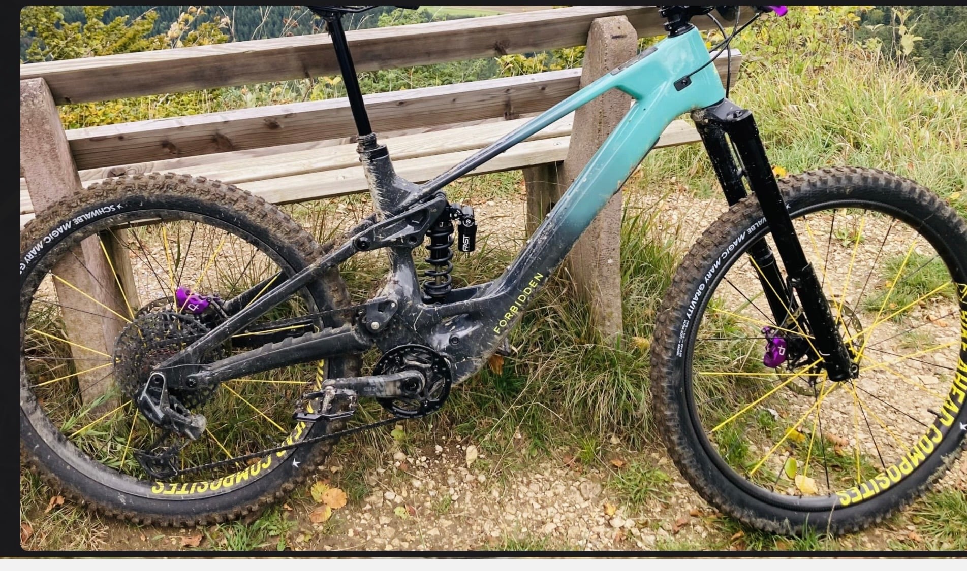

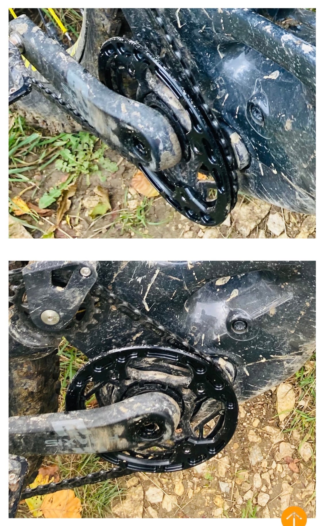

I’ve had a few bb/motor strikes and chainring too. Anyone running a bash on the chainring?

which diameter chainring guard did you get? Also how are you liking the flash blackline? I just ordered the flash 38 and excited to try it. Had a Fox Podium on my bike but already had to warranty it after 3 rides for leaking lots of oil
150mm
