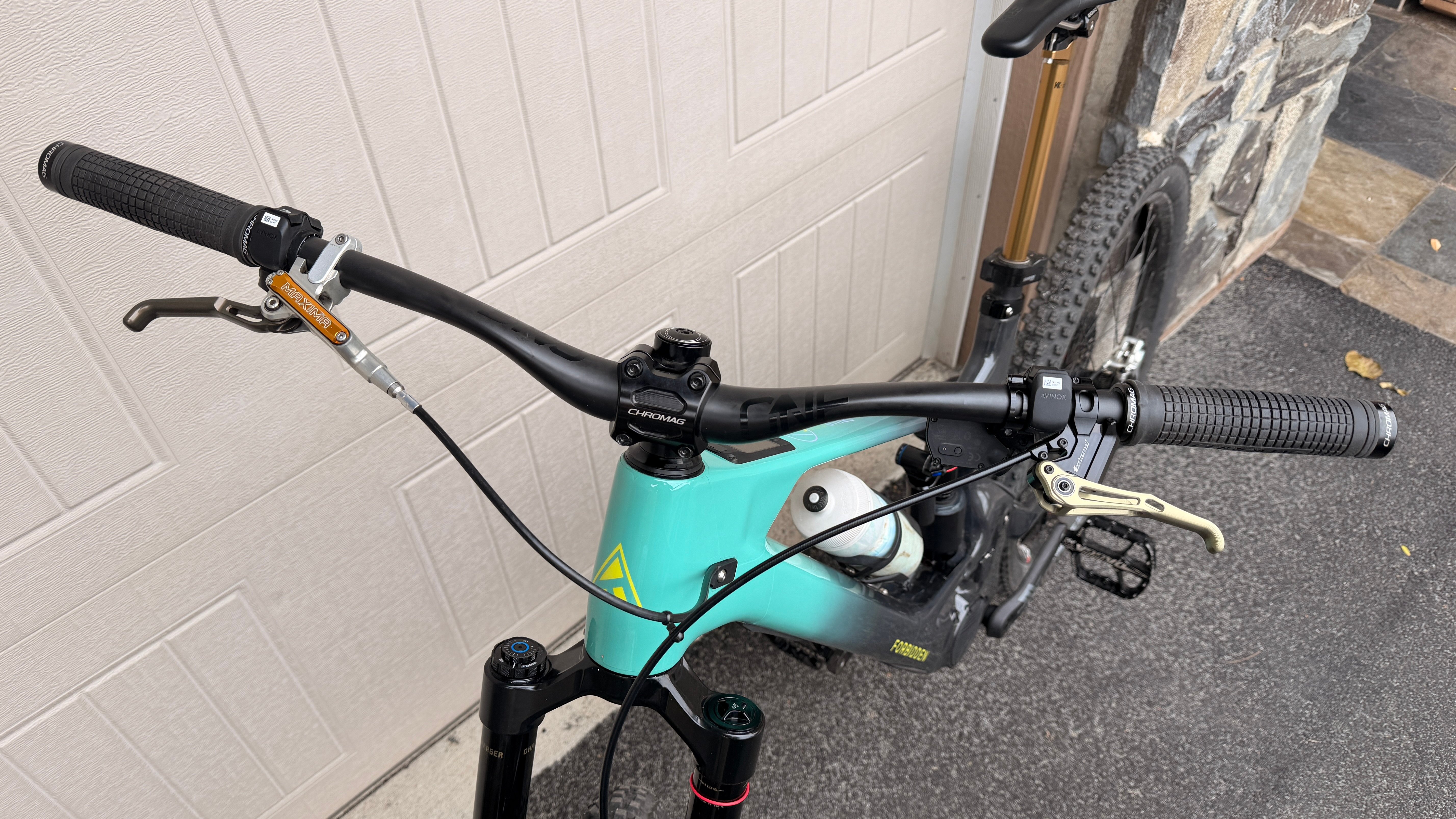

Would love to try the Intend. Maxima not so much.. Intend is to expensive for not having a brakepoint adjustment. At least for me with bigger hands. Waiting for a while for the shipment of hope gr4s... :)
To be fair, both brakes only have reach adjust. It is tool free on the maximas but you need a 2.5mm to adjust reach on the trinity. I’ve never really liked the feel of hope brakes. I may try radic kaha next, I felt the set on ollie lowthorpe’s bike and they’re very interesting, definitely the most sensitive brake I’ve ever felt, no dead stroke at all and massive power with little pull
the bite point is at the technically shortest throw possible, why would you want to adjust that? do you like a longer lever throw?
Yeah, I actually do like a little bit of dead stroke.. I would probably adjust to the Intends, but I just don't know why I would want to pay double of the Hope for less adjust-ability.. Don't get me wrong, I love Intend stuff (got a fork and 2 shocks) but I had 3 Tech4 brakes on bikes that worked flawlessly, no real reason to try new stuff right now :)
The dead stroke has been significantly reduced on the GR4 but I'm pretty sure you'll still like them. I do miss the longer lever from the v4 though.

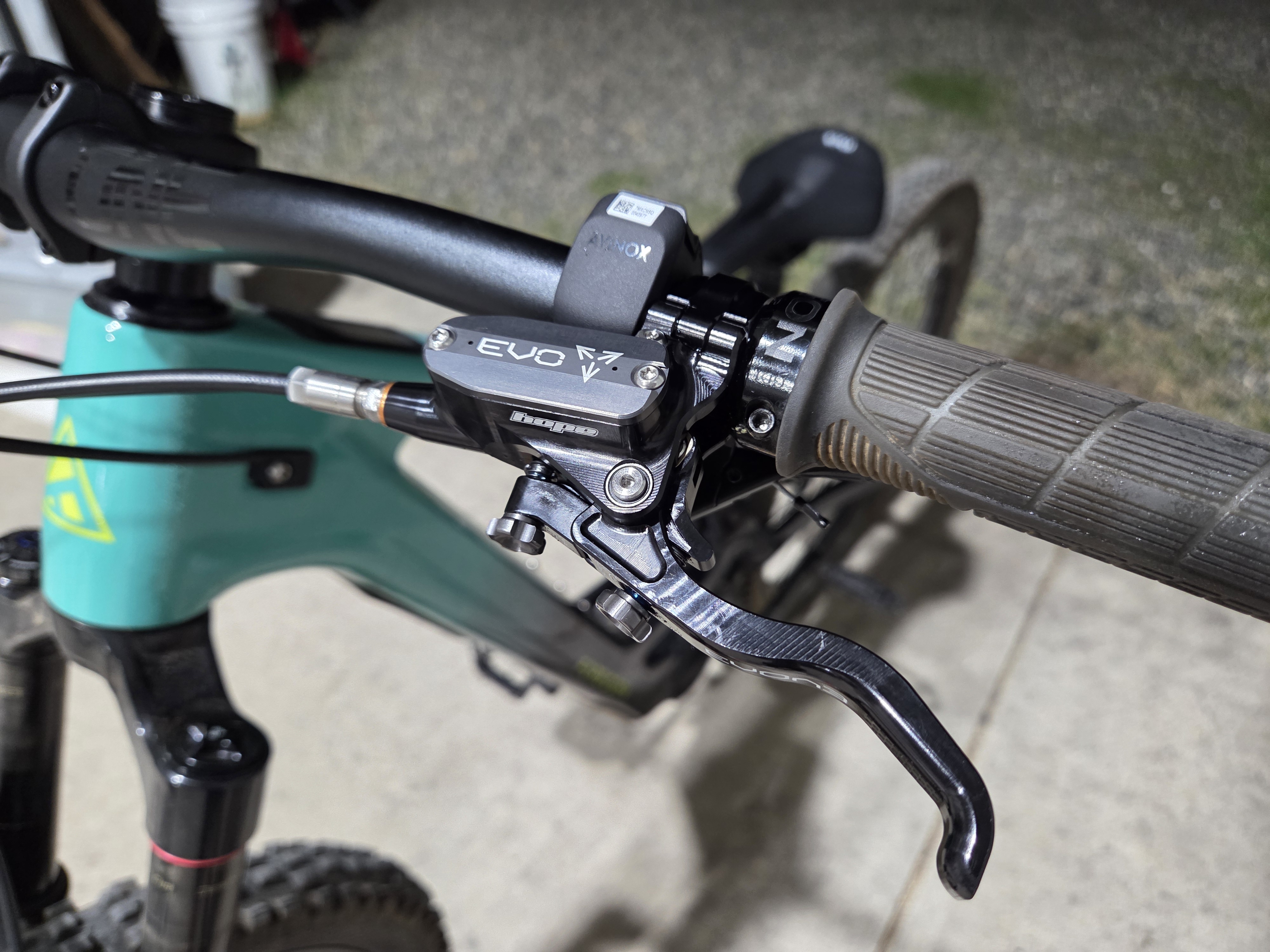

Now this just feels silly, trying to figure out which I like more haha
How do you like Maxima so far?
I am trying Maxima. I've been a Shimano XT fan before.
After trying Maxima a while, I don't think I like Maxima as much as I hoped for because the bite point becomes shorter as I ride rather than giving me consistent bite point that is the same as how it was at the beginning of ride. Given both levers are doing similar, I am thinking that it is normal behavior of Maxima perhaps.
And also it is very powerful to the point that I ended up locking wheels more than I hoped for. While many people complains about Shimano XT to on/off, I've never had any problem to modulate brake before. I am hoping it is just adjustment that I have to make and it will be fine after a while.
