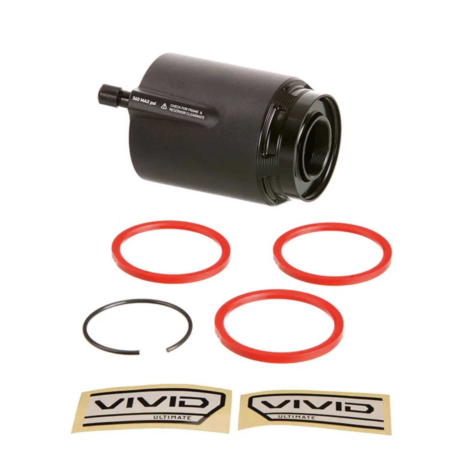

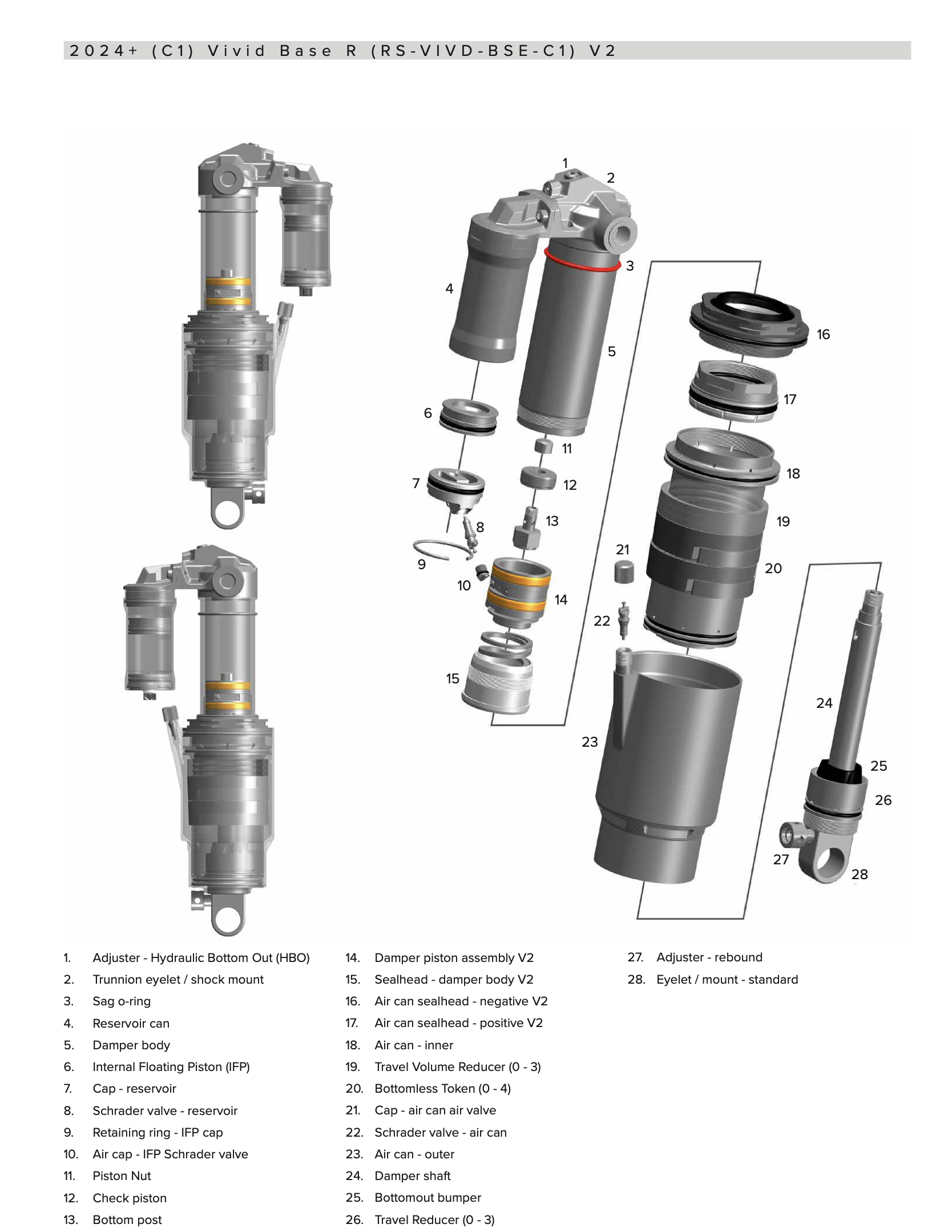

Some shocks, as shjin mentioned above allowed you to just remove the assembly, but it looks like the current Vivid has the valve assembly integrated into the can. You can replace the valve core though.
$80 for the can replacement will be cheaper than buying a new shock though.

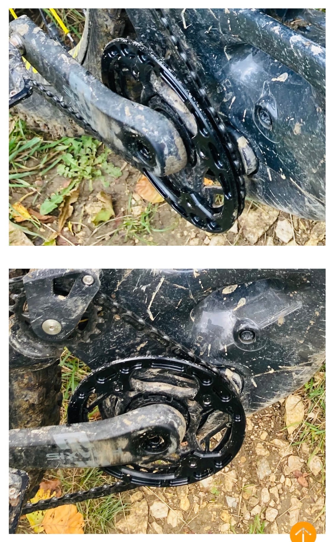

34t bash and just longer chainring bolts? looks decent.
Yes, the Bolts are included with the Bashuard.
Due to the High Pivot, a normal Bashguard is no problem with the Druid E. With the other Avinox bikes, this is only possible if you remove the chain guide.
