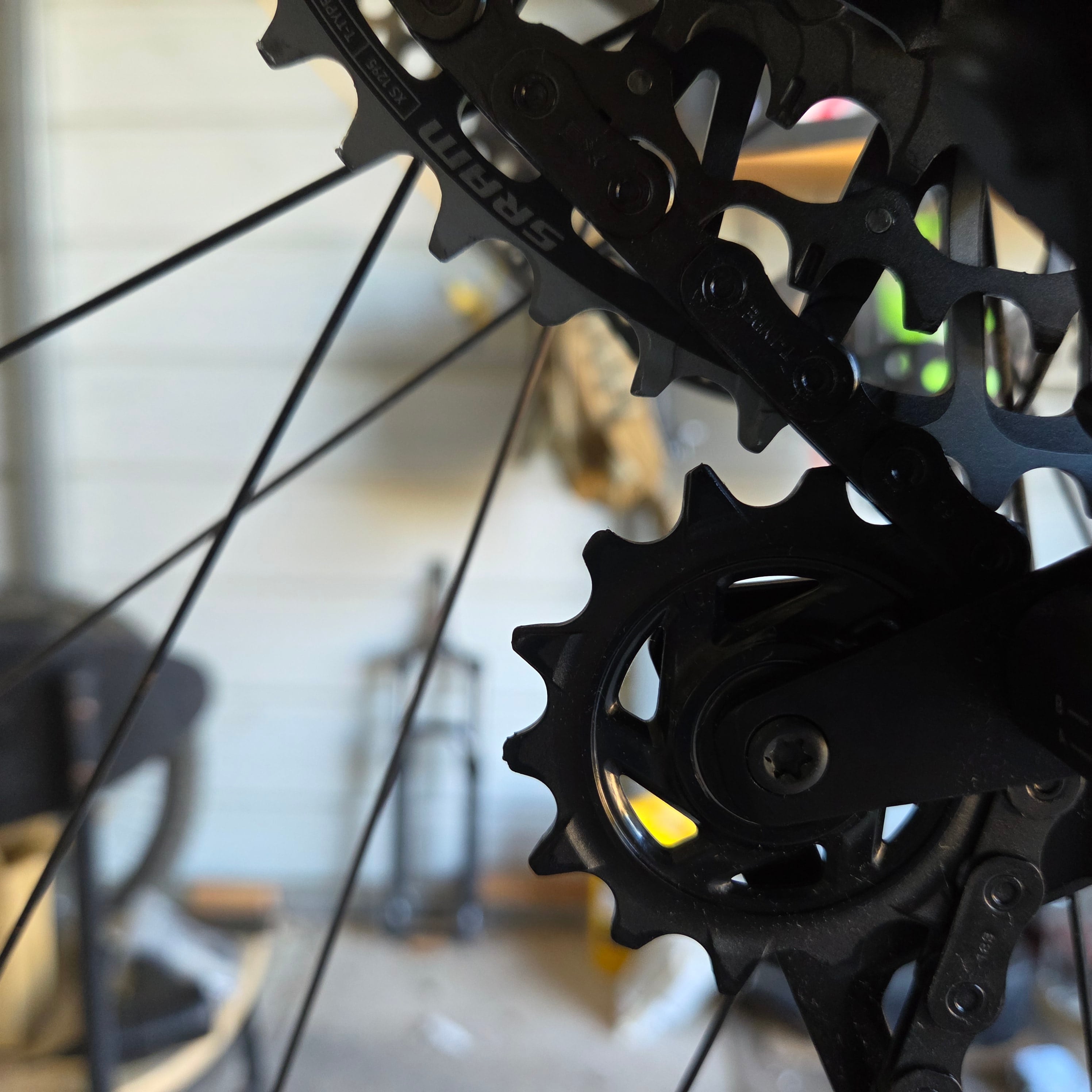

Put on a different wheelset with a different cassette and I think my upper jocky wheel rubs the cassette when shifting from 3nd to 2nd and then to 1st gear. This is on a bike stand, i assume under sag it will clear... bike is currently in pieces so can't test myself. It shifts fine in any other gear.. maybe I missed a step during the setup process.
Check your b tension setting. Thats usually the issue in that scenario

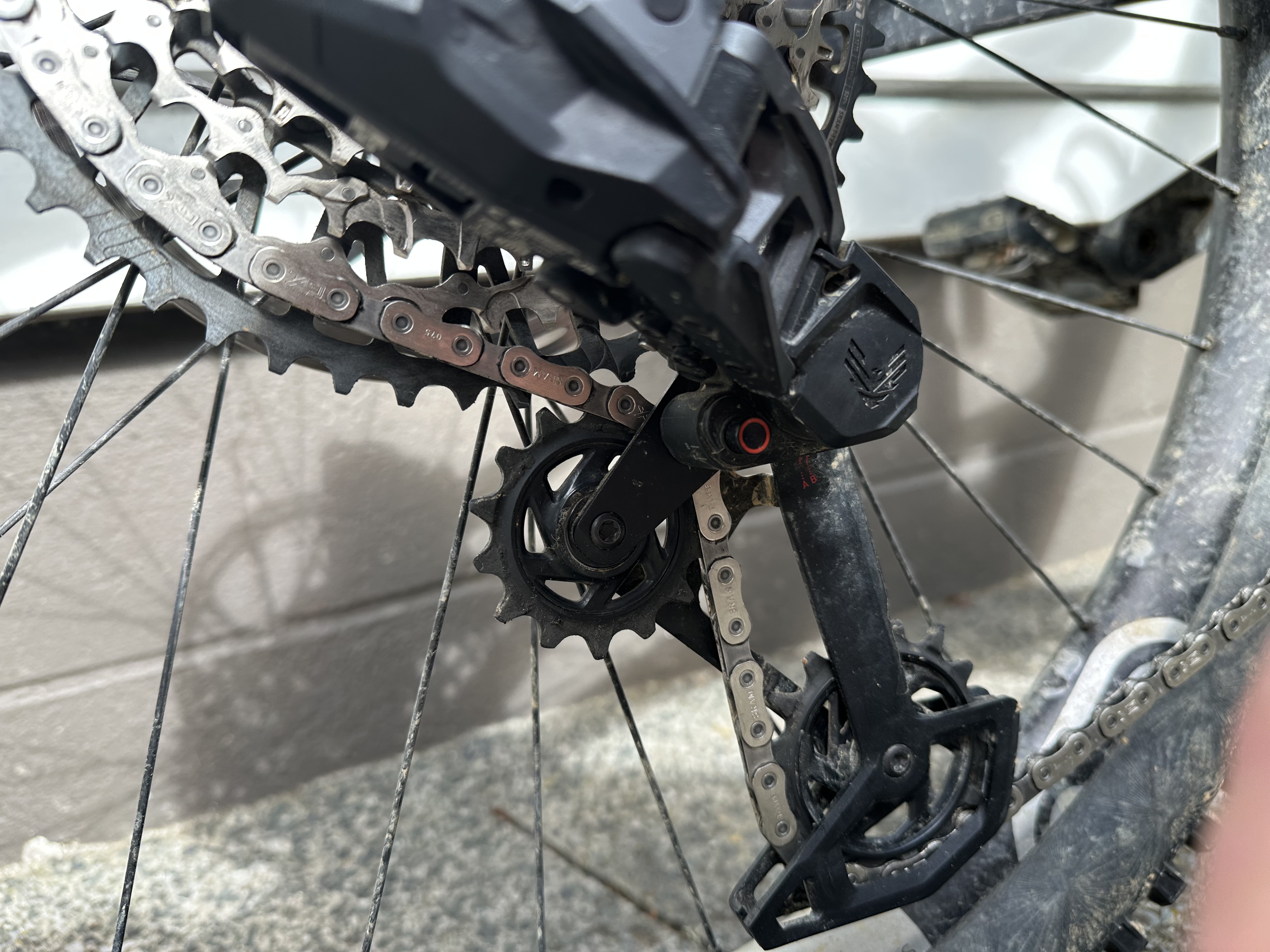

Anyone riders with AXS having issues with gear shift? I can't seem to get 7->8 to work cleanly. I re-did all the AXS setup as per Sram website last night, but still no improvement.
A big part of my problem was I'd set the Avinox system up as if it was 11 speed, not 12...🤦‍♂️ I wondered why the display was only reading 11 in top gear.
No b tension on axs transmission tho. Everything seems fine when riding.🤷‍♂️
When attaching the derailleur make sure to pull it back to take up the tension. If you follow the install guide I posted a page or so back you can’t go wrong. Your chain should be touching anything else though.
hmm i remember somehow my derailleur came out of the "A" setup mode when i was pulling it back torquing things down. Once it was torqued I realized what had happen so backed it all out and followed the steps again from SRAM. After putting down 20 miles today and it shifts so crisp and smooth that I'm just going to leave it alone. I'll follow the steps from lovemtb if the drivetrain starts making noise.

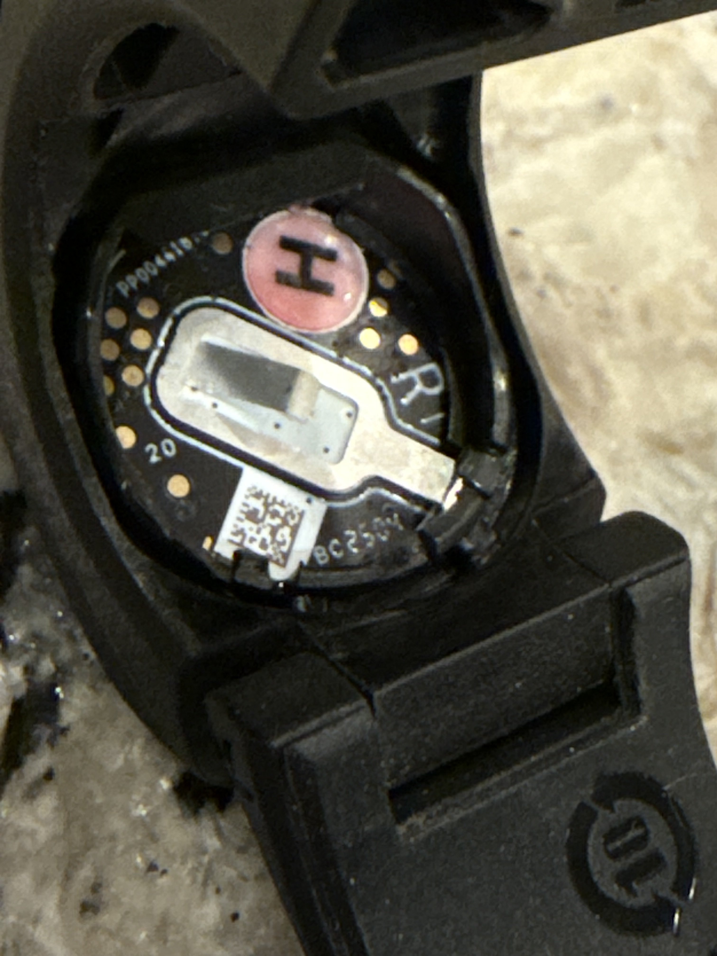

I did first ride in rain and wireless remote (menu button) stopped working. I opened it after getting back home and found that there was water inside and the humidity indicator seem to be agreeing as well.
I tried to turn it on after drying it but it doesn’t work. I ordered new battery just in case.
Anyone experiencing water problems with Avinox remote?
I had a dead battery issue after ride #2 on one of mine, I have not checked again for water ingress though. Isn't there rubber seal that sits between the case and bar?
