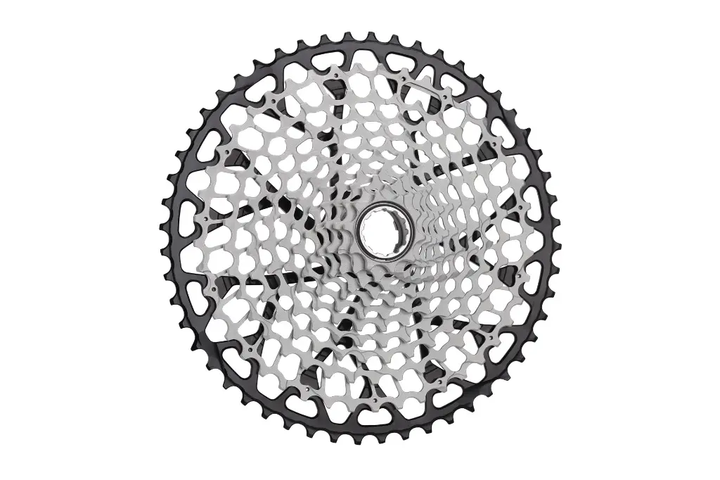

As sprousaTM mentioned above, the core3 wheel set is 2400g while the core2 is 2250g (assuming it is the e-alloy 2.0 model), there is a 120g delta in cassette weight between core2 GX and the core3 1270 cassettes and the OneUp v3 is one of the lighter droppers on the market with a 79g advantage to the core3 TranzX dropper (couldn't find confirmed TranzX weights). I'm guessing the saddle on the core3 carries a big weight disadvantage as well — but assume most will be running their preferred saddle, so that is moot.
So that is 1#/449g in estimated delta right there.

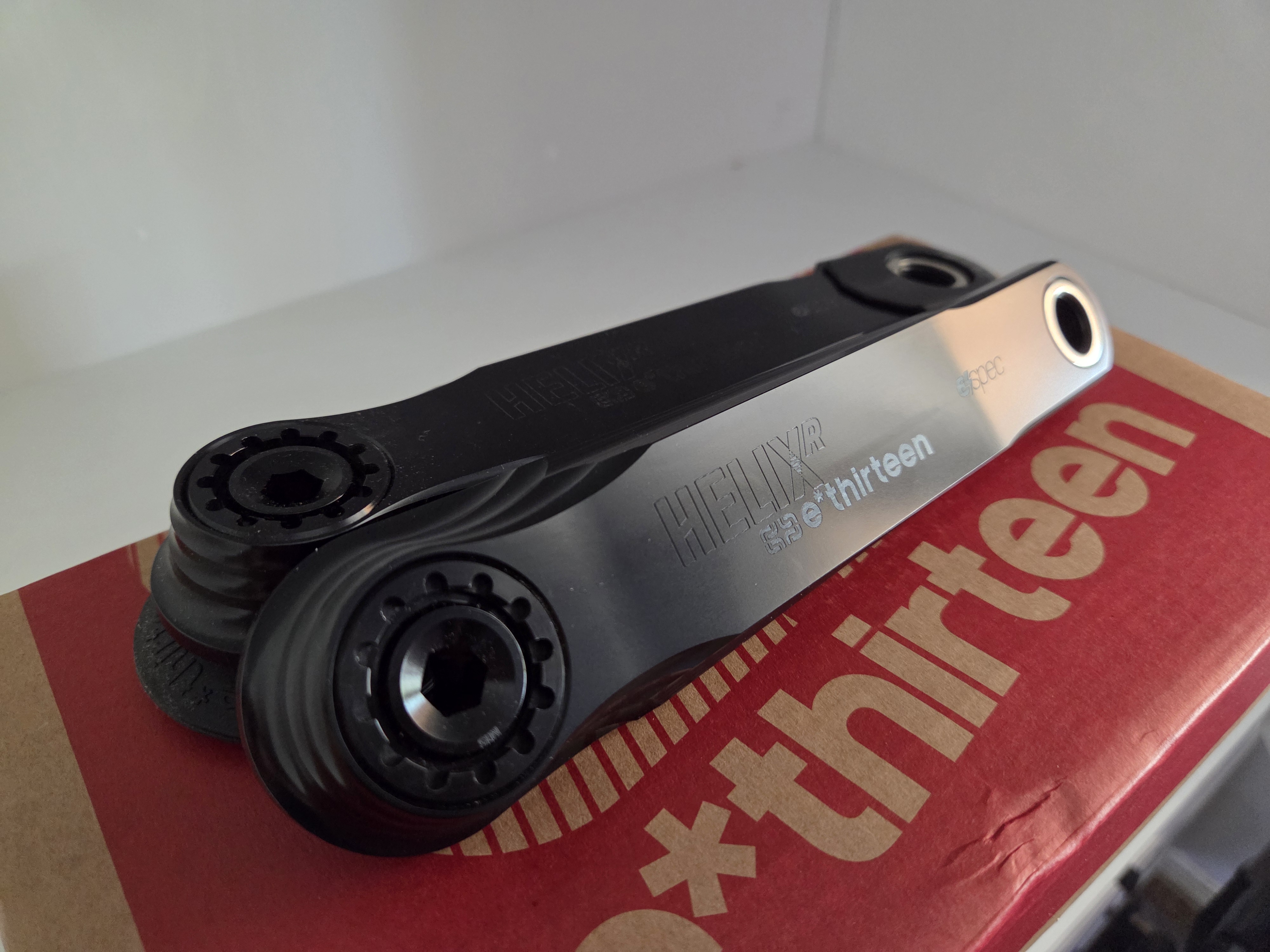

Not sure if i'll install these 155mm cranks due to the amount of pedal strikes i had on my first ride. I did have my vivid sag set at 35% though.

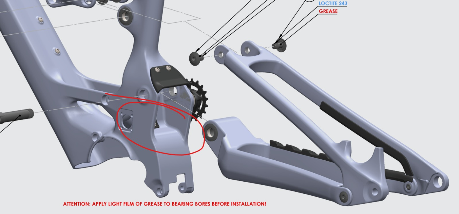

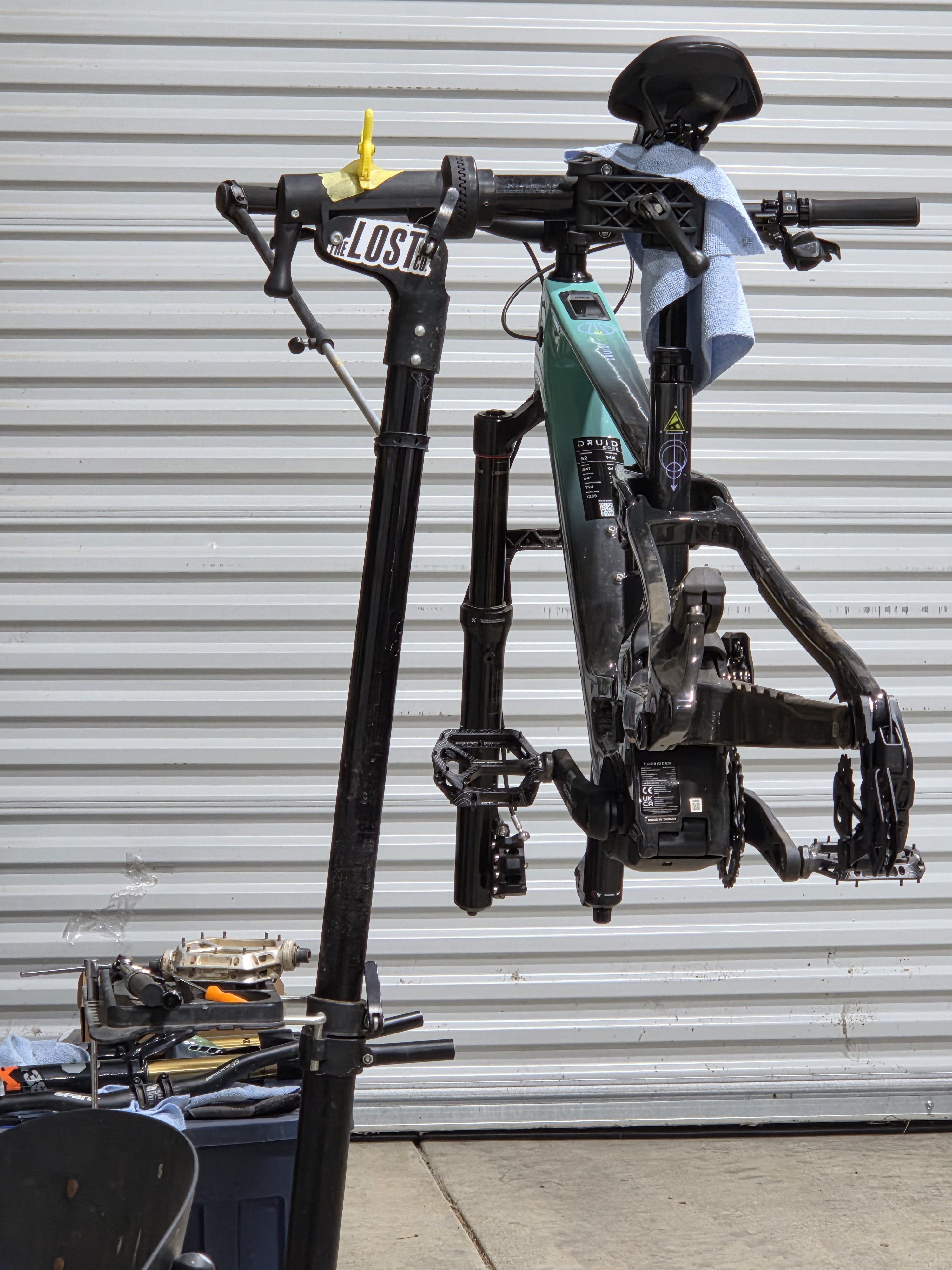

Taking out the motor...
I went about shortening my brake hoses and seat post housing to tidy up the cockpit. Brakes sorted easy but distractedly pulled the cable through the housing and needed to push the housing up the seat tube to put the cable back in - it got jammed in the nest of cables etc under the motor.... After much stress and sweating I decided to risk it and drop the motor. It was surprisingly easy, just the cover and two bolts (which have a 6mm on the bolt head side and an 8mm circular 'nut'). Was great to have the exploded diagram from the Forbidden website. With one bolt left in, but loose, I could tilt up and hold the motor in place and access all the cable housings etc. With the bike upside down it was really safe, no risk of it dropping and ripping out all the wires... I think a battery swap would only be a 10-15 min job. Not something you'd probably do mid-ride, but fine if you need to travel on a plane and ship the battery separately.

I was just wondering: did anybody put some moto-foam or something similar in the empty space? I am worried that this is the only place where dirt and moisture may cause problems some day..
