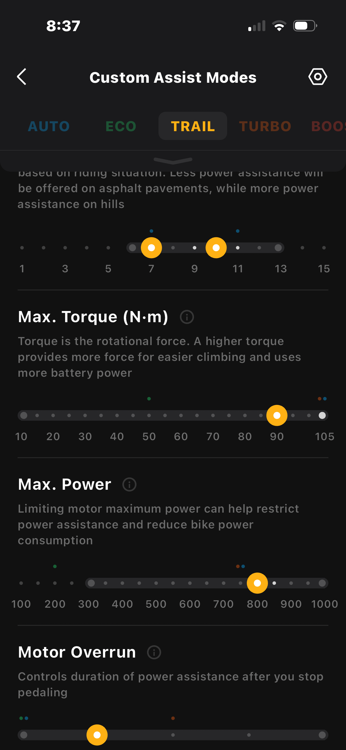

- I detuned ‘Trail’ to settings attached and it was plenty grunty. I towed my son around uphills for an hour then did a few runs without him and did 25km with 49% battery.
