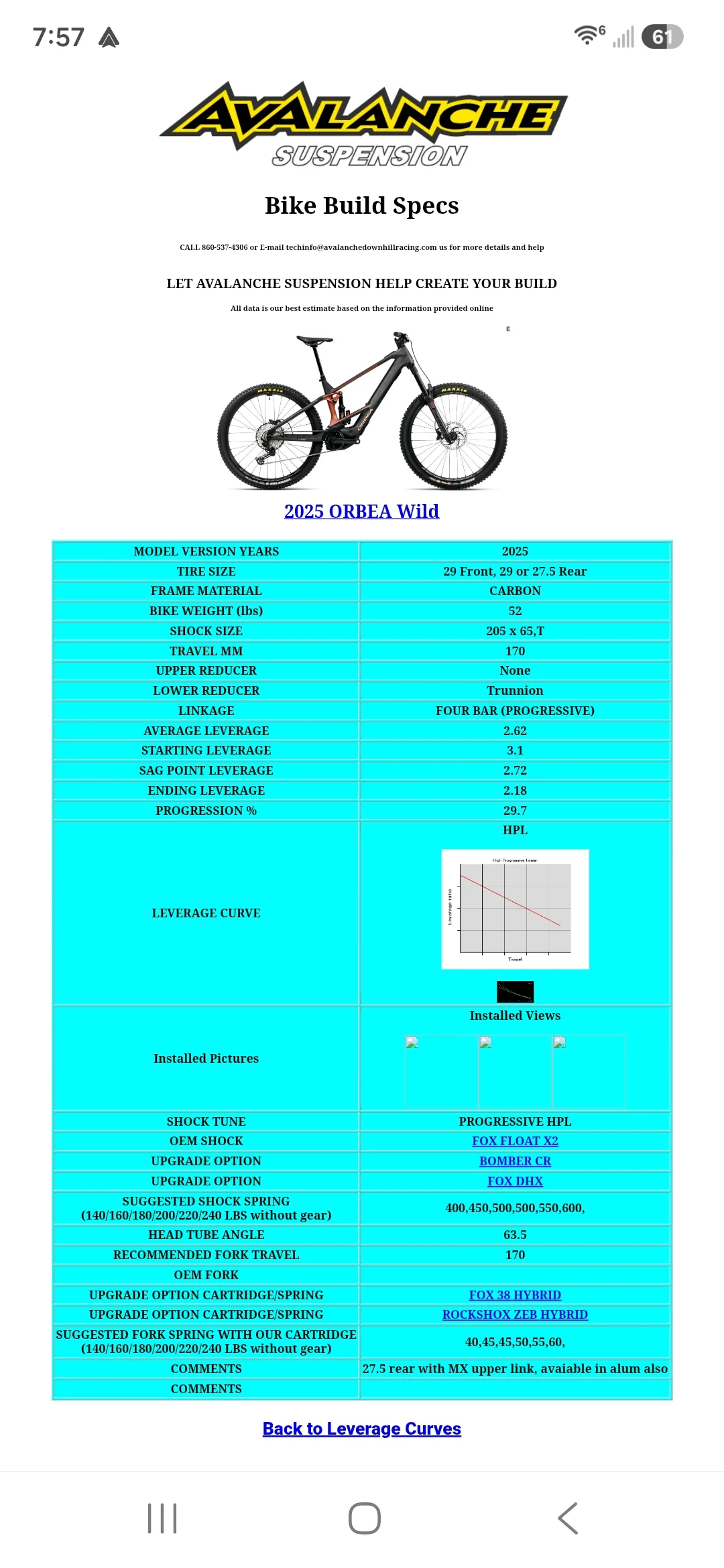

Here is the correct LR (30%, I had read once it was nearly 40% but clearly that was incorrect) from Avalanche's website. They just retuned my shock for the Wild and added a hint of mid-stroke support. I have (briefly) ridden Crestie's, a Norco HP bike, Sixfinity Yeti, etc. but I'm very picky about set up and only the Yeti felt really good.

30% is pretty optimal for air.
20% is typically coil shock territory.
But there are some bikes (vpp 🤷‍♂️ ) that really benefit from coil, even in the 30% progression range. The acoustic dreadnought v2 is like that, air is horrible on it.
The yeti's six bar design was really good, probably the most "character" free rear end I've tried in recent years.
The e-dread is pretty decent on air, but I'm already eyeballing an ext coil for it. Just got to know...
