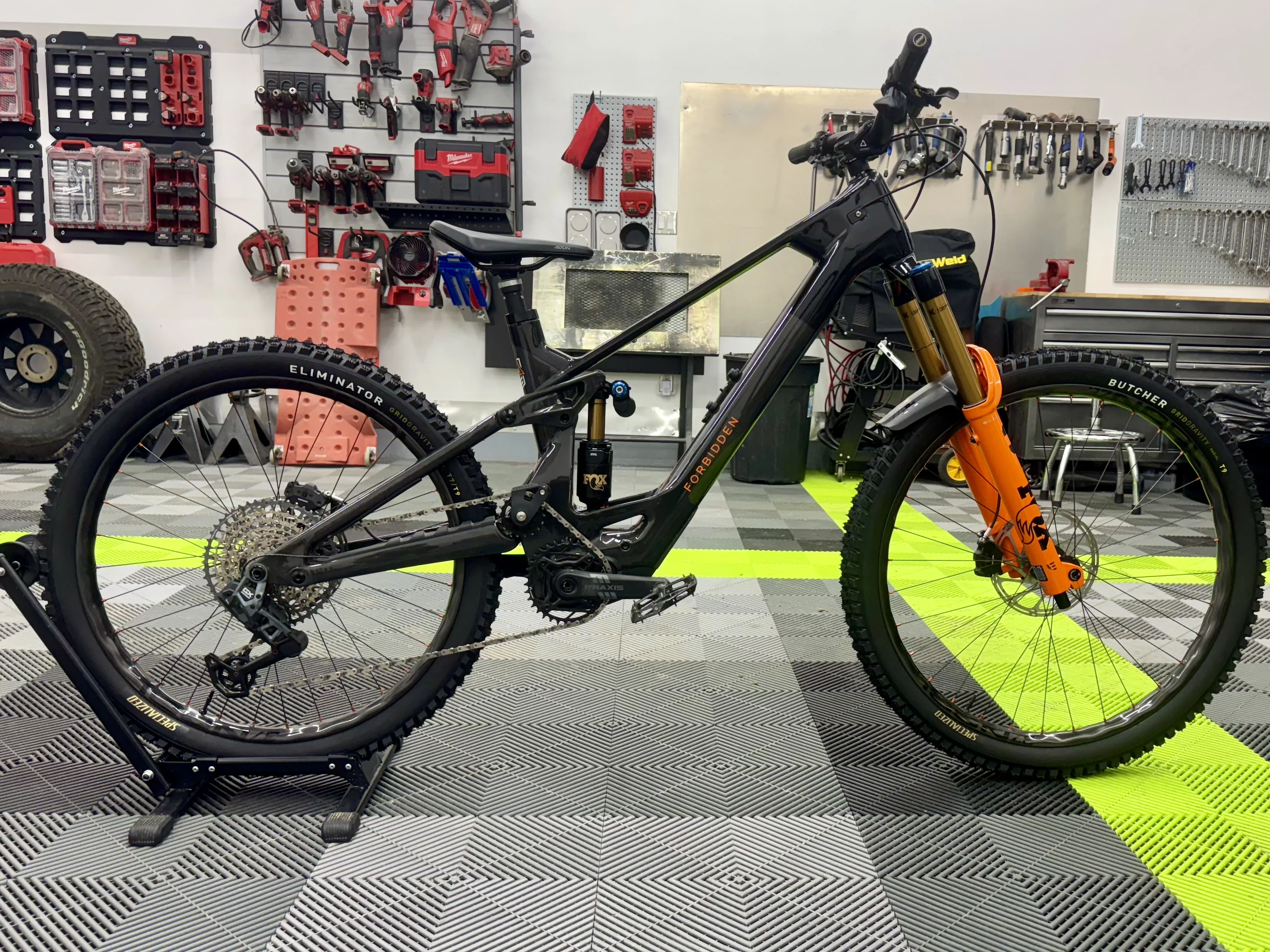

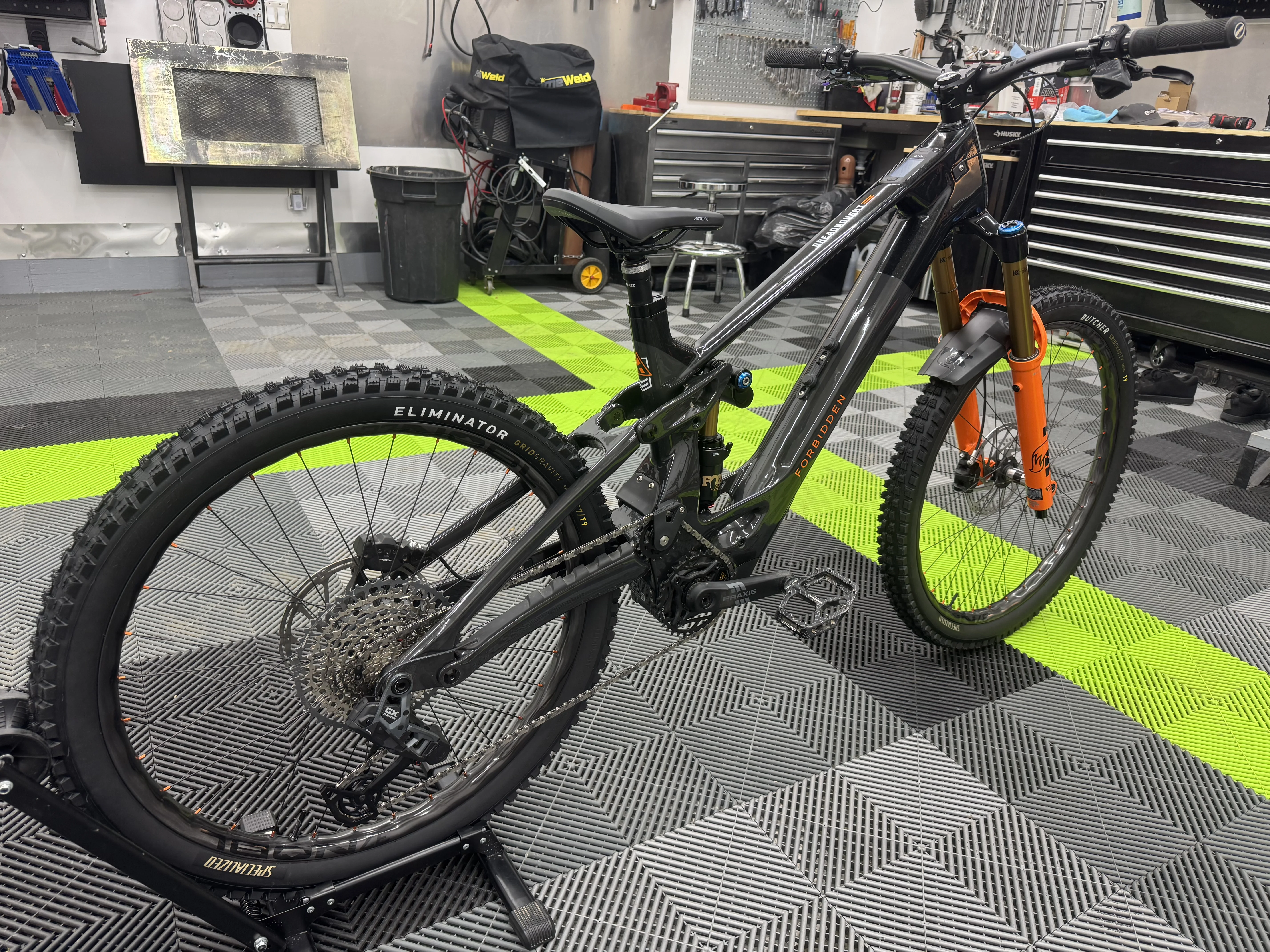

Back on topic, on an e-dreadnought related note: with some nobl tr37 carbon wheels, specialized's new radial gravity casings, a 600wh battery, and some carbon bars, my s3 t2 now weighs 48.7 pounds. Not bad.

Nice! Photos please

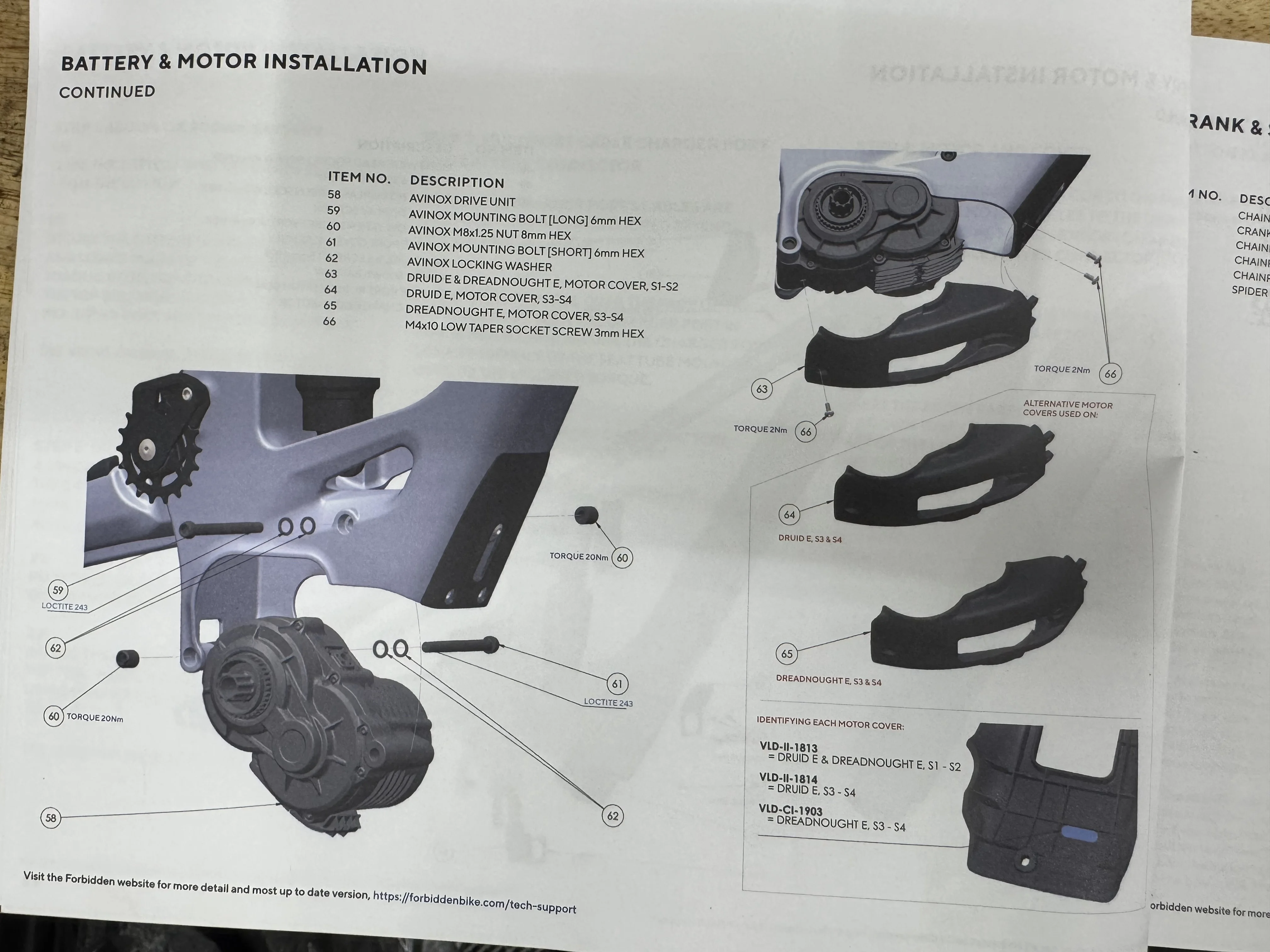

Hey there ntm95, I am wanting to remove the motor and battery but haven't seen any good instructions for this. Was the process pretty easy? Anything that you followed to do it?
I think that I have a cable rattle (maybe the rear brake line) and would love to take things apart and see if I can sort it out.

Hi Daniel,
I just removed the front motor bolt, loosened the rear slightly, and spun it up and back.
Ntm, that seems impossibly light with that kit. Nicely done Sir!
What wheels are those?
Ps. Lovely shop.
Ps. Lovely shop.
I was surprised myself. Same scale that weighed it at 43.6 pounds with the 800wh and stock wheels.
Wheels are nobl tr37’s, dt350 hubs.
They’ll hold up, I’ve been running the same set on my park bikes for three years.
Not sure about the tires yet, have yet to ride them. Didn’t like the schwalbe radials due to the vagueness in high load corners, these are supposed to be better, but time will tell.
