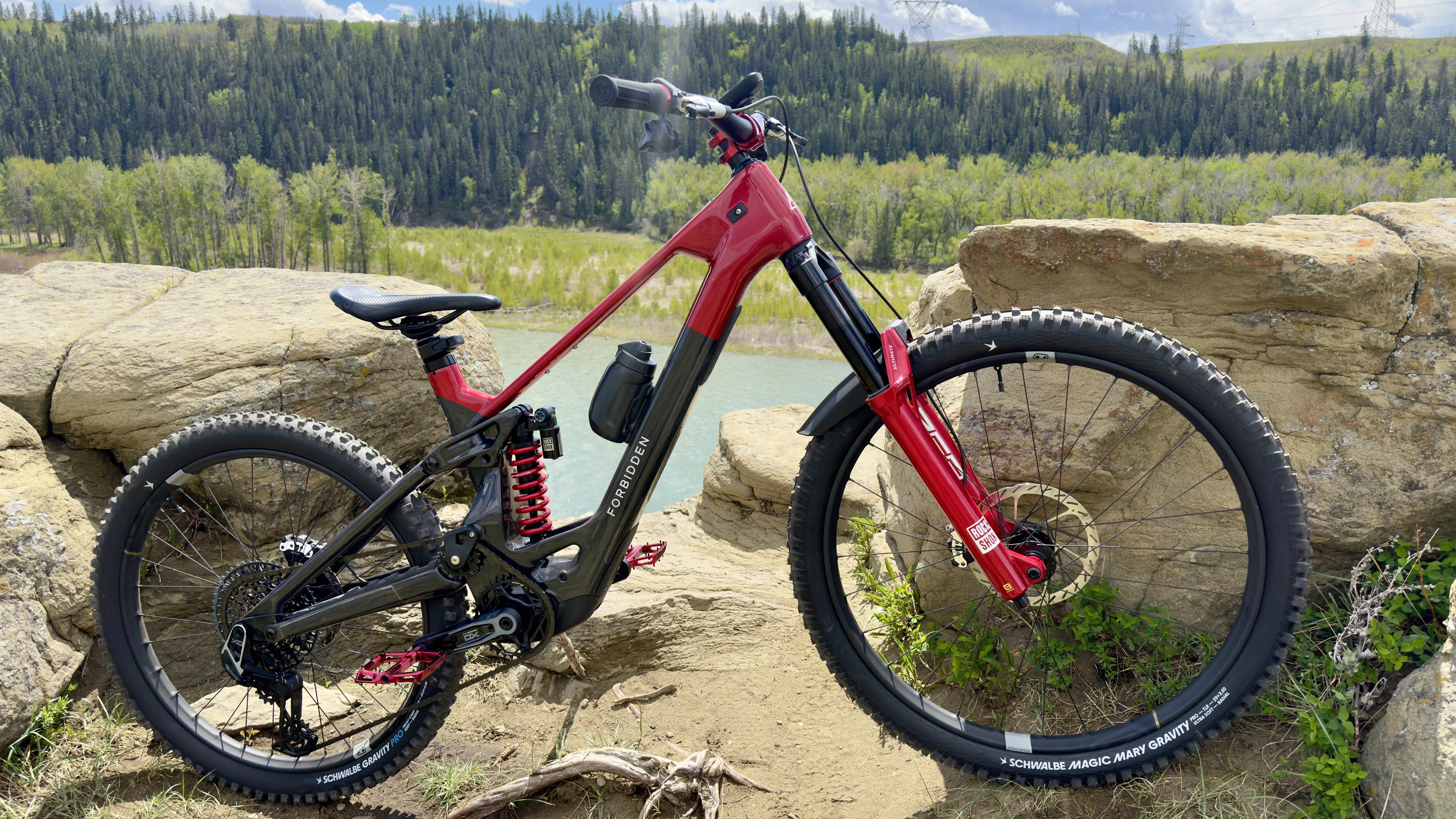

We got some fresh snow this weekend 😭, so no riding till next week. I just finished ride-wrapping the bike and took it out to feel it at a local park. Surprisingly, it didn't feel big; instead, it felt more playful than the Druid E. My Druid has the 40mm stem with 50mm rise oneup handlebar, but I put a 31mm stem with 35mm rise handlebar on the DreadE.
Why the backwards stem length/rise setup compared to the druid, different size frames ?
I'm tempted to try some 50mm bars on my sz3...

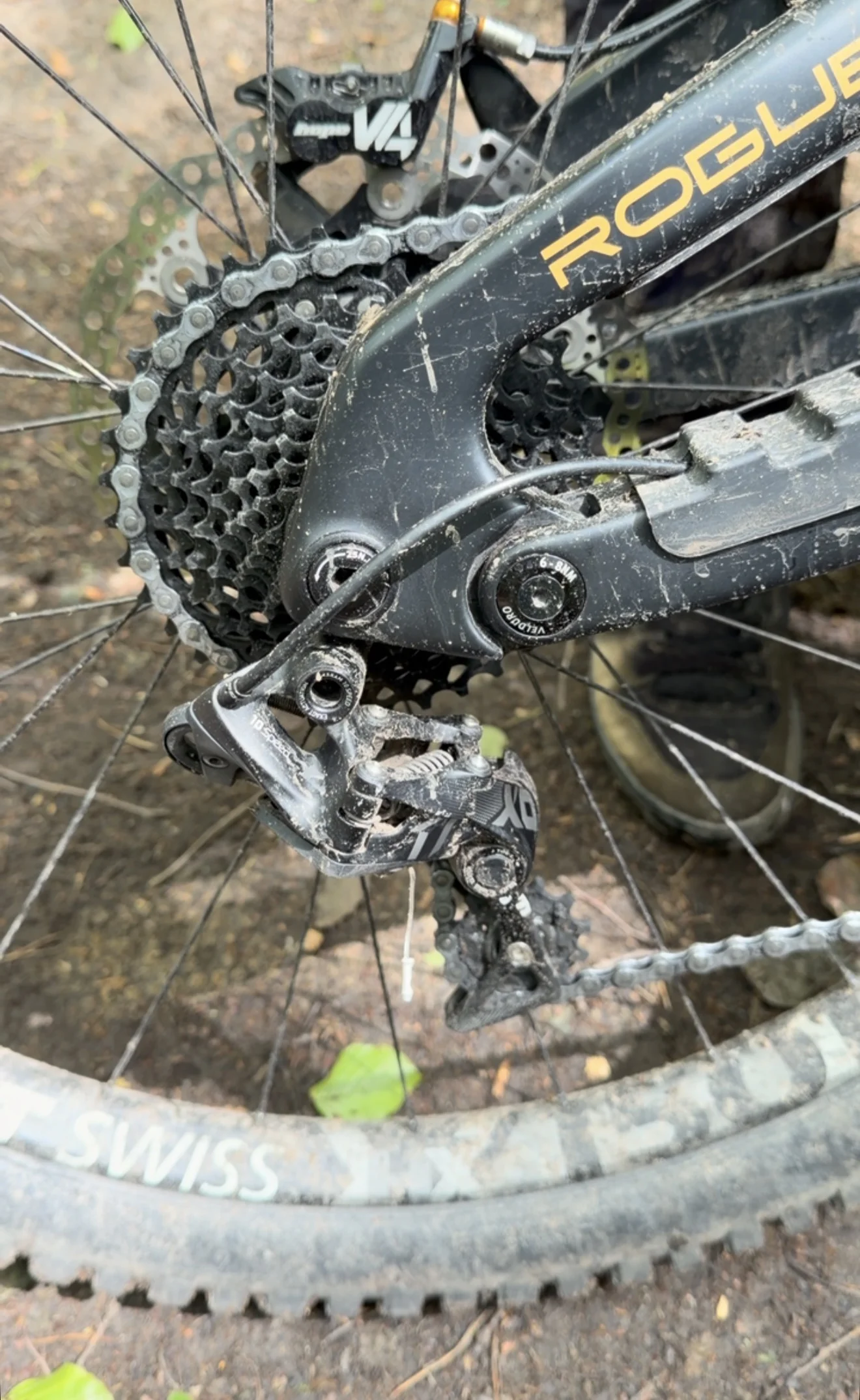

I’ve just got the bits for my 10spd setup.
XTR M980 shifter
XTR rear mech with Saint M820 short cage
SRAM XG 1080 cassette.
KMC E10 chain.
Saved a huge amount of weight on X0 T-Type & have a stronger, more suitable & more reliable drivetrain.

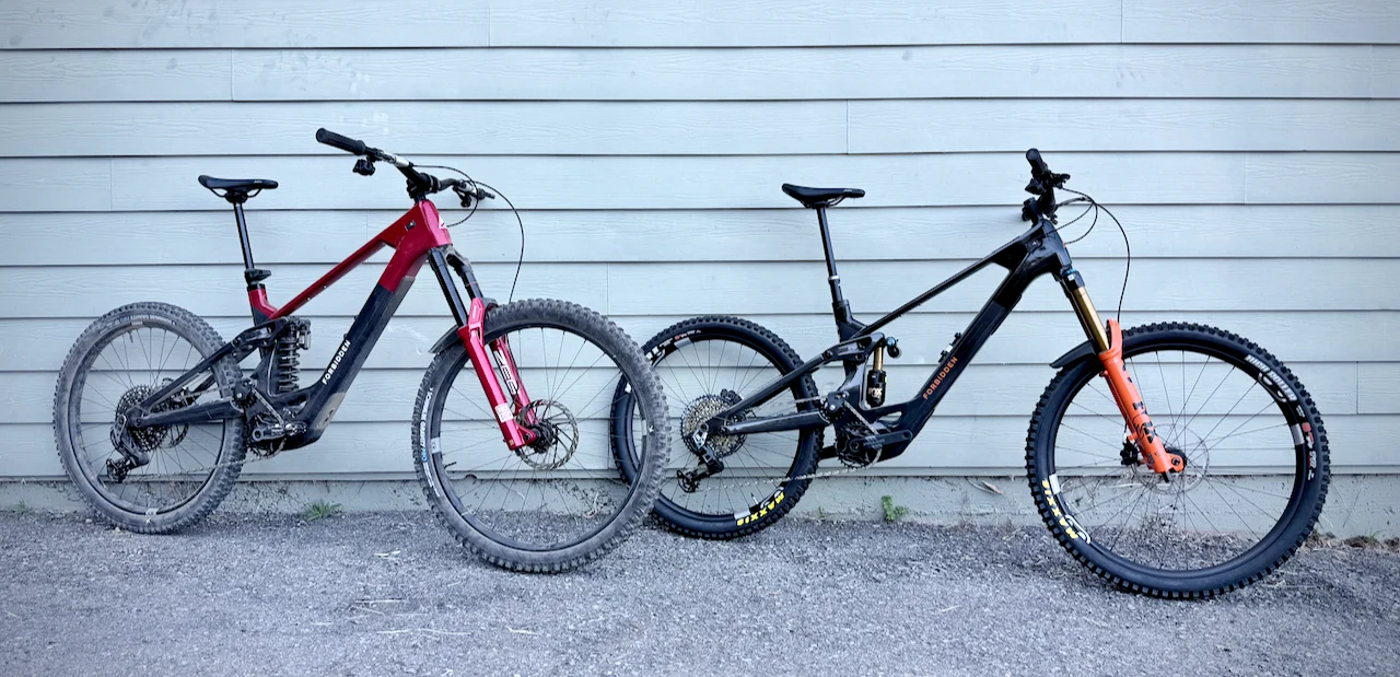

New to this forum and a new owner of a Dreadnought E.
I am 6ft tall and choose the S3 and the sizing feels perfect.
I went with a T1 build and made a few small changes
  • 200mm SRAM AXS dropper
  • Schwalbe Radials (MM Ultra Soft Gravity, Albert Soft Gravity)
  • PNW Carbon bars (38mm rise)(Running most spacers under the stem)
  • Peaty grips
I am still working on dialing in the suspension (stock 400 spring is feeling good so far).
This is also my first eMTB so getting used to the power delivery and settings in the app.
I have a few rides on it now and am super impressed. Happy to answer any questions you all may have.
My buddy also got a T2 and here is a picture of both of them.

My 10spd setup so far is spot on - haven’t missed anything more than the 32T on the back, I even think I could run a slightly bigger chainring on this. I forgot just how good Shimano 10spd stuff was.
The whole lot cost me less than a replacement X0 T-Type chain. 😆
