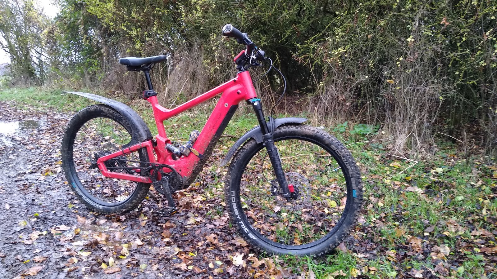

I am 2 months into my new R&M Delight Rollhof / Gates this has electronic shift and is quite beautiful to change as long as you keep weight/load off the system momentarily whilst shifting....just the same as proper shifting with derailleurs. it has auto down shift when stopped but to avoid stress on the box I have disabled the feature ...... no problem as you can change gear to your best starting ratio when stationary .
I do not like the Rollhof gear change switch especially when wearing winter gloves Very vague MUCH prefer the Shimano levers .
The lack of lengthy cleaning during the muddy season (10 months of the year) is bliss Big downside for me is the overall weight
. Plan a short review of the bike shortly.

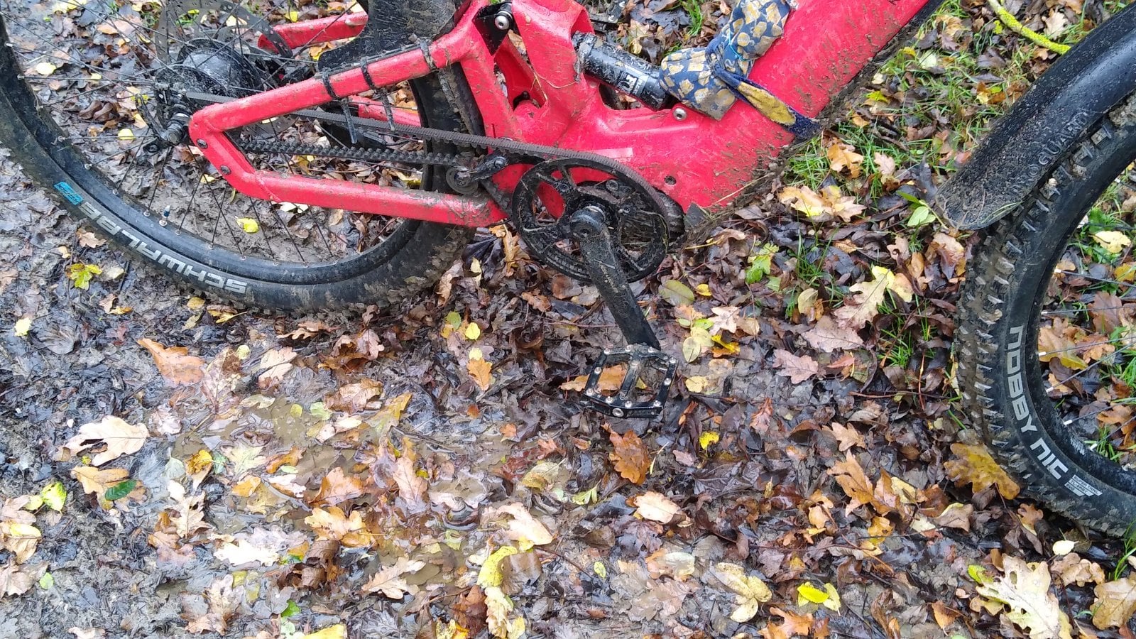

Is that a custom tensioner or does Rohloff/gates offer forwards frame/bb mounted tensioners now?
That is the stock tensioner . Needs disconnecting if you have to remove the rear wheel . Dealer showed me a trick of turning bike upside-down and with a long cable tie or similar pulling the spring out of the way...makes everything easier BUT remember which way the spring faces when refitting I did it wrong and had to start again. Have fun all.
Hey @OldBean what rear fender is that? Does it flap or brap?
Its a Mudhugger medium....... with my own rear extender and frontend mudflap to keep muck out of the suspension bits / shock area..its crude but it works...I still get some spattering but it keeps most muck away.
It does vibrate quite a lot but I ignore it ...the biggest problem is when its on the car bike rack..... it then flaps around badly in the slipstream. Have tried bracing it with various stiffeners but no joy so far. I fix the MH with reusable cable ties but refitting it before each ride is a PITA so dont bother to remove it.
