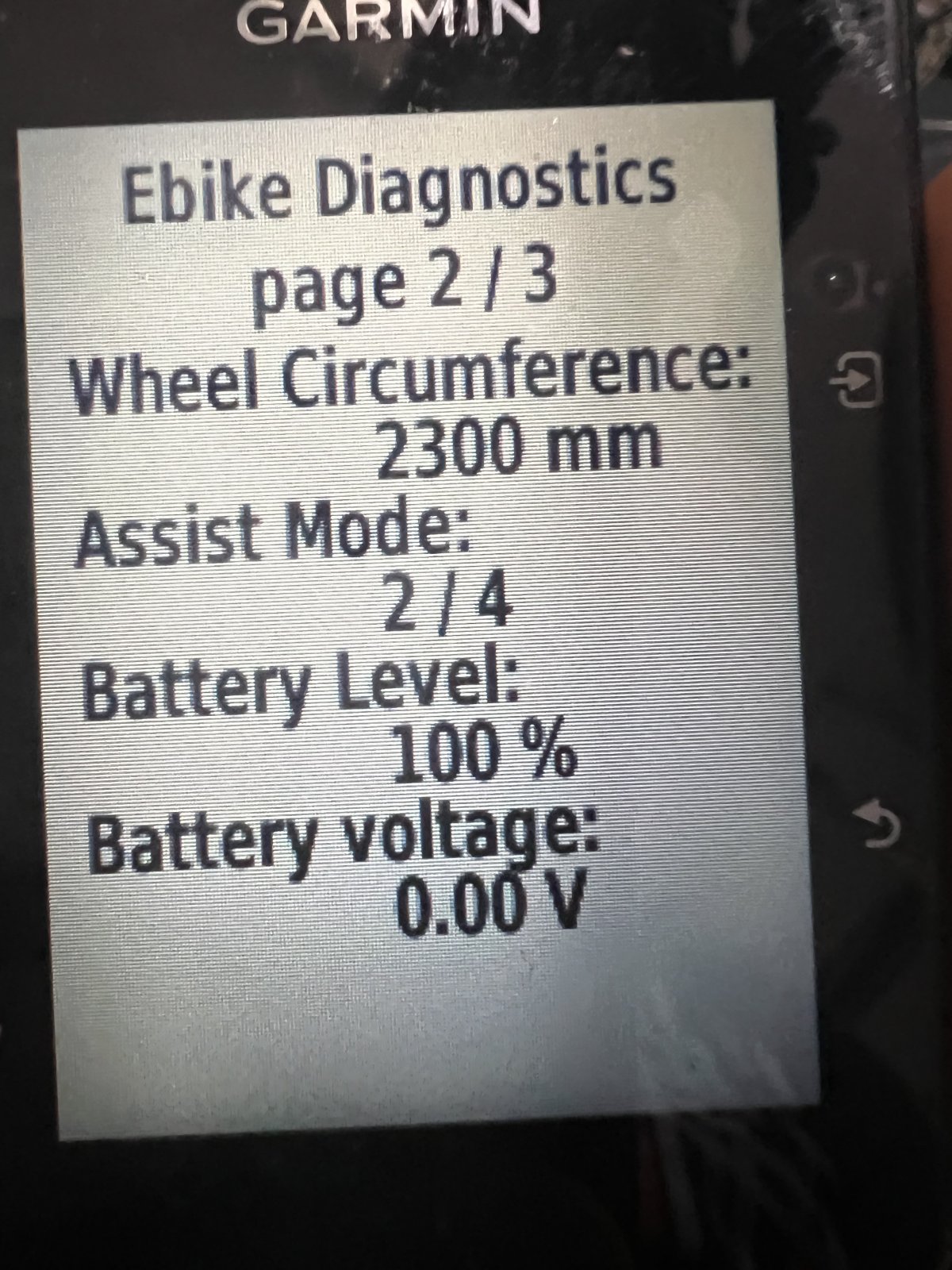

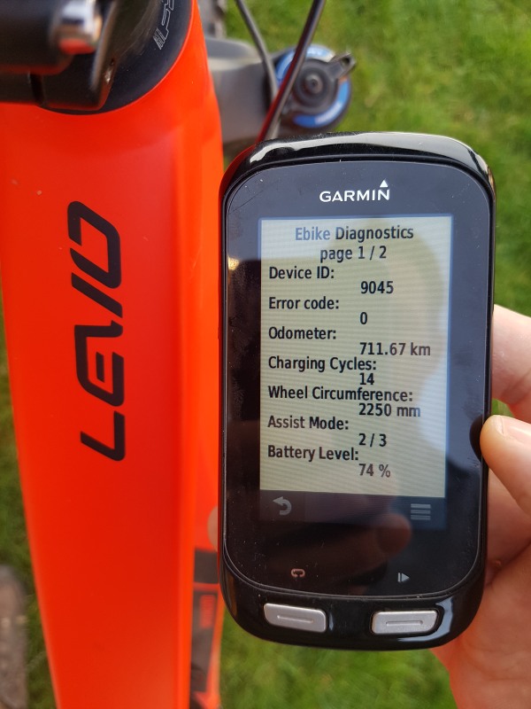

Hi guys, interesting that Specialized released such major update to older bikes. Please make sure to reset pairing by adding zero to Bike ID in app settings and it should pick up the bike again. They also changed how the bike reports assist modes. I will hopefully release soon ability to customise assist mode name to specific numeric values, so you will be able to have eco/trail/turbo back on screen after that.
Can you please some of you launch my Ebike Diagnostics app onn such updated bike and send me picture what number the app shows under "assist mode" after the dash? Thanks!
1st thanks for the great app!
FYI Eco show 1, Trail Shows 3, Turbo shows 5 during a ride

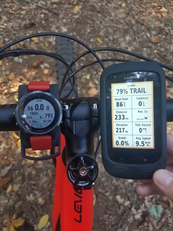

as I also ride Turbo Levo and likes to ride with my Garmin instead of smartphone, I developed applications specifically for ebikes which communicates via ANT+ connectivity (which all Turbo Levos supports) without need to be setting up any fake-channel. So, in case somebody is interested in similar setup, here are they:
Ebike Field behave like simple datafield which you can configure to your preferred screen layout. It can show both battery level and current assist mode and it supports wide range of Garmin devices (EDGE and watches). You can even configure what and how it should be shown on screen. Additionally it support to render graphs of battery state and used assist mode during whole activity to Garmin Connect, which is perfect for evaluating your battery consumption. Version 2.0 changelog with multi battery/bike pairing feature.
Ebike Field "Nerd Style" does the same as first app but is specifically for watches and tries to maximize number of information on watch screen while remaining usable. It is even able to remind you in case you are off your preloaded route/course and you can reconfigure shown metrics on screen in app settings via Garmin Connect Mobile app.

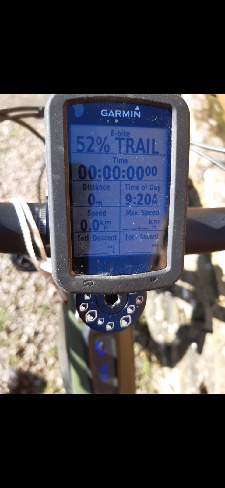

I too had this problem. 2019 gen 2 levo, Garmin Edge 1000. I can confirm that the fix of making the bike ID in the EBike Field section of Garmin Express fixed the problem. Get batt % and ECO, Track or Turbo.
