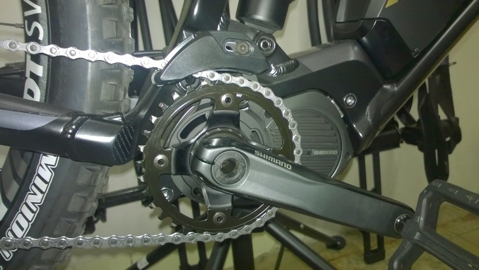

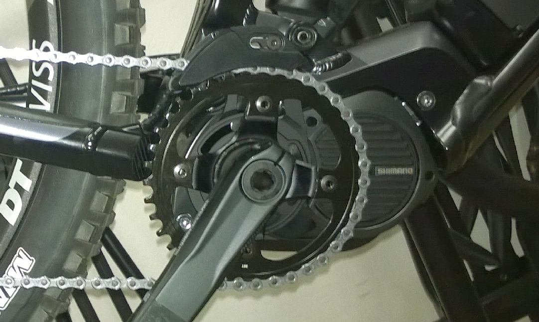

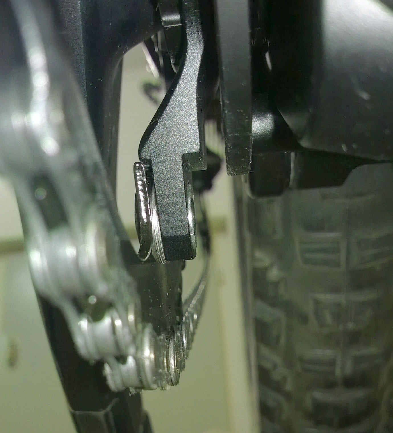

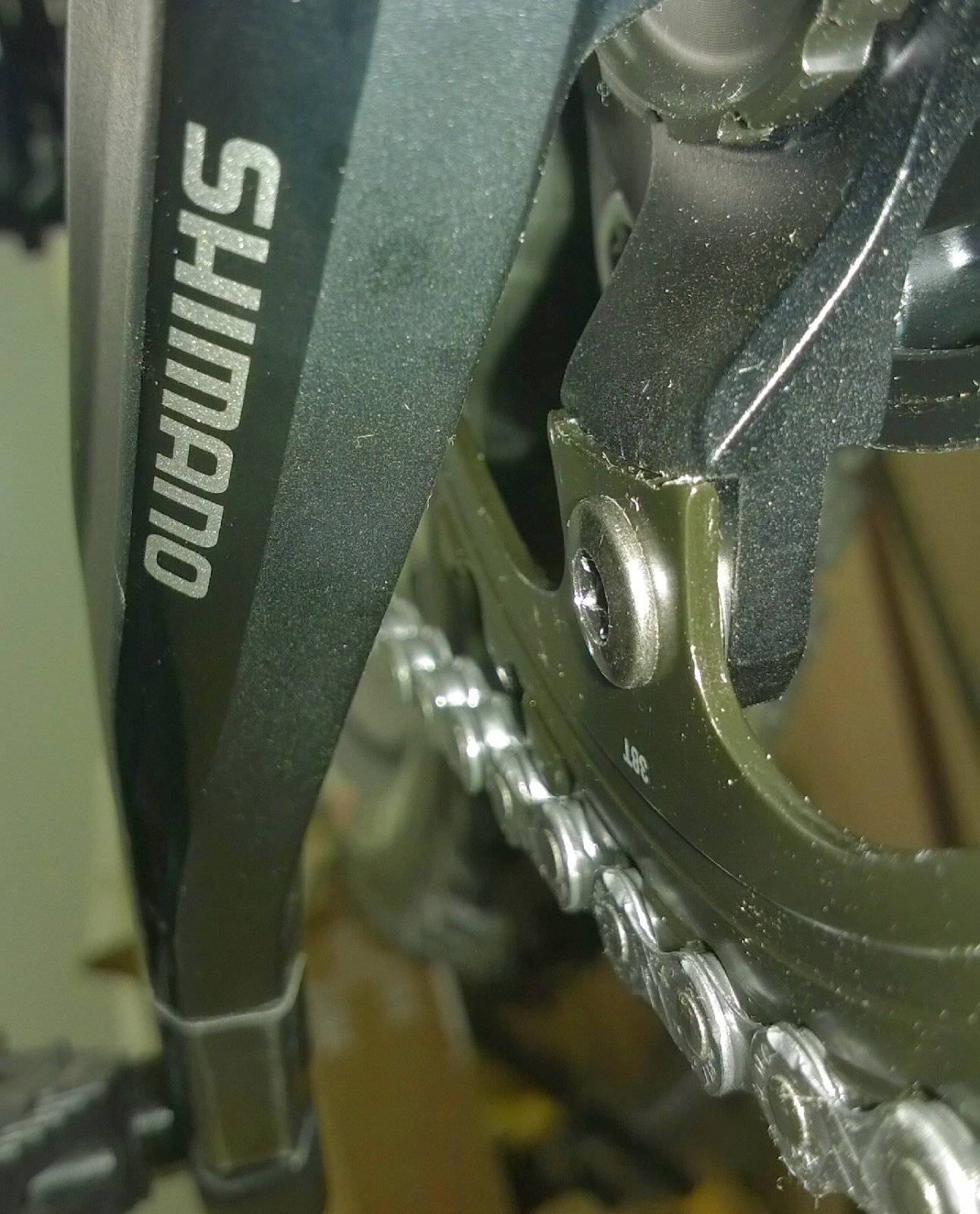

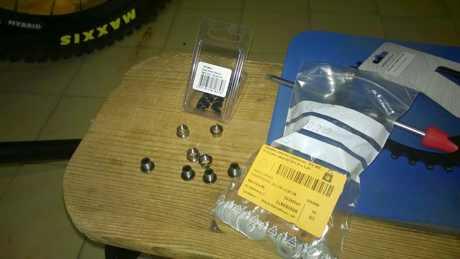

Hi, I have Merida e-160, XL frame. I use a 38T Shimano chain rings. Its circumference is too large, so I had to use washers, first about + 1 mm, finally it is about + 2 mm, and longer screws. The chain of 116 articles remained original. It was also necessary to slightly adjust the chain guide. Remember to check the screws for tightness after some time.
Ive run the chain on my e160 to the top ring on the cassette and I cant believe its healthy..it grinds like a coffee machine because the alignment is so far offset from the front ring. I even think it will simply throw the chain off...! What do I know ?
I dont think what you have done can be anything but worse but coming from the motorcycle world, I am happy to be proven wrong...!
This chain has done less than 200 miles - This is the amount of lateral flex it has....if it were on any of my motorcycles, I would have binned it ages ago...!!!
Just as well motorcycles don't have derrailleur operated gears, eh?
Are those longer screws some Shimano screws and how long they are ? Original is 10 mm about..
